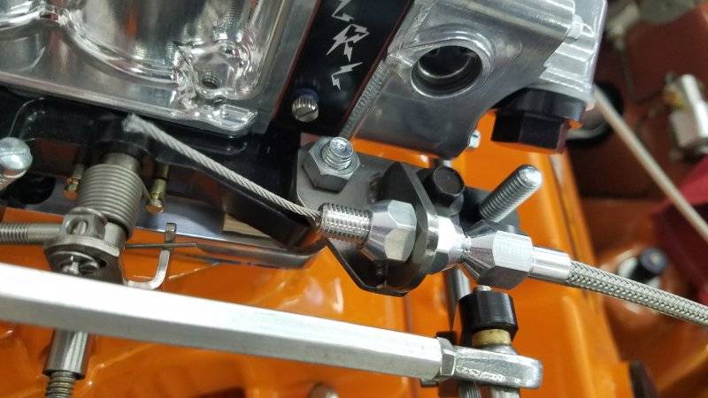

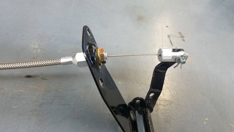

Looks like my existing stock throttle cable is not going to work with the new carburetor stud mounted throttle bracket I’ll be using. what are you guys using for throttle cable?
Looking at this….. Just want to make sure I don’t order something that wont with A Mopar pedal assembly for some reason.
Summit Racing SUM-200041B Summit Racing™ Braided Throttle Cables | Summit Racing
LW perhaps you can make the existing cable work by modifying the bracket location? Maybe fab something up?

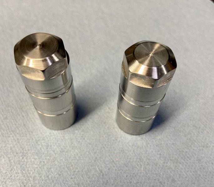

Made some new shock stud covers for the Dart today, liking my mil/lathe unit over here..

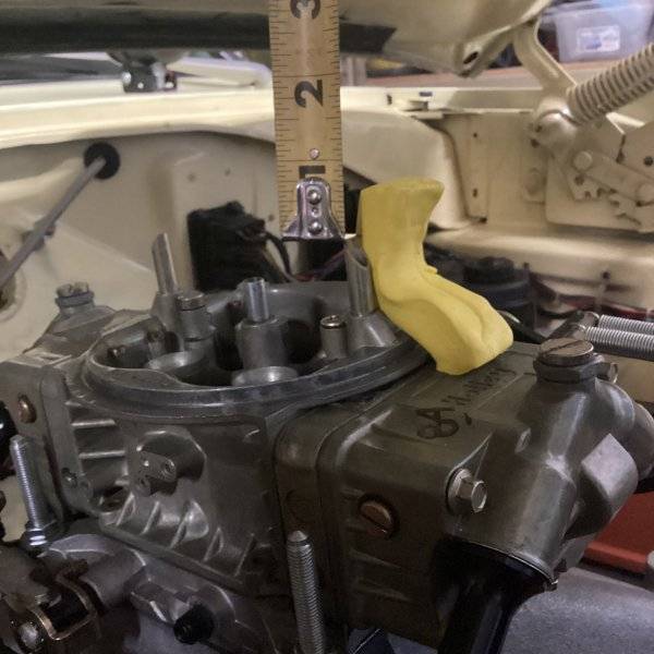

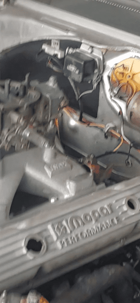

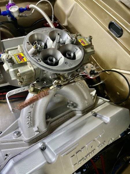

With this bracket, just in case I do decide to use a dominator. 2nd picture was a temporary fix just to get it running

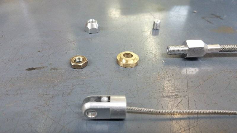

Amazon $19 cable with a homemade bracket. I did go with a heavy duty ball stud. Broke the skinny one.had a little modification to the pedal side.

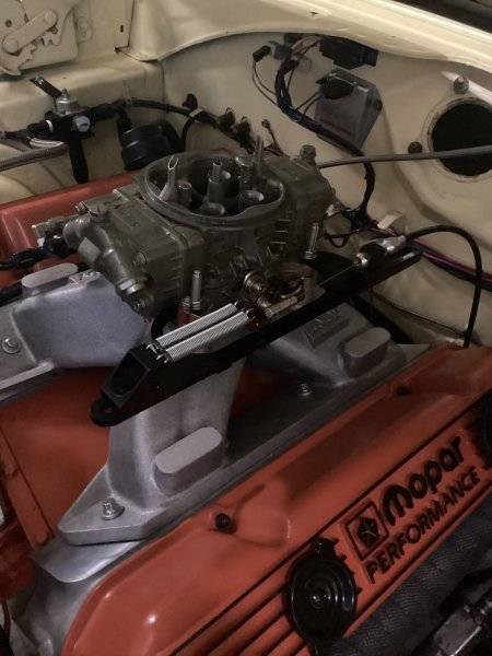

Got the last few pieces installed and took it for a couple of shake down runs around the neighborhood.
The Summit throttle cable worked out great. It’s adjustable / cut-able, and works great with the stock gas pedal setup

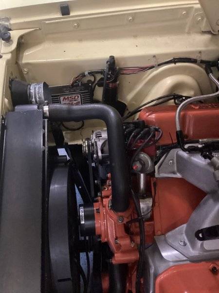

I put the coil over on the inner fender, right next to my ignition box. should stay a little cooler over there rather than the stock location.

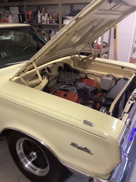

lastly, the hood was bolted on, and it fits….. sort of. With no air cleaner, and the 1” 4-hole spacer I want to run is out, the hood will shut. Carb overflow tube is 3/4” from the hood. No room for any air cleaner that I’m aware of. Especially since my new throttle cable bracket eliminates a drop base. I’ve come to grips with cutting this hood. My dad was over yesterday, and coming from a proponent of original musclecars, his comment was “who are you kidding? this is a racecar now and an RO23 scoop would look great. cut the hood.”

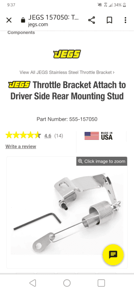

Hey LW looking good hope it exceeds your expectations.
Side note I see you don't have 1. Thought you might be interested
was planning on fabbing one up myself, but Im all about simple, so I ordered one of these up. Thanks 67!
