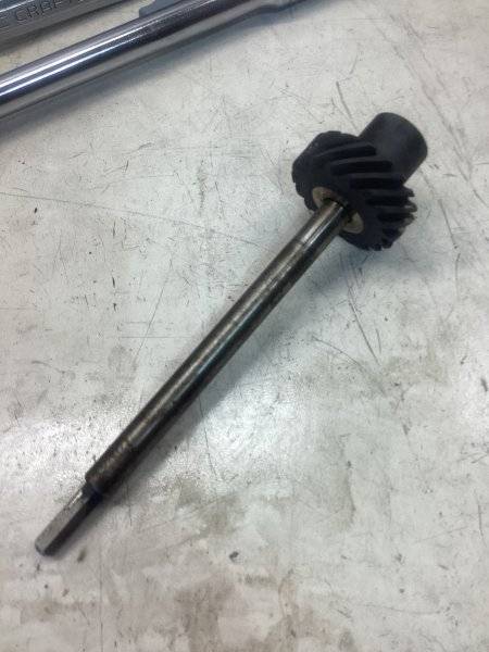

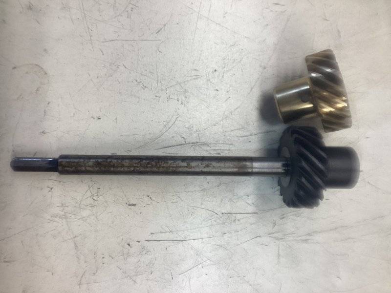

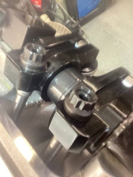

Q: Does the stock oil pump drive gear just press off the shaft? The new bronze gear has a roll pin hole, but there’s no roll pin in the stock gear.
After having the shaft in the press and applying torch-heat, I’m still not be able to remove the stock gear from the intermediate shaft.
I had assumed I’d be able to get the stock steel gear off. When I saw there was no roll-pin in the stock shaft/gear, I scratched my head….. what am I missing here? If I can’t get this figured out, I’ll have to order an entire new shaft and gear.
help needed, guys.

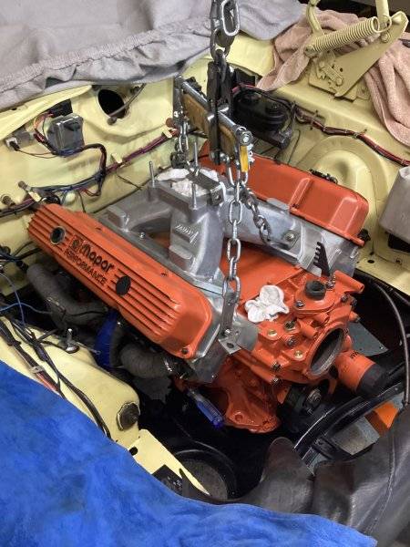

Well it’s in its home, hopefully for a good long time. Installing an engine all by yourself offers it’s challenges. Still not quite bolted down, but we’re close.
I woudn't use that shaft. Get one that is tapered at the hex to the round pirtion of the shaft. Seen more than one break right at the hex. Just happened to a friends new 512 on the dyno. Had to turn the crank, resize 2 rods, and replace the main caps. Not pretty
Doug
As dvw said, looks like a factory stock shaft, not a performance one. Recommend buying a complete assembled one from Milodon or another race supplier.

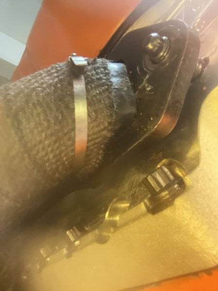

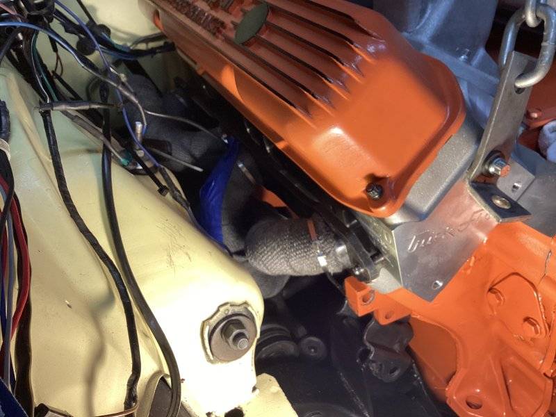

It looks as though I have a serious issue with spark plug to header clearance @ #’s 2 & 8. Angle plugs & Hooker Comp. 1-7/8” headers.
Shoulda‘ hung the headers on the engine stand.
Does anyone make a spark plug with a shorter porcelain section? How have you guys tackled this?
That’s crazy. Have you bolted the header snug against the head and rechecked clearance? Maybe wrapped to thick at that point?
its only wrapped single thickness with 1/2 overlap. pulled really tight. Not sure how I’d get it any thinner than it is. While removing the wrap would gain me a tiny bit, it’s not going to make up the room I need.
I found some shorty plugs that will help, but I have the crappy feeling that I’m going to end up pulling the motor and header back out, cutting the wrap off, heating the tube and taking the ball-peen to it. Then re-wrapping.
No good deed goes unpunished.
Ok, back out it came tonight, unwrapped #2 header and proceeded to heat and hammer. Got decent clearance with a fairly minimum amount of denting. #8 turned out to be ok. Re-wrapped the header tube, and got the engine back to the point it was prior.
Punishment accepted, and time done.

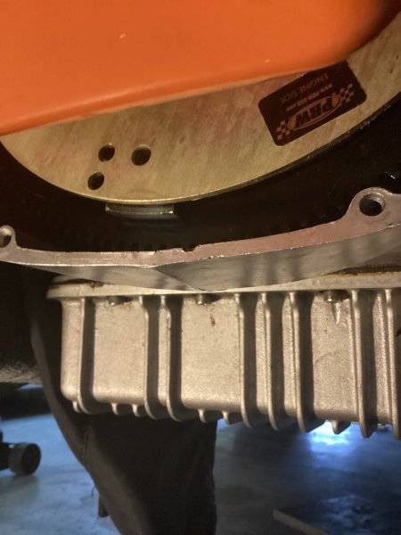

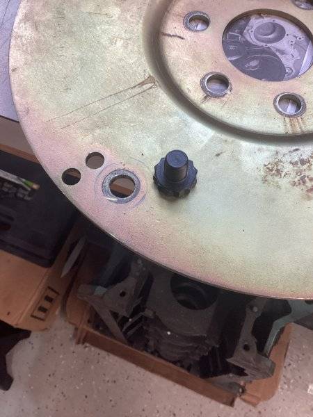

I cannot even believe what I’m looking at. Under the car to put the flex-plate bolts in…. Bolt hole in the flex plate is too small. WHAT!?! This can’t be. Dug out the old non-SFI rated flexplate. Sure enough. Different size holes; big enough to fit the ARP bolts. Who woulda dreamed this was possible. PRW is going to get a piece of my mind!
transmission now has to come out (lesser of two evils vs. the engine coming back out at this point).
Trying to keep my spirits up, but feeling pretty defeated.
Bummer, when you take 1 step forward just to go 3 steps backwards. Just a tip, I always hold the flexplate against the converter to line up the holes then apply a mark to both, makes tighten then easier
Not quite as bad as I feared. Got the trans loose and just a couple inches off the block and realized that was enough space to get a wrench in there. Flexplate out.
