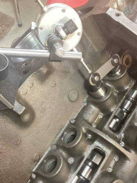

Install the cover with the gasket and a couple of bolts close to the cam C/L. See if the cam moves fore aft. If it won't move take .005" off the button and check again. The cover isn't a precisiion part. Sneak up on it. When prying on the cam, the cover will flex so make sure you watch it.
Doug

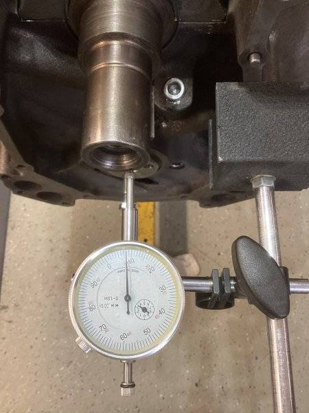

Thanks for the tip, Doug. I’m at a point where I can identify movement in the cam without any evidence of deflection at the timing cover (checked with a dial indicator).

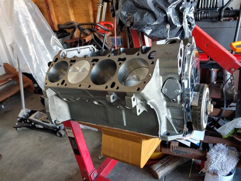

More progress To report.
Short block somewhat complete. still need to check cam timing and come to a final spot that I’m satisfied with on cam end play. I may be there, just not convinced yet. I installed the cam straight up. But as said, I’m yet to verify with my degree wheel.

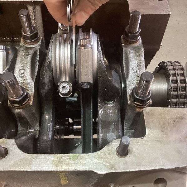

Rod journals ended up with .0028 clearance. .0030 on the mains. Crank endplay was at .008. All in all, it’s going together on the somewhat loose side. Probably pretty good numbers for a motor that will see 7k+ RPM.
The 470 (Chevy rod on a Chrysler journal) side clearance ended up with a largest clearance of .075 on the 1/2 journal, and a tightest of .067 on the 7/8 journal. I’m not sure what to make of that, but it sounds about typical from what I’ve read.

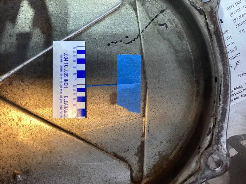

So I went ahead and got some blue plastigage to see if it was useful on the cam endplay question. I understand that there is a deflection issue with the cover. Probably some compression in the bearing on the back of the cam gear as well. Figured it couldn't hurt to try though. I did get some crush out of the plastigage, so I’m more comfortable now than prior. If I take the reading literal, it looks like roughly .012 (a little too much). When I figure in a little fudge factor for deflection of the cover and compression of the timing gear bearing, I’m satisfied that I’m somewhere north of .007, and south of .011. At the very worst I’m a few tenths away from that and willing to say “send it”, unless someone feels compelled to talk me out of it.

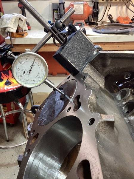

Also, if you’ve been following this thread, you may remember my post reporting that my machinist was less than bullish on his ability to offset grind my crank and then land at zero deck with a Frankenstein combo of parts. Well, he should have been more confident. His crank journal with my collection of parts hung on it couldn’t be more zero.
There isn't very much if any thrust when using a roller cam. With that amount of endplay the roller wheels aren't going to fall off the edge of the cam. Run it.

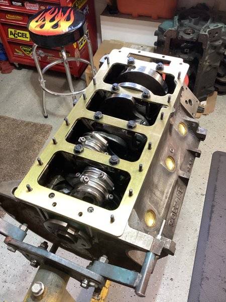

main girdle in place……
It’s going together LW, nice to see. That girdle looks lots like mine, which came from 440 Source, along with the aluminum main caps and lightweight crank. I guess it’s been 8 years since I put mine together and I still have one new left - left over piston. My kit came with 5 left and 3 right pistons. Lol/WTF. I called them and well don’t you know, the correct piston was still on their shelf and they sent it right out. I didn’t like the fit of my frost plugs like you’re using, they seemed somewhat loose so I changed up to the ones with more cup to them and those fit tighter for my liking. I was worried about possibly loosing one. The things a guy worries about during the building process. That’s going to be one fine build when your finished LW! . Low 10’s!
thanks Malex. It is a source girdle. I had to clearance the stud holes slightly on the #4 cap. When I put it on, it was snug to the studs on the front Side. I didn’t like that so I opened them up slightly. Like you, I believe in building my own stuff. Even though I don’t do it every day and have the experience of some, I know I’m going to look harder at every fastener, and think through every item, sweating the little stuff on my own engine more than any machine shop would.

I’ve seen circle burner motors with piston guided rods that ran more side clearance than that. Just think of it as piston squirters. side clearance helps hold the oil wedge on the rod bearings. If your bearings look a bit overloaded then you can just up the volume on the pump.

LW. I wondered what your deck was at. Mine is .001 - .0015 ish. I was running a .039 gasket with that. Then when I had the heads off I couldn’t get any .039, only .036 was available so in they went.

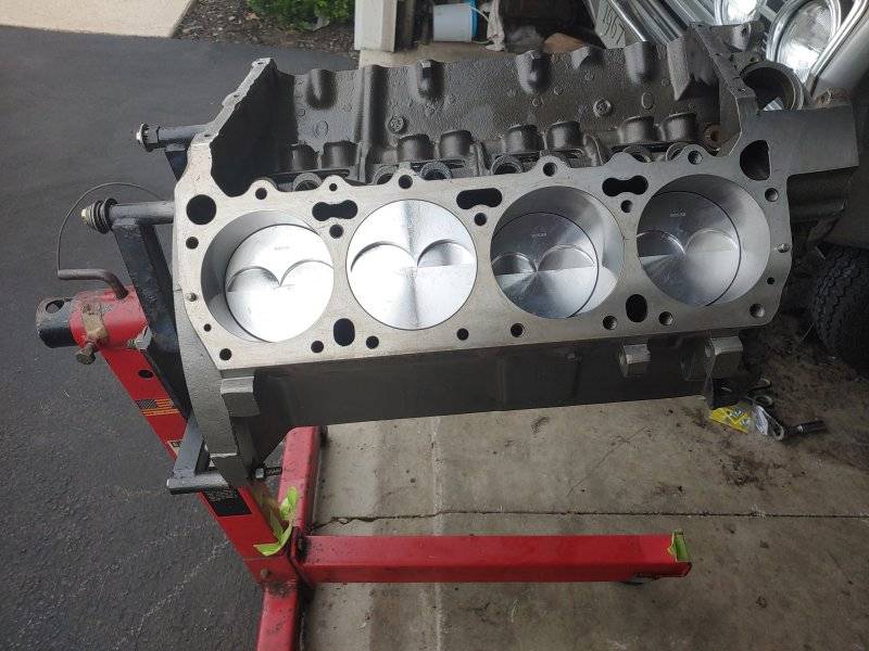

My deck has been cut .020. This is why my crank ended up at 3.875, instead of 3.915, and I’m at 468 cubes, instead of 470. I have .040 Cometic head gaskets. Comes in at 11.3:1.

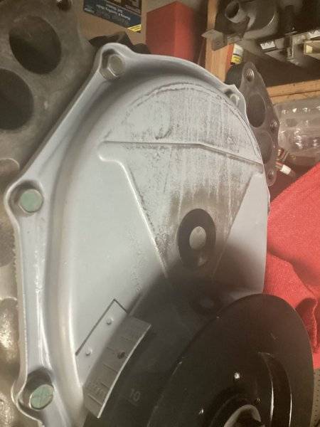

Got the short block buttoned up yesterday. I did apply a .060 washer to the front of the cover at the cam location. This snugs up nicely to the cast aluminum water pump housing, and should help limit cover deflection, and thus cam end play.

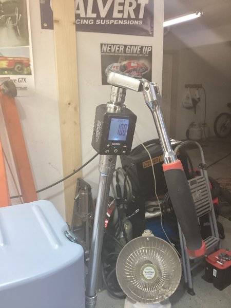

My favorite recent tool purchase is this handy little digital torque adapter that turns any ratchet into a torque wrench. Real easy to use and allows you to use your breaker bar as a torque wrench, making accurately tightening fasteners a little easier.

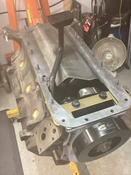

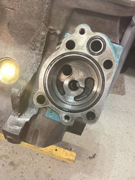

Im reusing my melling HV oil pump. All the passages look clear here. Should be good to go. With the addition of the girdle plate, I did have to adjust the angle of the pickup to both clear the tray, and to get it back to within 3/8” of the pan.
