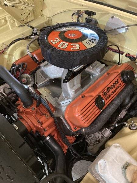

I would probably try to get some air to that carb somehow, but you probably don't want to mess with the firewall area for the air pick up Nascar style. Flat hoods rule.
Smartly and sharply cut some lard from that car. It should realistically be somewhere in the 3400-3500 Lbs. Easier said than done though.
I used to have the carb sealed to fresh air from in front of the core support (see picture). The new setup is tighter and doesn’t allow for it though. I may try to modify the airbox to work. Thinking a glass hood with an RO23 scoop May be in my future since I’d also like to run a 4-hole tapered spacer under the carb.
