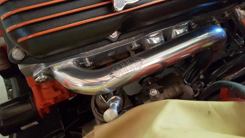

I just installed a set of 1 7/8" TTI's on my coronet.
It's a 4 speed.
I used a Robbmac starter. It was pricey, but I didn't want to roll the dice with an auto parts store reman offering and have to remove the drivers side header to replace a starter.
The fit is perfect with zero denting of tubes.
I did install mine while the engine and K-frame was out of the car. I wouldn't want to do it with the engine in the car.
