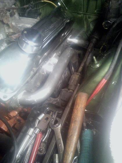

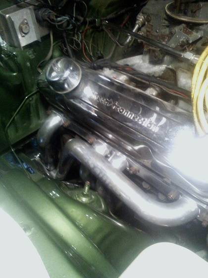

forgot to update this. I swapped out my old headers with my Flo Techs. Blocked up the front of the car. Pulled the passenger side off, piece of cake to get the old out and the new in. Had to unbolt the motor mount bolt and jack the passenger side of the engine up a bit.
I should have stopped for the day, but it went so easy I figured I'd like to get the other side done.
Pulled the drivers header off, unbolted the starter and got it out. The header would have came out almost as easy as the passenger side, but I needed a bit more ground clearance. I didn't fell like getting off the ground again, and since I have a brick floor....I just pulled some bricks up, and the header came out. Got the new header slid into place. I run an original gear reduction starter. I should have quit for the night since I was getting tired. The only bad part was getting the heavy starter in place and bolted. Then the header was a breeze...I didn't have to unhook the clutch linkage either.Plenty of clearance for the drivers side. The only issue of clearance is one of the passenger tubes is close to the inner fender. All in all a lot easier than I expected. I think if I had a 440 instead of a 383 it would have been tougher.

View attachment 669475 View attachment 669476
How high off the ground did you have to get the front end?
probably two feet. I forgot to mention...I did have to "adjust" the last tube on the driver's side to clear the z bar...but nothing drastic.
