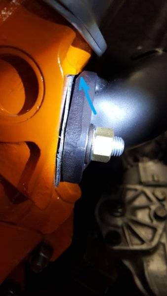

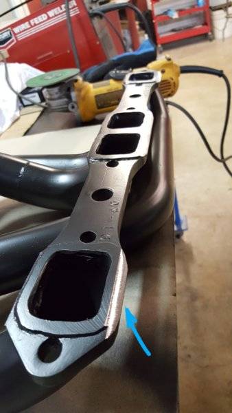

I see you're useing the 452 heads. They have a ridge that will interfere with the header flange. Quick fix is to grind/taper the header flange before installation.
