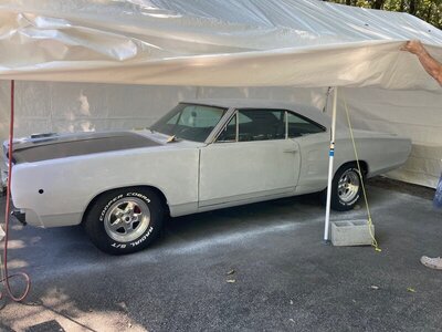

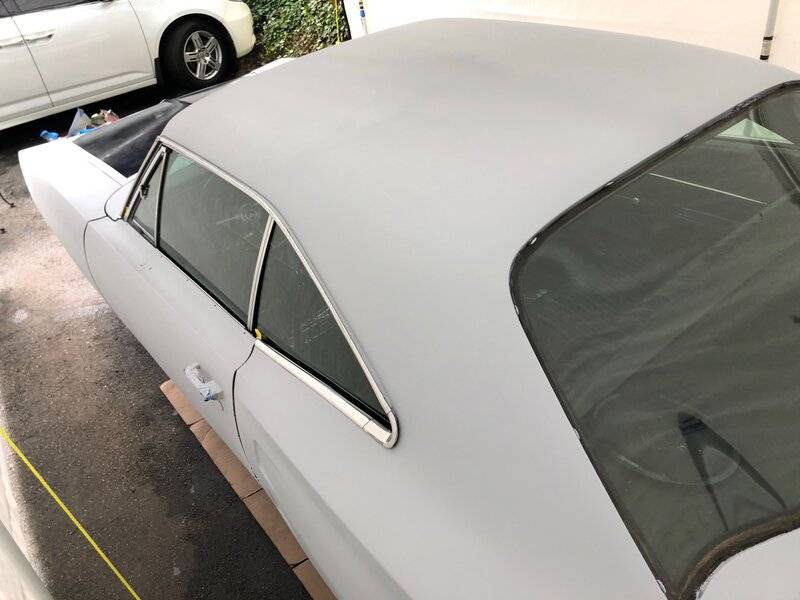

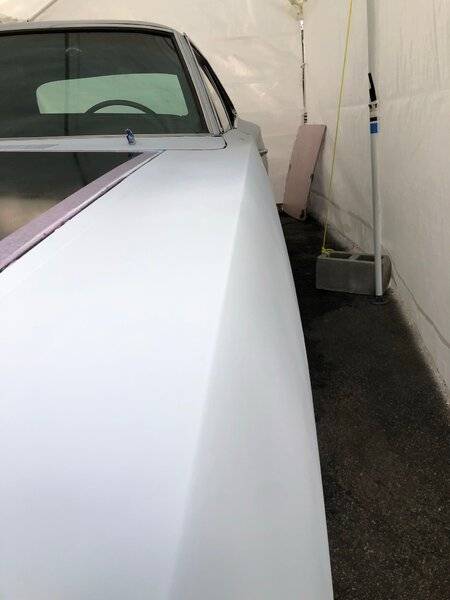

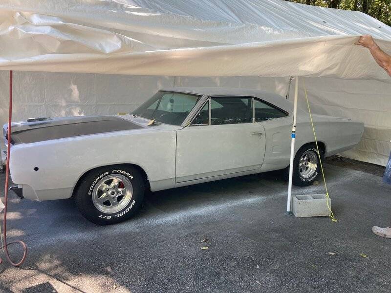

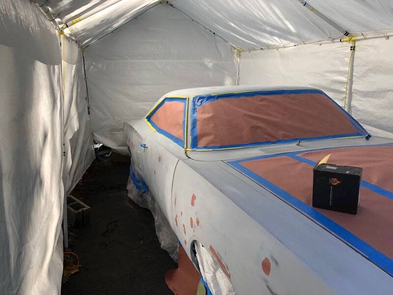

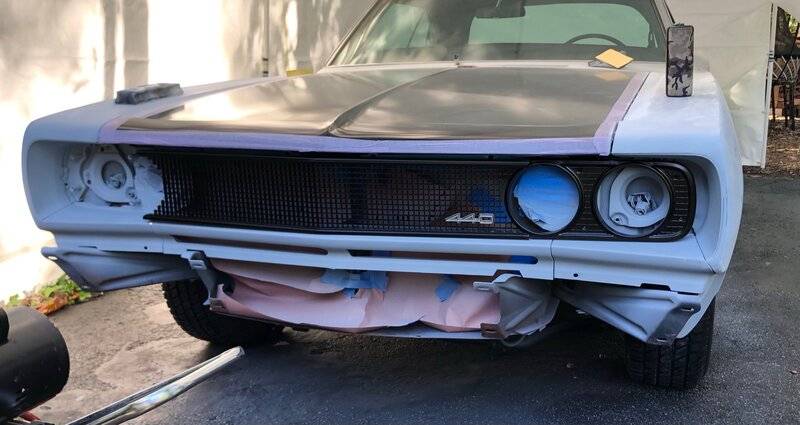

In prime. Block it tomorrow and hopefully it will be Q1 next week.
Rubber sits well. I will need to lift the tent skirt and get a side shot in the daylight.

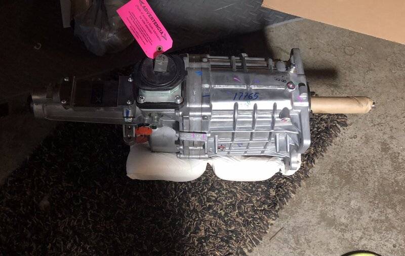

The mail man showed up. (1) TKX on the deck.

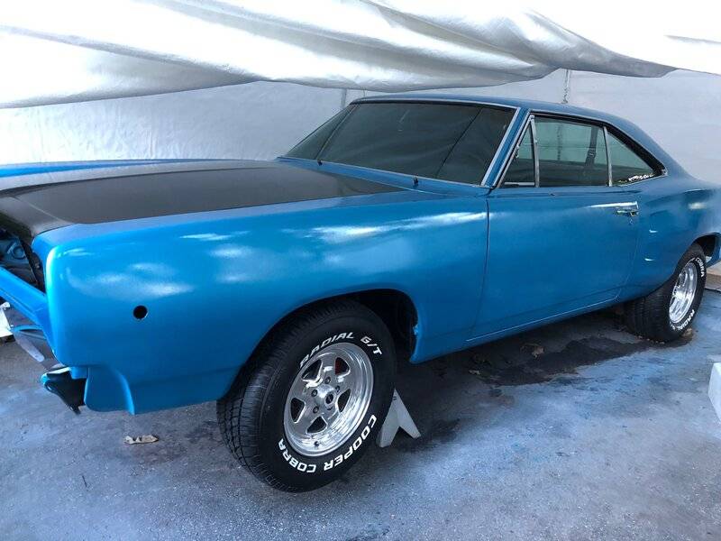

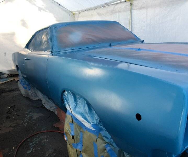

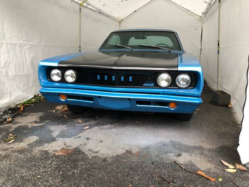

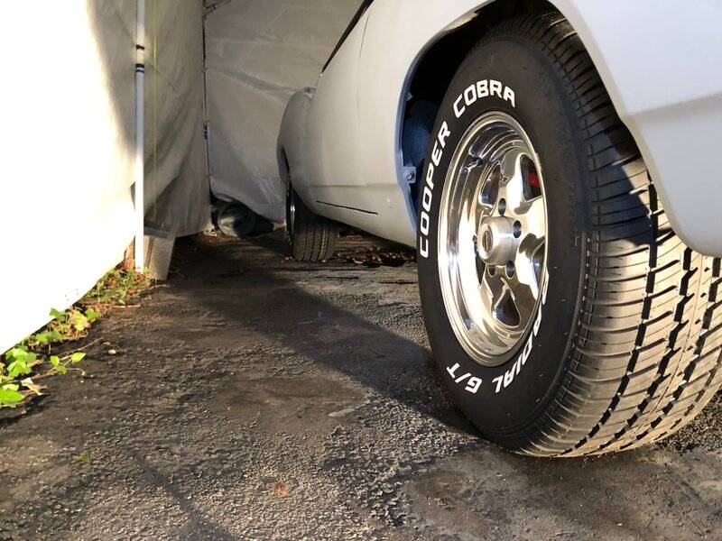

Full day of blocking and final touch up followed by a 6 hour spray out today. She is blue, my shoes are blue and my hands are blue but it’s over.
81DB3AD1-106D-4AA9-A2F5-C961CB7F04B8.jpeg A4053DC9-6440-4CB4-A85B-03492483DC91.jpeg
Buggers are probably blue too! Ours always were even though we thought we were wearing decent protection equipment.
I will give myself a solid B as we untaped today. Lots of lessons learned to carry forward. Now the real work begins to wet sand, cut, buff and polish.

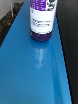

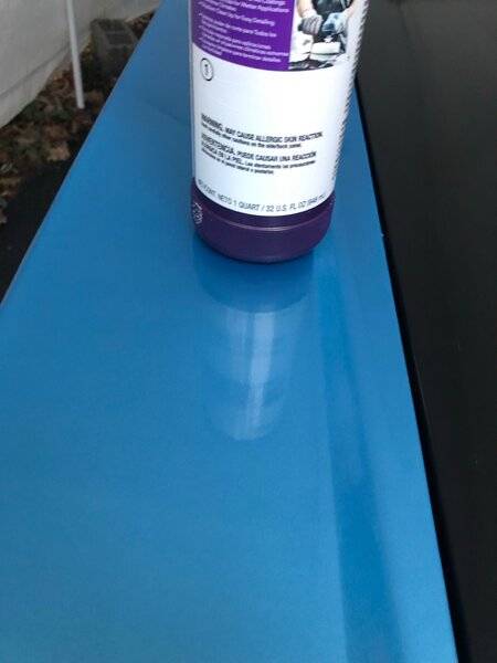

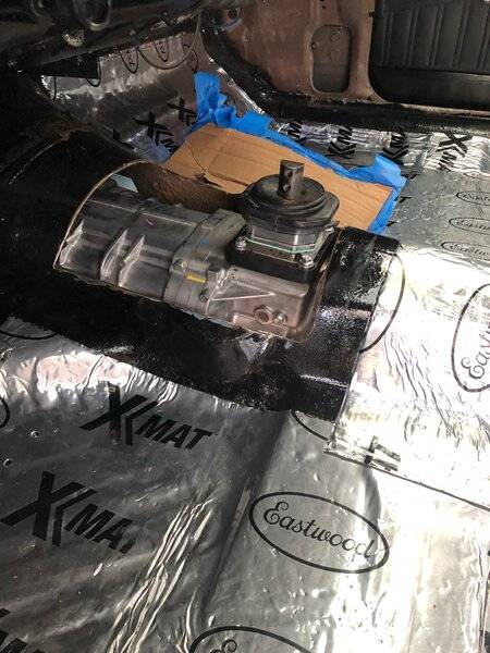

One TKX in the saddle. Not going to lie on this one. It sucked. It would fall in to the last 1/2” and then no way. I actually gave up last Saturday due to frustration and before a broke something and came back to it on Sunday. I needed to get something as a win so I wet cut all of the paint; 1000, 1500, 2000 and then test spotted rubbing compound to see if I took it far enough.
Back to the tranny, it says in no way to pull down that last 1/2” with the bolts or risk breaking the ears off. I waited 10 months on this transmission, in no way will I risk losing it. Directions then say to engage the clutch and let it self align again and it will go. That sounds great except the clutch is on the transmission that I am trying to install.
So, sneak the TKX up to that 1/2”, secure it, fish clutch hose thru and connect and then bleed clutch, which takes time. Run the TKX bolts in finger tight and engage clutch. It never sat down for me, but just slowly inched in. 6 hour tranny install. You win some and then you lose some.

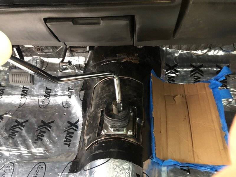

The good news is I would say other than the shifter hole, no big tunnel mods are required. I had already cut mine based on the TKO template. There is one knot on the top driver side case that will need the tunnel beat open to clear. Because of the shifter location for the B’s, it is the main shifter dogs. I am final placing the hump shifter cut out hole sized to the shifter base, no the shifter tower. All that means is a larger final hole so that the shifter tower can be removed from the top and not drop the tranny. The trade off is now the interior trim ring doesn’t have a base to screw off to. I will form a second hump hole and cap the previous one but only screw this down so it can be removed. Long winded, but hopefully helps the next guy.

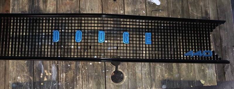

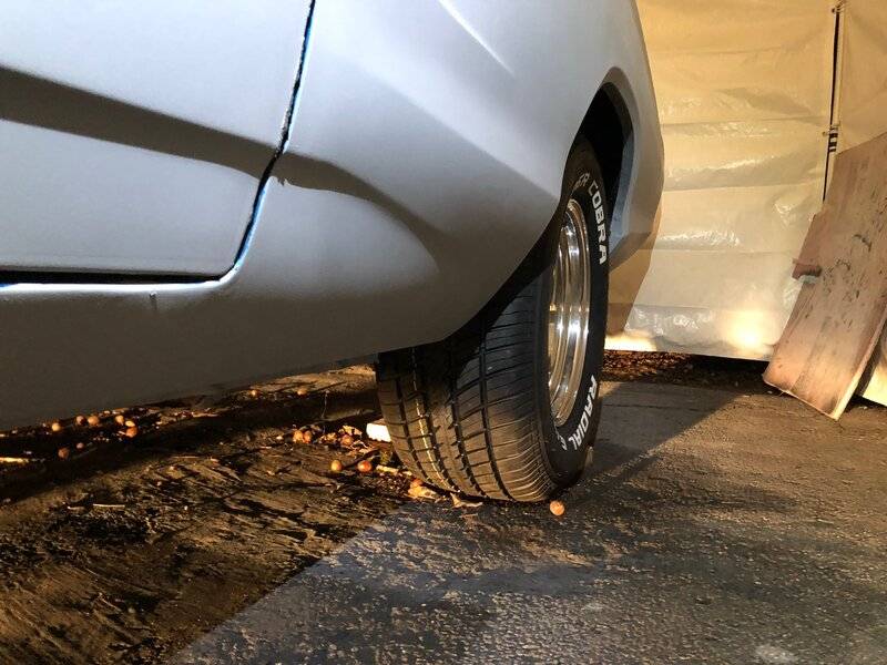

I bought LEDs and brackets to upgrade the front end, but bucket mods and additional thought will be required to make those happen so I punted back to 5001, 5006 for now. I need this thing driving.
Note for the group, the light buckets are specific and labeled by side and hi,low pocket.
Also, at tranny install, my drag link on the steering was backwards so it touched the oil pan. I little rework and it’s good to go. Why do everything once when twice the fun can be had?
8DD055E0-8C4B-4873-913E-AF1A7DFAB215.jpeg 89209A91-A06C-4A53-9B54-AF837D81713B.jpeg
I wasn’t sure when my son wanted color match on the bumpers but it seems to work. I know it is not everyone’s cup of tea. The good news is the bumpers were very tired and needed rechrome or replacement. This kept the originals in play.

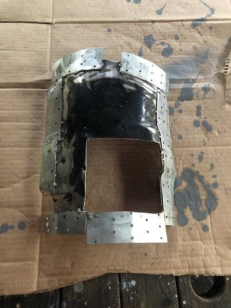

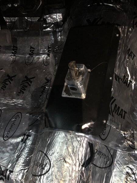

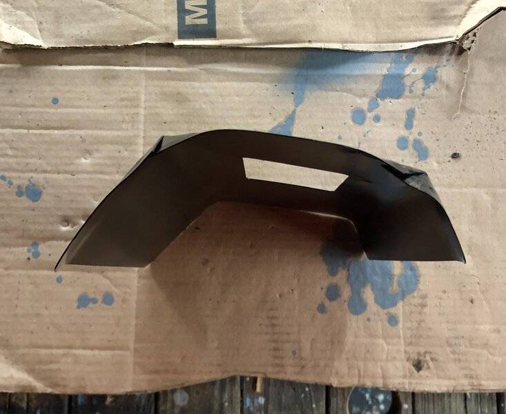

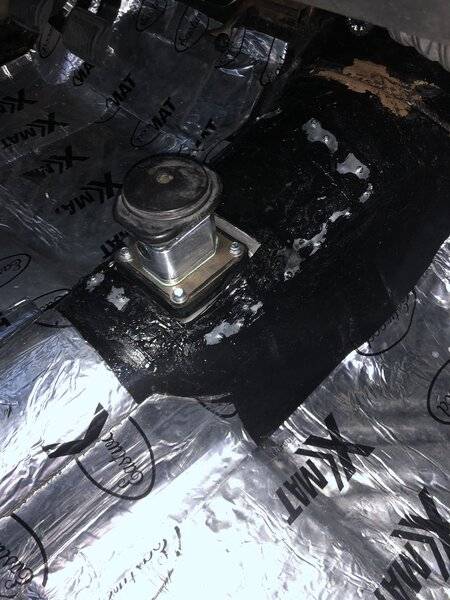

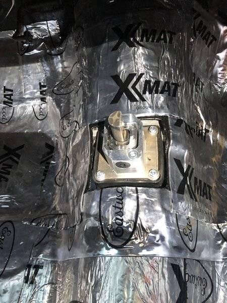

Original plan was to install tranny, measure for driveshaft and spot shifter hole then pull it back out and weld the hump from below. With the pain of install, no way I am pulling this thing out unless mandatory. So I am attacking the hump from above. (2) lids going in. First to secure and waterproof the hump and second for a flat spot to at h the shifter boot ring.
I took the original cut out and welded tabs all around so it would now just drop in and cover. I seam sealed, bonded, and screwed it tight. I then seam sealed all of it. The second is plate sent from SST as a flat and you have to bend it. The crack in a picnic table makes a great metal brake for longer pieces. Again second hump is screwed only so that I can remove and chase the shifter from the top if needed.
