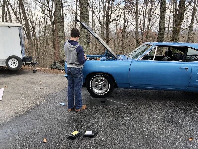

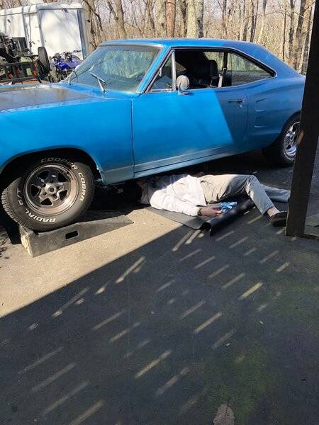

First oil change. Everything underneath seems in order. Heavy lifting is over so driver mirror put back on. Reverse lights connected. Roadside kit put together and secured in trunk.

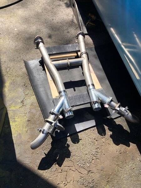

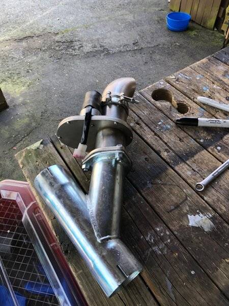

The fun; As we all know these cars are never finished, the weekend just is not long enough. So, we added some noise. His favorite thing so far.

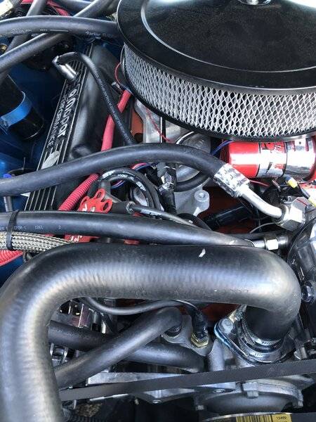

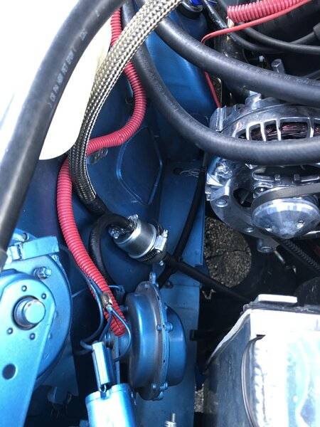

Resolve on the heat soak issue for the group. Vapor lock/percolation. I went ahead and installed the 1/4” return line, Wix vapor seperator, and rerouted the gas supply off of the block. It will idle all day now and not bust 190*. The Wix will need a .060 restrictor fabricated and pressed in as the return barb is wide open and not restricted. Apparently the fuel was boiling, leaning out the mixture which was then making heat. It just snowballed the longer it sat in traffic. No amount of cooling fans were going to be able to compete.

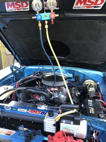

Last piece of the puzzle. A/C has been sitting, waiting on some warm days to charge. That was today. Pulled it down for 45 minutes, good hold at 29”, hit it with 3 cans. Cold on the inside. Found a great hint in route. A fully discharged system will not engage the clutch until 25#’s. Do not jump the Low pressure switch, it will smoke the compressor. Drop your 134a cans in a bucket of hot water. Just before use, use compressor air to clear all water. The hot can and cool car makes it suck like a, well, $2 is $2 dollars. Once you are above 25#’s, start the car and finish.
