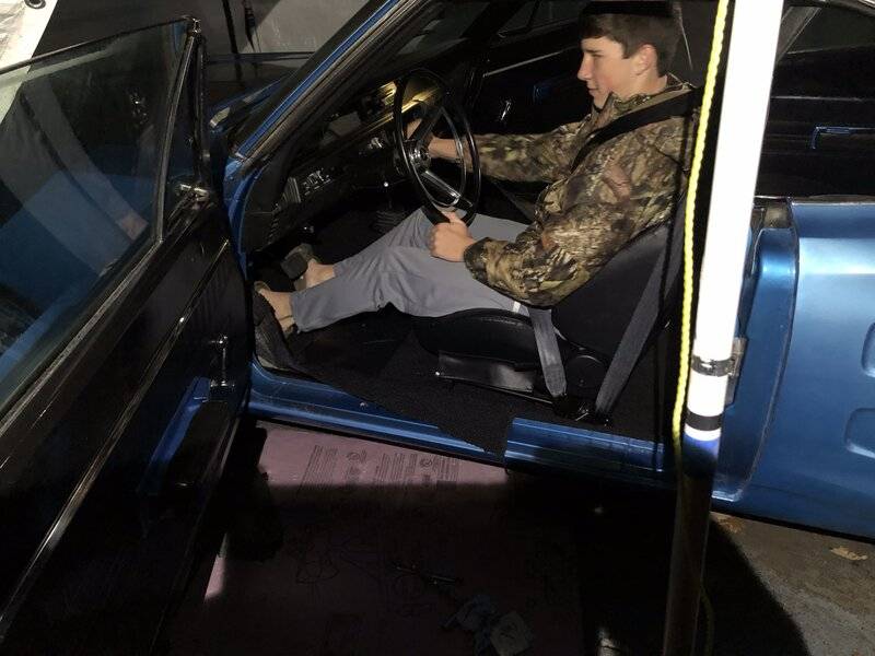

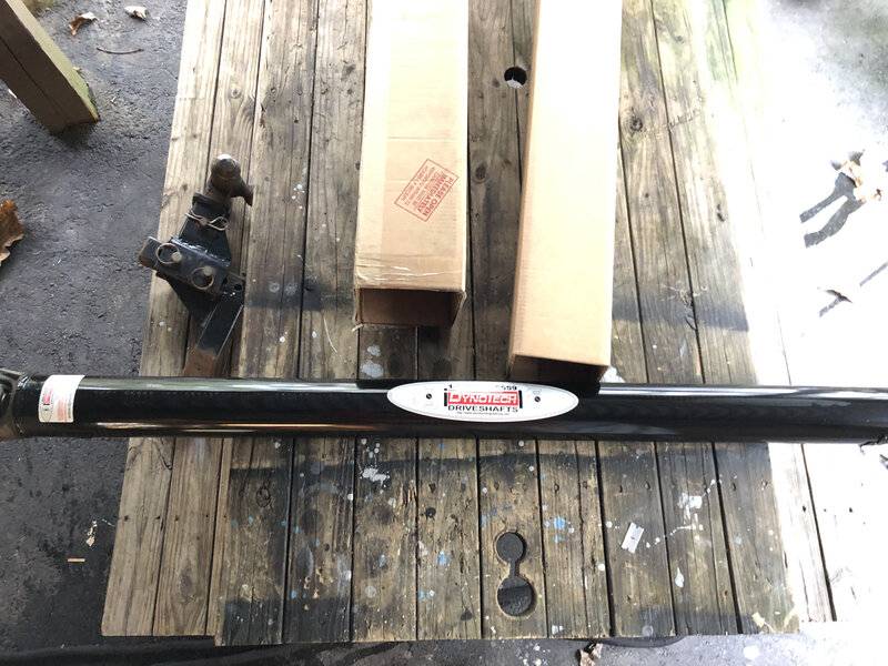

With the delivery and installation of this last package today, she moved under her own power after 26 years. I went exactly 5 feet forward and then 5 feet back only to realize I was already out of gas. Well hell.

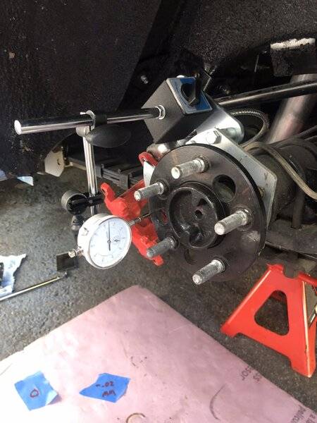

Looks like the rear wheel studs have a heavy shoulder and the disks were not seated. Opened up the rotors holes and that issue is resolved.

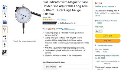

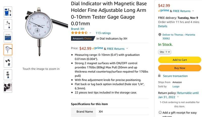

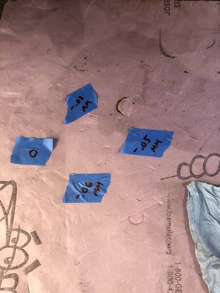

Pictures of the axle with the dial indicator. Well, because I went thru the trouble.
.00196” out. Looks good.
32D27D4F-B8AD-423F-9553-1225AF2898F3.jpeg 1239AA53-B4E2-4E78-9425-6B244295C4A5.jpeg

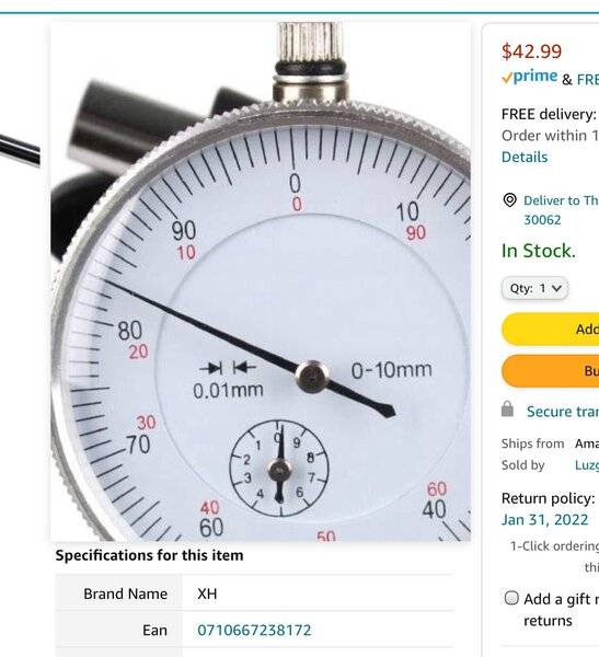

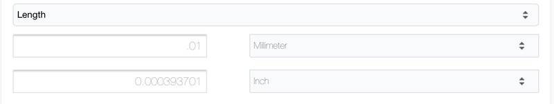

I had to do my bell housing and the only gauge I could find quickly was the one below that uses commie math(mm). It measures at .01 mm which is .00039”. That is pretty tight.
BF3A1D30-A5F5-4D32-85E0-4EF081B122DB.jpeg 833AF4D6-265A-4C24-8AD5-BAA86E597105.jpeg F28FBA0F-1C6E-423E-9B32-E875F5BA2051.jpeg

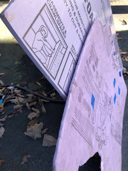

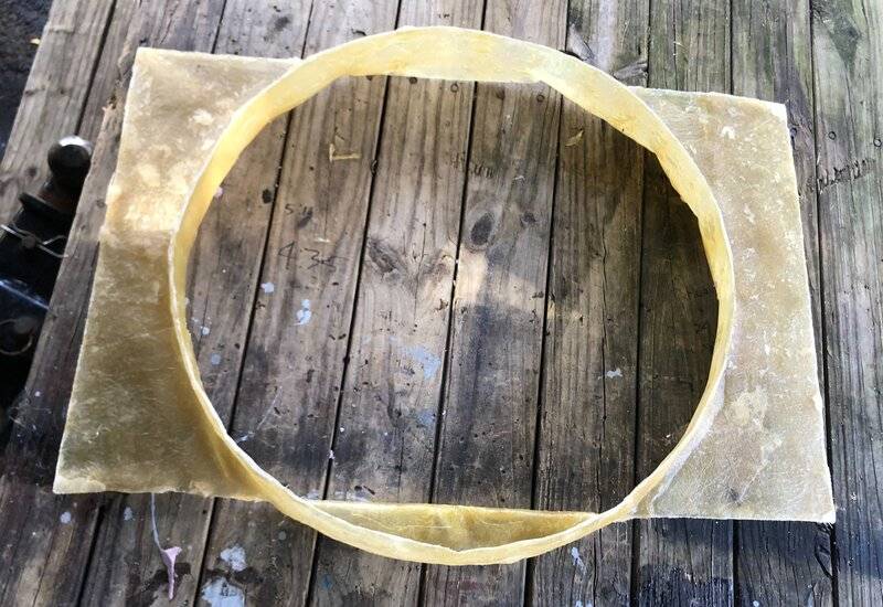

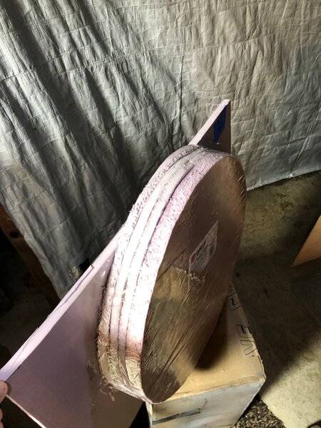

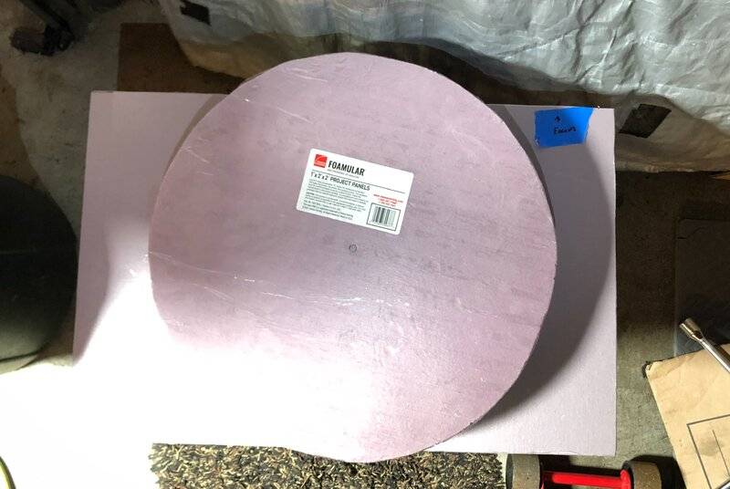

Looks like we will need a shroud for idle/heat issues. I have the 26” Champion radiator and did not realize that all of their shrouds cater to electric only, no fans. The universal kits just don’t quite fit. I am going to give making a fiberglass one a try. Mold already made below.
C1120A12-35C4-4F07-A7A7-78AB9D80A759.jpeg 66EAA643-CF7D-4570-8A07-509CE38A276D.jpeg

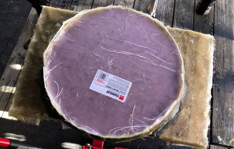

All dry and out of the mold. I will float out some of the lumps and then go to paint.
C85D935C-2897-4F84-9866-CEB1EE6DAE8C.jpeg 12B43A83-29AF-489D-A821-9004544E9106.jpeg
I have a few boats so I fiberglass a little. This would be my first “part” to be produced. Kind of like paint, 90% prep and 10% production. Just wet it out and keep going. I went 3 layers and it seems plenty rigid. I will run some metal down the vertical sides for the screws to clamp the fiberglass out.
The foam works well, but put packing tape on everything or the resin will dissolve the foam.

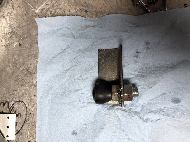

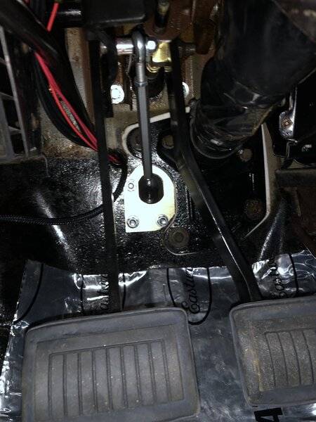

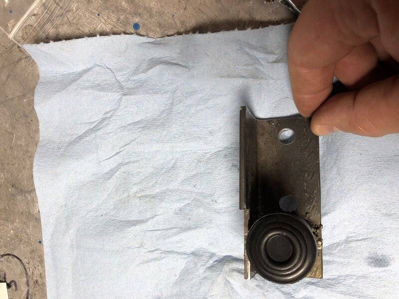

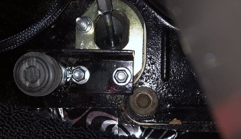

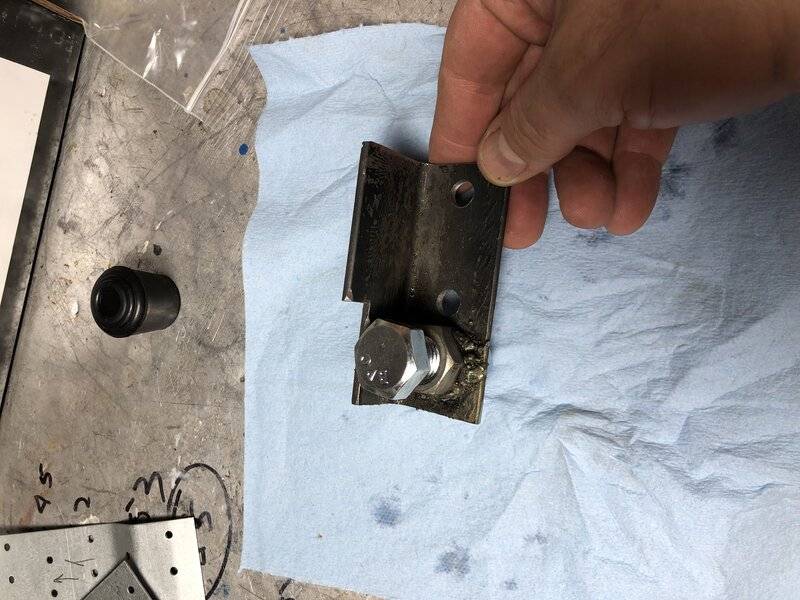

I forgot to add this on the clutch after we installed the tranny. The hydro clutch almost mandate a pedal stop or risk blowing out the master cylinder. Of course, the kit contains no provisions to do so. Luckily the master cylinder bolts at the clutch are long so some angle iron, welded nut, 1/2” bolts, and a table foot bumper gets you there. Pics below and I will add the final install later.
6349B17B-9AE0-44CF-8C25-AA557A80AA93.jpeg 5ECB26BF-A223-4851-92D1-AA167AE61BF6.jpeg A76DD413-2F6B-49DD-8B89-FD47C06E3735.jpeg C7B3DF7D-AF15-4564-B9CE-02E60D6ED200.jpeg

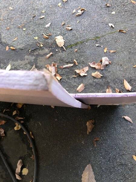

Clipping paint. Getting better but my shoulders give out on the vertical.
Cardboard is old school. Get some pink/blue board. Provides cushion and you can stab your screwdrivers from range. The piece on the right has had a hard 14 months based on compression.
