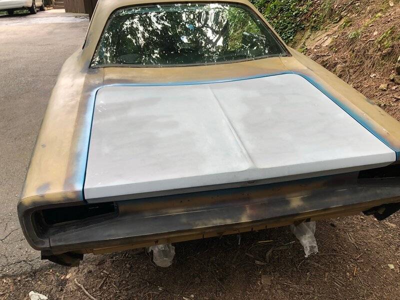

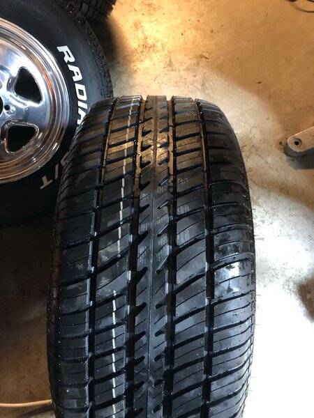

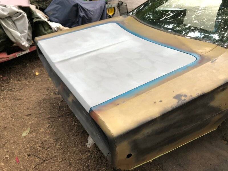

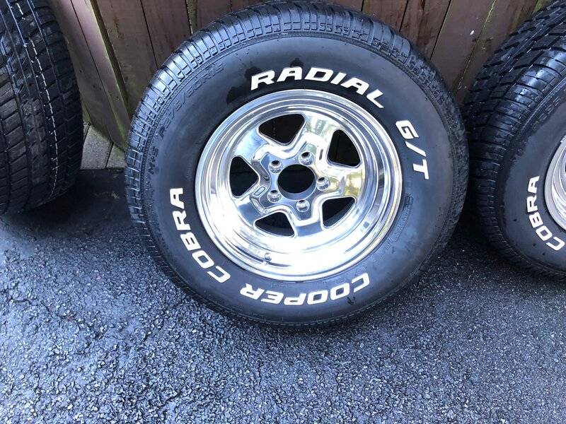

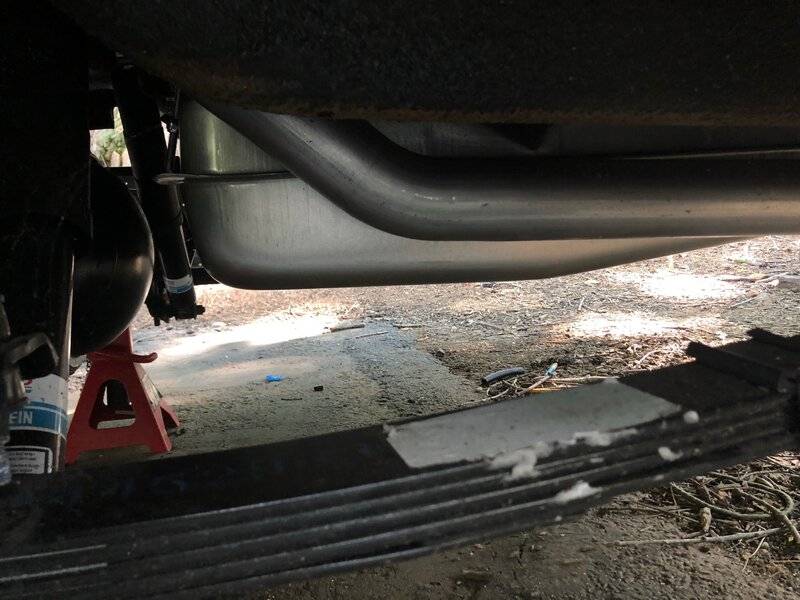

Trunk and seal done.
5A451D9E-878D-4EB7-BB44-92372BA95BF1.jpeg 23FA2D37-181F-43A3-9FBE-19C7173C3C9E.jpeg

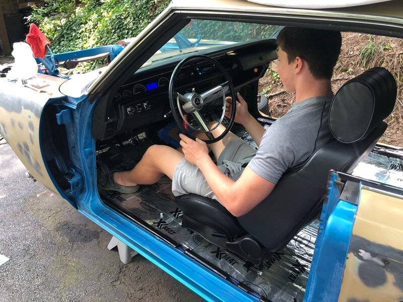

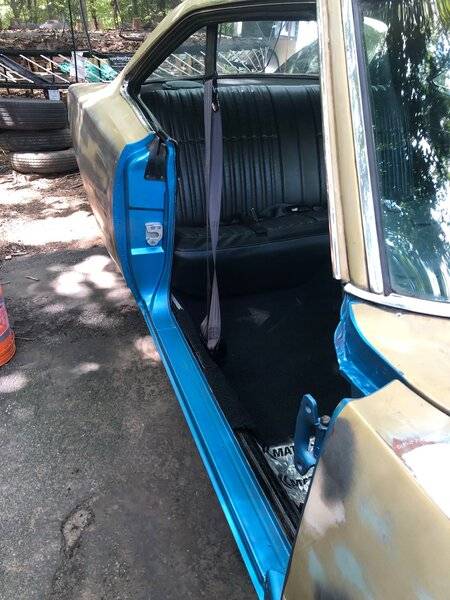

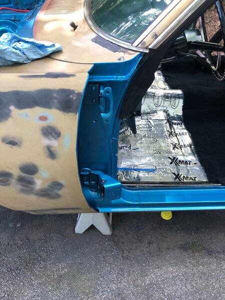

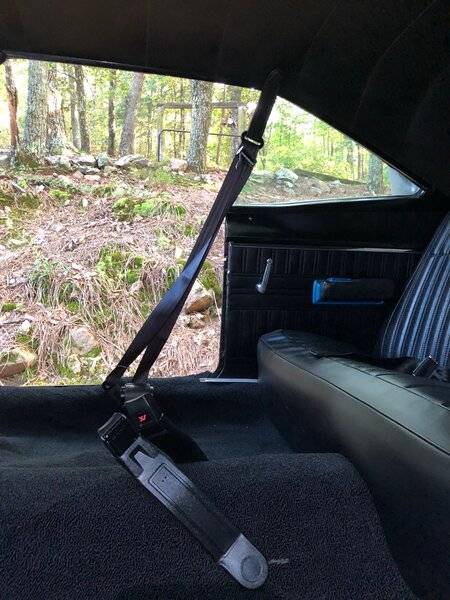

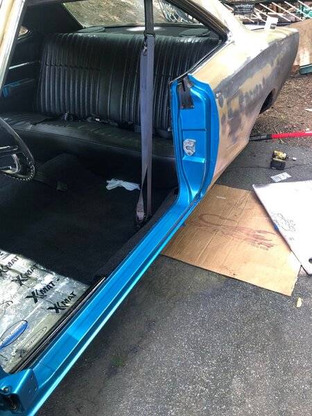

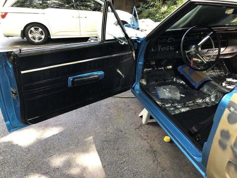

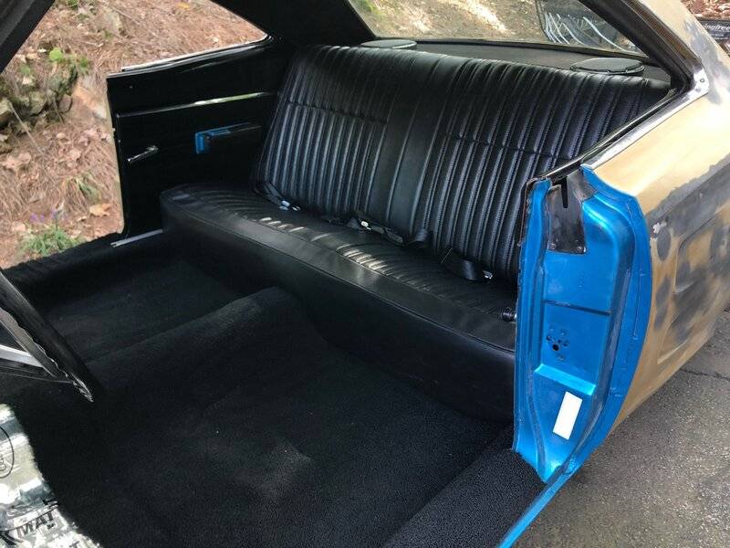

Steering column back in. Middle to rear interior 100%. Waiting on tranny to finish hump.

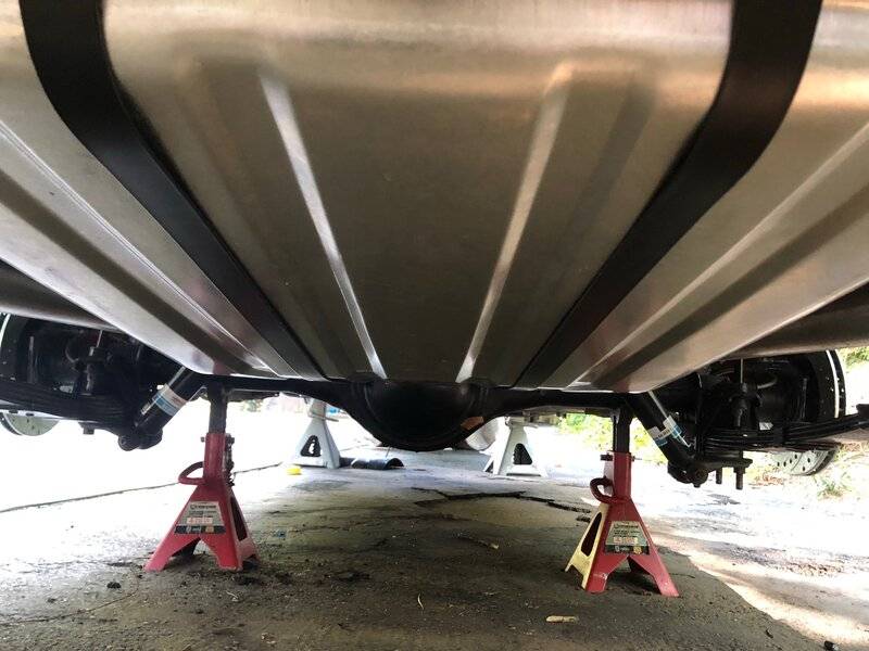

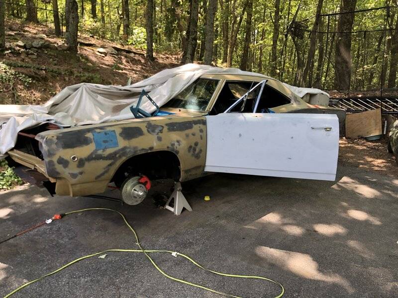

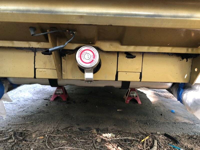

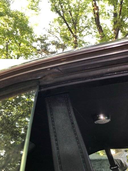

Door jamb cut in complete and (1) 20 gallon tank ready to roll. Doors go back on tomorrow. That seals the car back after now 10 months of worrying about the weather.
Antenna delete, doors back on the hinges. Long time coming and she is now dry.

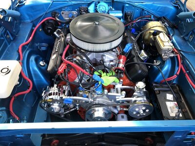

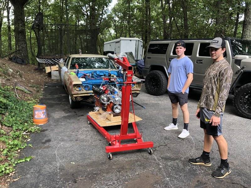

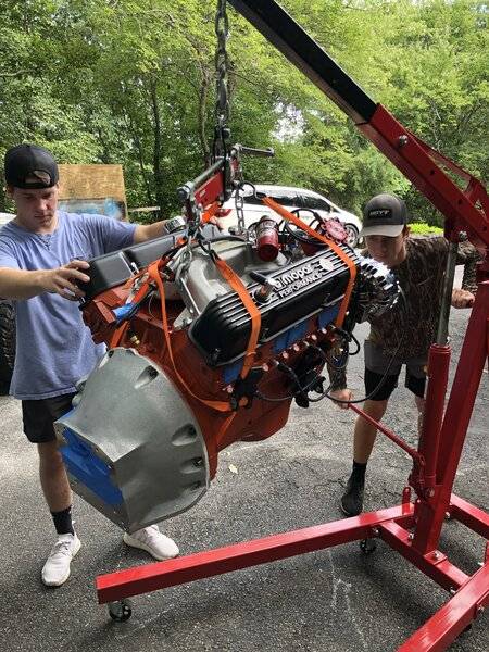

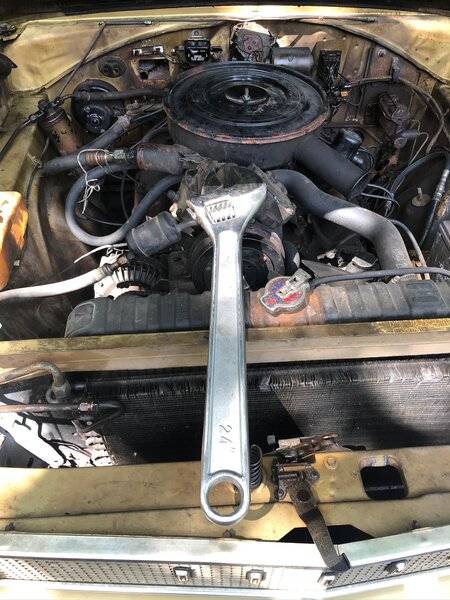

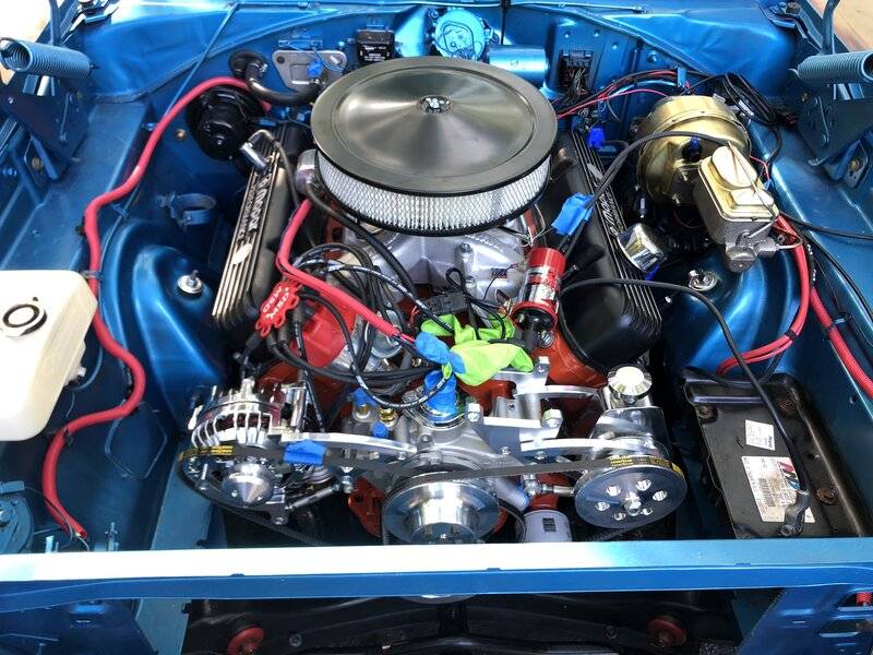

She is not done, she is not there; But (1) year to the date of delivery, she took 440 hp back on her K frame. Big milestone for my crew.
Lot of motor for a little hole. Rock and roll.

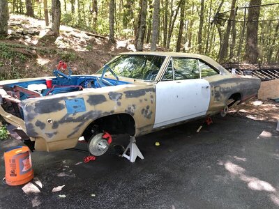

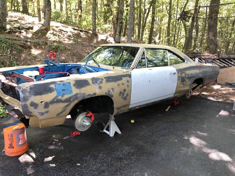

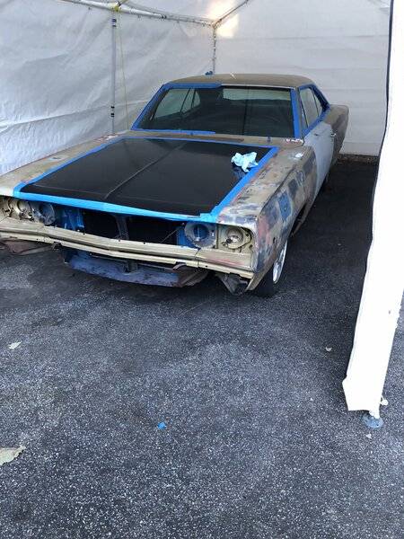

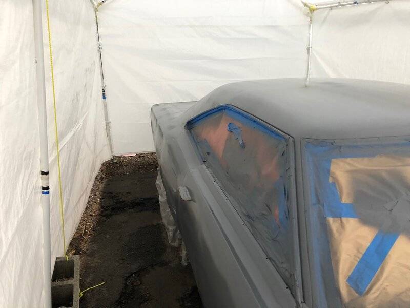

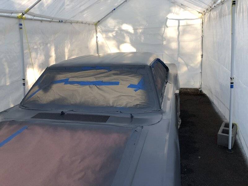

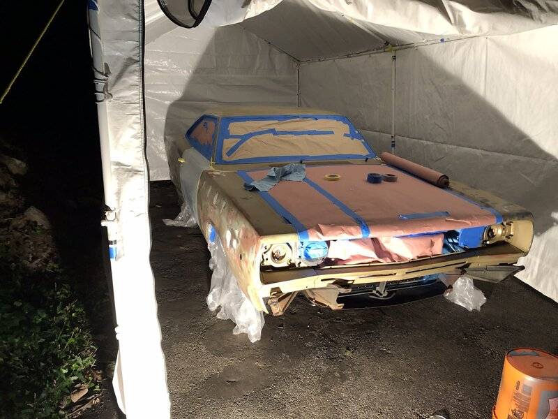

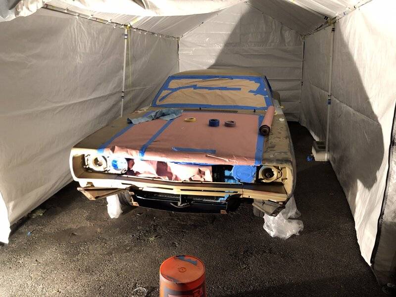

Into the paint booth. The plan is epoxy, (2) passes of high build, blocking, and then final. Sounds like 3 or 4 hard weekends.

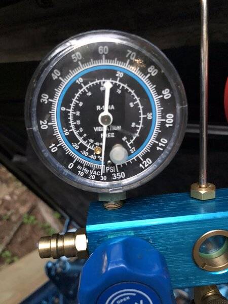

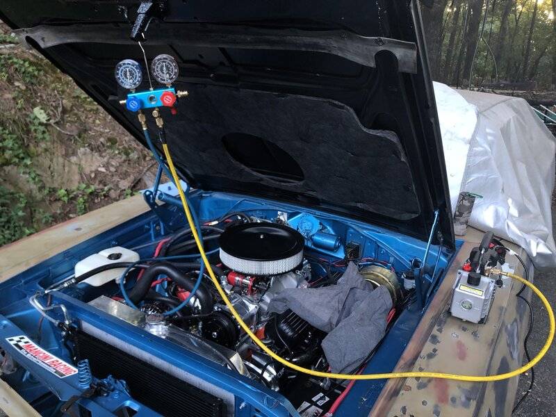

A/C hoses finally crimped and clocked. It pulled down and held on the vacuum.
EC930286-47B0-46B0-9A96-9E3CEF8B273A.jpeg 61C60CF4-90E7-4F3D-87C9-505CBE822E72.jpeg

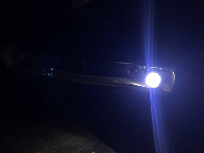

Test burn on LED’s. Trying to decide if we want to burn all (4) for low beam or stay factory and burn outside (2) low and all (4) high.

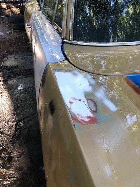

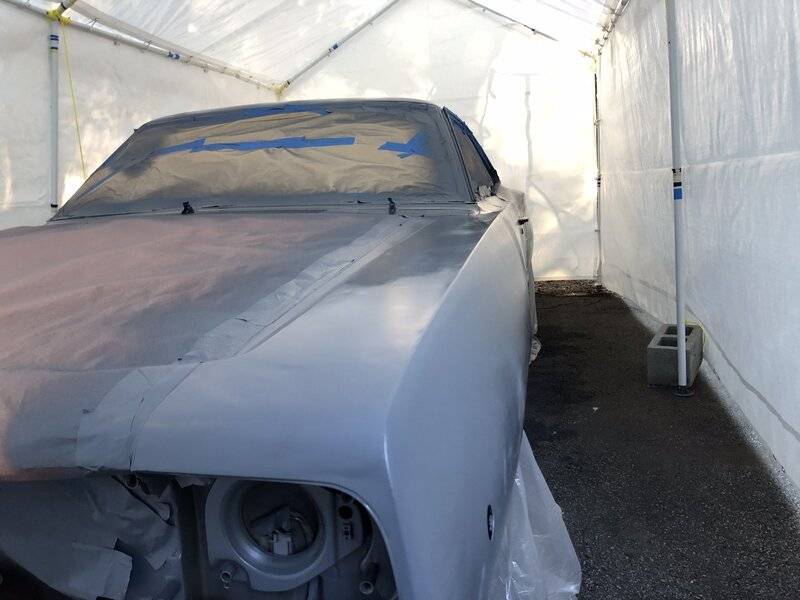

The Feral Pig is dead. She is wearing (2) coats of epoxy to bed tonight.
785986FF-34AA-4F78-B5B2-C996B3C07820.jpeg 3529F60A-96C1-460F-B05A-D15FF767DB6D.jpeg CB81E0B5-EC3D-4D3E-8283-48FBA6348A8D.jpeg

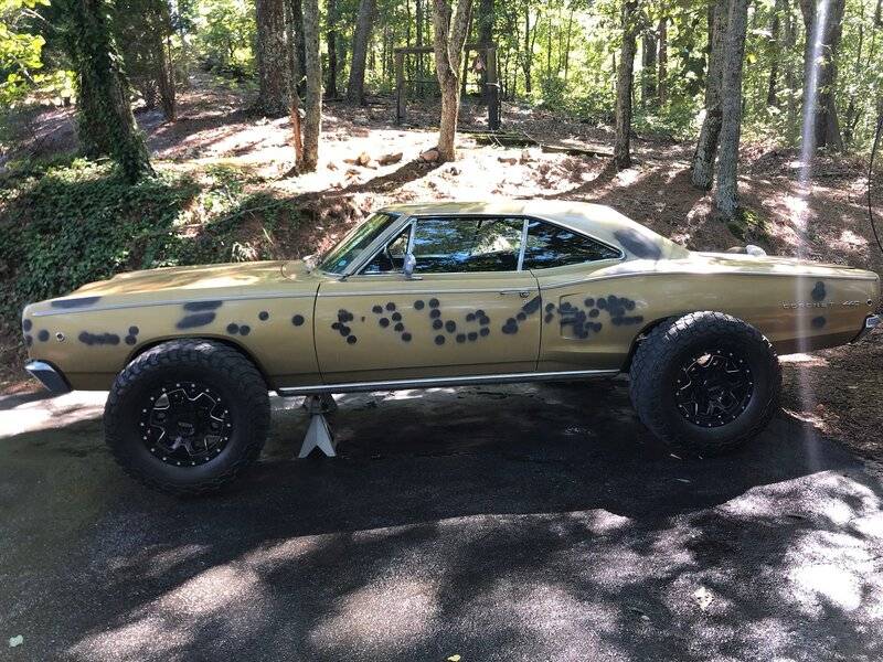

Meat has hit the ground. SST got some TKX’s inbound so it comes this week. Paint, tranny, driveshaft; 4 weeks we are driving.
