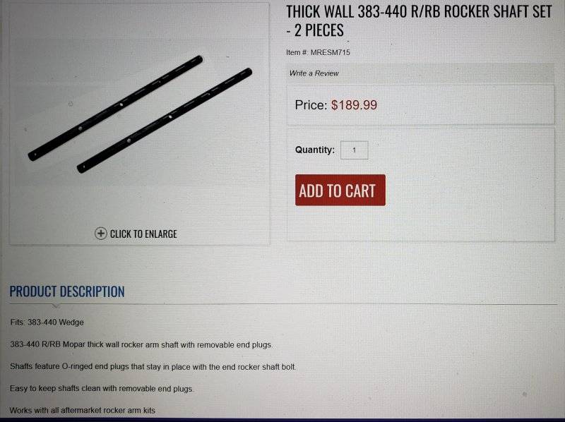

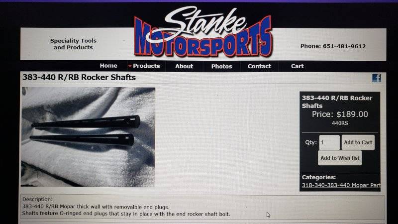

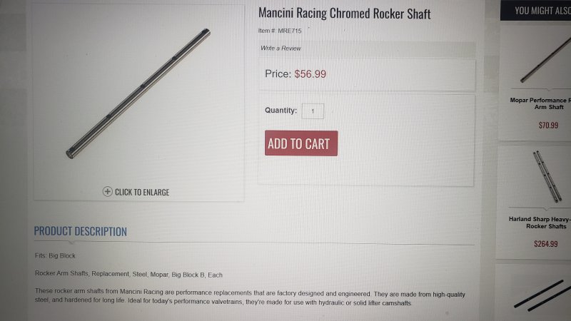

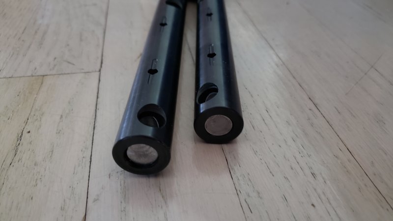

Make sure you use the Hardened shafts for the rockers! Mancini has two kinds, one is soft and one is hardened.
You need to use the hardened ones so the rockers don't gall on the shafts. I forgot who makes them but I'll try
and find a pic and post it here.
Stanke makes the good ones. The Chrome shafts are a joke! Try to run a file over the shafts to see how hard they are.
My opinion is these are a must-have!
and find a pic and post it here.View attachment 1823922View attachment 1823923View attachment 1823924View attachment 1823925
There’s no such thing as soft ones besides the same style rockers were used on the Max Wedge and the Max Wedge used the same standard shafts as the 361, 383, 413 and 426 Street Wedges did.
