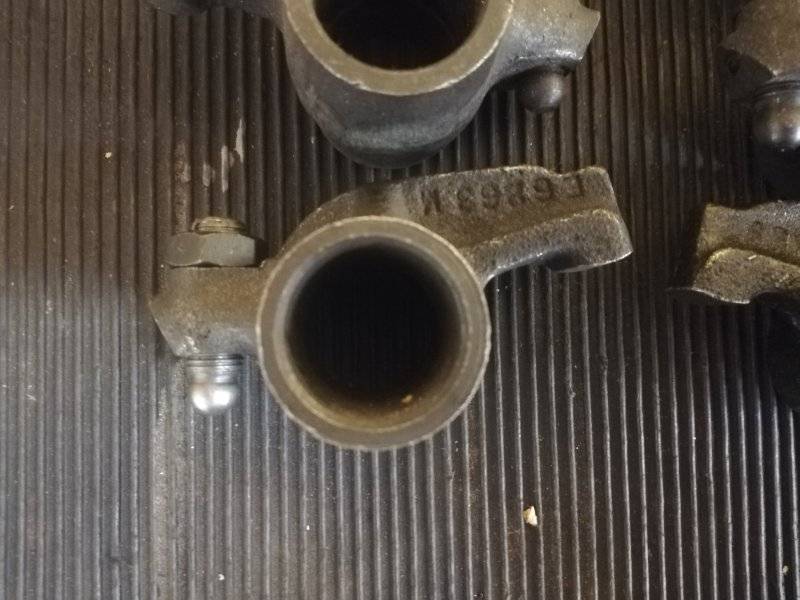

Do you know the original application for those rockers?? Are they factory or aftermarket. Not a whole lot of factory adjustables out there...... I do have some here tho, I'm going to have to look and see if I have shafts and what they measure... It would be good to know what the real clearance should be.... trying to think just where I could find that info.... maybe measure a different set??
How are you measuring? Seems odd that they would be under .875.
Mine are factory max wedge rockers.
Ah wait, you made me go out into the garage and measure again and now I noticed that the shafts had been tourqed too hard, they are egg-shaped!
(I got them as extra parts when I bought a pile of original 440 stuff.)
....well, that explains a lot.
Those look awful straight for max wedge... I have some of those too, and some others. I'll have a look at some of this stuff and report back.... Really hope were arent looking at some old 273 rockers there!!, but I'm not the greatest at just comparing by pix on sight....

Ok, a little follow up on the rocker confusion. I dug out the supposed MW factory rockers that I supposedly have.... they have the same markings as yours, identical. So, we have the same thing, whatever that is lol. I took them and tried them on some factory mid 70's plain old rocker shafts, and the ones that they came with...both .875".... They slid right on, and so did my Hughes aluminum rockers, although it was clear that the clearance was much tighter on the new aluminum ones. I think all these new .872" aftermarket shafts are really just to prevent galling on the new rockers (just a guess).
