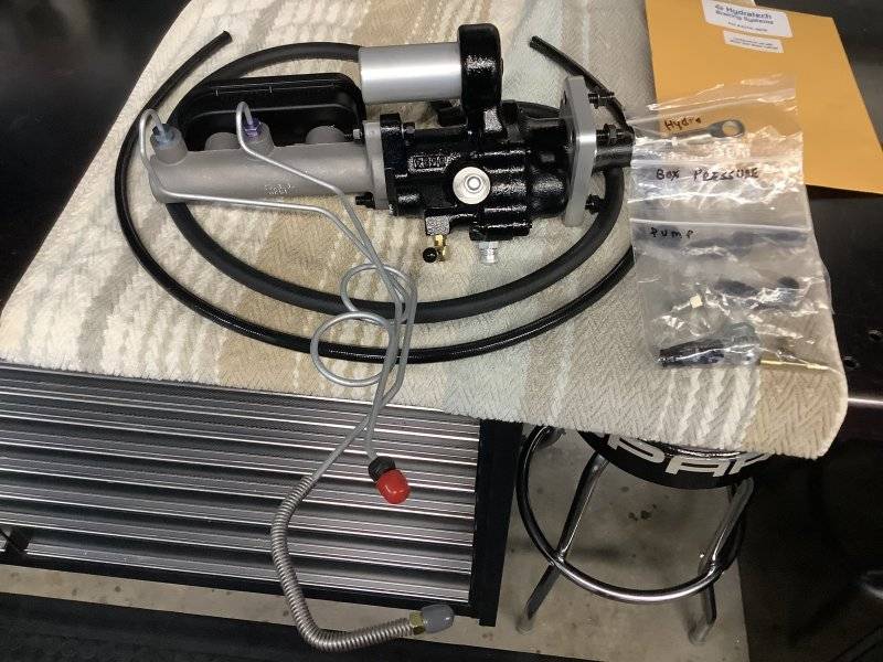

In 2022 I went through my engine and to save money, I reused a still good camshaft that produced low idle vacuum. Of course, this was inadequate to power the brakes so I tried the manual setup as I tried in 2012 and had similar findings. I switched to a Hydroboost that I got from Dr Diff for free in an agreement that I'd do the R & D of it and get to keep it free of charge. I don't know what I did wrong (if anything) because I could not get it to work and in the process of trying, I burned up 3 or 4 power steering pumps. He had me ship it to someone else and supposedly, that guy got it working in his car. I asked later about it and was only told that he got it working but I got no clear explanation as to how he did it.

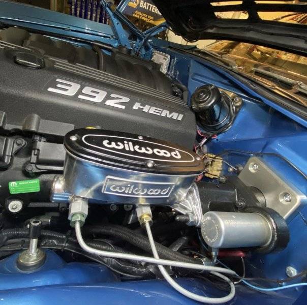

When I did the 392 Hemi swap in my ‘70 Cuda I went with hydroboost and Wilwood 6 pistons all around. By far the best braking system I’ve had on a classic Mopar. I just tweaked the front/rear prop valve and it was perfect.
