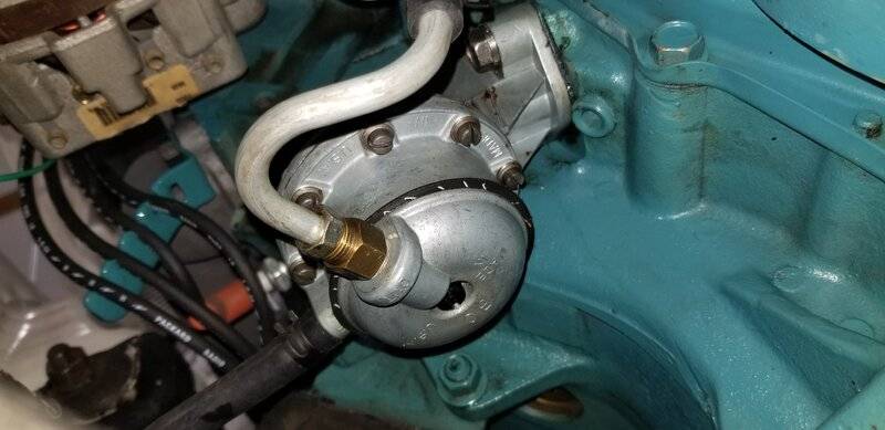

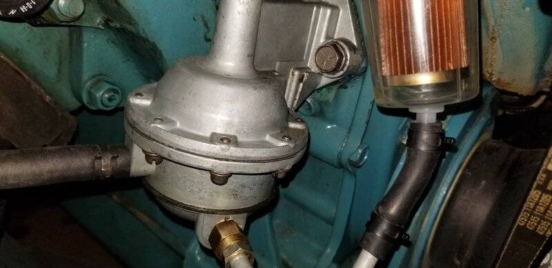

Yep, I viewed the video...talked to Tom today about finding a date coded pump for my 426...I think I'd have better luck dating the prom queen. Maybe I'll just buy a 6903 from Summit and ship it to Tom/Mike for inspection and correction if need be. I have no idea what pump I currently have and came with the car upon my purchase. Let me see if I can post a few pics of it..maybe someone can identify it.
B O stamped on bottom with Made in USA...anyone?

Couple of issues I have noticed as of late are she pulls hard up to around 70/75 then falls back....after about a week of sitting it takes forever to start...I am thinking the pump is allowing fuel to drain back towards the tank...choke works perfect, 650 AVS2, electric for now until my original AFB comes back from Arizona restored.

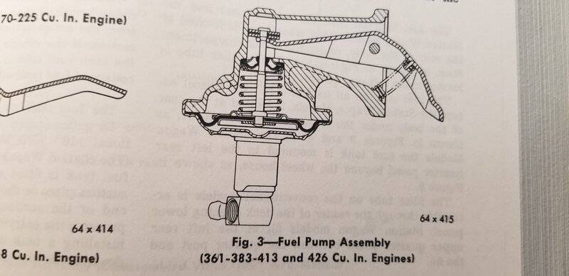

I just realized today I am looking for the wrong pump for my 64 426-S...I need an MS-3672S which is the crimped style not rebuildable or so some say.
