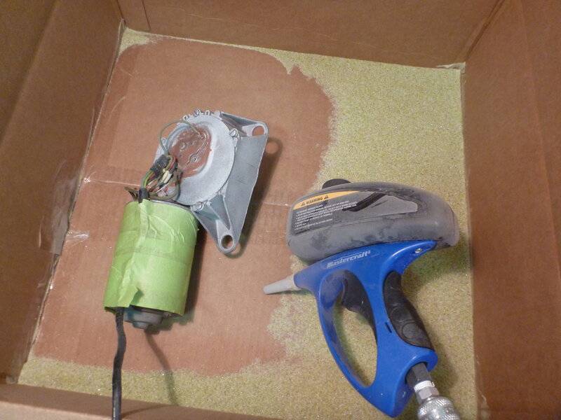

Why is blasting not an option? detailed areas aren't a warpage concern, I'd seal up what I don't want blasted & break out a pressure pot...
I like sandblasting at home. I use tarps and section off the car so I don’t fill up areas with sand that is hard to get out later. Depends on how rusty your car is though.

Blasting is my last resort. I have a hydro last set up that would work great but I can’t push my car out to work on it as I have a sloped drive way. Also the engine is in. I am not sure I would ever get all the sand out of it as well it would be a fn mess. Een using flap discs and polycarbonate discs but the intricate area where yes sb would be great are the areas I need to have some efficiency with.

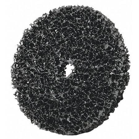

You want a crud wheel.
They're a real porus abrasive wheel. Hard to describe. But they get the paint+**** off without destroying the metal
Can you provide a link? I googled it and crud wheel is very generic.

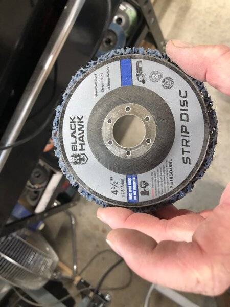

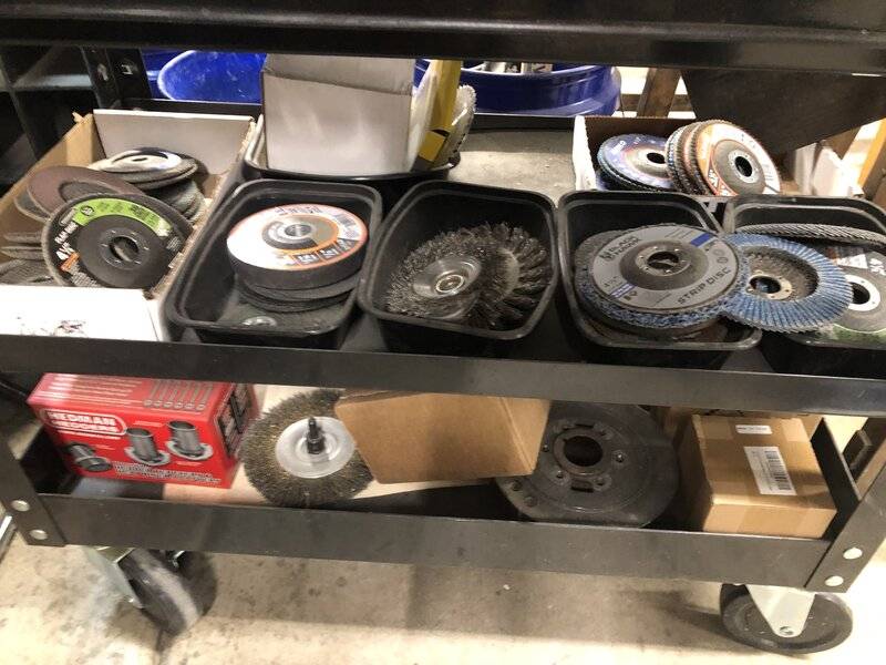

Yup been there done that. These are polycarbonates some with silicon carbide. The problem is these are dang stiff and will not bend into the area that I need. I need one that’s flexible.

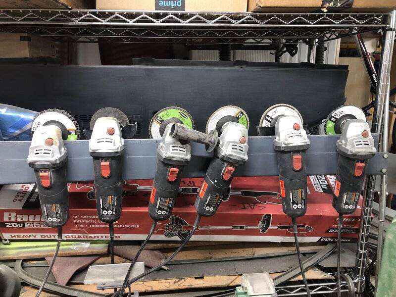

Here's where I’ve been. I got some also from HF that work well on flatter areas.
