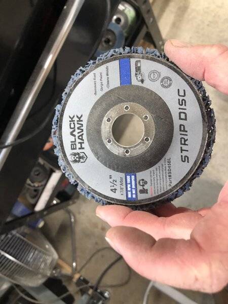

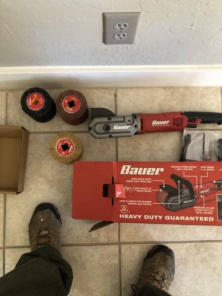

Norton used to make a stripping disk(blue in color) that I used to strip paint with an old Makita grinder/polisher, until I got the SCT Contour. The Contour is a bit pricey but it works very well and I've stripped many cars with it. Typically takes two drums (black)to do an entire car to bare metal and leaves a perfect profile on the metal.Yup been there done that. These are polycarbonates some with silicon carbide. The problem is these are dang stiff and will not bend into the area that I need. I need one that’s flexible.

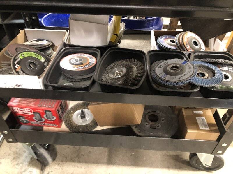

Here's where I’ve been. I got some also from HF that work well on flatter areas.

Thanks. With that larger drum how did you get in the corners and tight spots? Thats what I was after in this post. I would love to have that machine but its pricey to justify over flap and abrasive discs with angle grinders that I already have.Norton used to make a stripping disk(blue in color) that I used to strip paint with an old Makita grinder/polisher, until I got the SCT Contour. The Contour is a bit pricey but it works very well and I've stripped many cars with it. Typically takes two drums (black)to do an entire car to bare metal and leaves a perfect profile on the metal.

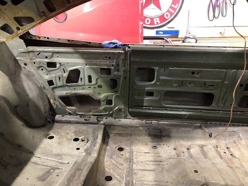

Dr. Dr. My arm hurts when I go like this…….then don’t go like that.don't get it in there? the masking it up suggestion/ idea is supposed to eliminate that........ you do have a dilemma; I have the luxury of a rotisserie, where I can spin, blow and vacuum. You have my sympathy, this **** is a pain in the ***, sometimes you have to get creative, and attempt what seems to be ridiculous. A few hours of strategic preparation can save hours of hassle later.
in the past, I have made custom hoses and attachments for the air blower and shop vac; for cleaning out rails, rockers, drops, ect

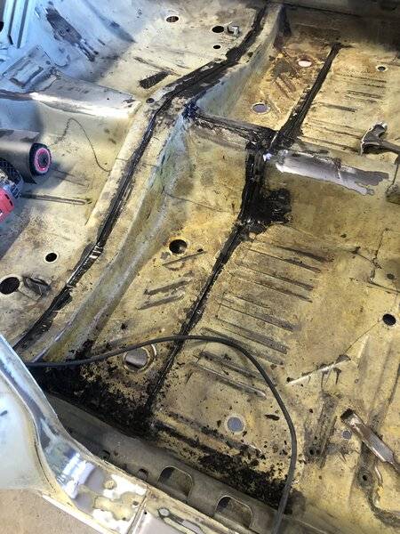

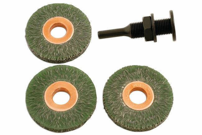

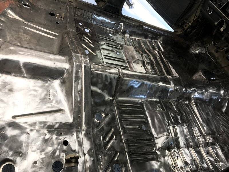

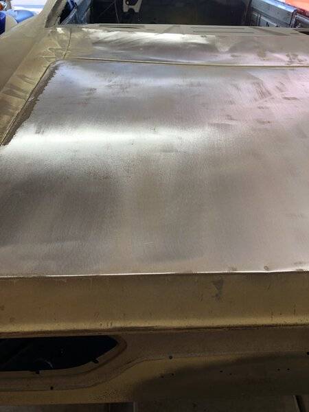

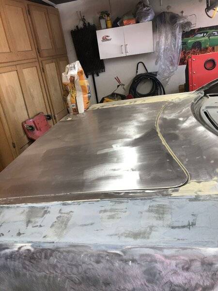

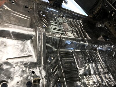

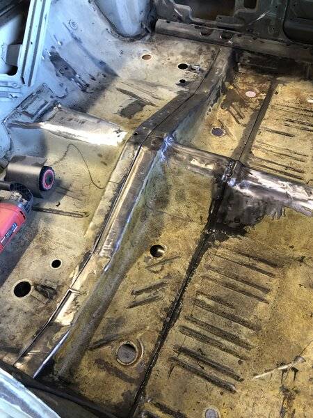

Well done! I know how much work that was to do! Is the surface have enough tooth structure from a wire wheel? Normally epoxy needs a 180 grit or so for a good bite….??Wire wheeled this whole thing. I used a DeWalt 4" cutoff grinder with HF wire wheels both Cup wheels and Radial wheels plus some of the 3M nylon wheels. I did the detail work with small wire brush wheels and cup wheels in a drill. The trick with the drill is to find one that does 3000 RPM....not 1800 RPM. I found a cheap HF drill that did the trick. And as someone mentioned above....you can reverse the drill and the wire wheel acts like a new one again. Definitely wear a face shield and safety glasses if using the 4" cutoff grinder....and I wore welding gloves and a heavy shirt/coat. When those wires come off at the RPM's the cutoff wheels run at...they tend to want to stick into things.
