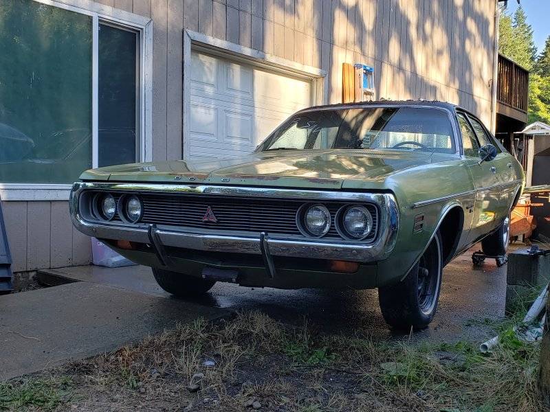

Me at 16(ish) with the original Coronet

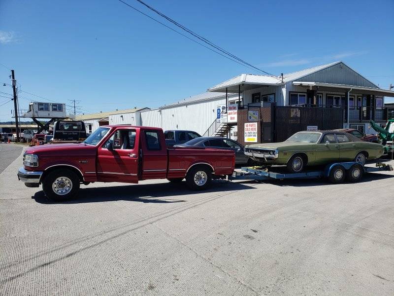

me towing the car from the wrecking yard I rescued it from
the car after its first wash

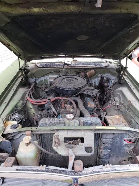

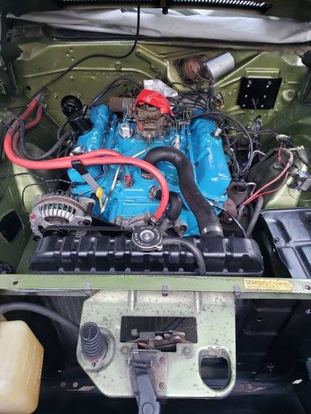

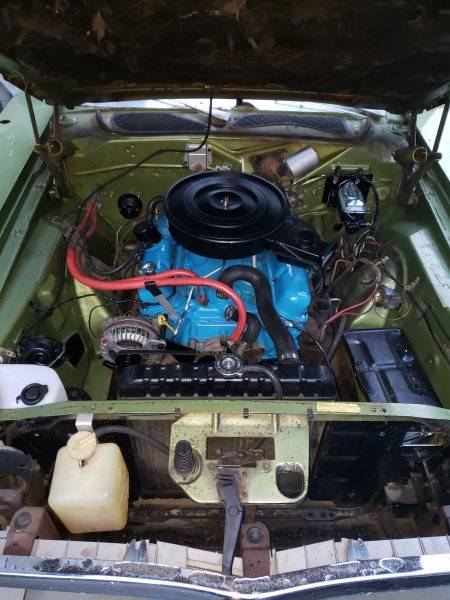

engine bay as bought and current

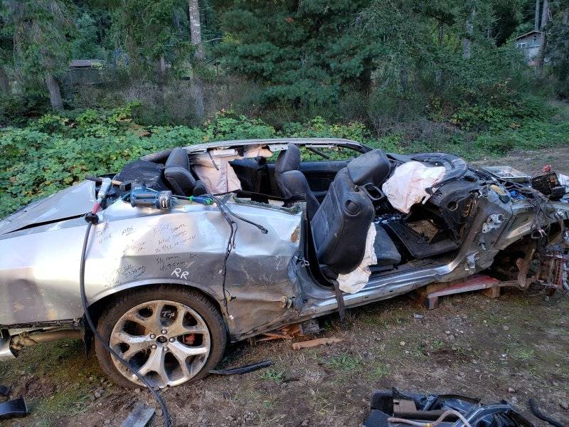

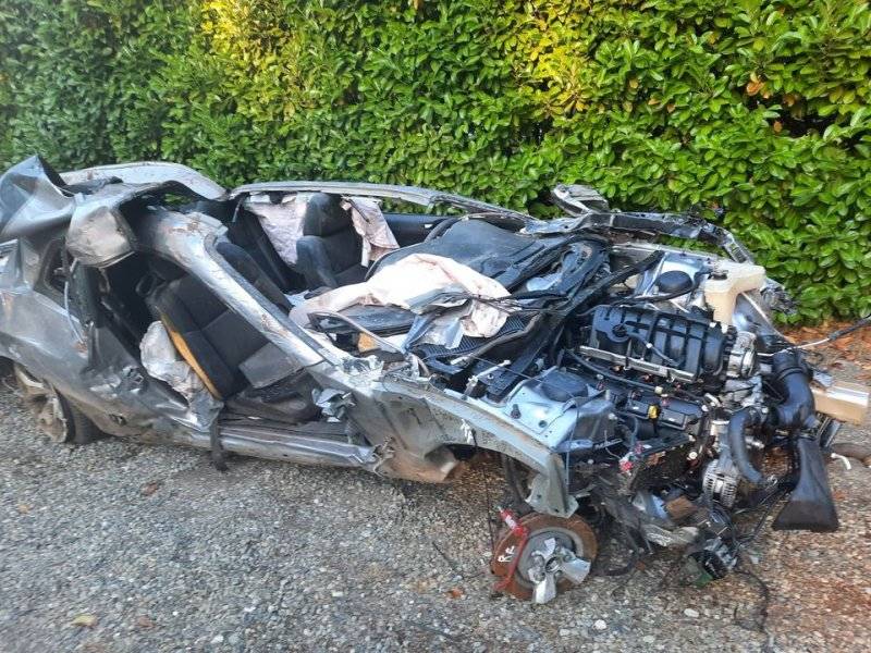

the Challenger donor

Welcome aboard. Nice story and background info. I am sure you will succeed with your skills. Best of luck with your toys. Man, that Challenger was one hell of a wreck! It's amazing anyone survived at all!
In over 40 years of working on cars and climbing around in wrecking yards, it's one of the worse I've ever seen anyone survive. I was sort of amazed by the minimal damage to the engine as well. Not a mark on the front pulley, one little chunk out of the corner of the passenger valve cover, belt tensioner broke, and intake boot torn is all I can see. PCM/wiring all look good.

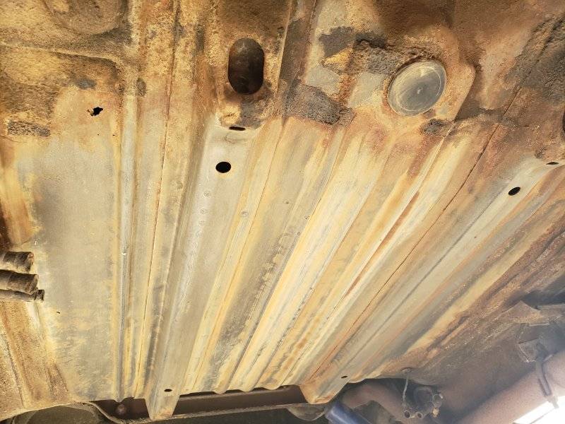

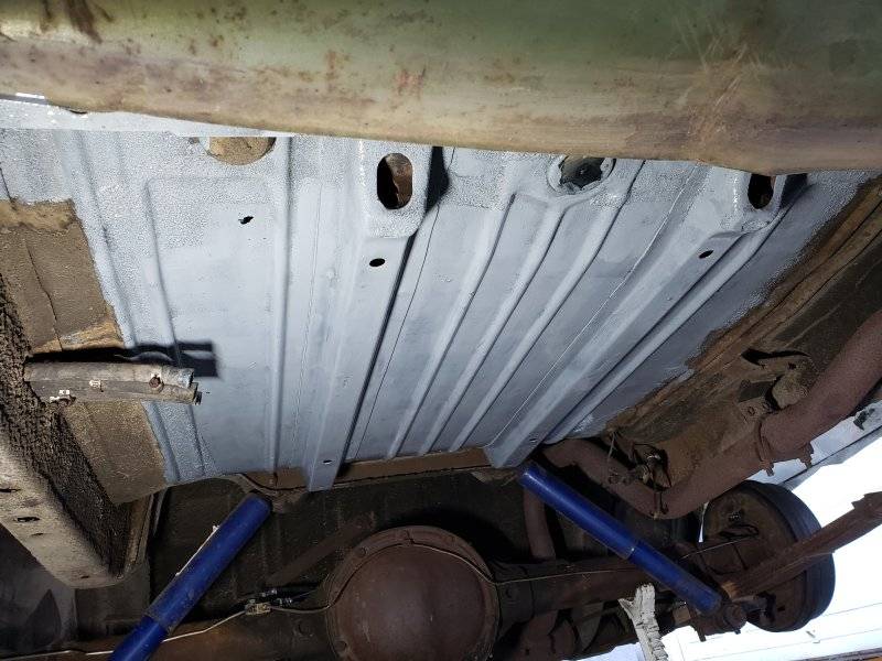

Been busily working on the car when we've had decent weather the last week. Got the brake master cylinder and the lines from the junctions back in place and today was clean and POR-15 where the fuel tank lives. The area is in pretty decent shape but it isn't body color so apparently Dodge didn't paint any more than primer? Or maybe the underbody wasn't painted the same color? The rest is heavily undercoated so I can't really tell.

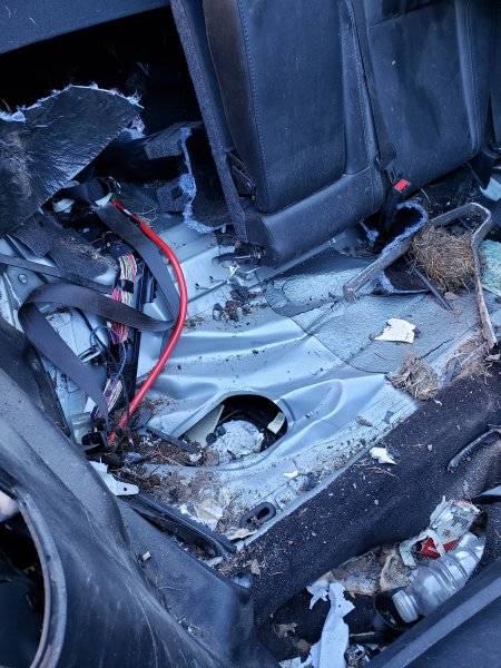

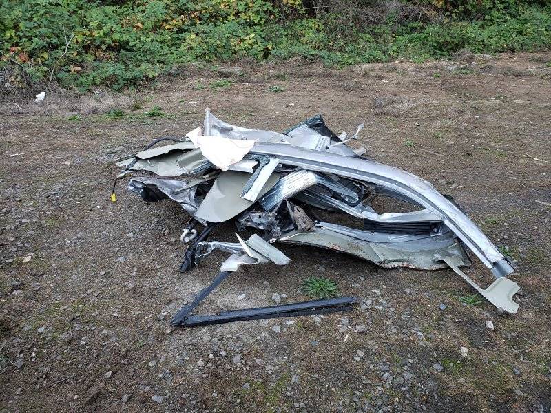

Also been busy tearing apart the Challenger, nothing (and I do mean absolutely nothing) on the body is worth saving, so it's just a death wheel/sawzall job for the most part. I'm mostly getting interior out first so I can get to the floor pan. Pretty certain I'll need to cut some of it loose for engine/trans removal, and I'm going to try and salvage the trans tunnel (though it is bent), might possibly be useful for fabricating the tunnel in the Coronet. I got the remains of the center portion of the roof cut off and the passenger outside from the dash to the C pillar off, and the remaining (drivers) door off. Once that was done I have most of the rear seat out (surprisingly minimal damage), the last piece of that needs the drivers outside roof section moved so it isn't trapped. Porta-power time!
Keep all of the spaghetti plus the connectors. Fasteners, clips, lines, body plugs, wiring boots etc.
Oh the wiring is being marked and treated very gently as I remove it. That's one of the biggest reasons to buy a complete car, those harnesses are NOT cheap. I'm also keeping all the nuts/bolts/clips/boots/etc from everything removed. Even if I don't use them on the Coronet, other projects might use them.
Of course, this is why I have bins of this sort of stuff after 40+ years of doing car stuff... :lol:

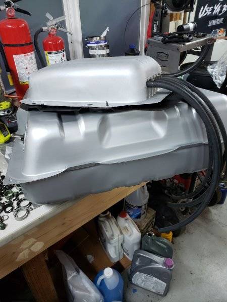

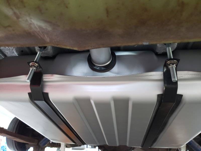

Ok progress over the last week or so has been spotty, as it's shifted to the usual October-June rainy season here in the Pacific NorthWet, but I have gotten a few things accomplished. New fuel tank was prepped, evap tank in the rear fenderwell was removed, cleaned up, painted and all new hoses, fuel tank and evap tank installed. Rear brakes readjusted (I like them up tight when bleeding a new system), stock wheels are back on for now, and car is back on the ground. Got the electrical pieces back in the engine bay and hooked up that I'd taken out to paint, got the oil changed, and refitted the air cleaner. All that's left before the first real run of the engine (I fired it back when I first got it very briefly) is some vacuum lines I'm going to replace, and replacing the fusible link with an inline fuse since it's in rough shape.

Engine bay as bought and current
New fuel tank and evap tank with new lines in place...
