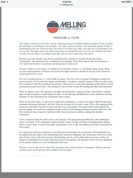

Not sure... But here is a nice read on pressure vs. flow:thumbsup:
