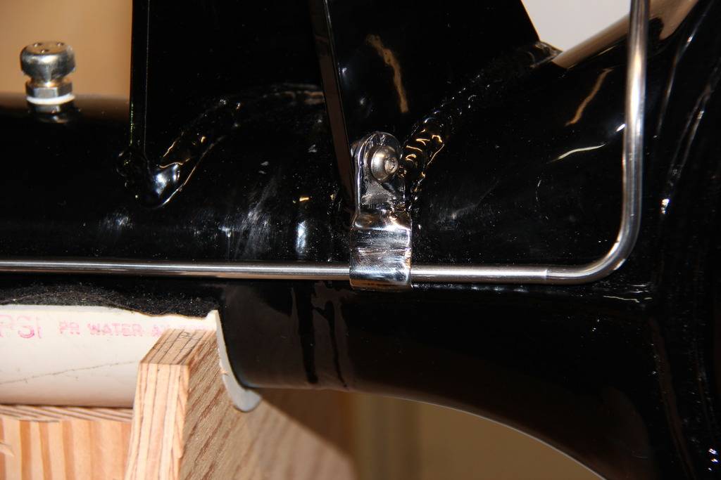

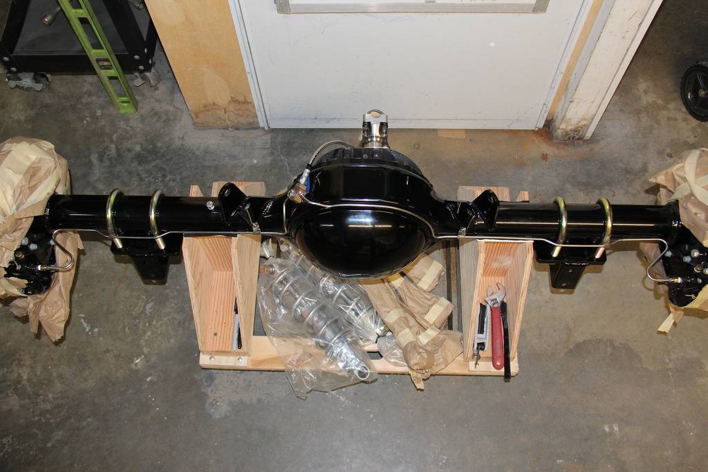

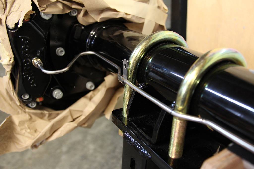

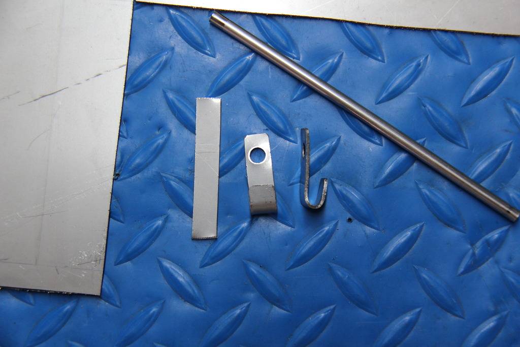

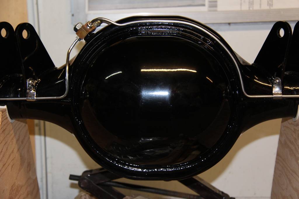

Ok this is the last of the pluming work (for now ;-)Before I put all the tubing tools away I bent up the rear brake lines. As therear has no brake line clips I made 2 weld on S/S straps to go on the U boltsand 2 S/S clips that I drilled and taped onto one of the 4 link mounts.
Thanks
Pat
Are those fixed calipers or floating?

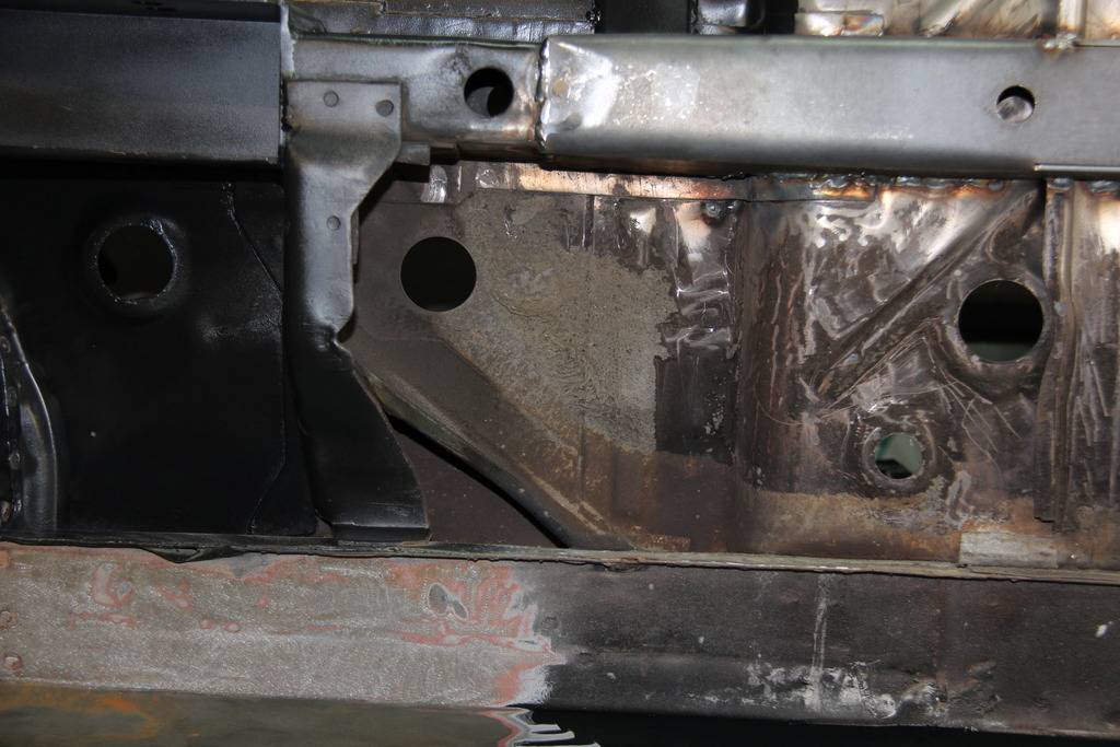

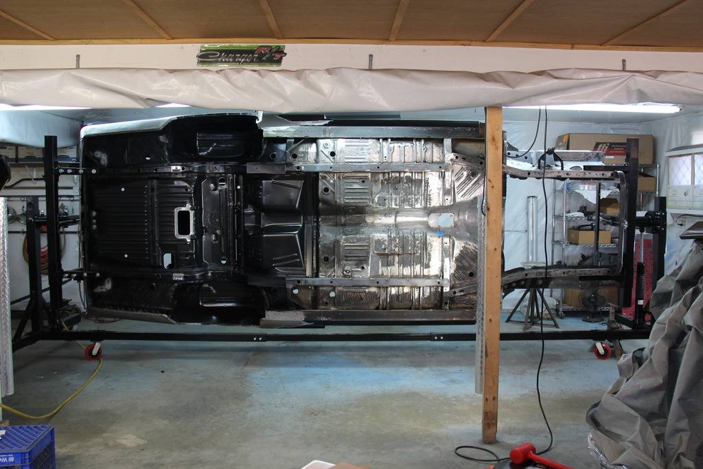

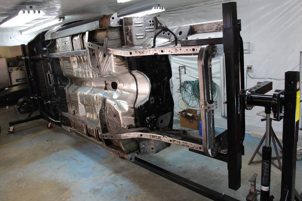

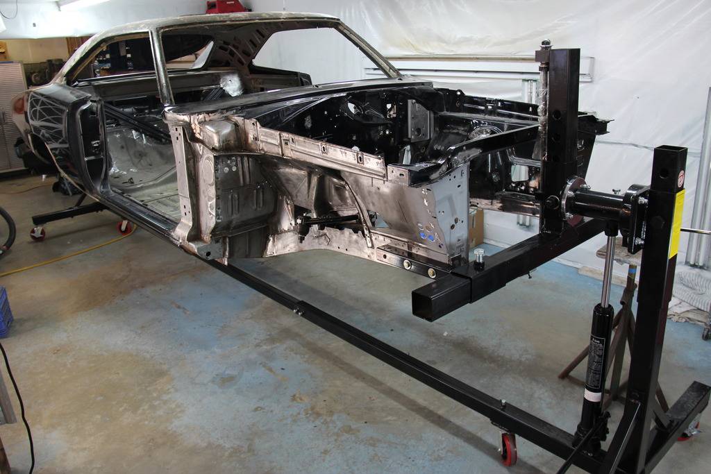

I put the charger on the rotisserie so I can finish thebottom and prime it. I also have a small floor repair.
Thanks
Pat

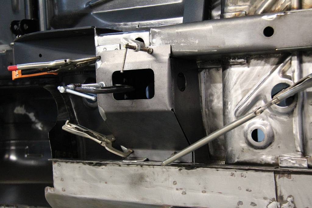

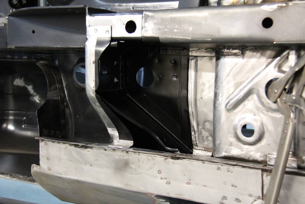

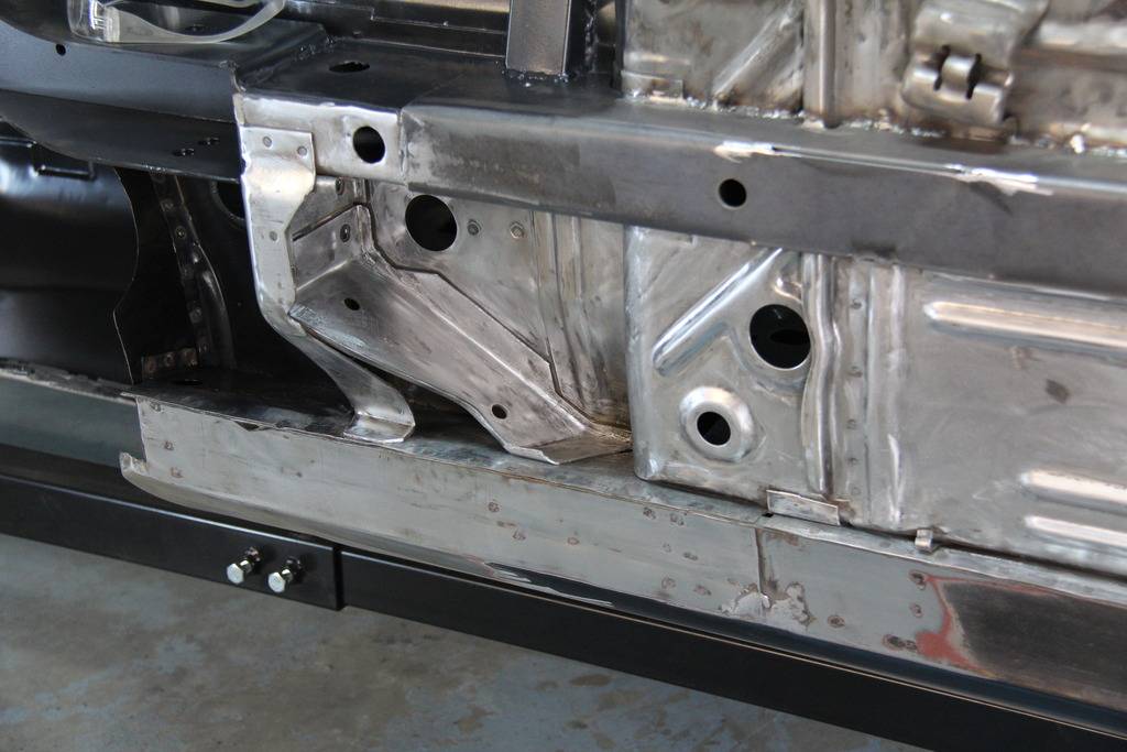

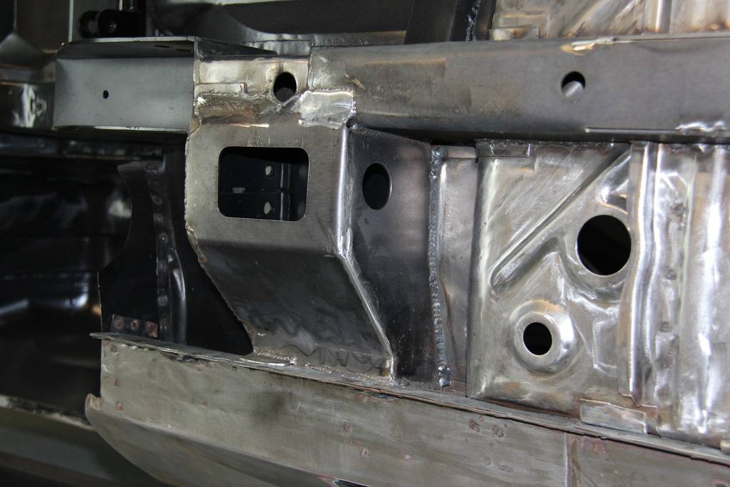

Started installing the torque boxes and have the leftaft welded in. The US Car Tool boxes fit nice and only need a littleadjustment. I added a 1 ½” hole for a future rear brake vent.
Thanks
Pat

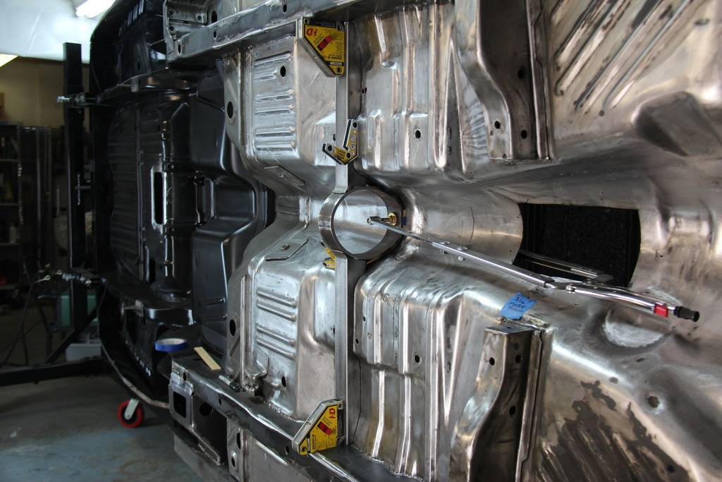

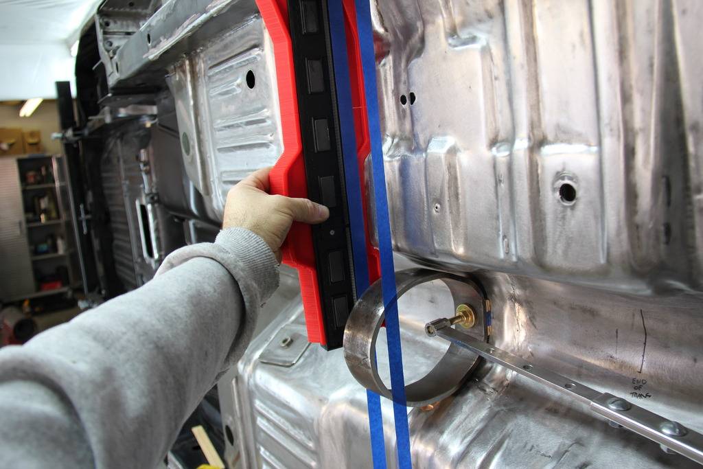

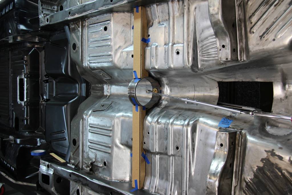

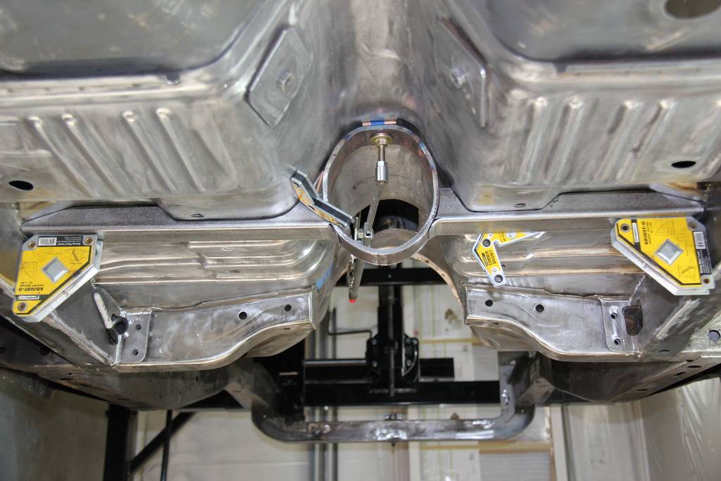

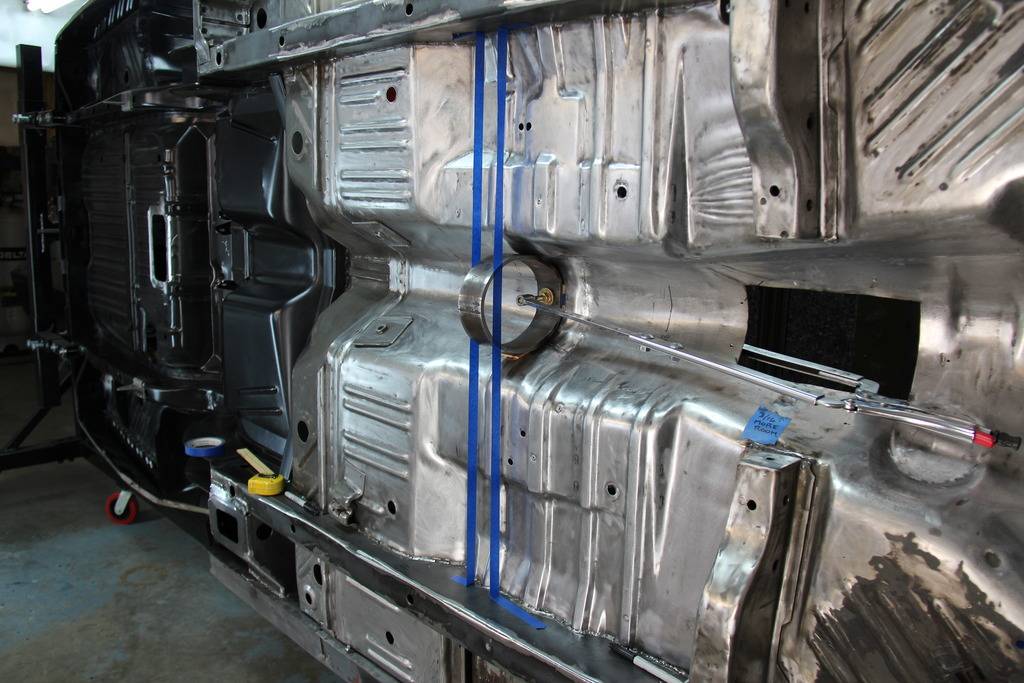

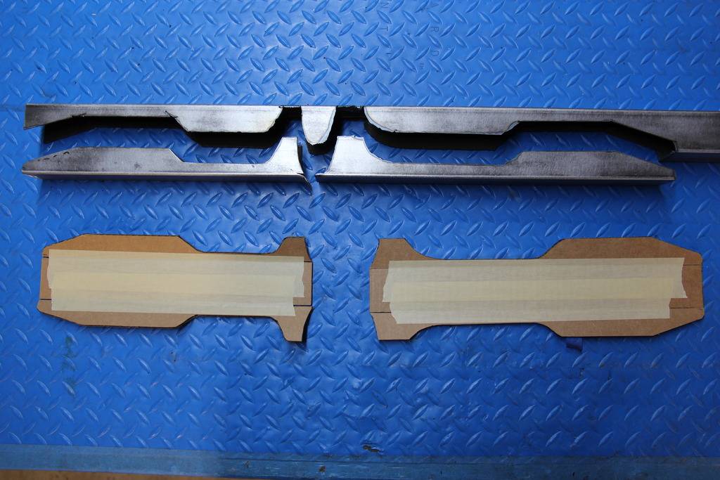

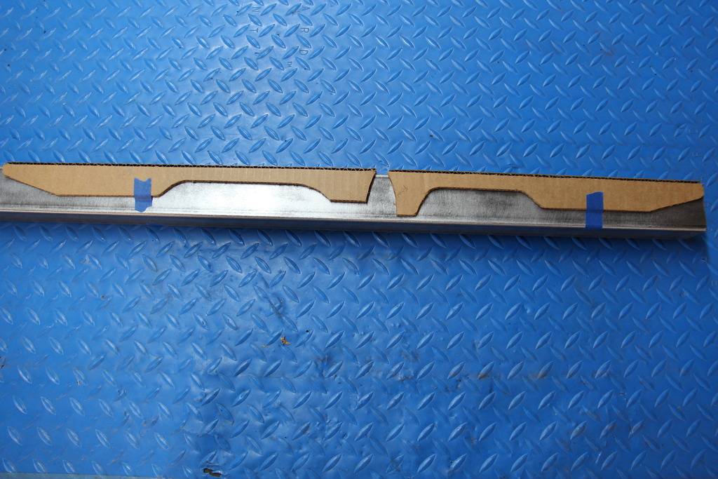

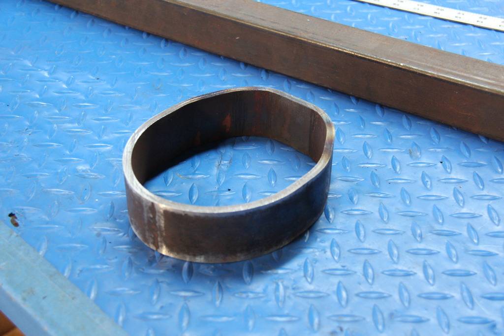

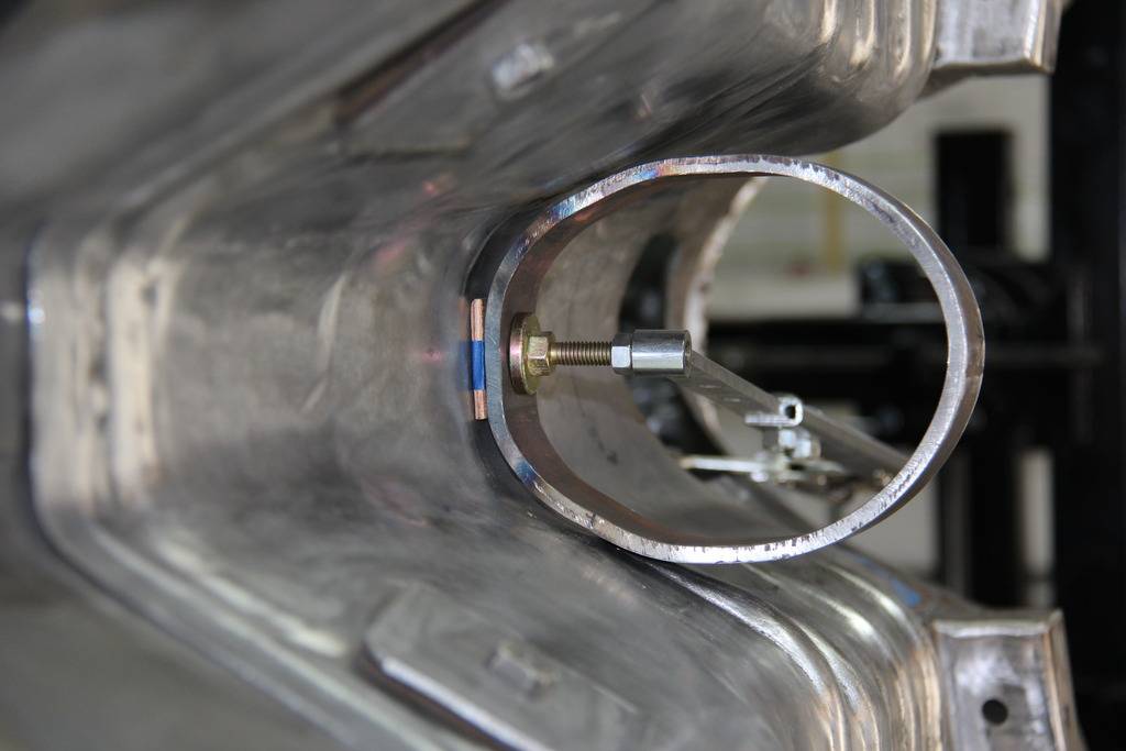

I started on the driveshaft loop/crossmember today. Using apress I oval a 2” section of 6” pipe and hammered the top half to match theshape of the driveshaft tunnel. With the loop clamped in place and using a 15”contour gauge (a must have tool) I made two cardboard pattern for the crossmember.With the cardboard center section of each pattern as wide as the square tubing(2”) I was able to lay it over the tubing to get a precise line to cut with theplasma cutter. I still need to make the pattern for inside the tunnel above theloop before I can weld it to the floor.
Thanks
Pat
Great looking work going to be a beautiful car when done
Love the way you built that driveshaft loop, super nice! Love the Dogs too.
Incredible fabrication work as usual! What are you using to clean up the floor pans prior to priming them?
That's some great work. Tell the helpers there doing a great job.
