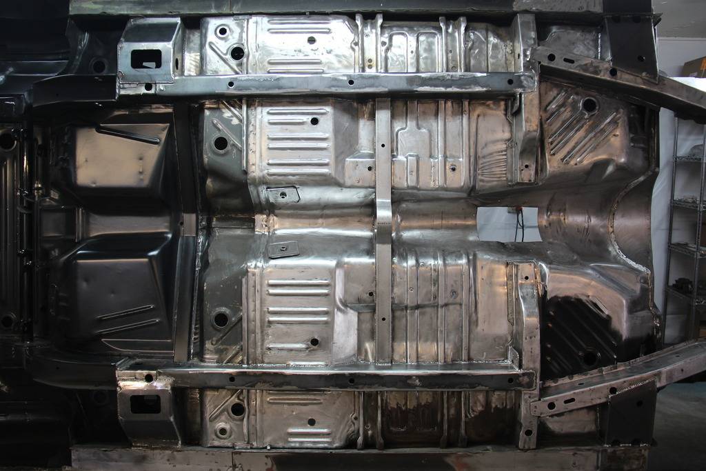

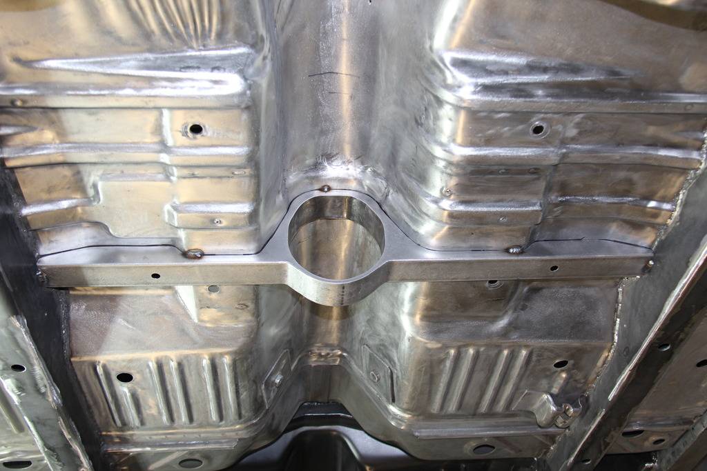

Incredible fabrication work as usual! What are you using to clean up the floor pans prior to priming them?
I use a heat gun and a putty knife to remove the factory under coat and wipe off the leftover under coat with lacquer thinner. Then I use a 6" & 3" DA sand with 100g paper to remove the factory paint.

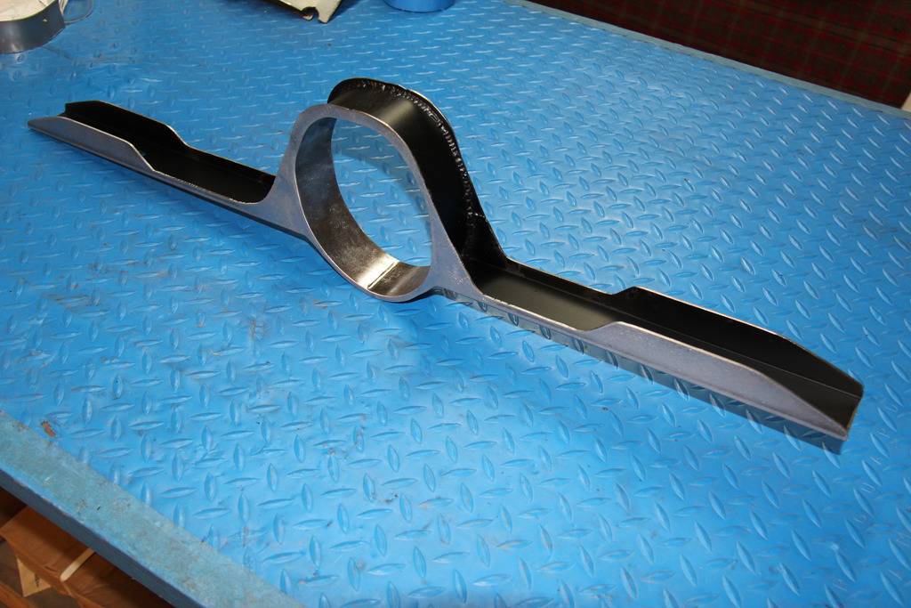

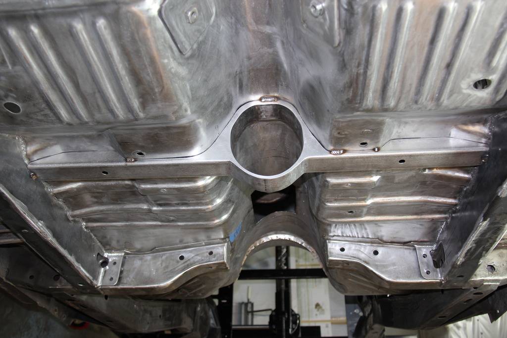

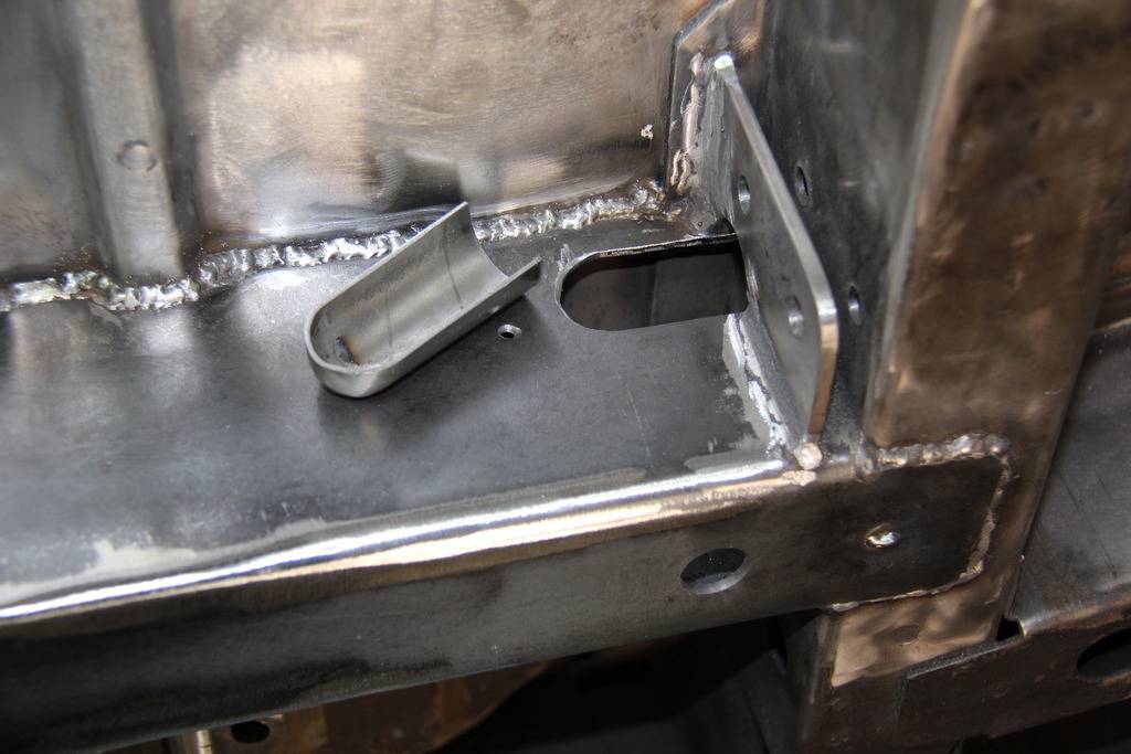

The drive shaft loop/crossmember is made and tack welded in place. Back to thetorque boxes.

People wonder why some hot rods cost hundreds of thousands of dollars ... that hoop is probably worth $600. in labor !!
What are you spraying on there that won't burn off when you weld near it ???

Thank you, but I'm just a shop nut that likes working on old cars!
Pat
The time can add up quickly, Good thing I'm not paying someone to build this car I couldn't afford the labor ;-)
The paint is just black primer set back 1/8". I will follow it up with some internal frame coating after the welding.

Some TIG welding here and there but the loop/crossmember is all MIG welded. The key to welding is good penetration and contact. You can make any good but ugly weld look nice with a 60 grit grinder ;-)

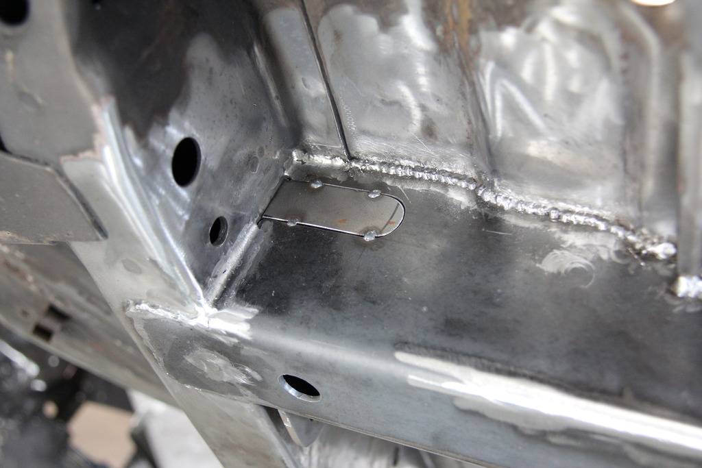

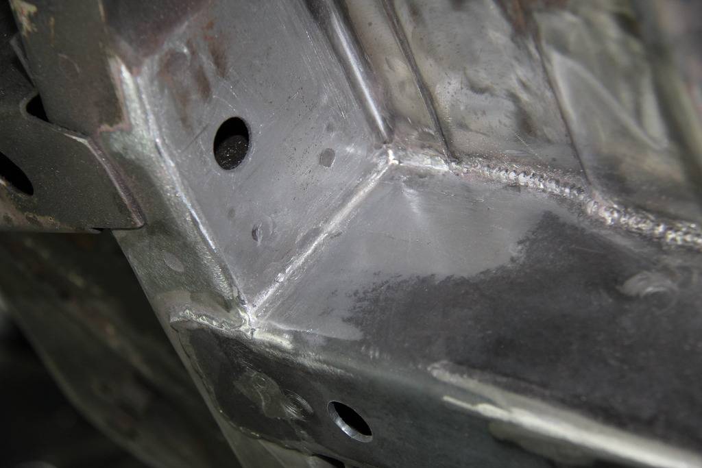

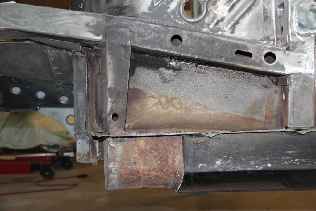

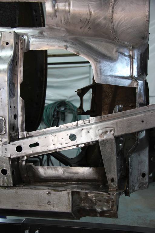

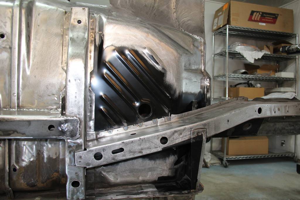

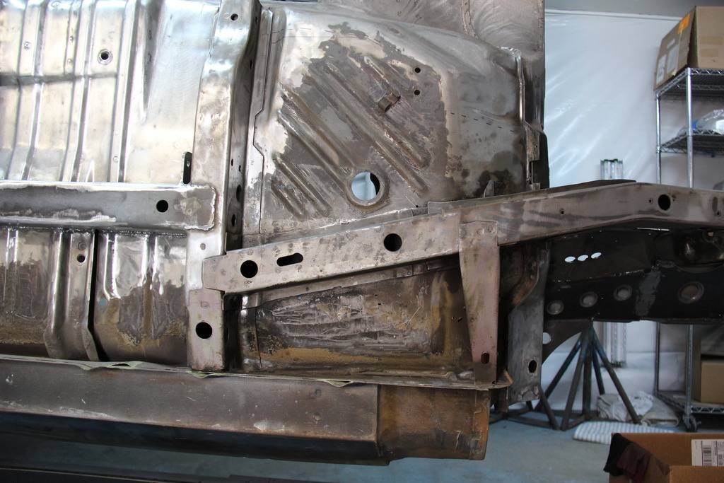

Finished up a few details on the front of the frameconnectors today. Front torque boxes are next.
Thanks
Pat

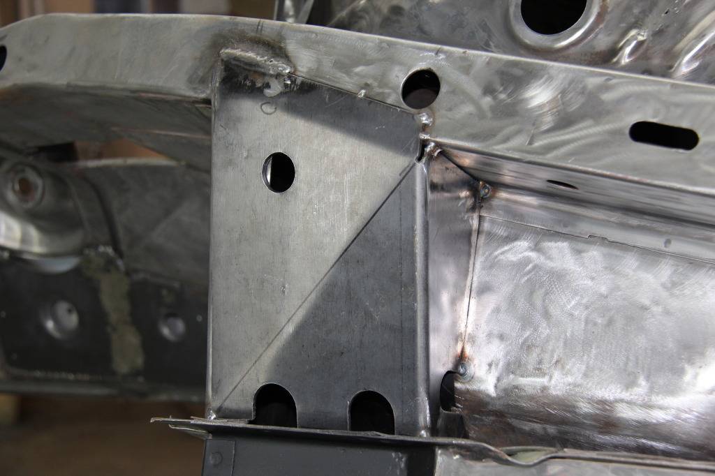

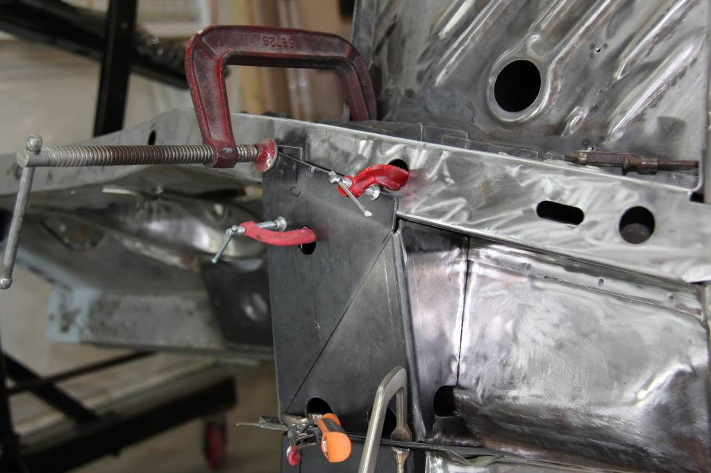

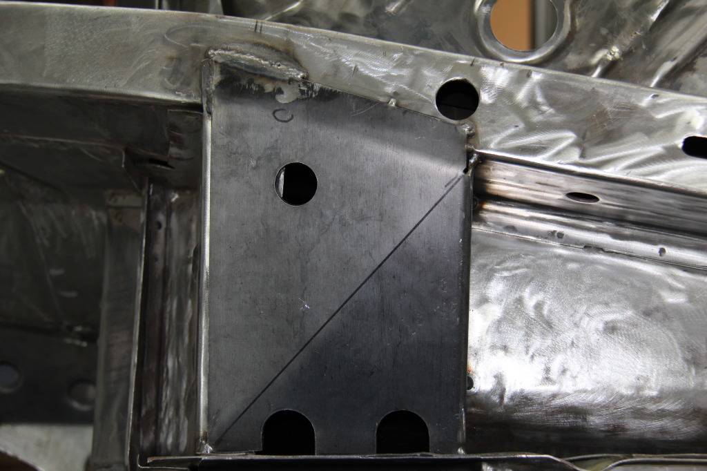

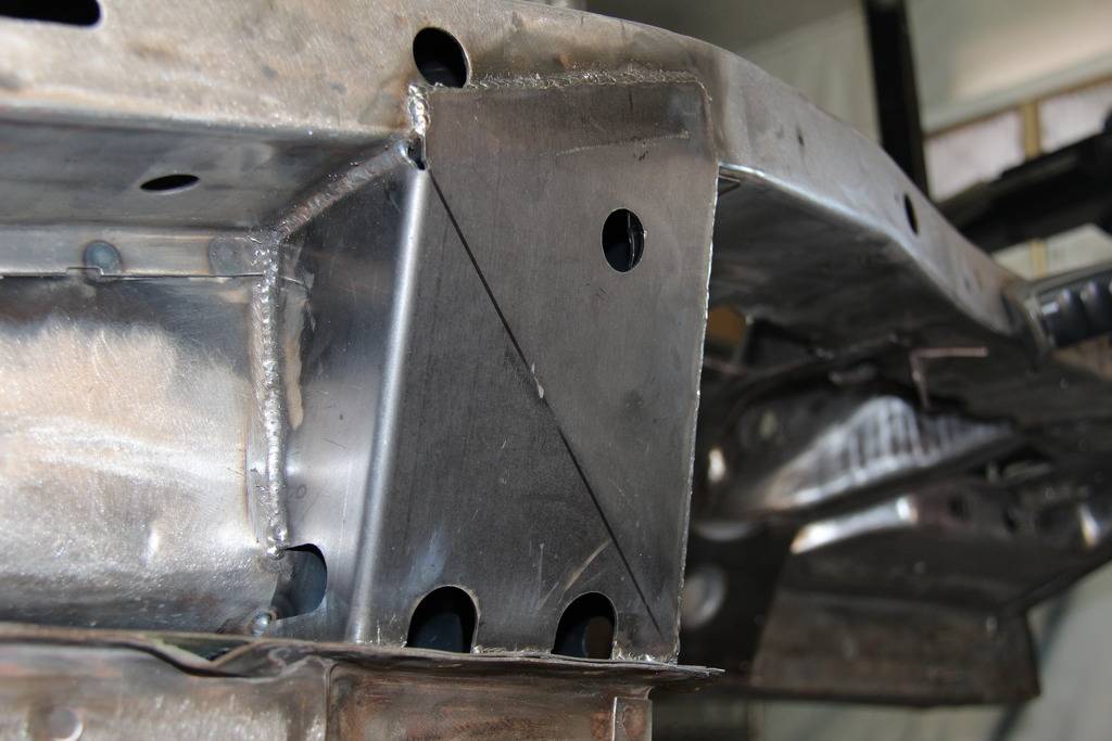

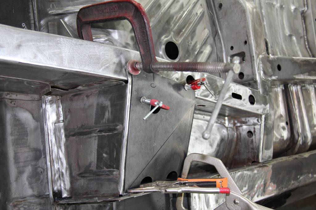

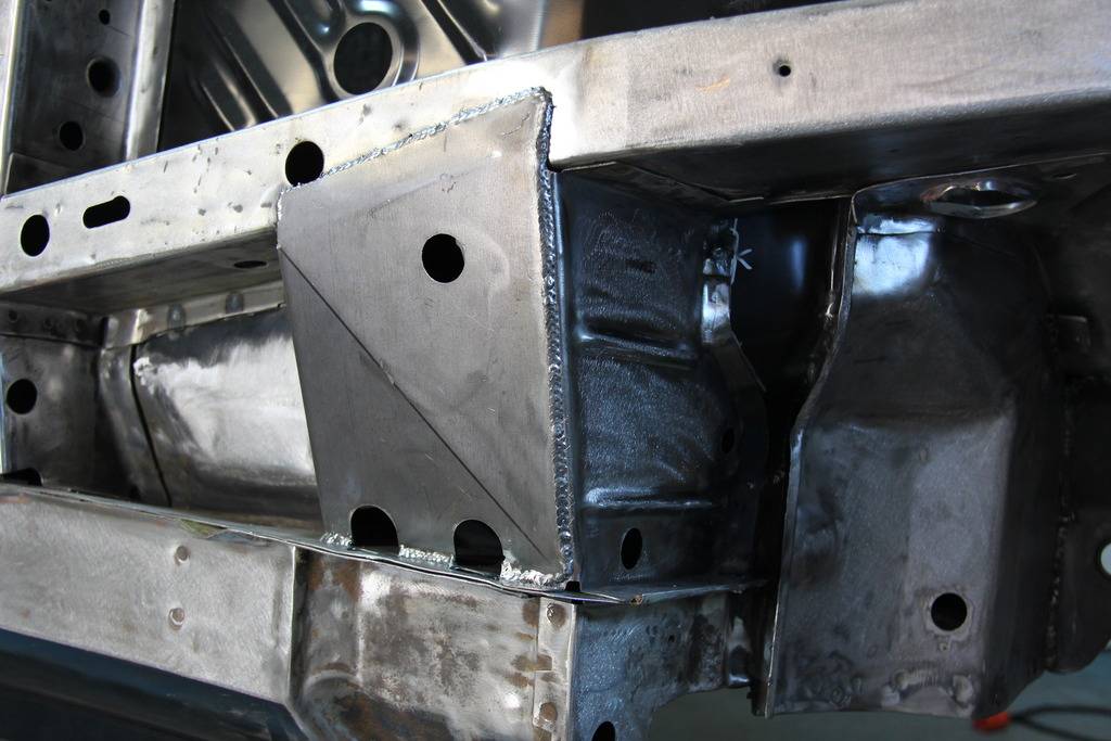

Fit and tack welded the right front torque box. Had tobend the US Car Tool torque box on an angle and added ¼” along the floor sideto get a good fit. Both sides will need the same alteration to fit correctly.
Thanks
Pat

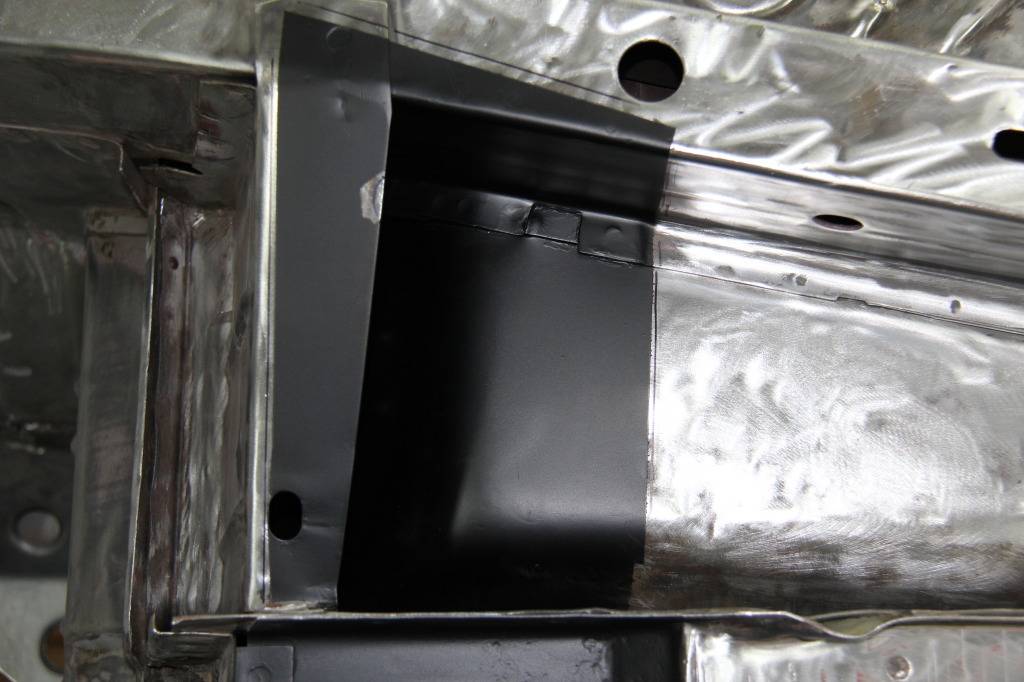

Nice! Some of the inside paint will burn after welding, are you planing on painting again inside the boxes? I painted my subframe connectors inside before mounting them, then I sprayed with a 360 nozzle on a hose thru the holes after welding, cant see the results but I hope I covered the welds. Do you use a weld thru primer?
It's to be expected that you'll burn some paint I tried to tape back 3/8 to 1/2" anticipating some burning. Before the final paint on the bottom is applied we will coat the inside of all of the frames.

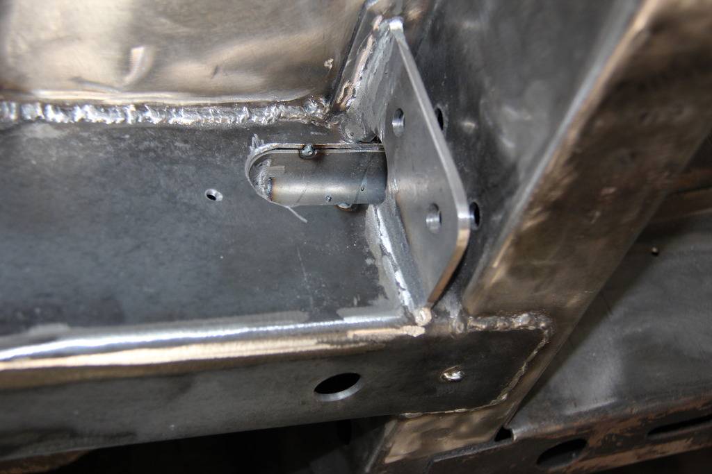

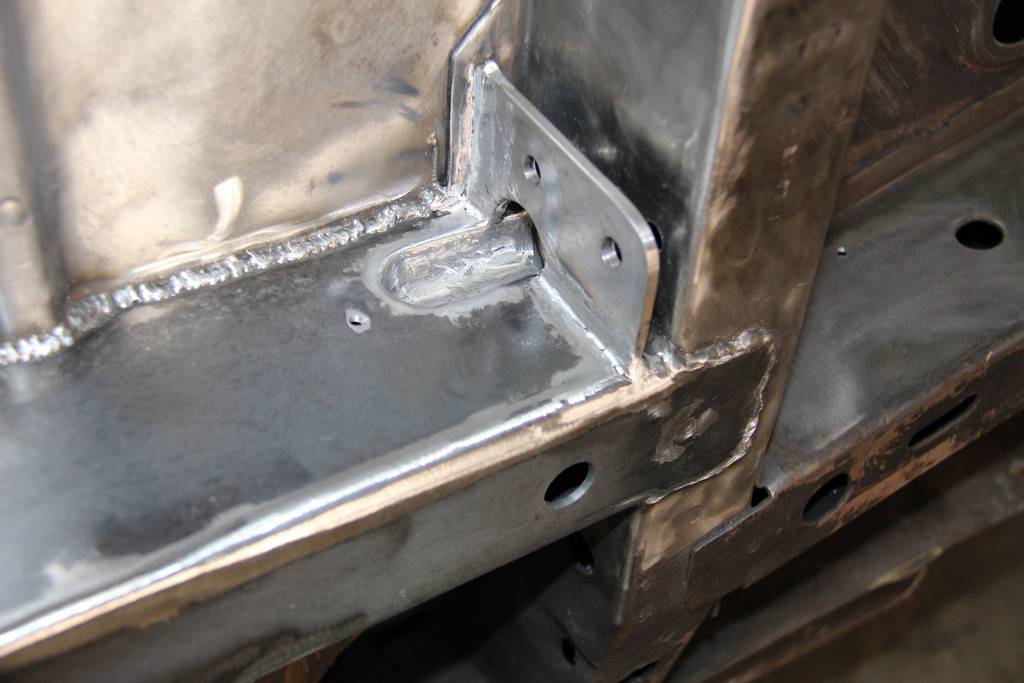

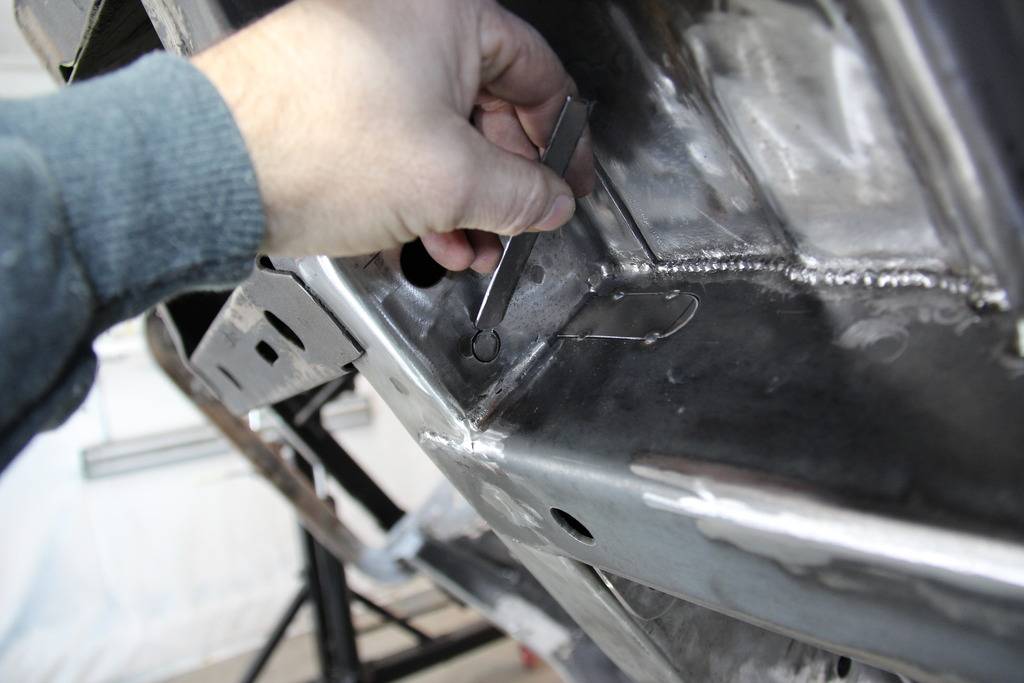

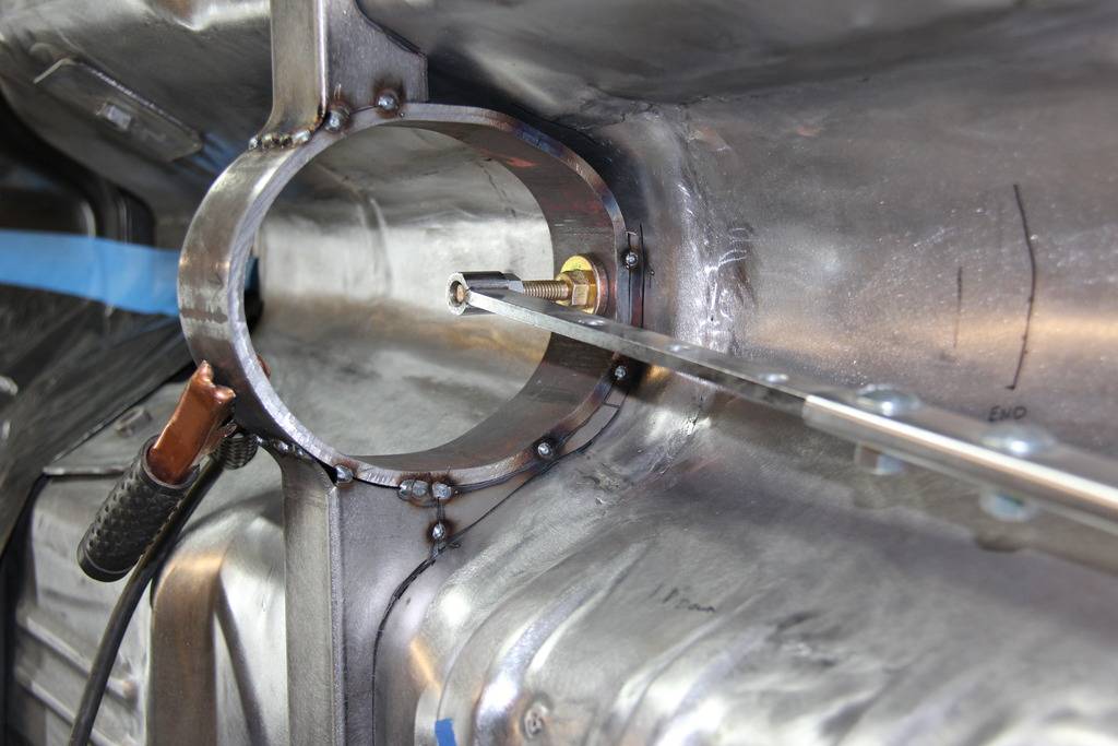

Installed the parking brake cable pass-through tube inthe frame connector. I also remove the original floor mount for the parkingcable as I’m going to install a small roller to redirect the cable along theframe.
Thanks

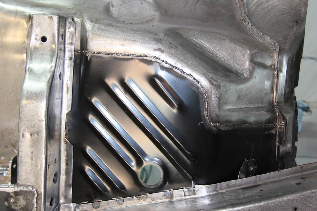

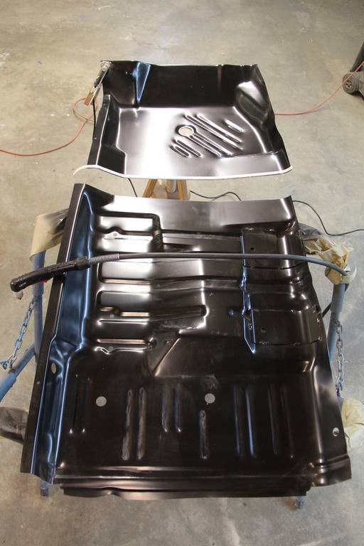

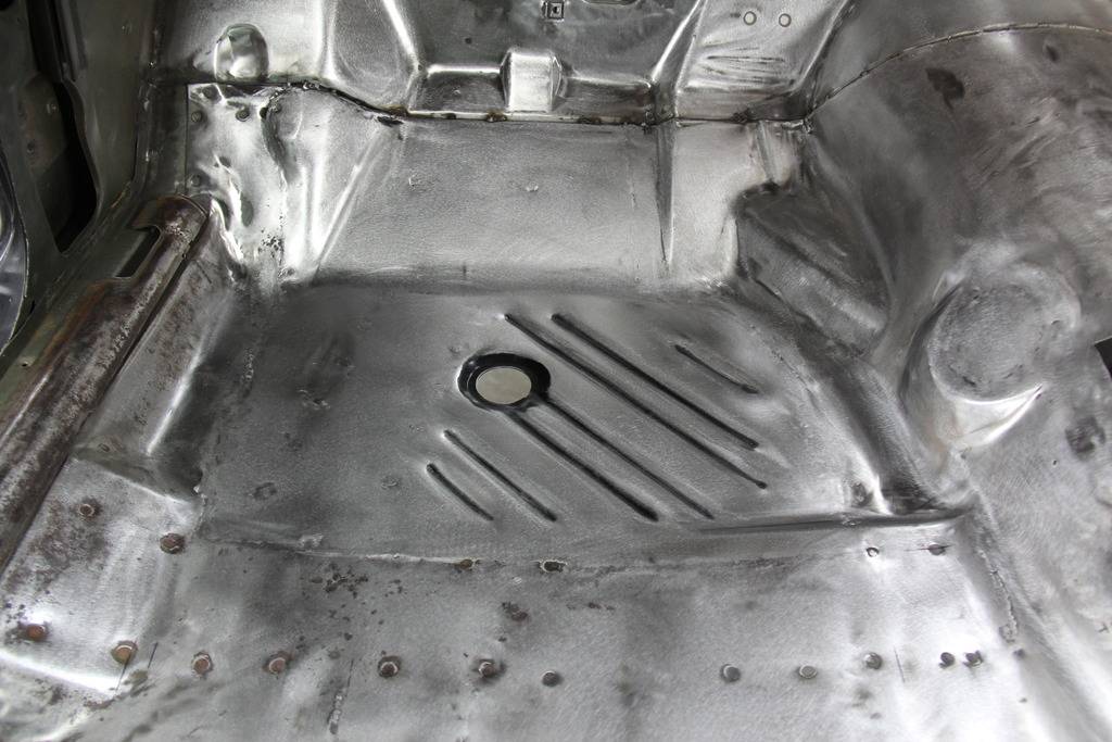

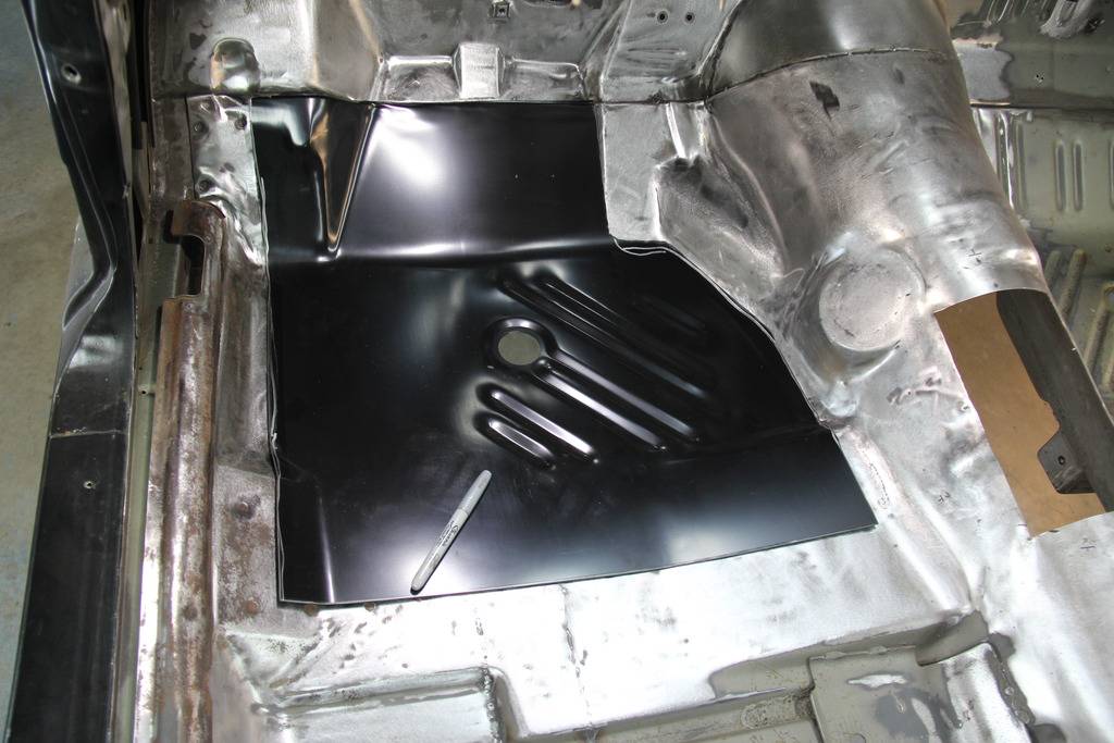

I had a small section of the driver’s side floor with pinholes that needed to be replaced. I cutabout 18” from a new left side floor pan and grafted it along the cross memberso it would be hard to tell if it was repaired. Some high-build primer shouldmake any imperfections disappear.
Love the rollers for the cable and the super tight fit on your floor...nice work! I did the exact same thing with the tubing to get threw the subframe connector haha. Love this thread

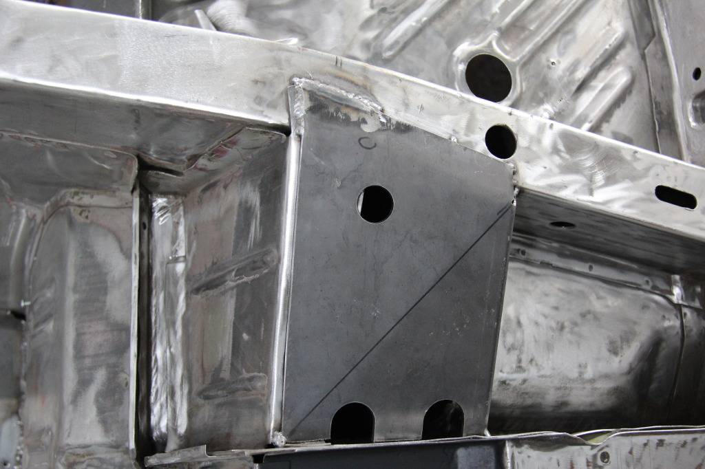

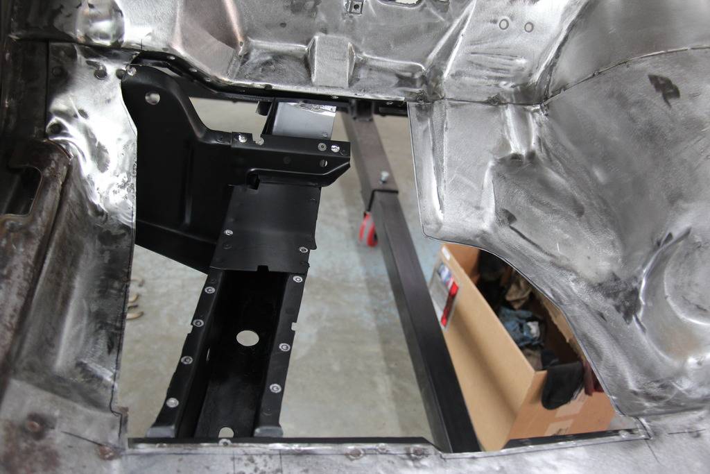

Fitted and welded the last torque box (left front) nextup is welding the unused holes in the firewall.
Thanks
Pat
