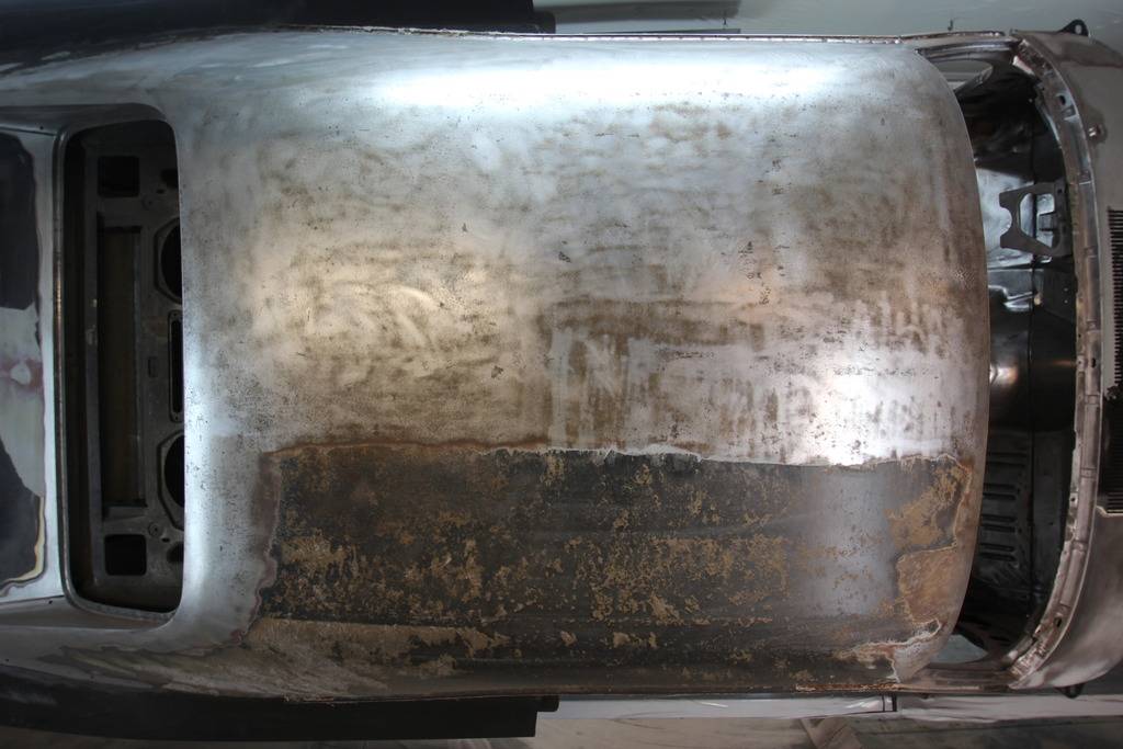

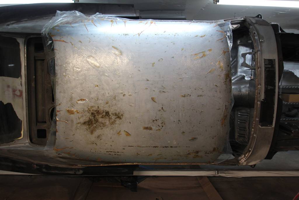

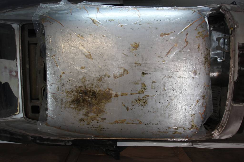

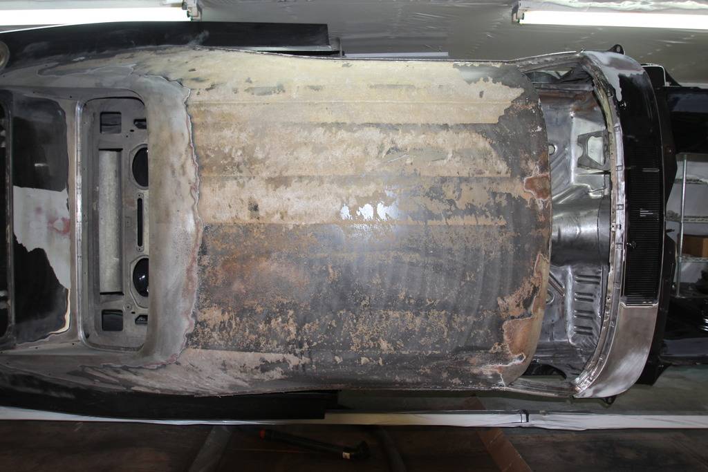

I started on the roof of the car by using paint stripper to remove the vinyl top glue, paint, and primer. Then I used a 6” DA sander to remove any leftover glue and paint. As with most vinyl top I was left with some rust and pitting to treat and repair. I coated the roof with a gel rust dissolver and covered the roof with plastic to keep the gel from evaporating. After about 8 hours I removed the plastic and rust dissolver then neutralize the roof with water, and paint prep. One last sanding with 80 grit on the DA sander, a wipe down with Final Klean and 2 coats of epoxy primer. Next I’ll will skim-coat the roof, sand and more epoxy primer.

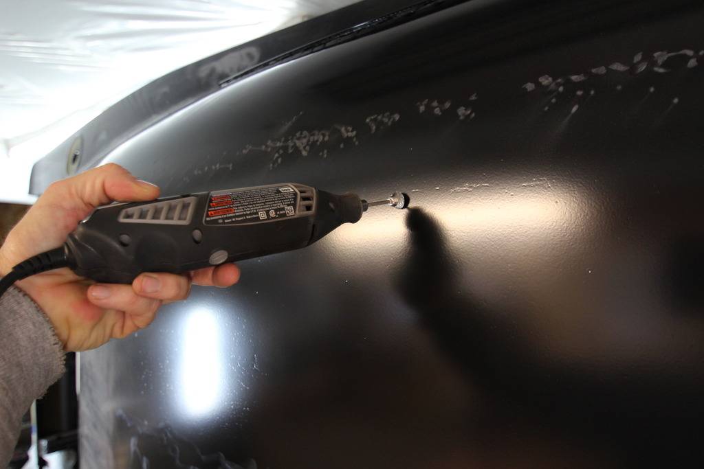

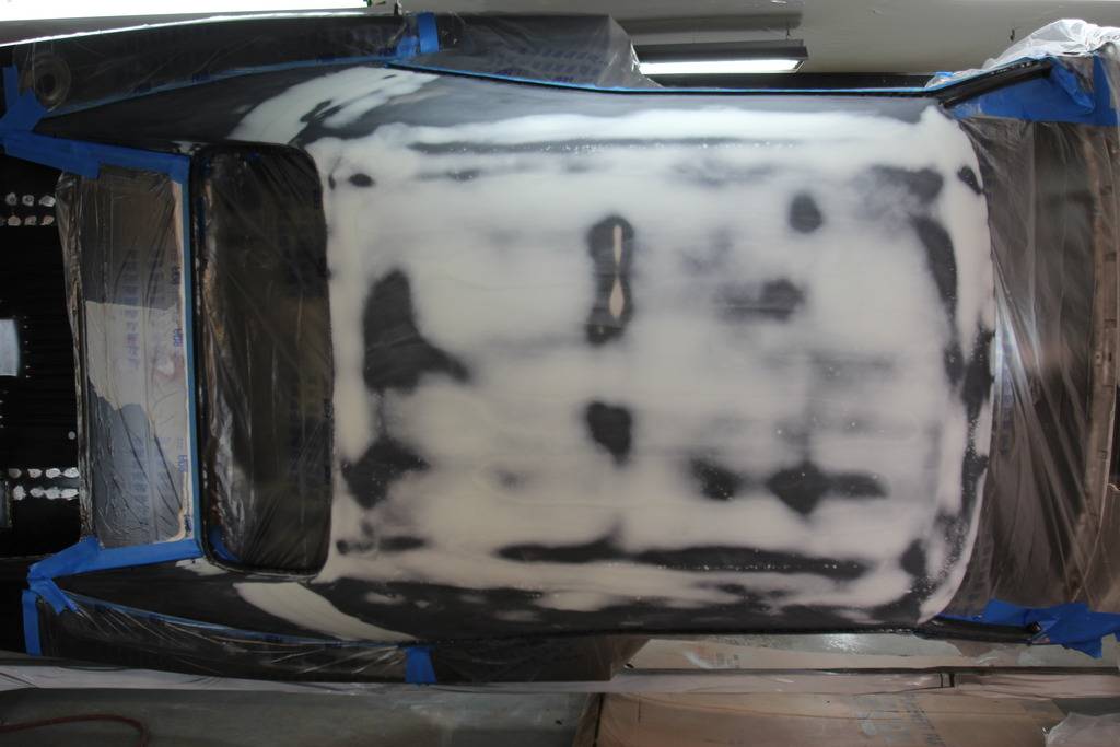

I used a Dremel with a wire brush to scuff the pits, and then block sanded the roof before skim coating it with body filler. Block sanded it again and sprayed a coat of high build primer. FUN! :-(

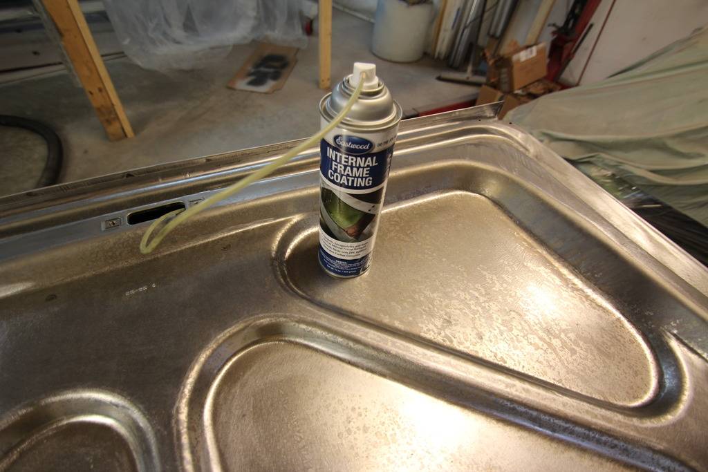

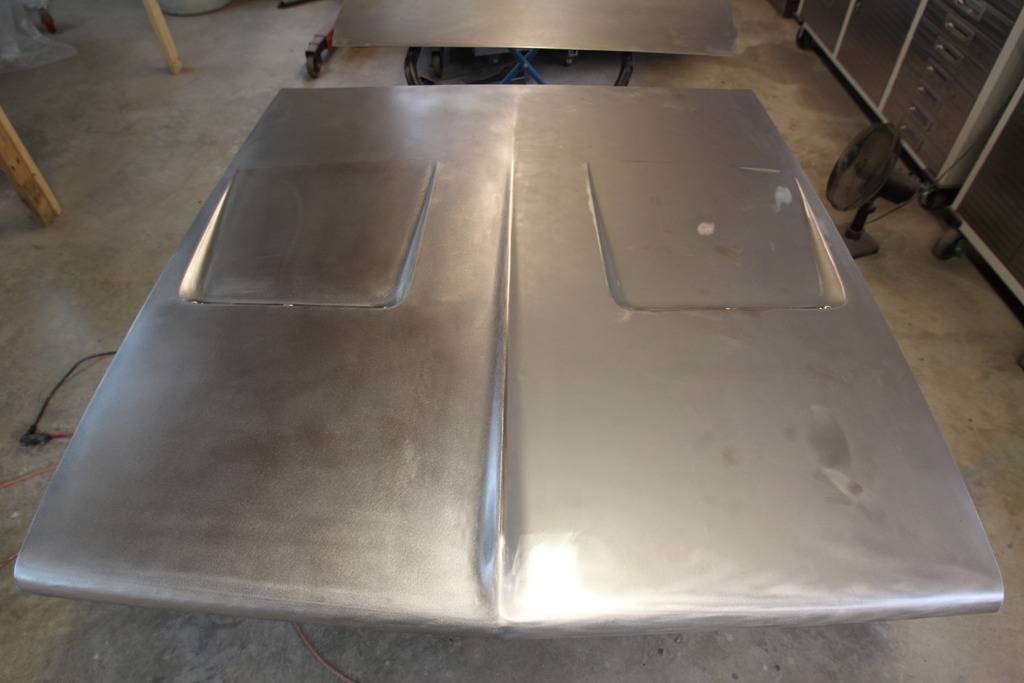

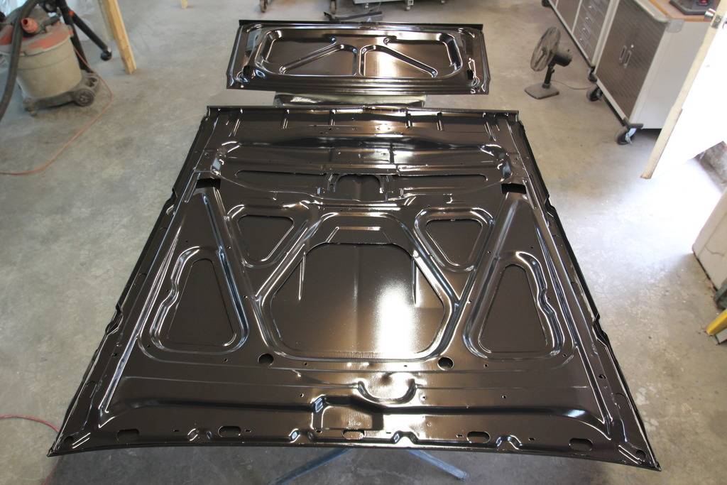

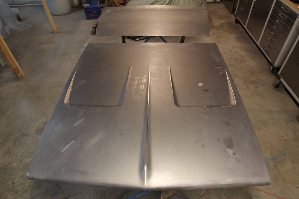

Started to see a little surface rust starting on the hood and trunk that I had soda blasted over a year ago and never epoxy primer. So I pulled them out and power wash them with a solution of Hold Tight which neutralizes and cleans off the excess soda on the bare metal. Then I sanded the panels with 80 grit paper with the DA sander. Before priming the outside I sprayed inside of the frame work with rust encapsulator/frame coating.

Here you can see the left side in the picture is sanded and the right side is the virgin metal after powder coating.
Using Eastwoods internal frame coating and rust encapsulator I was able to spray inside both the trunk and hood framework in a variety of different positions to coat all the internal surfaces.

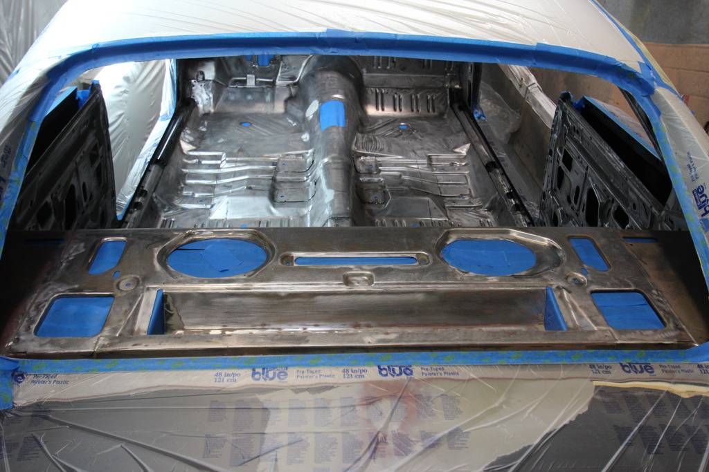

After removing the sound deadening held up with contact cement I was able to prep and prime the inside of the roof. Before spraying the epoxy primer and coated the inside of the roof framing with a rust encapsulator.

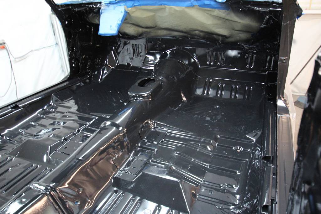

Then I prep and sprayed the floors and package tray. Next I’ll seam seal the floor.
