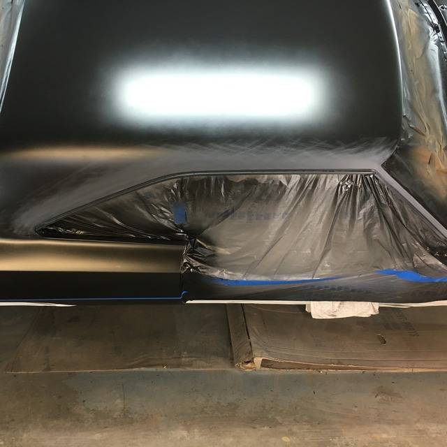

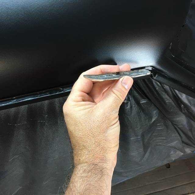

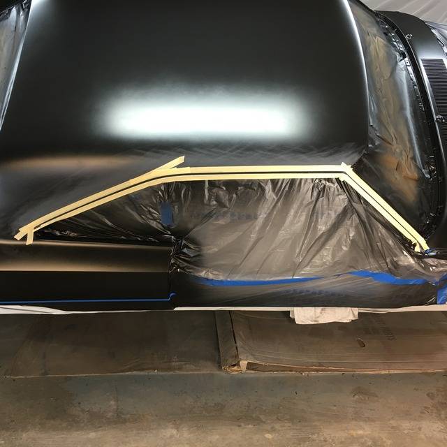

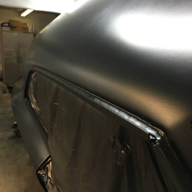

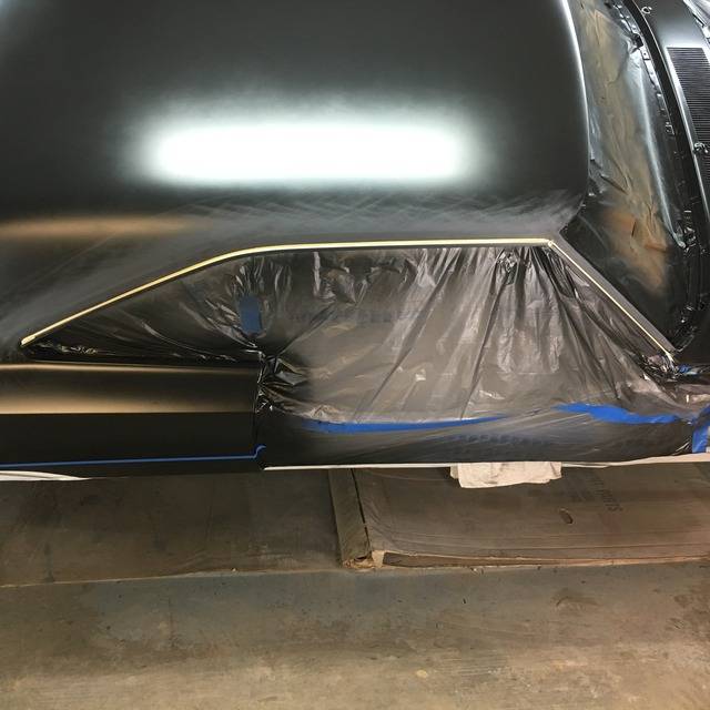

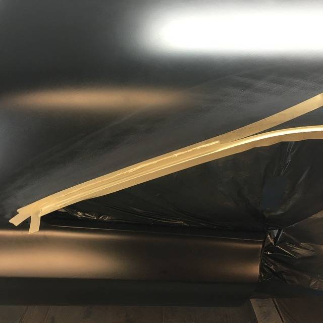

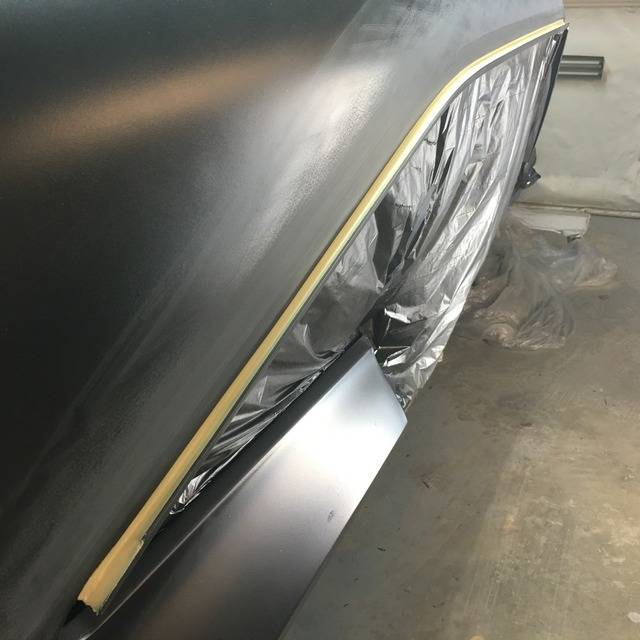

With the car completely epoxy primed I applied all the seam sealer on the exterior panels, starting with the roof drip rail. After sanding with 220 and a Scotch-Brite pad, l taped both the drip rail and roof to control the edge of the seam sealer. Using a product from 3M called Fast & firm #08505 I tooled it in using my finger and little lacquer thinner to keep i pliable. This Fast & Firm is easy to use and works great for paint or a vinyl top. I saved a small section of the original seem sealer to maintain the same shape.

I'm excited for you to be at this point. You're in the home stretch on this one! Keep the updates coming.
Nice job, I did the same on the last seam sealing job I did. Makes for a nice tidy finish. Car is looking fantastic.

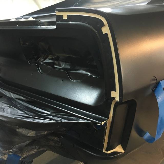

Not much to show the last two weeks as I've been out of town but I did get some more some seam sealer done around the trunk and quarters.

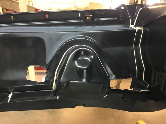

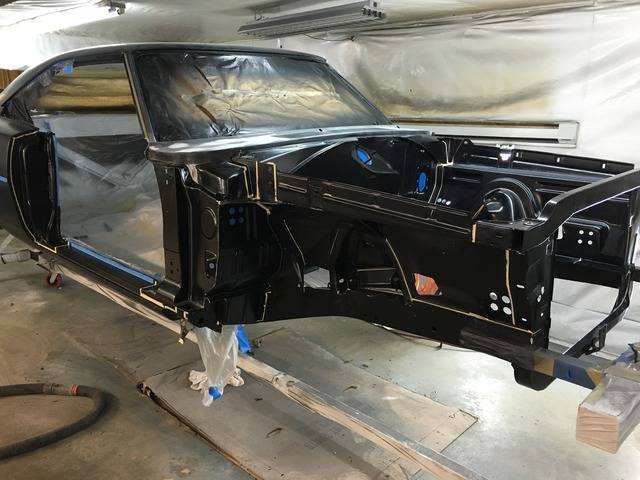

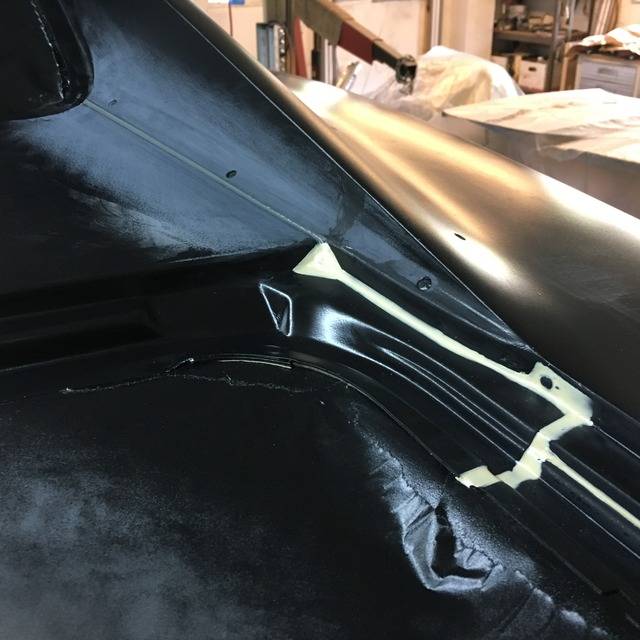

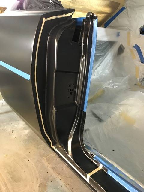

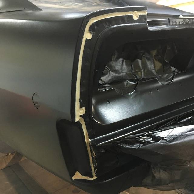

Finished up 90% of the seam sealer including a lot of areas the factory did not do that I had to use a pick tool prior to priming to remove the stones, grease and grime from the past 50 years. The beige seam sealer is 3M's fast and firm #08505. Easy-to-use, you can smooth out with a wet finger and 2 hours later you can clean up any mistakes with a rag and lacquer thinner.

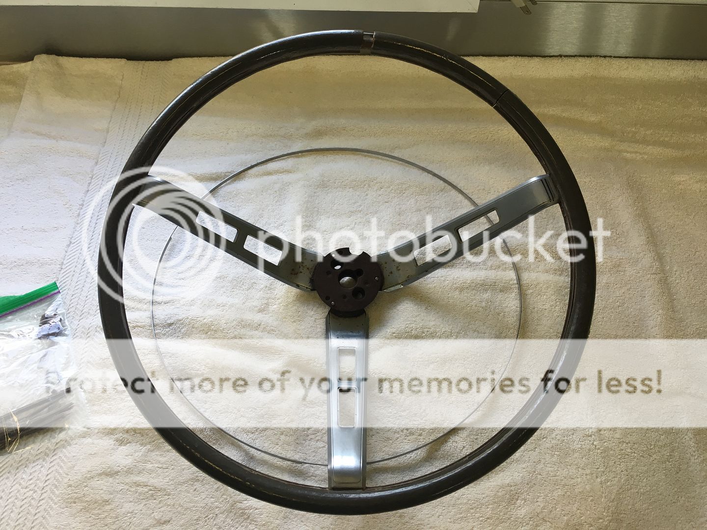

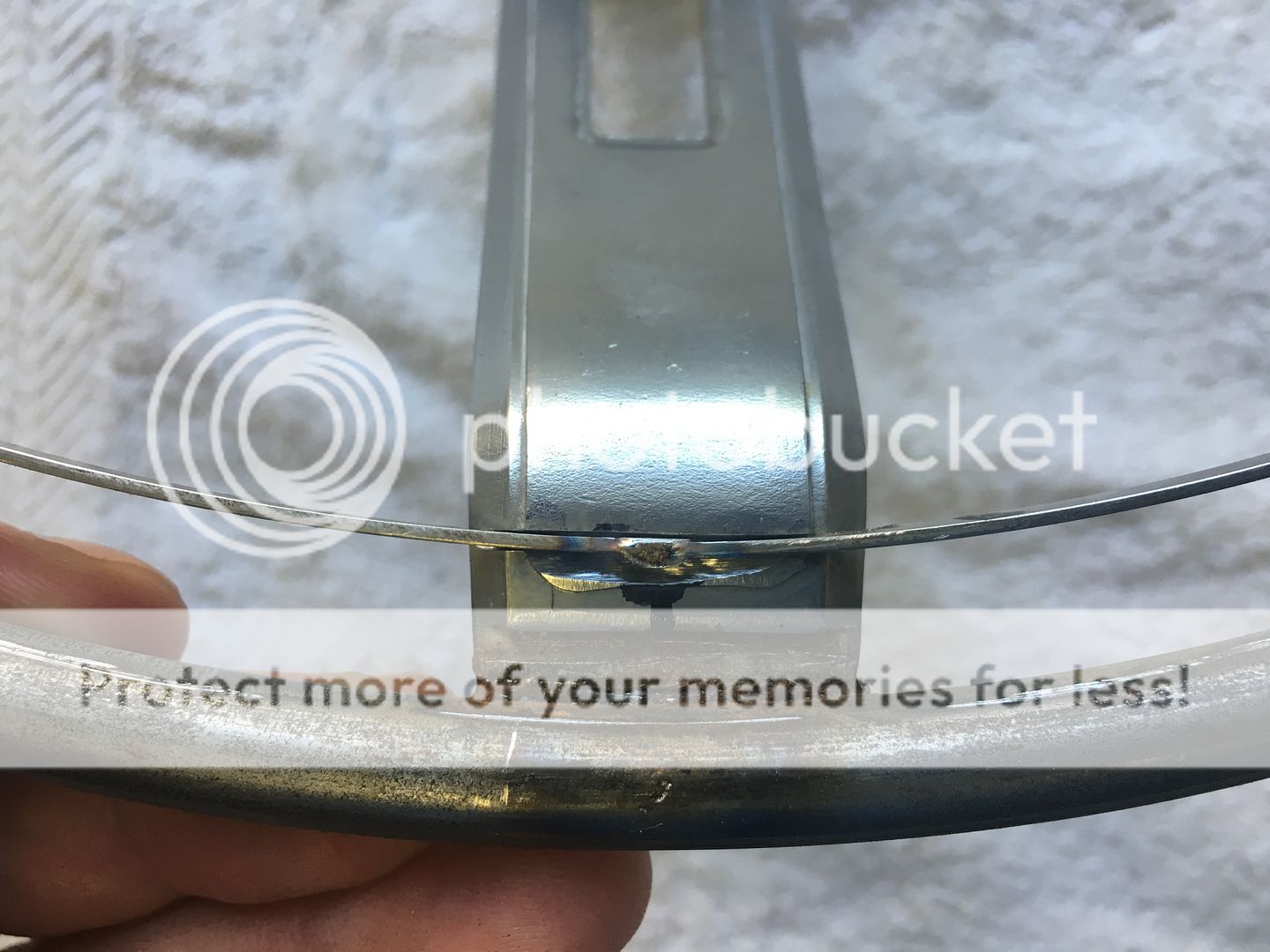

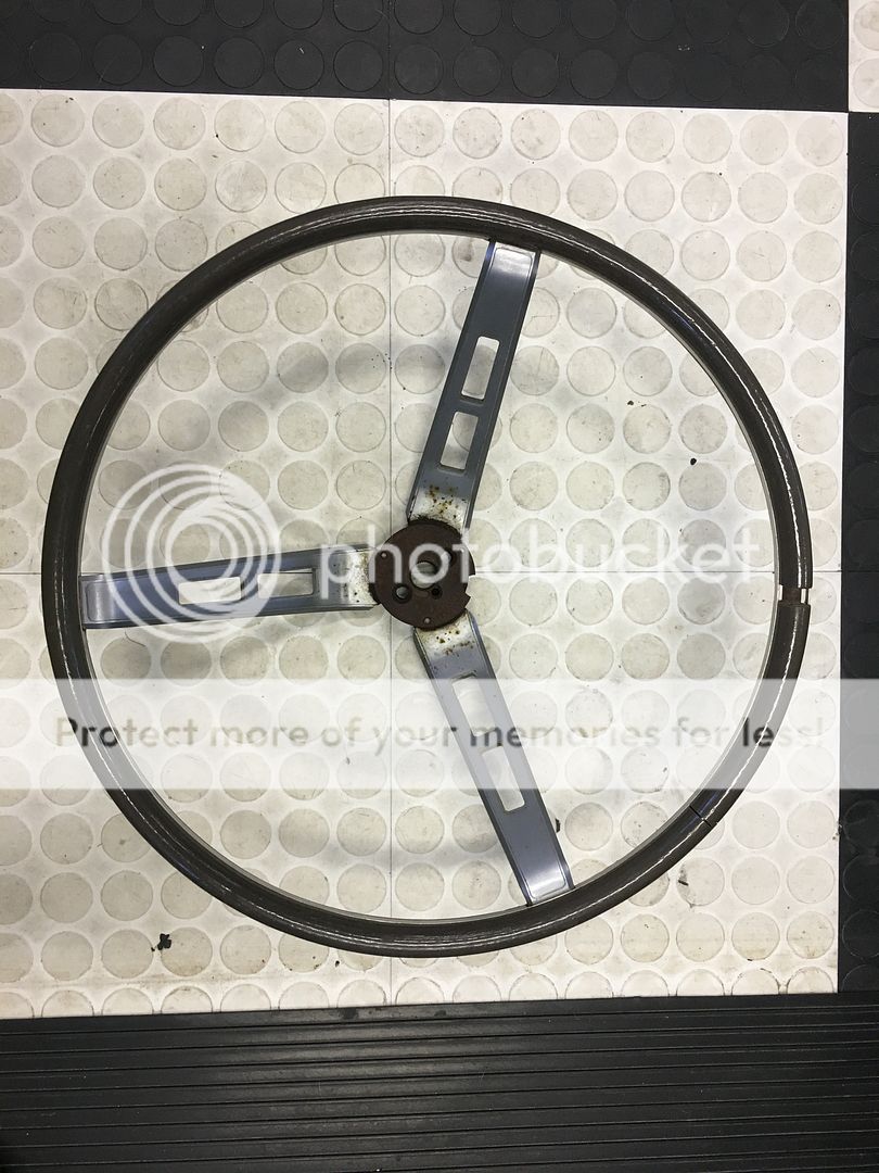

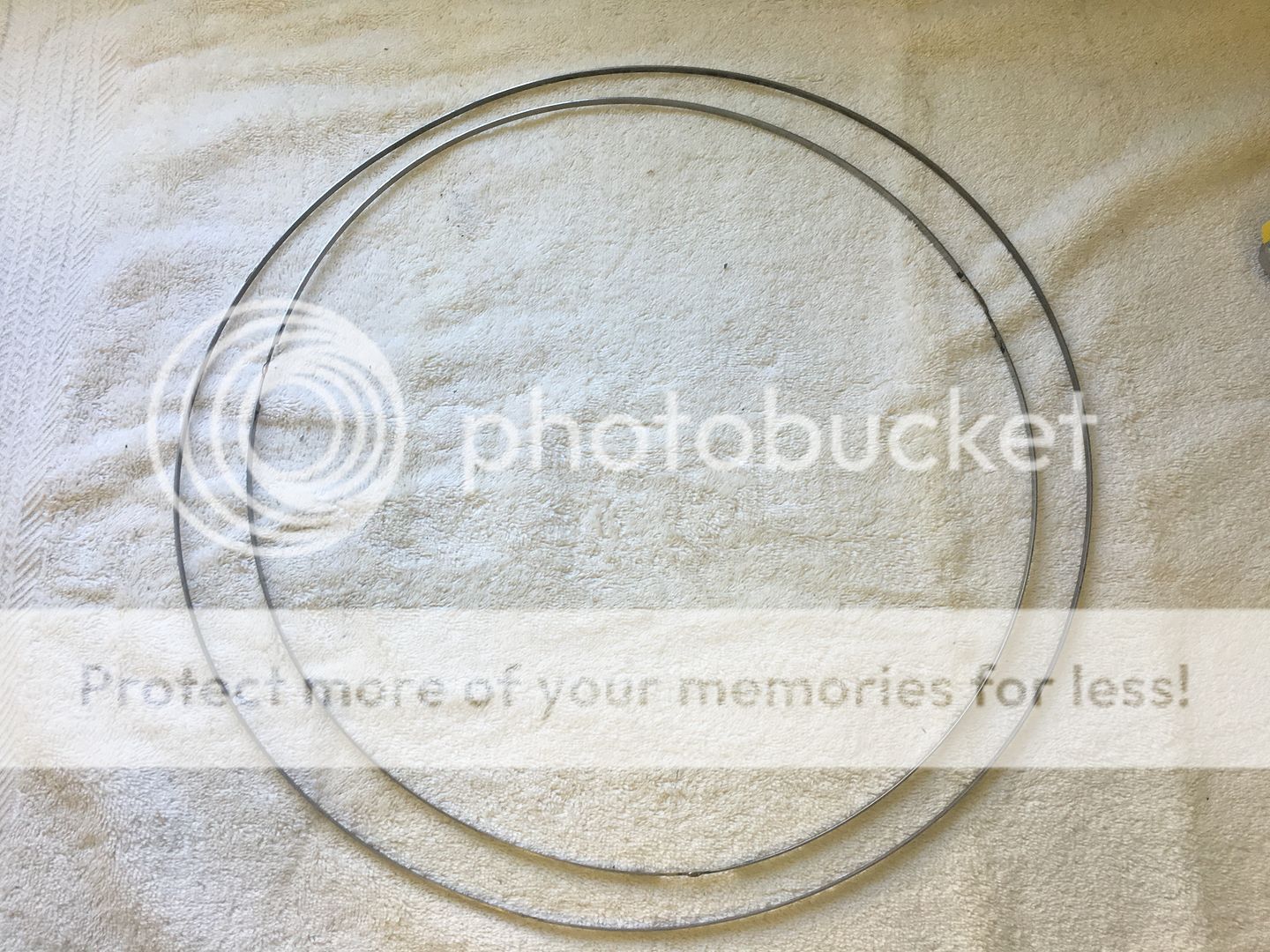

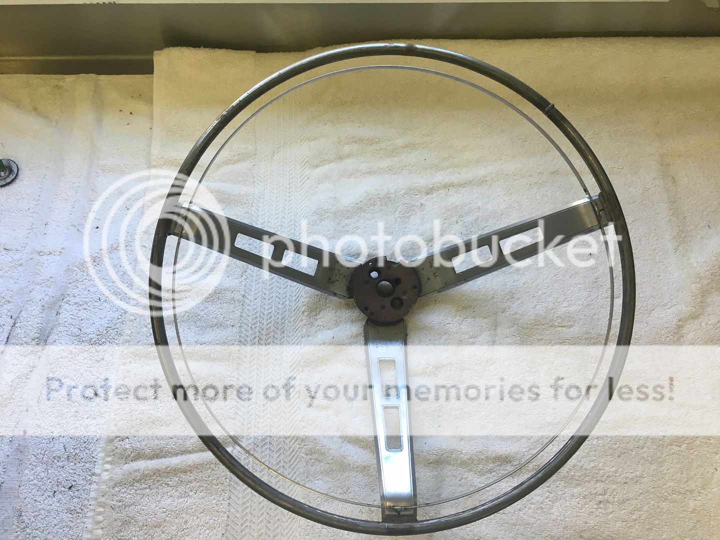

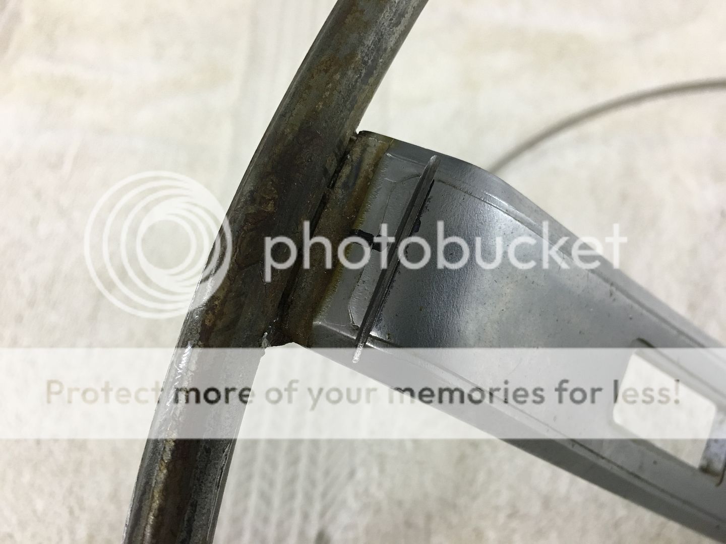

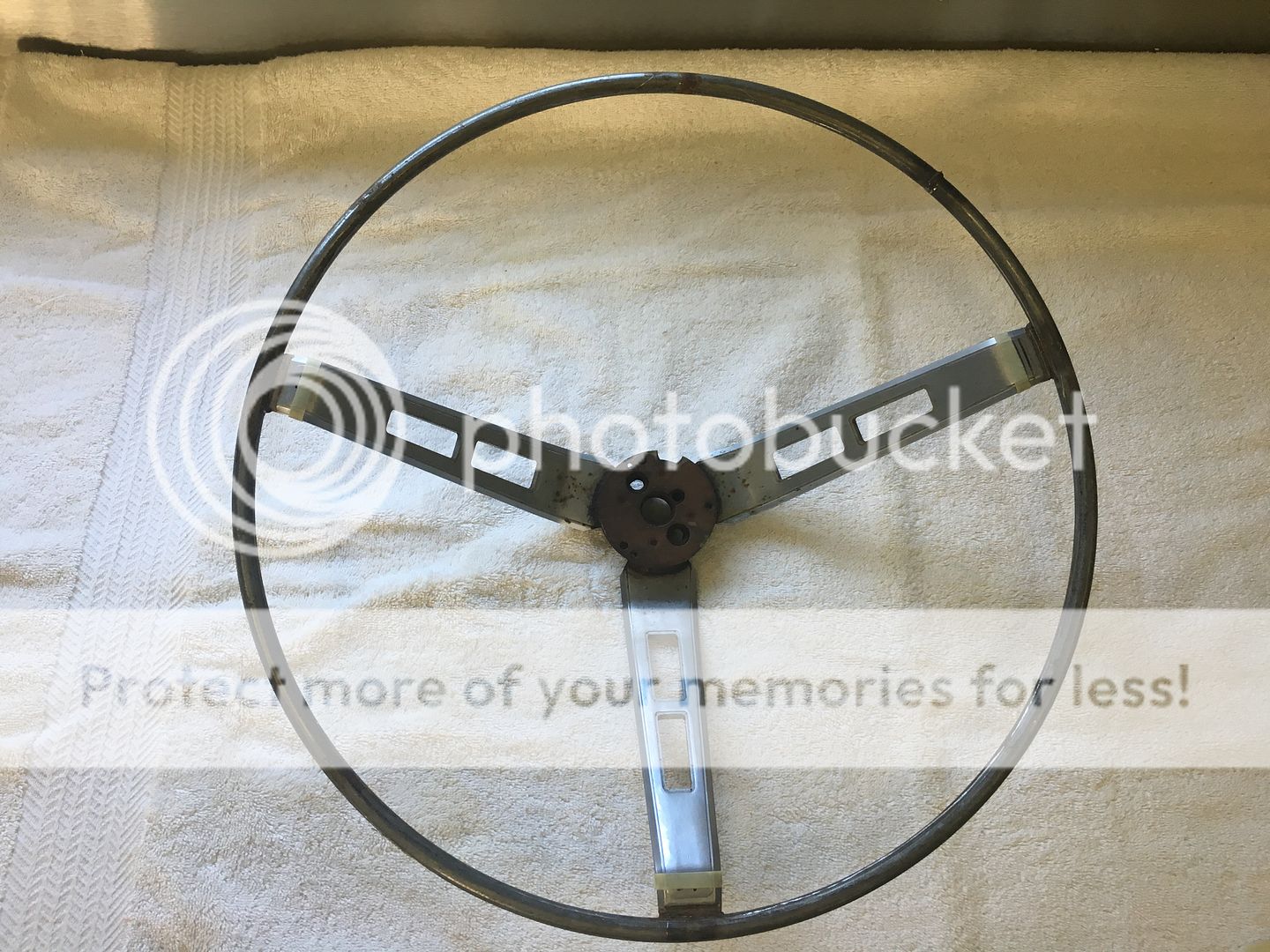

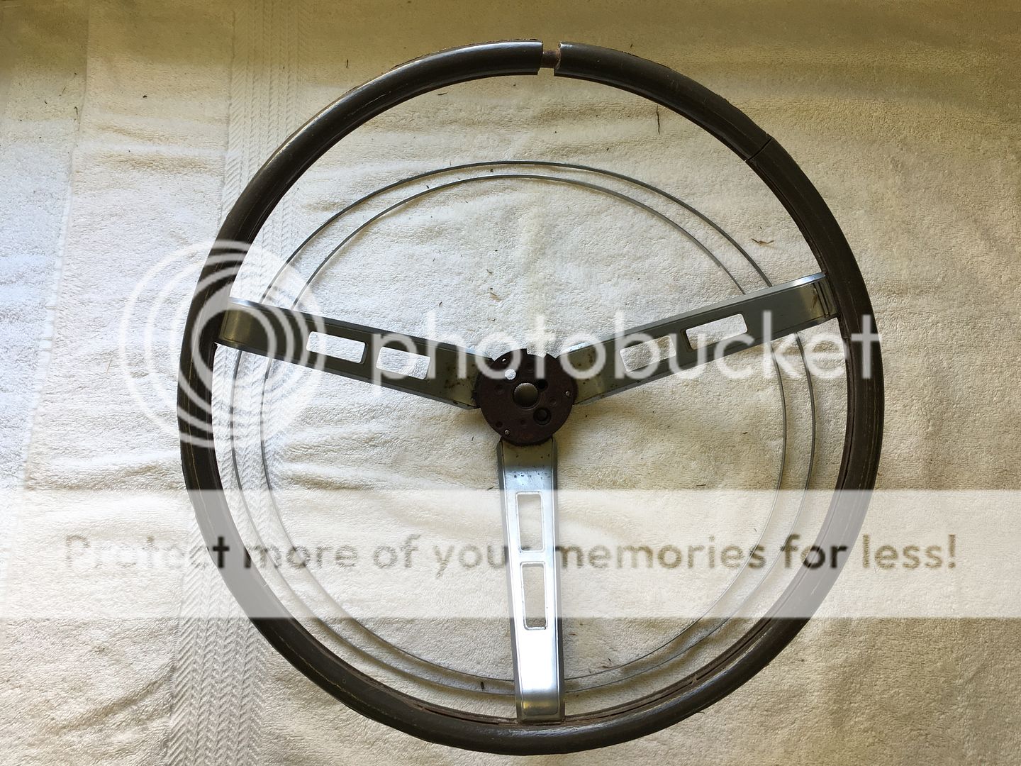

I've been laid up for a few weeks with some hernia surgery but I use this downtime to work on modifying the woodgrain steering wheel for the car. I love the look of the woodgrain wheel but driving my silver charger it was never comfortable handling the steering wheel as it's so thin. So I decided to modify this wood wheel to have a much larger modern size grip. I did not want to enlarge the diameter of the wheel as there already a little large compared to modern cars so I moved the inner ring in by about 3/8 of an inch. To do this I had to cut the S/S inner ring at all three spokes and weld it smaller in diameter and then Cut a new slot in all three spokes to hold the ring in its new location. While I have the steering wheel out for re-plating the spokes I need to brainstorm how I'm going to remake the larger plastic wood grain handle??? Suggestions welcomed!

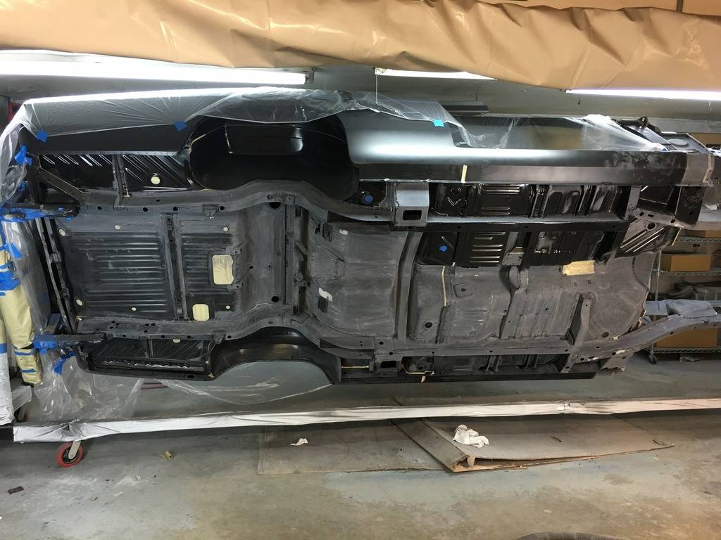

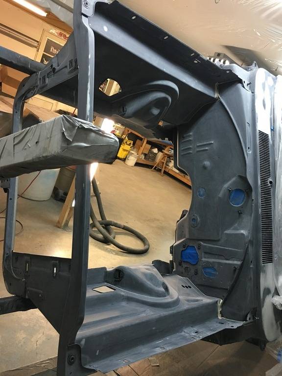

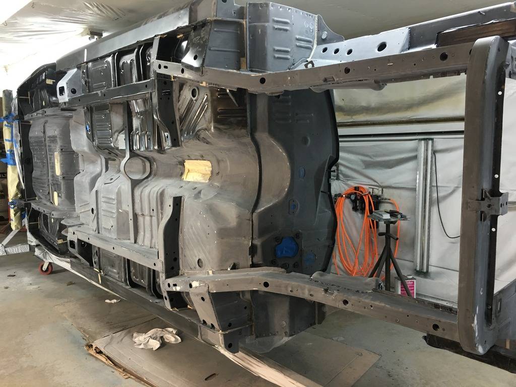

Still making progress just not a lot of photogenic things show. A lot of boring sanding to prep the bottom and engine well for base-coat clear-coat.

That's all the stuff nobody appreciates, but you. Believe me....I know.
Very nice Pat! How many coats of each, and what type of paint do you use?

Last two cars I used DuPont chroma-base but I may switch to PPG on this car as I like the black options a little better?? As for number of coats, after the primer and a epoxy sealer it will get two coats of sealer, 3 coats of base and 4 to 5 coats of clear.
