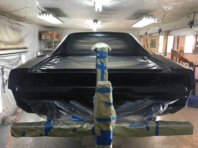

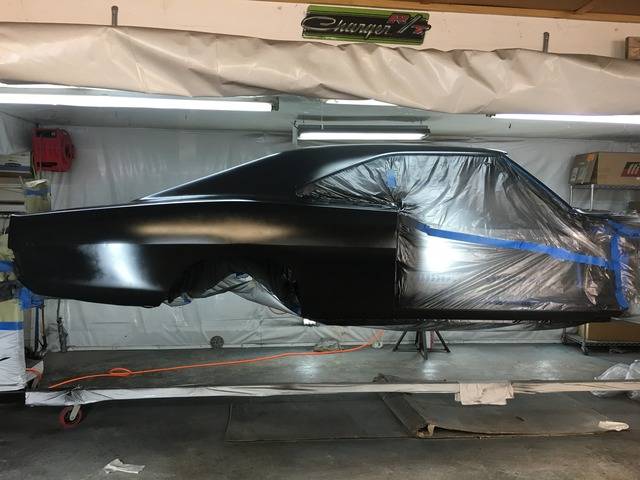

More outstanding work Pat, hard to believe how you keep things looking so tidy but looking at all the masking tape it just shows patience is the key. Love seeing it get coated in Epoxy, only means things are getting close:thumbsup:.

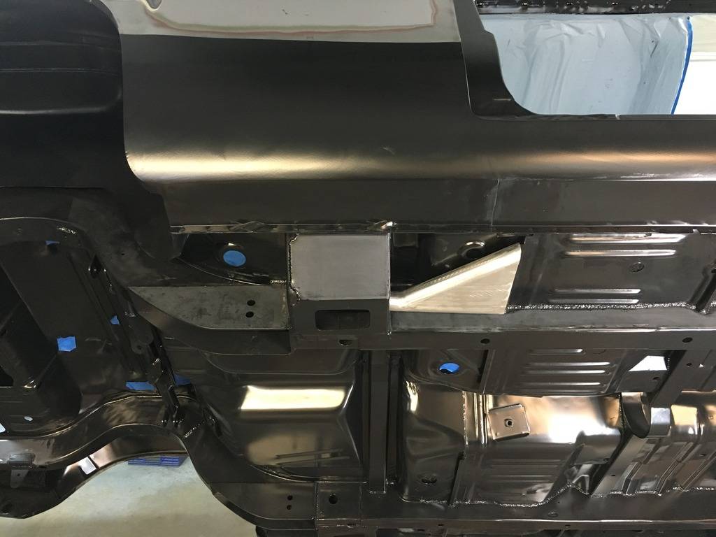

Rear brake vents look super cool too, great idea.
Thank you sir, I'm keeping my fingers crossed that I'll be shooting this car by September ???

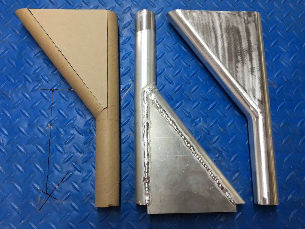

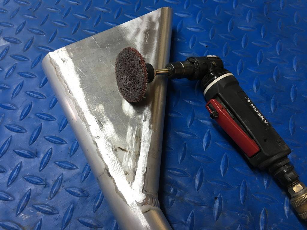

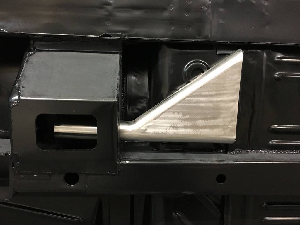

I made the aluminum rear brake vents using my cardboard template. After welding them together and grinding most of the welds down I used a air tool with a medium Scotch-Brite pad to finish off and smooth out the welds. The Scotch-Brite pad is very user friendly and fast when working with aluminum.

The only downside I see to this is that you'll be pulling hot air off the pavement. There's a reason race cars run the ducts off the top of the body. The air isn't much cooler but it IS cooler.
very nice work though
There is always a fine line between form & function but for me not at the expense of the original 1968 body lines. As for road temp my rear brake cooling ducts are not much lower then most front brake cooling ducts?

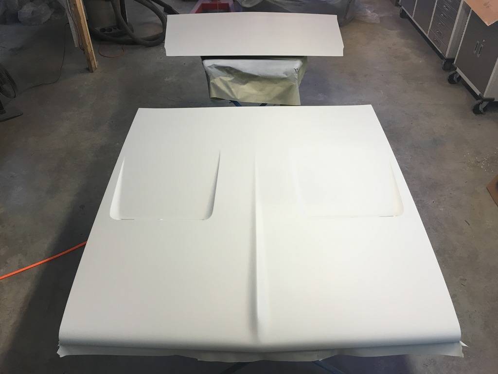

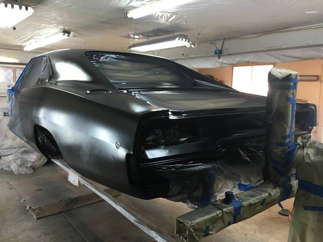

Not a productive weekend on the charger as I went to Carlisle, but I did spray some hi build primer on the hood and trunk lid today.
Thanks
Pat

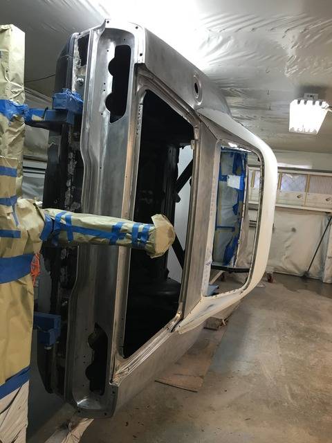

Finally I have removed all of the original paint and primer except for A small section at the center rear valance. She's all prepped and ready for epoxy primer just need the shop to cool off a little.
