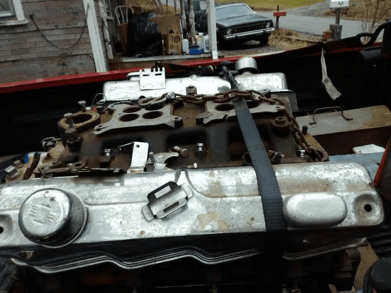

can't wait ..... but if ya notice its not the long ram.. it is the shorter one without the full lenth devided runners
