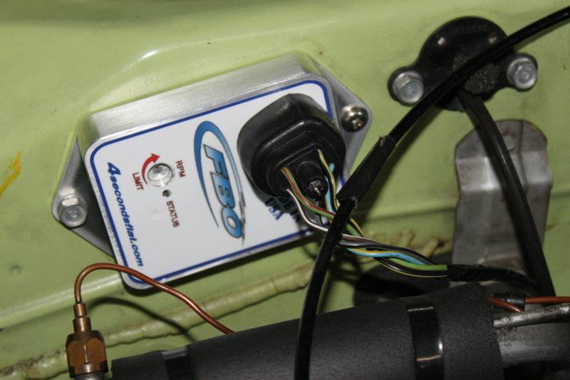

ok I just installed mine two days ago and went on one 30 min test drive, so far its significant over my orange and lastly a jegs high rev, which had a delayed start, this FBO starts the engine right up as you know I like the fact its a modern alternative to correct todays fuel issues it has a bit more power over the jegs I will know more once I drive it on a longer trip. I did try that Revenator ICM, the engine was having this surging all the time and it lost its low end snappy feel. I sent it back for a full refund.

This would be ideal for maximum economy and a less smelly car. Now that this new system is in place I can have a cleaner idling car, better economy and much better power with out loosing coil voltage, and power loss up to my 5000 rpm max for this engine 7000 with the new box. When I first tested the car installing only the coil and the new ECU it made more power and sounded better. Now with the new distributor, as Don mentioned I have the complete package for the engine. Of course you need good spark plugs, wires and a good carburetor. All timing adjustments were done by using a digital timing light, it has a the rpm read out and I have a vacuum gauge always connected so I can see how the engine is running all the time. In my opinion and from past experience back in the 80's to about 2012, when the car ran great and started with one key turn, all this modern design components are needed due to the additives in modern fuel. IMG_5484.JPG
View attachment 666175 I just finished installing a Distributor from Don at 4 Seconds flat.com. With my altered 318 a .430 inch cam, I could no longer use my stock distributor from Auto Zone, and the lack of mopar performance parts availability any more, I had to resort to a Duralast with a non- adjustable VA advance after my old worn out Mopar dist. needed to be replaced. Since about 2012 and after it would not start that well. I was running a factory original dist. when I had the motor rebuilt and it ran and started fine for years. Because the fuel was changed back in about 2012, our engines have had trouble running the new designed fuel which is for a modern engine.
This new dist. is set up with direct manifold vacuum. I installed one heavy spring because I had a slight ping low to mid range on acceleration, nothing at heavy full throttle. The new dist can be adjusted by turning two screws and inserting a plastic pre- sized degree gauge, tighten up check and your all set to go.
My settings are as follows for my particular engine:16 mechanical in the distributor, 18 degrees at the damper, with no VA connected to the manifold, 30 degrees at idle with VA line connected to the Intake manifold vacuum.@@ shown on the vacuum gauge,3 turns of the mixture screws, ( a 2bb carter factory carb) rich it wont idle well with anything less.
My total will now be 34 degrees max mechanical @ wide open throttle and should be about 46 degrees (add the 12 degrees to the 34 max mech) with steady highway driving. I can now adjust the VA at the can and slowly bump it up until my max is reached, some mechanics say and I have read the engine could go up to 50 degrees full VA advance.
This would be ideal for maximum economy and a less smelly car. Now that this new system is in place I can have a cleaner idling car, better economy and much better power with out loosing coil voltage, and power loss up to my 5000 rpm max for this engine 7000 with the new box. When I first tested the car installing only the coil and the new ECU it made more power and sounded better. Now with the new distributor, as Don mentioned I have the complete package for the engine. Of course you need good spark plugs, wires and a good carburetor. All timing adjustments were done by using a digital timing light, it has a the rpm read out and I have a vacuum gauge always connected so I can see how the engine is running all the time. In my opinion and from past experience back in the 80's to about 2012, when the car ran great and started with one key turn, all this modern design components are needed due to the additives in modern fuel. View attachment 666176
