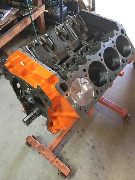

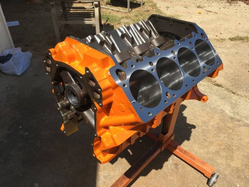

its coming along Now, all machining done and a fresh coat of paint that will probably take a week to dry. cant tide detergent final wash it until it sets up.

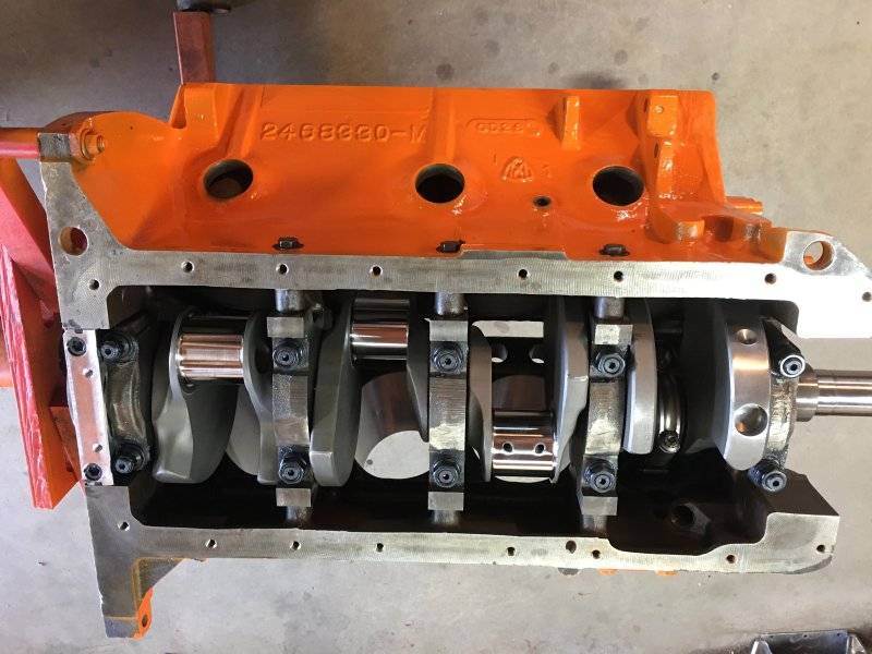

main and rods set at .003 clearance , pistons at .005 . top rings at .025 , 2nd at .028 . isky EZ max lifters rebuilt and ready.. molnar 4.15 crank and 6.86 molnar rods with racetec 2816 pistons for a 11-2 CR....trickflow 270's. The Hemi Wedge !

That’s coming along real well and nice parts. What’s the final size?
505" ish, its like 504.++.....cant remember whether the cross bolts need any sealer.

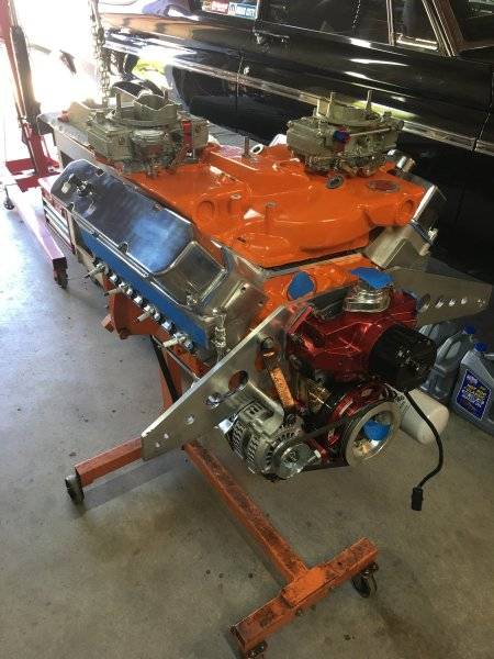

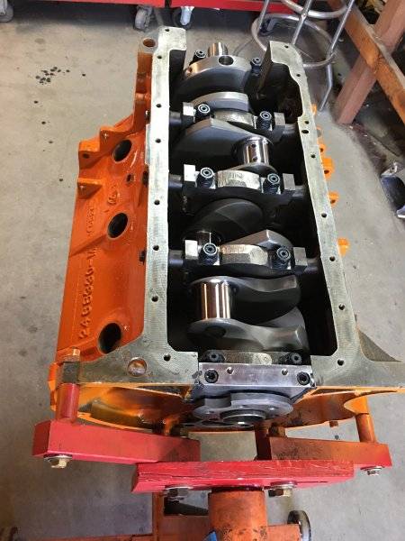

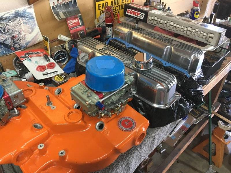

made some progress today, crank is now torqued in place with a MP rear main seal housing. seals were offset appx .250 and sealer used in place of the side seals. clearance ground it a little but was probably good without it, to be sure. pistons r .012 down in the hole :thumbsup: . need to set up gear drive and degree the cam and set timing marks in relation to the damper But these expensive cranks dont come with Keyways.....and it wont show up until the weekend or later....

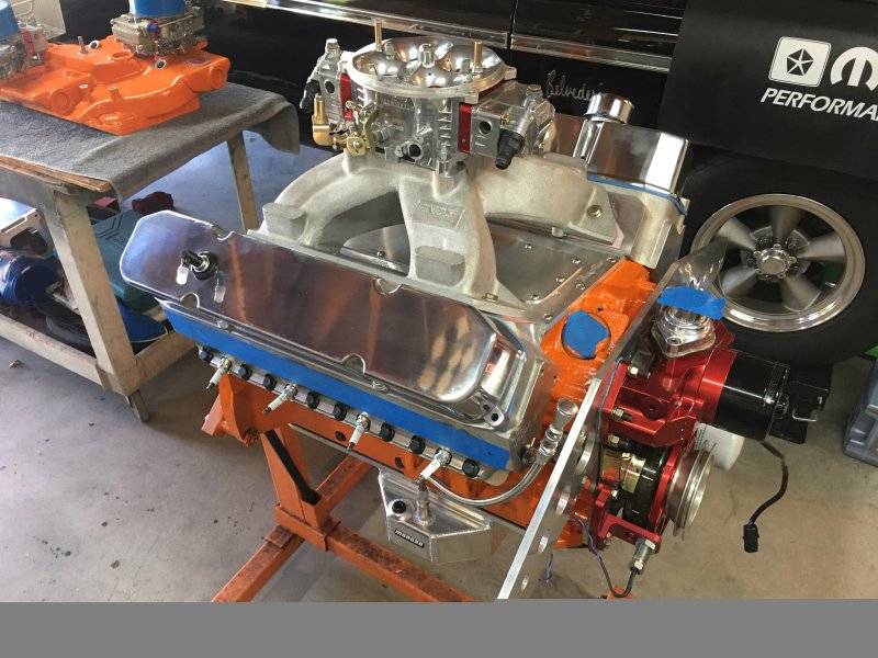

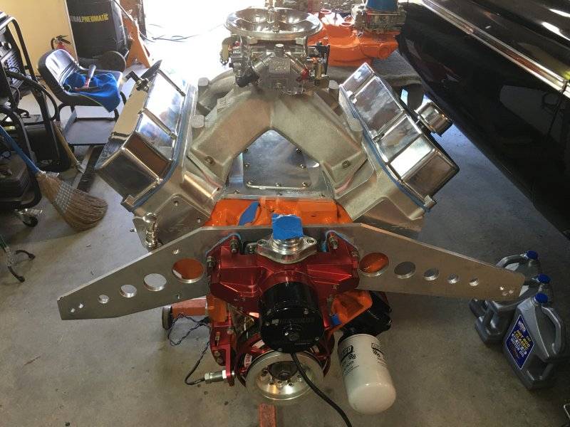

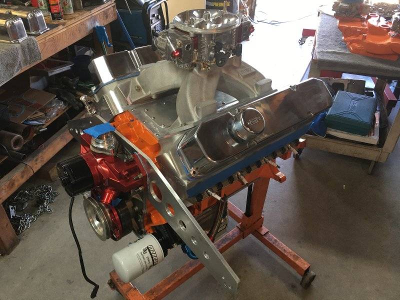

almost ready to go, sealer is drying on the intake gaskets bottom side and on the motor plate/water pump..lots of bumps in the road from manf changing and miss representing there products..But its done. waiting on 2 lift brackets that wont be here until after the 4th..

Looking real good. Gonna be a rocket ship. Wondering what size is that Quick Fuel up on top.
thanks. thats a Holley 80902 1050 XP that i bought last weekend at mopar alleys show/swap meet...doesnt appear to have had any fuel in it as new 700.00. couldnt say no..indy intake is just cinched down enough to evenly seal the gaskets. will start it with the crossram thats already tuned with the hemi 770's and go from there..

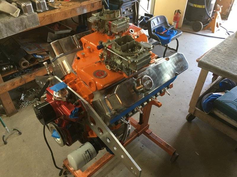

Now its ready to go in, had an O'**** moment putting the intake on when the allen head socket popped of the extension and it fell down the runner all the way into the head, fortunately the valve wasnt open enough for it to drop into the cylinder....took the intake back off and used a magnet to get it....
alot of work, time and money to get the 3 crossbolts on the side shown in the pic.....here's some engine ****.
The Hemi Wedge !!

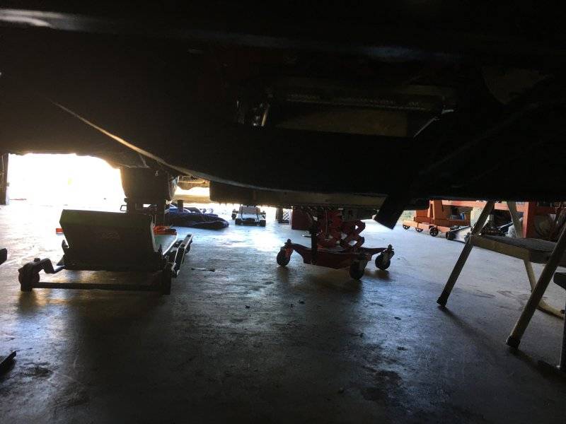

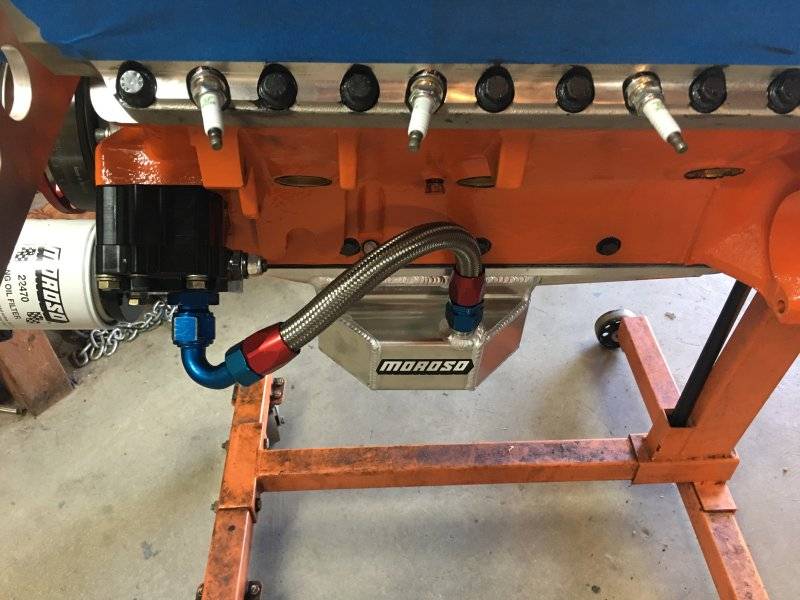

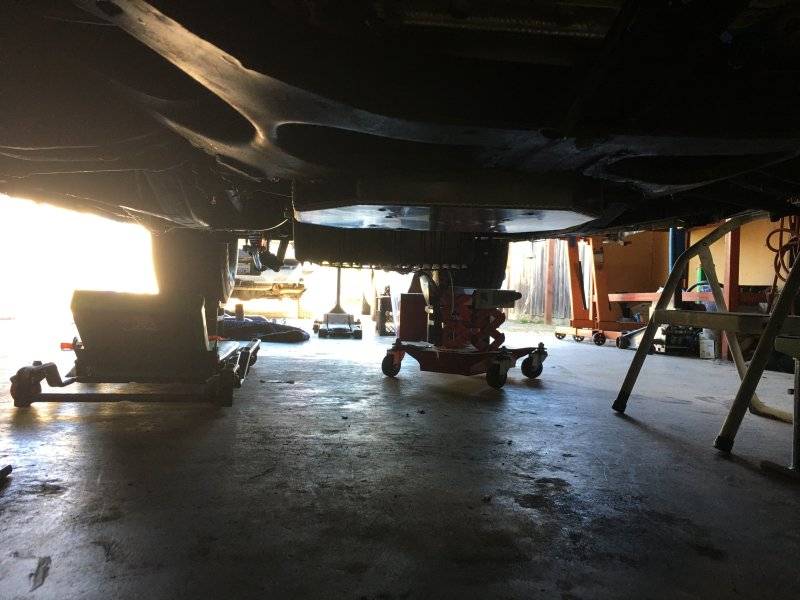

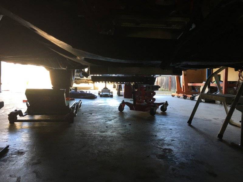

had the afternoon to myself so i installed the motor today, had to know whether the new pan would fit, according to mr stanley it would,,,,,and it did. low profile moroso aluminum 7 QT pan, hangs 1 " below the 1963 K member which has the inner lip cut off and welded up. cutouts on both sides, the passenger side is 1" less wide than the driver for offset motors Unlike the milodon unit... some thought was put into that :thumbsup: . complete with internal trap doors and anti slosh plate. external pick up only with a dip stick provision...and i did install hockey pucks on the front as stops per malex...lol.
