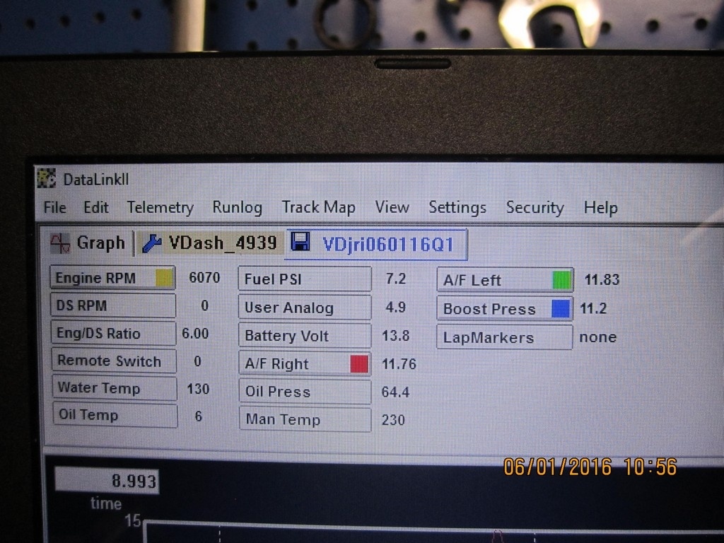

Been playing around with the carb still. Raised the float level and now I'm getting closer. Actually its rich now, before it was on the lean side. Now I can start closing up the idle screws.
Idle in park and cruise is in the 13's. Idle in gear is 14ish. WOT went up a bit to 11-12's. Don't spend a lot of time there.
