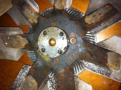

Question regarding the MP clutch fan. I've searched and searched, but haven't found anything definitive regarding this. The MP clutch fan comes with a 5 blade staggered fan and I've been using this setup on my engine for the last 2 years with good cooling results.
I've up'd the power of the 440 and several recent posts got me to thinking, can I transplant the MP clutch to my original Mopar fixed 7 blade fan? Would I gain any benefits with the 7 blade fan over the 5 blade fan?
The radiator is a 26" Glen Ray max cooling radiator with shroud, 180 thermostat, Mancini aluminum water pump and Be Cool coolant.
Theoretically, a 7 blade fan would pull more air (cfm), as far as adding a clutch, typically the clutch fan assembly have a hub that the clutch bolts to, (and clutch bolts to water pump pulley) I'm not sure if your fixed blade fan has that hub so you wouldn't be able to bolt a clutch to it.
youd probably be better off buying a 7 blade clutch fan.

Clutch and non-clutch fans won't inter-change.. Your 5 blade staggered fan is the Viscous fan. Mopar says it their best fan setup. Pulls all the air with less HP and less noise. I've ran them for decades with great success.
Likewise here for the last 2 years with no cooling issues. I guess I'm just overthinking something that hasn't happened yet. Guess I shouldn't fix what isn't broken eh.
