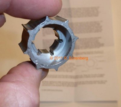

Let's see if this works. Is this noise from a damaged reluctor? I got it running great now. Just can't seem to figure out what this noise is from. I am definitely thinking my pickup damaged the reluctor but not certain yet.

With that much noise you would think that the reluctor or pickup would have chunks under the cap. Is there any sign of that? Dry bushing on the shaft?

I had a similar issue with mine although not the screaming noise you have. Mine would hesitate and bog at initial throttle or off idle stumble. I wound up taking my distributor completely apart and inspected every piece in it. I was planning on changing the advance curve with a lighter spring in place of the heavy one at first but wound up re-assembling the distributor with a new pick up and reluctor. I set the gap at .008 between the reluctor and pick up and while doing so noticed the the vanes on the reluctor were not aligning up with the pickup strip. I pulled the reluctor again and noticed that it had 3 indent sleeves and an arrow pointing in the clockwise direction. My crew chief 69a100 remarked that the reluctor was for a small block...they rotate clockwise where as BB rotate counter clockwise. Well I happened to have a replacement reluctor courtesy of Rick Ehrenberg/aka. eBooger of Mopar Action that is both for use on BB and SB with arrows pointing in opposite directions and double the sleeves for setting up timing and advance. I swapped one of these for the 3 sleeve on the distributor and the vanes and contact point on the pickup aligned perfectly. Here is a link to one he has for sale on the eBag:
http://www.ebay.com/itm/Mopar-Modif...Parts_Accessories&hash=item33923053d6&vxp=mtr
You can clearly see the additional slots and the arrows pointing in the opposite directions. The switch to this one cured my issues and smoothed out my ignition and throttle response. Also one last concern here...Did you make sure to re-insert the roll pin back into the slot in the reluctor? That might be the cause of the screaming you are hearing. An easy thing to over look too. As for the Orange Boxes...Me I prefer the Chrome Box over it. I have never had an issue with the Chrome ones. Hope this helps you out and will smooth out that aweful screaming noise. The exhaust note does sound really good there...cr8crshr/Tuck

Ironically enough, I was looking at those reluctors on ebay last night. Mine has conflicting arrows as well. I haven't removed the roll pin yet, but will once I get a new reluctor. I am quite blown away that this is an issue and noise that no one else has ever experienced with these. It sounds good and now runs like a SOB as it should. But with that annoying scream! Once that is gone, ole blue is bsck n business.
