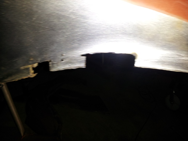

First I cut out the areas where the rotted metal extended above and into the flare part of the quarter . . .
( as I was cleaning up the metal on the back side, more bad areas appeared - I'll have to remove some more bad metal in other areas )

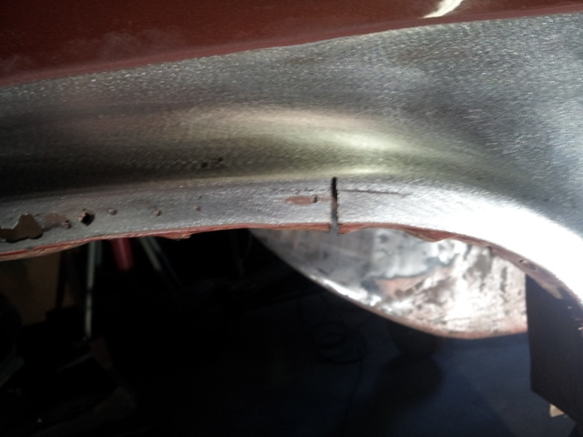

Then I cut the arch where the bad metal ended so that I had a line to cut to . . .

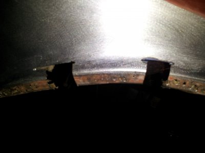

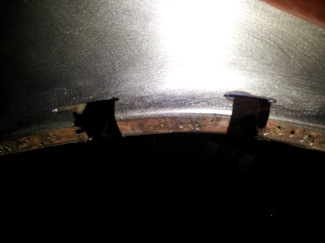

Then I cut away all the wheel arch where all the rotted metal "was" and tried to leave the best metal I could for re-welding . . .

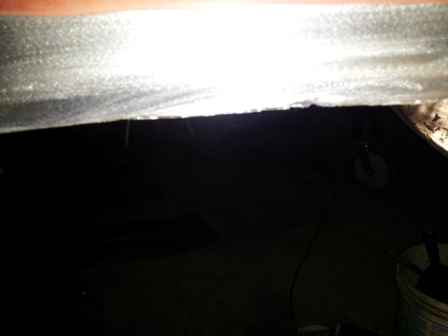

( look at the first picture and you'll see that all the "bad" metal has been removed . . . )
Did some grinding on the edges to get rid of any rusted or bad metal and leave a good edge to weld to with the new metal . . .

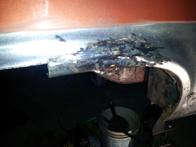

And . . . my first attempts to start welding the metal back in to replace the missing pieces
( ok guys . . . YOU all make it look SO EASY . . . )
Got a long way to go, but I'm welding in small sections and trying to keep it all even as possible as I go along.
