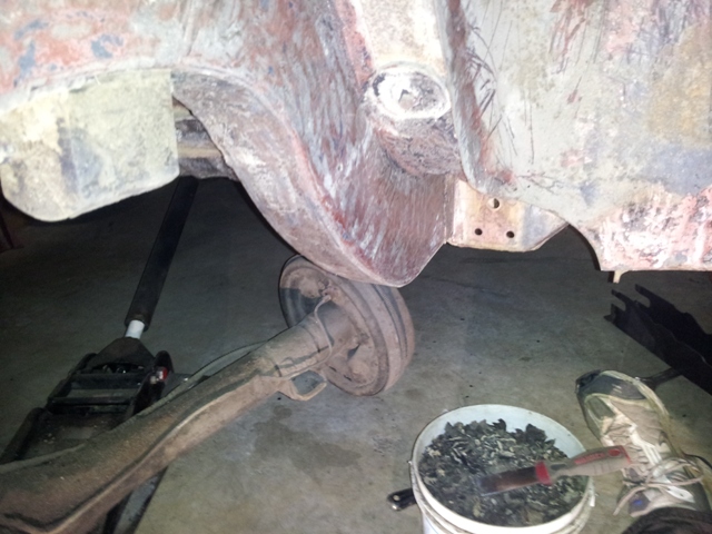

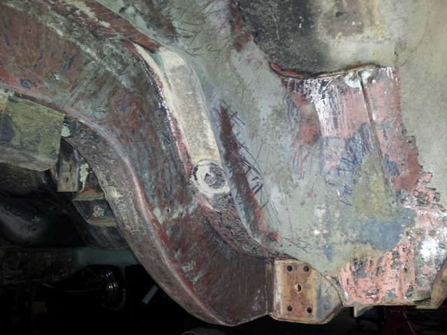

Switching it up . . . need a break from undercoat removal . . .

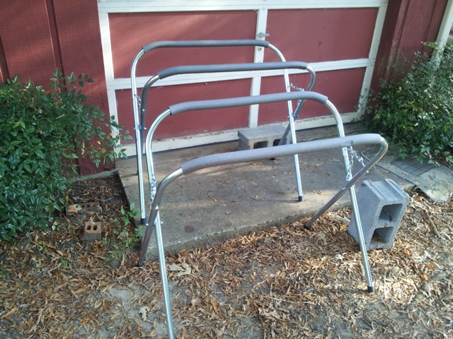

Didn't want to "eat" undercoating today and needed to work on something else . . . so . . . I was trying out a new item that I got from the car show . . .
A pair of 500 pound fender stands . . . they seem to work very well ! ! !

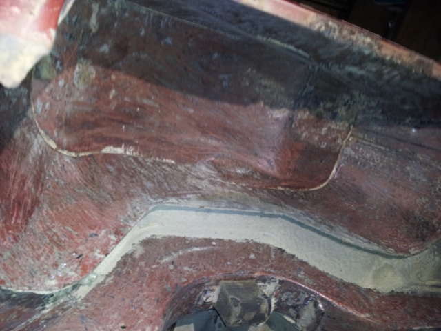

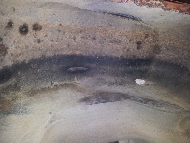

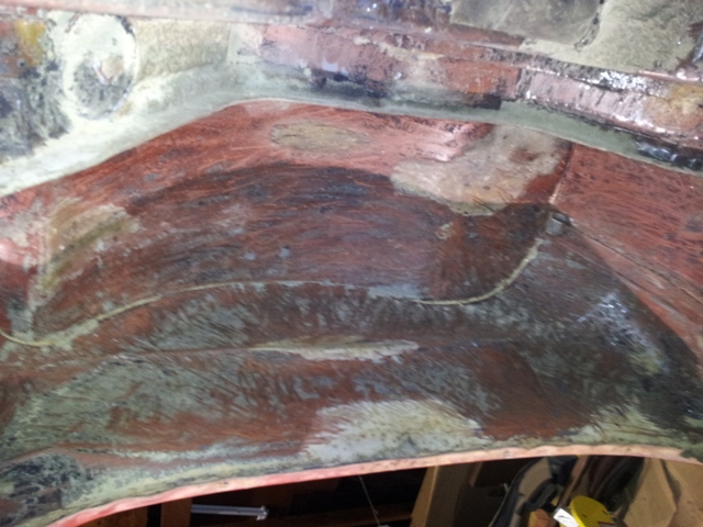

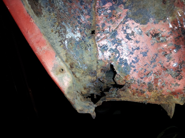

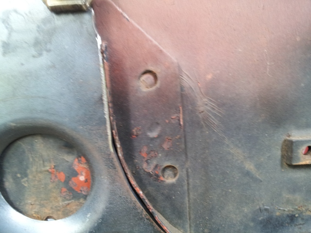

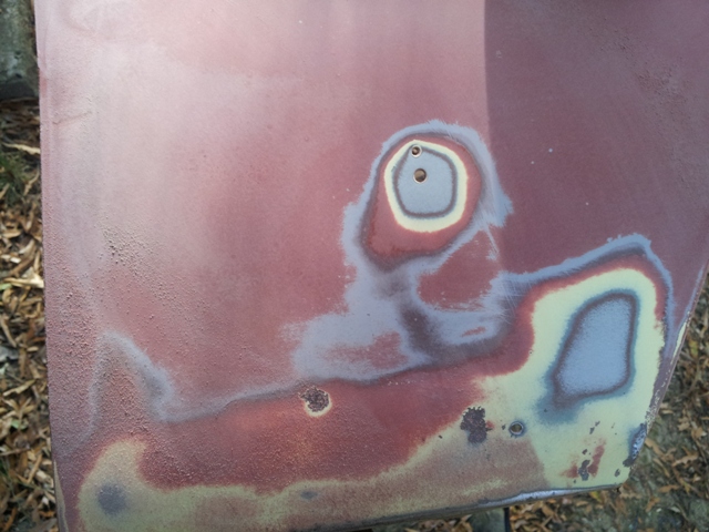

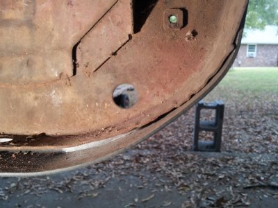

So I wanted to see what I had on my passenger front fenders . . .
(1) original primer (2) yellow paint (3) copper paint (4) black primer (5) grey primer (6) latest copper paint . . .
Want to get these all media blasted down to the bare metal and get all this paint off them . . . after I weld up all the holes and fix the rot.

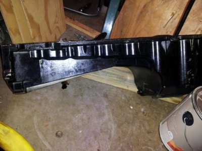

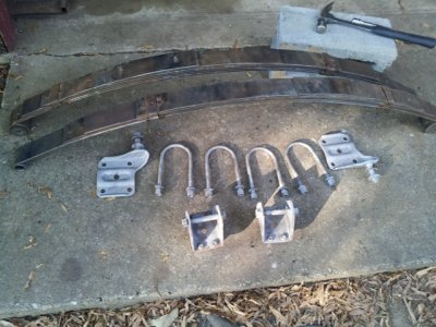

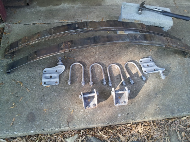

since I've removed the rear end from the car, I've got a bunch of parts that need to be cleaned up . . .
and now they're almost ready for etching primer and epoxy primer . . .

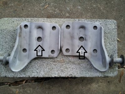

A little trick that I learned for marking part . . . if you want to mark parts and note if they were on the driver side, or passenger side, I've discovered this little trick to mark them easily. First, you can mark them anywhere, but I find an inconspicuous spot, and with a center punch, mark the driver side with a single punch, and the passenger side with 2 punches as seen in the parts below:
that way they'll always have a mark for where they go on the car - and it's barely visible. It helps me . . .
Tonight or tomorrow I get to figure out what I'm doing with etching primer and epoxy paint . . . but,
