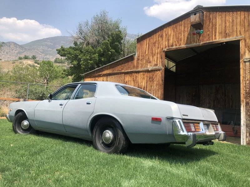

I can't sell the Monaco. One of my friends offered me $4500, I tentatively agreed, but I made no real effort to actually go through with the sale, so to celebrate, here's a couple of gratuitous pictures of it, in the yard...

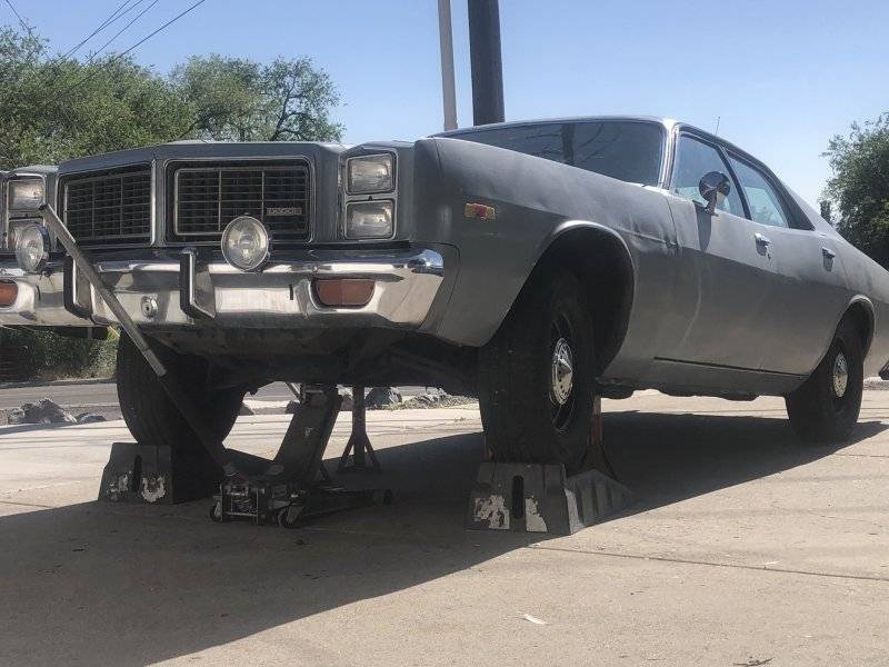

The car must have heard me, because I returned home that day, started the car and it ran like utter crap. I also decided to try and fix the trans leak. So, up she went...

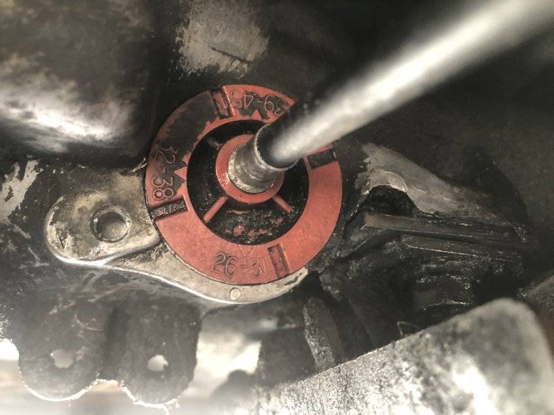

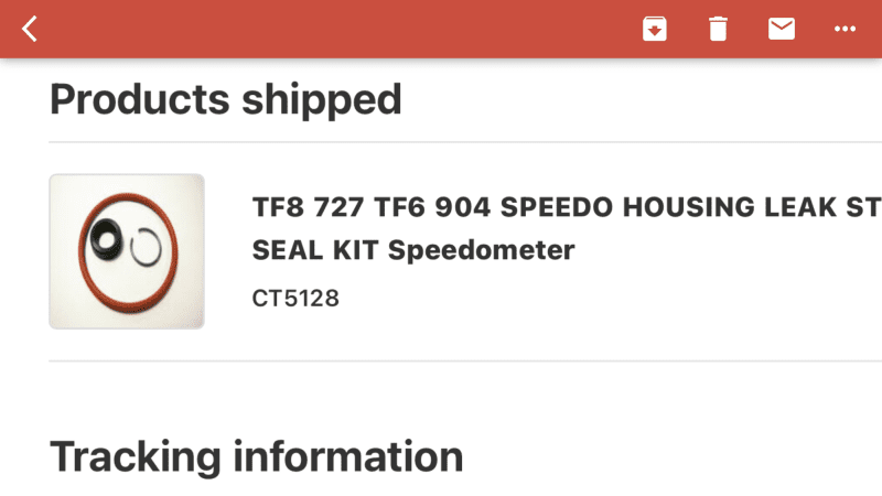

The leak is coming from the speedometer cable housing, which I bought a seal kit for last year. Since then, I've done less than 100 miles, but I've gone through a large jug of trans oil, so the seal kit was obviously useless.
It's coming from the middle, where the cable enters the round red housing. I took it apart and cleaned it thoroughly, reinserted the seals and added some oil resistant gasket maker. Let's hope that does the trick.

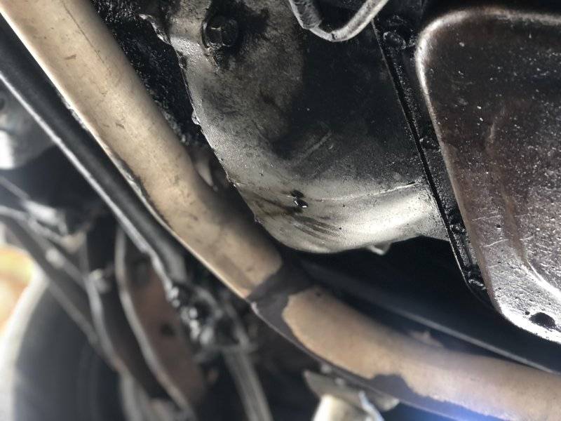

While I was under there I spotted the dreaded potential rear main seal leak again.
