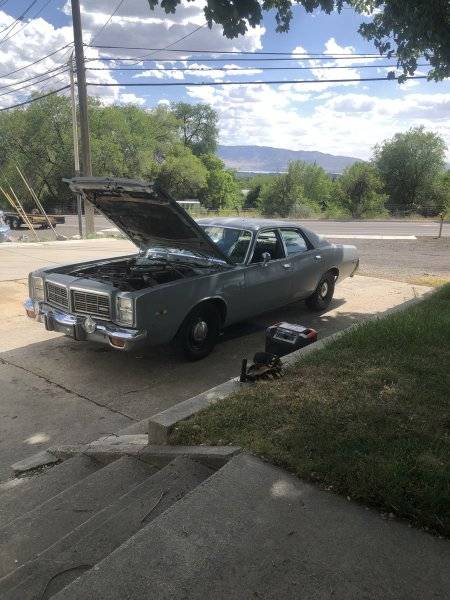

My 1978 Dodge Monaco 4 door sedan.

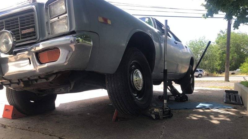

Two jacks, and a total of three 3000lb jack stands. Because....y'know, it's really heavy yeah.

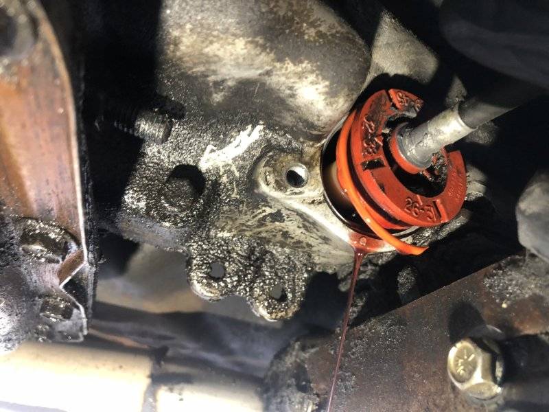

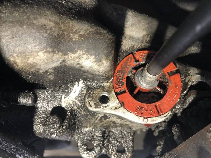

Once I'd pulled the screw-in holder off, I had another look at the speedometer cable housing and weirdly, my gasket maker seal has held, but the main red o ring looks to be drizzlin...
And then as I pried the housing gently out...yeah that seal is about as much use as a seventeen year old Walmart employee...

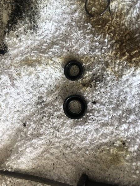

I pulled out the black o ring and for Pete's sake the new seal is way bigger than the original. So that wont work then....
Once everything was cleaned up super good and the big red o ring replaced, I threw all the bits back in and bolted it back up. Then I went for a drive. Quite an aggressive drive actually. I spent most of the drive, attempting to break the rear wheels loose. I was unsuccessful except when we were on the gravel part of my driveway - but that doesn't count. But it did push me to get the Mancini Lean Burn removal stuff underway asap.

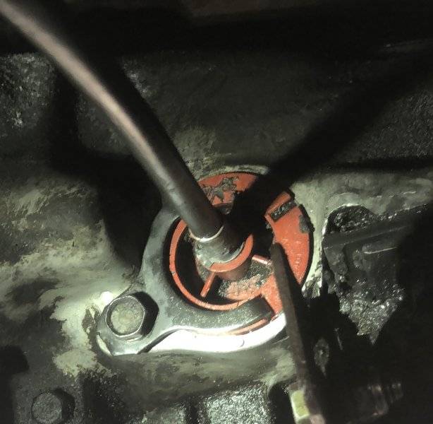

While everything was still hot I had a good look at the once leaky speedo-cable housing...
Drier than Ghandi's flip-flops! Excellent!!

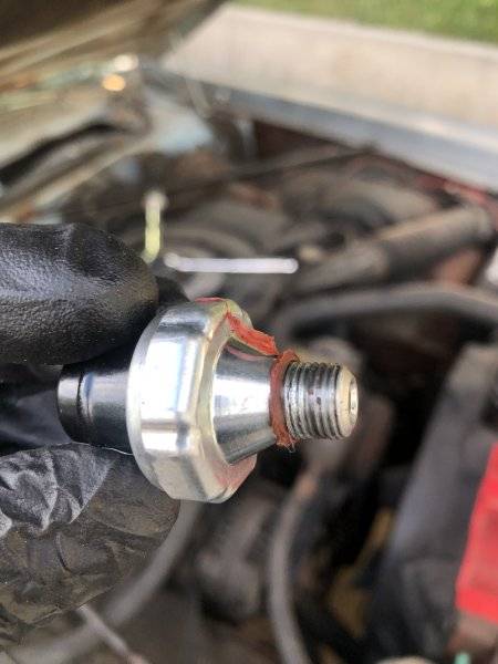

While I was under there, I looked into the engine oil leak that I hoped wasn't the rear main seal - and as some of you advised me, the oil pressure sender is the culprit. Out it came, a little red gasket is completely perished (what the blazes are these manufacturers using for gasket rubber? Cheese?)

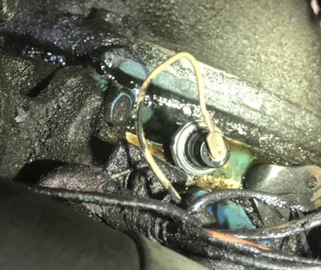

so I taped the threads up, gently screwed it back into the housing with a 27mm socket, making sure I didn't over tighten it, and did a long idle - dry as a bone. Then, I went on another aggressive drive. That "Italian Tune-Up" method really works - I don't think I've had so much fun in this car. Was really fun. Anyways, came home, had a look at the sender and...
^^^ that gold color is fresh engine oil. Well that won't do :-(
While my face was contorted into that spot where you can actually see the sender, I took a look at the base of the distributor as well - it's dirty but not leaking oil, it's definitely the sender.
So, fella's how would you deal with this? Put more tape on threads? Buy new sender? Tape up threads of new sender? Buy a burrito and pretend the situation is not happening? I favor the last thing, especially one of those carne asada burrito's mmmm...

Regarding the sender, and as you surmise, there are two places where leaks can happen: (a) the sender itself and (b) the threads.
I obviously can't see which is leaking, but the senders are infamous for leaking, so I would replace that. Leaking from the threads is not as common unless the sender is loose. When you put the new sender in, put some Teflon tape on the threads and tighten it up good. It's a pipe thread, so it seals based on the threads. So give it a reasonable "grunt" when you tighten it to ensure there is no leak there.

Goodness me fella’s, the trans leak is fully fixed, but that blasted oil pressure switch is geysering all over the place, even with Teflon tape and gasket maker. I’m wondering if a new sender would even fix that.
Sounds like it has been over tightened and oversized the hole possibly. Silicone will only work if the threads are clean and dry of oil. It has to be very snug in the hole. It could be the unit is ruptured internally and is leaking from that.

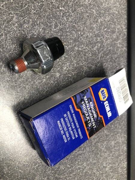

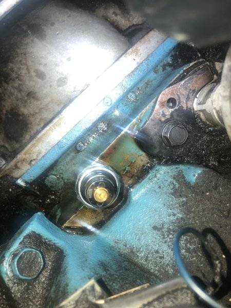

Last night after the Fire Service put out a rather scary grass fire right out the back of the house, I pulled the old oil pressure switch, thoroughly cleaned the threads and installed the new switch, with some teflon tape. Went for a blast around the neighborhood, and then...

Now, the threads are not jacked. I got a camera in there and checked. Is this puddle of irritation coming from my Distributor? Is there a gasket under that clamp there yonder?

Either back of intake or distributor O ring or gasket. Give you 2 guesses which I'd do first.

Gary,
I agree with nxcoupe for these two as possibilities. I guess I will also say that, unfortunately, the distributor is unlikely compared to the back of the intake manifold (based on my experiences).
I would also just quickly check that all the manifold bolts are tight.
If it is the back of the intake manifold, the proper fix for that is removal and replacement of the manifold. It's a big job, especially with A/C crap potentially in the way. To cheat (and potentially only as a diagnostic), I would (a) clean the area really well. This includes using carb cleaner to get rid of oily residue. Then clean it again - really clean and dry. Then (b) buy some oil resistant silicone and smear between the engine and manifold seam (Permatex makes some good black stuff). Get a good bead of it all the way around that seam. Let it cure. Then run or drive the car and see what you find. Do a short drive so you can potentially see where oil is coming from. The silicone should have at least changed the path of the oil leak. If it did and it's still leaking, at least you know have a confirmed source. If you got lucky, you were able to seal it or dramatically slow it down.
