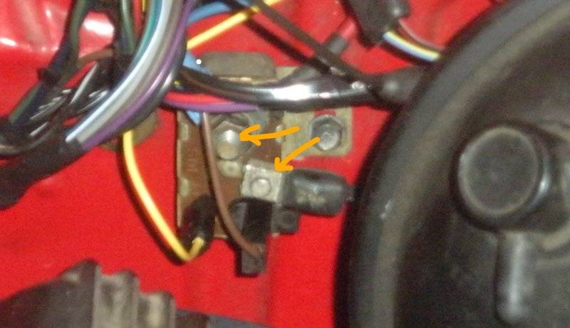

If you want to start the engine in an even simpler way, turn the key to the RUN position, take a screwdriver and lay the edge across these two terminals on the starter relay:
This will engage the starter. Once the engine runs, pull the screwdriver off.
I'm very glad I know this. I have my remote switch now but I am very grateful to know the back-up method! Thank you sir!
Not the brown wire that the neutral safety.
Yellow and battery.

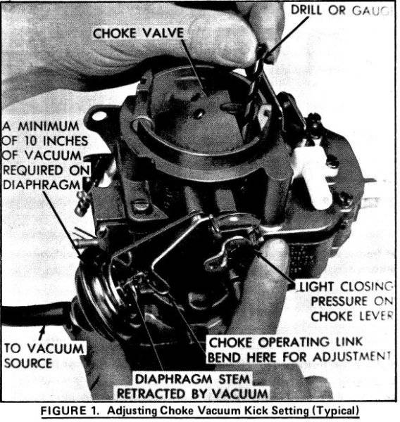

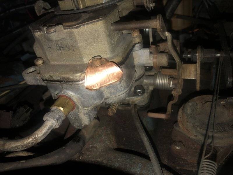

So I found this picture on Mikes Carburetor Parts website.
*Question: bottom left of the picture, where it's labeled "to vacuum source" - does that go to the vacuum advance canister nipple on the new distributor?
Yellow and battery.

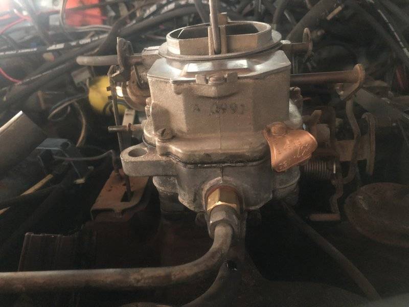

And here's my carb from the front
To the right side a little
To the left side a little

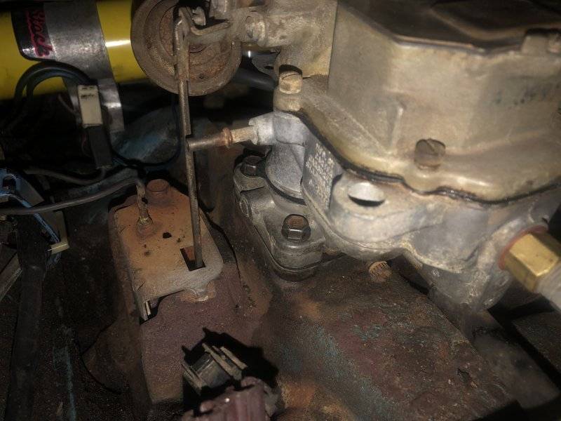

See that nipple next to the choke rod in the last picture? Why is that not capped off?
No, that is showing the hose for the chike pull off. It should go to the base of the carb to a manifold vacuum source.
I can't see the idle screw so it must be on the back driver's side of the carb.
Ok, I can cap that off. On my Lean Burn carb there's some kind of electronic thing mounted to that - it's more a shaft than a nipple. But I'll cap that sumbitch anyways.
So where would a vacuum hose from the distributor vacuum advance canister go on the carb?

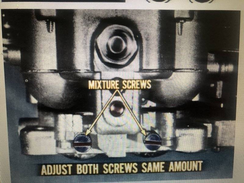

If you see the big brass fuel inlet, then look below, there are two screws, spring-backed ones below left and below right - are these the mixture and idle screws?
I found these pics. There's not much straight forward information out there, it's very complicated and requires a major search just for a simple thing like "what are these?" - but here's one answer, the screws are both mixtures...
and it looks like there's another screw for idle over by the vacuum thingamijig...
So, I'm going to cap everything off, hopefully get the Vacuum advance diz attached to something that makes sense, add the remote starter to the mix, try and get it to idle, adjust the timing (to what I don't know) and then....ummmm....yeah I have no clue what I'm doing here.
