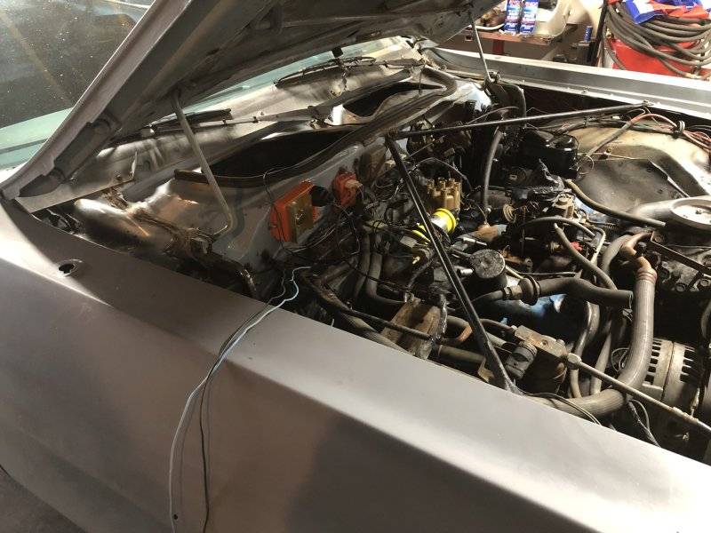

So, in 98F last night I began, using the very detailed Mancini instructions.

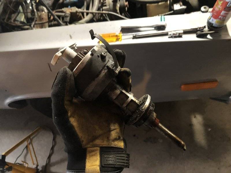

Old distributor came out, and sure enough the seal was broken, so maybe just maybe that's been the source of my stupendous oil leak.
Most of the wiring and the coil went in as did the new distributor (I took Don's advice above and made sure I could adjust the Distributor without the vacuum advance cannister hitting anything)

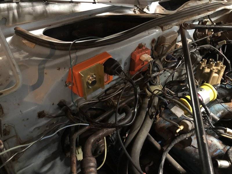

And there were two factory holes (by a complete coincidence) that allowed me to mount the new ECU to the recommended spot on the firewall.
This evening, I'll finish up the remaining wiring, and get into timing and other assorted stuff and things.

MAKE SURE the ECU is well grounded. If it is not grounded you will have no spark. A toothed washer will help assure this.

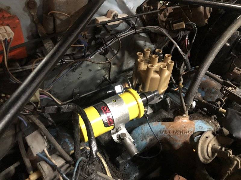

Gary, do yourself a favour and get that coil off of the engine and mount it vertically somewhere on the firewall.
I know the firewall looks pretty busy with everything on it but you should be able to find a place for it.
Or what about mounting it on the passenger side inner fender? you'll have to get a longer coil wire for the distributor cap tho.
Ignition coils should be mounted vertically.
Thanks Hawk and Beeper - I was coincidentally thinking about remounting the coil last night, now you’ve mentioned it I’ll take a good look this evening and see what I can do. Good advice from you guys as always.
Speaking of last night, I had an hour of complete panic. The Mancini instructions, although very complete, and very easy to follow, suddenly on the final three stages of the wiring, became almost impossible for me to comprehend. Cut the BAL wire from the starter relay, add wire…… ummm…… what do I do with the remaining bit of wire? Blank it off? And the positive wire from the coil…. The instructions kinda left me to figure that out for myself
Quoting Jackie Gleason in Smokey and the Bandit “I’m as confused as a baby raccoon”.
Well, BAL wire from starter relay joins to positive wire from coil and both go to the ballast resistor - at least that’s what I’ve worked out. We’ll see if I’m right later.
