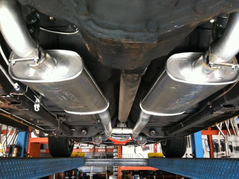

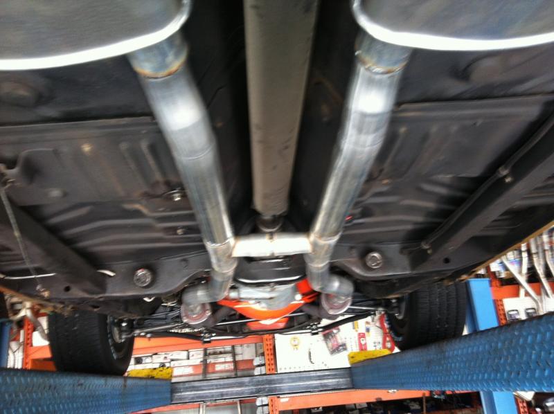

Just got a call from the exhaust shop...after several delays they say it's done. On my way to pick it up in a few hours.

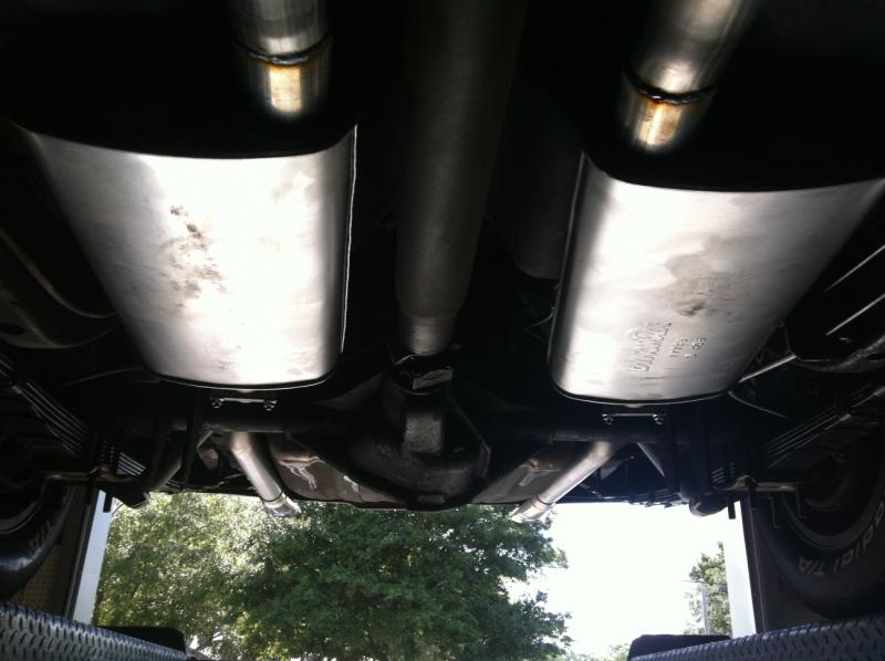

Just got back from the exhaust shop (Mad Hatter in Tampa if anyone is curious). I think they did a good job and the car sounds great. It has a nice throaty sound outside and is soooooo much quieter inside. The idle evened out a bit too with the crossover (perception at least).
They custom made the pipes from the header back to the mufflers, I supplied the the H-Pipe and everything from the mufflers back to the tips. Cost was $300.

that exhaust looks good!
That sounds like more then a decent cost on your exhaust, She looking good for sure!!! :)

I should also say that I now hear a bunch of little noises I will have to address (exhaust leak at the gasket between head and header and others).

I can say I wanted quiet in the interior, but I didn't expect it to be so subdued. It is a major difference from the Flowmasters that were throaty as he'll be you couldn't come close to talking to someone in the cabin. I think if I had to do it over agin I might go with the Ultraflows or even Flowmasters. I think the big difference came from extending the tips to the rear and the H-pipe. The sound in the clip when I come around the side of the car is sooo much quieter and thinner than expected and also shows that I have a few other things to take care of like exhaust leak at header. The engine went from roaring beast to a lot thinner sounding which I didn't expect (everywhere except at the tail pipes, where it sounds great IMHO).

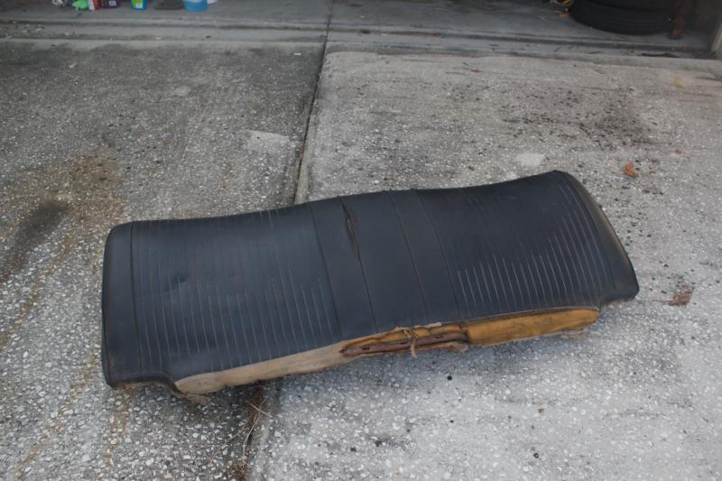

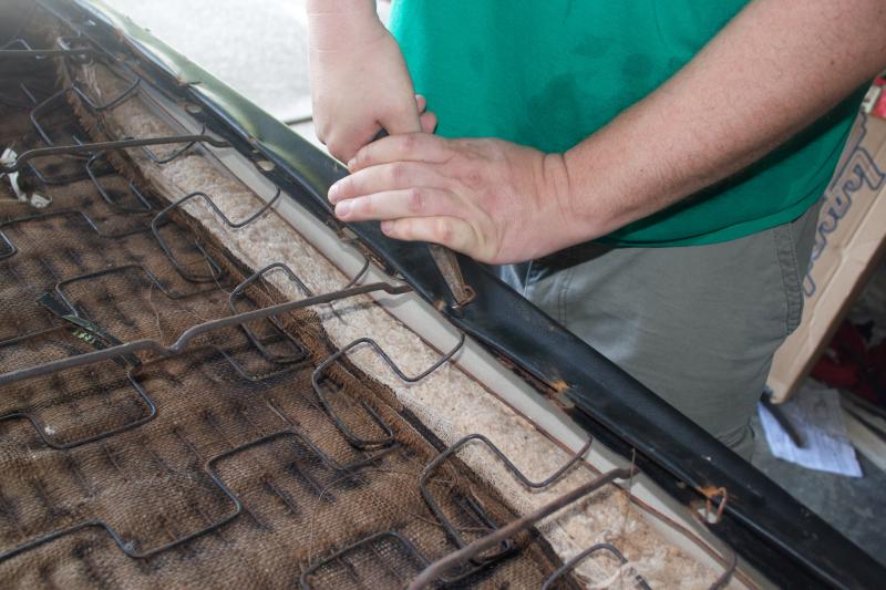

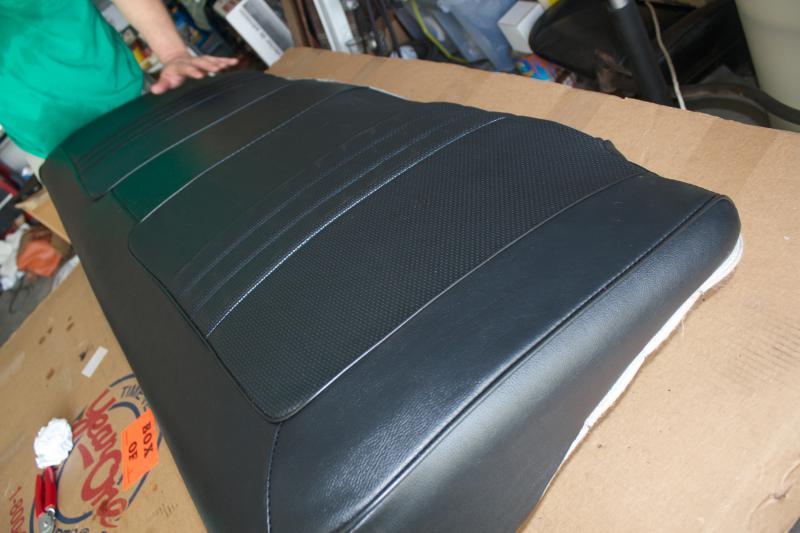

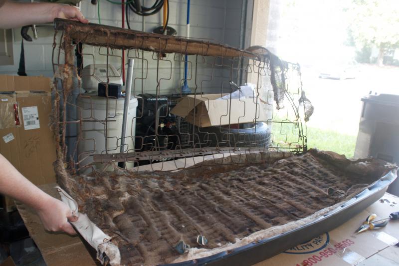

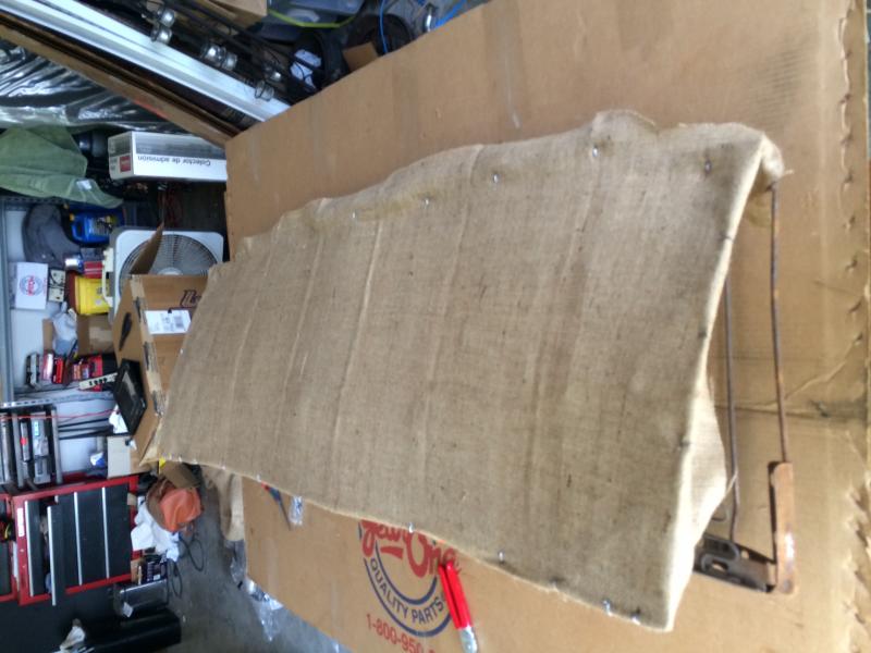

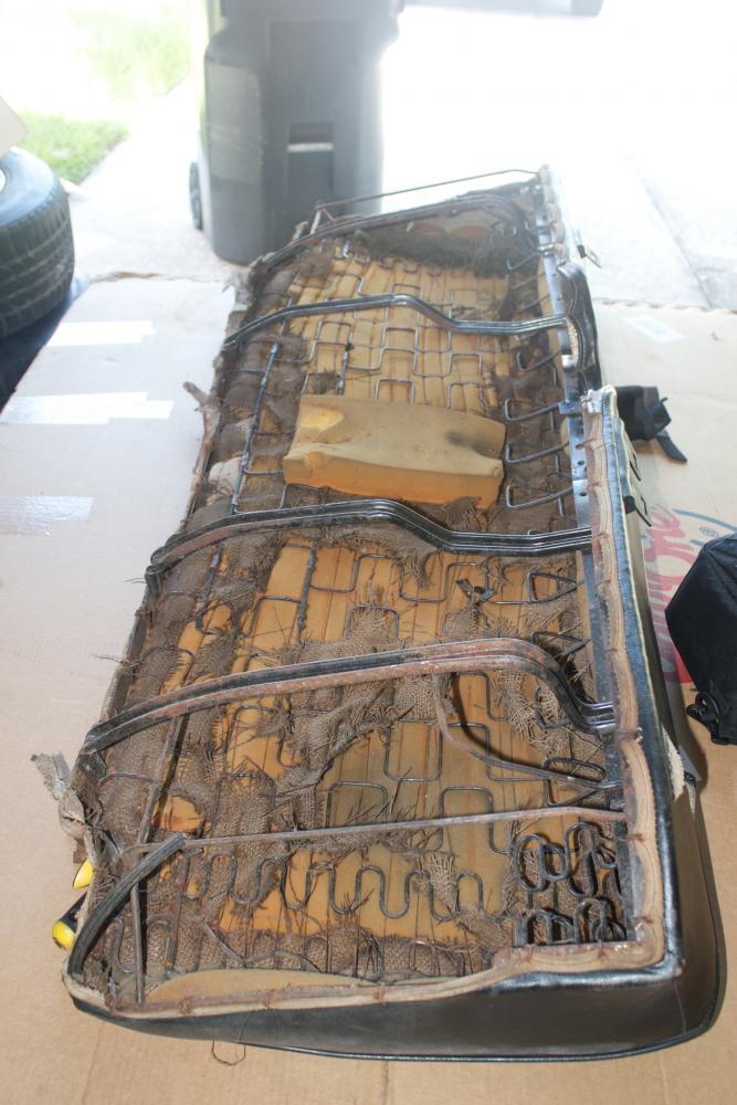

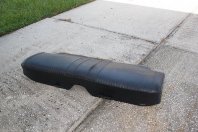

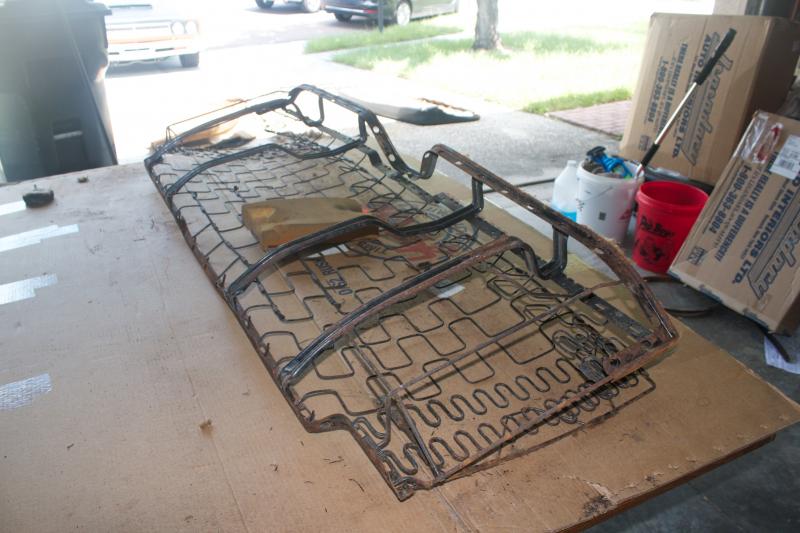

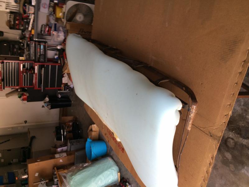

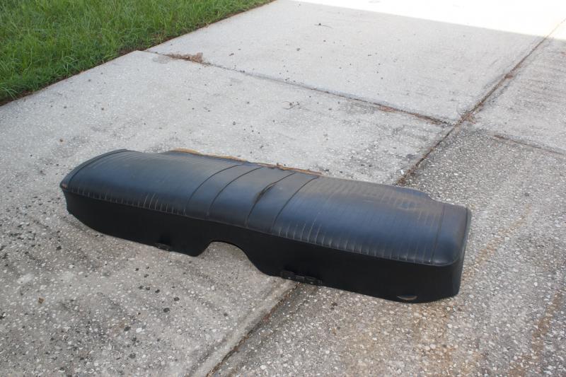

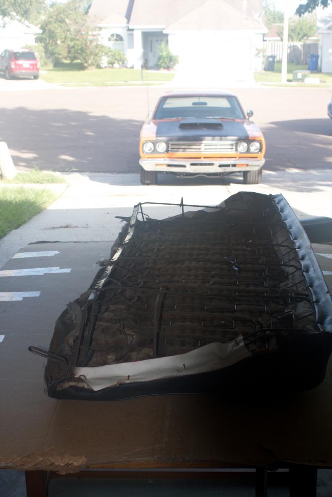

Started Re-upholstering the rear bench this weekend. Other than the extreme annoyance of running out of hog rings half way through the job and then realizing that no brick and mortar stores, open this weekend, have them in stock.... all is going well
The seats are not original to the car and were out of a Sport Sat I think
I got the bottom seat done and I think it came out good. You can thank my wife for the pictures as for some reason she got a kick out of the fact I was doing upholstery and decided to document it.
IMG_9114 - 2014-08-30 at 05-49-06.jpgIMG_9115 - 2014-08-30 at 05-49-13.jpgIMG_9109 - 2014-08-30 at 05-47-42.jpgIMG_9123 - 2014-08-30 at 06-06-49.jpgIMG_9136 - 2014-08-30 at 06-08-55.jpgIMG_9141 - 2014-08-30 at 07-34-27.jpgIMG_9143 - 2014-08-30 at 08-36-26.jpgphoto 1-1.jpgphoto 2.jpg
