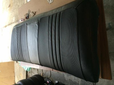

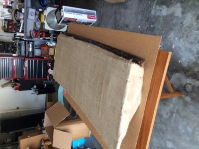

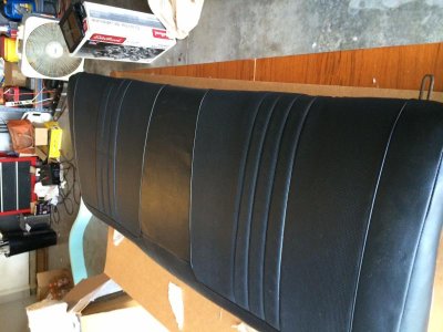

OK... I found the only store in the greater Tampa Bay area that carries Hog Rings... a CarQuest 30 miles away had 400 of them. I bought 100....at the end of the job I had 1 left! All total I think I used 199 to do the job.

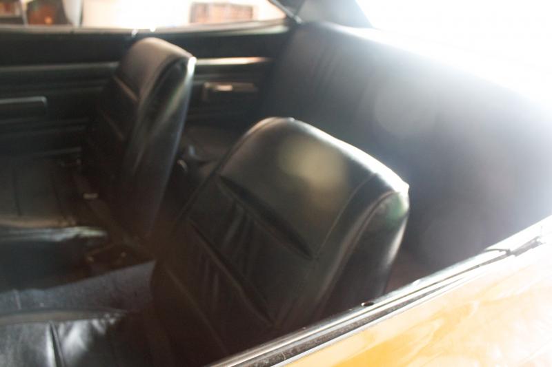

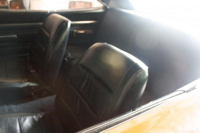

I just put the seats in the car and they look great! Only thing I would do different is the padding across the top of the upper seat is a little lumpy. I may try to massage it out, but all-in-all I'm very happy. I'll post pics of them installed later today.
looks pretty good! lay the seat in the sun and that should smooth out.

Hawk, for the rear seats, you could probably buy all the stuff for half that from a local upholstery supply shop. There is nothing special about what comes in the kit (although I did pay the $175 myself)
Burlap, muslin, cotton, hd foam and some listing wire. I haven't tried to price it individually but I have a hard time believing that those items would run over $90.
Ok I take it back, I just priced from a local shops website and it came out to $140. Although you would get enough burlap and muslin to do both front and rear for that price... Might be able to do front and back for $210ish? Better than $350. It was good having the kit the first time out, but I would buy from upholstery shop if/when doing it again now that I see there is really nothing magical in the kit (I hate when there is nothing magical in the kit).

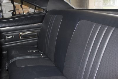

Here's a finished shot I took from my website... the pic is a little small, I'll replace it with a better one later tonight.
looks pretty good considering who did it.......:poke::laughing6:
Thanks guys, I like how they came out.

If you need interior supplies check these guys out http://www.dltcorporation.com/ I bought hog rings by the pound from them for what the mail order houses were charging for a package of 10. The other suggestion I have is invest in a decent pair of hog ring pliers the crappy ones they included with the seat covers broke after about the 10th hog ring. Back bench seat and back are a breeze the buckets that is another story. back seat took about an hour and a half for both the buckets about 4 hours each and a lot of F-Bombs. LOL
