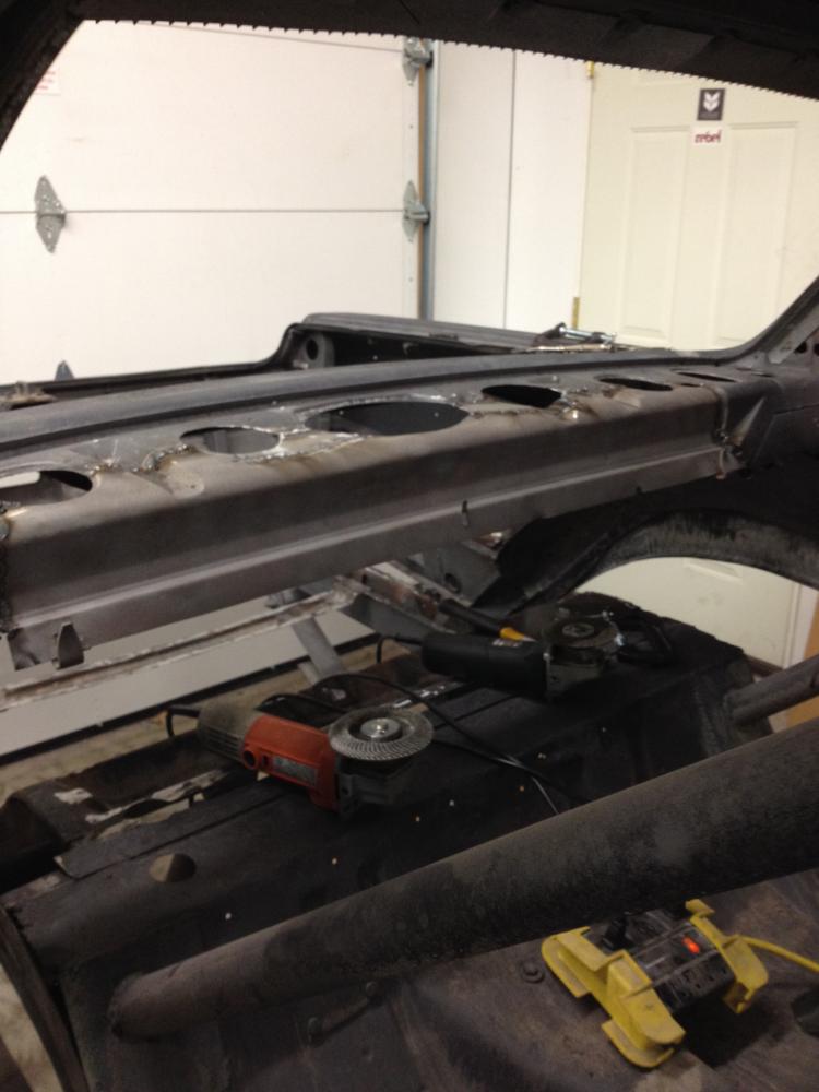

I got the package tray in today. Just need to get the welds cleaned up and put some primer on it, so it doesn't rust. Wheel tubs are next.. Then button up the trunk and move to the inside floor. The AMD floor came today. Hopefully it fits as well as the trunk has.

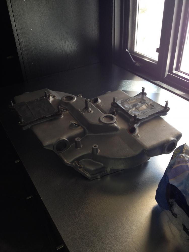

not a ton of progress. patching small holes in the floor, getting closer 1 inch by 1 inch. I did find and buy a stage III cross ram though. Ouch $$$$$$$$ Looking for a pair of Carter 3705 carbs to complete the intake. Hoping to make more progress this weekend.
Intake looks great, excited to see it assembled. I love the look of those engines, maybe more than a Hemi!

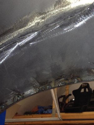

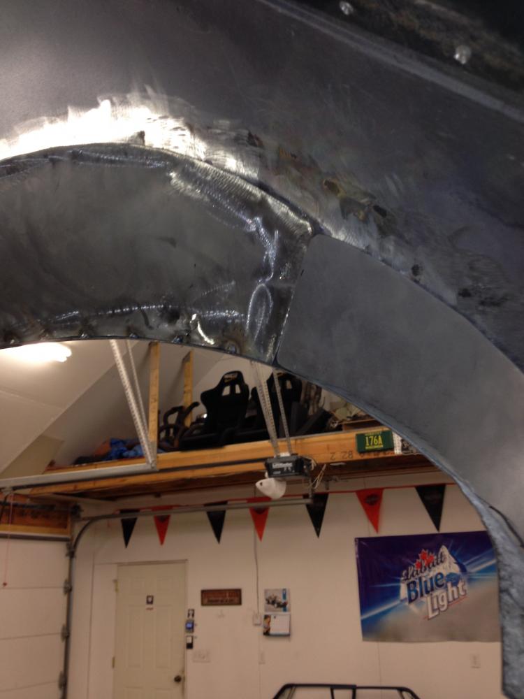

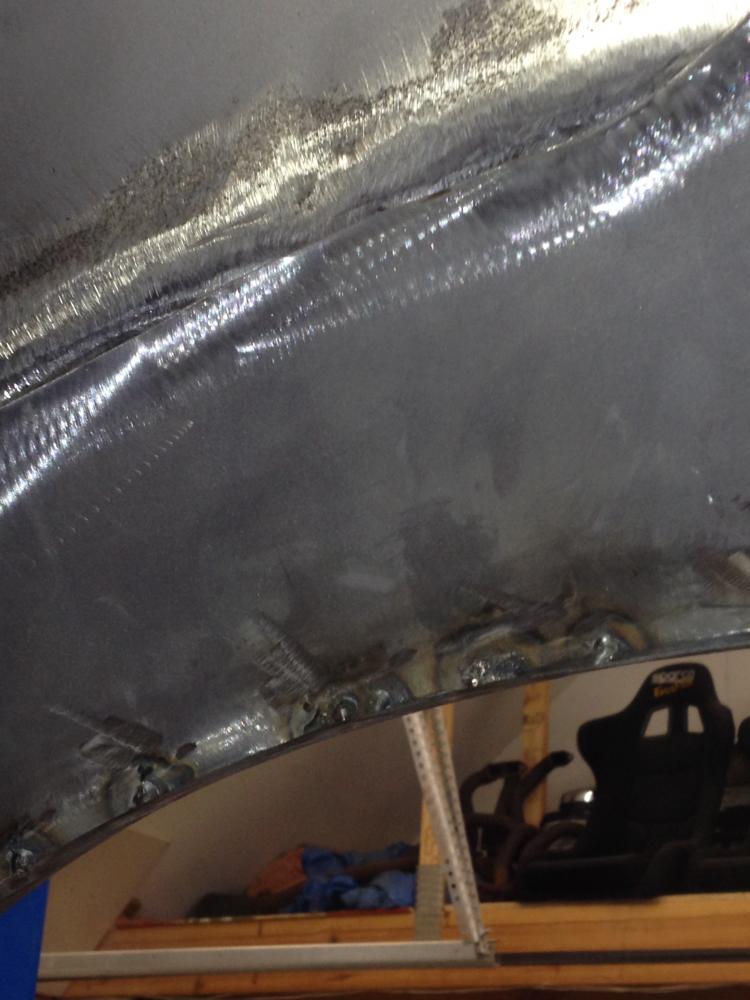

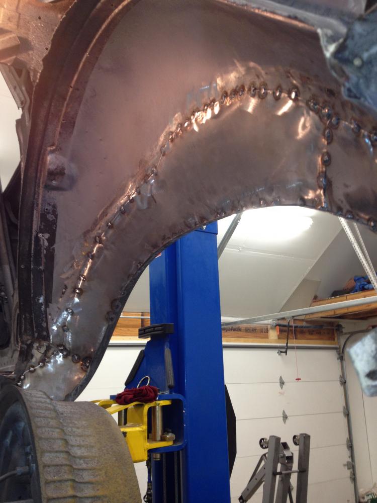

I would have had my inner fenderwells patched in and done. But I ran out of gas for the wire feed. :( At least I have all the pieces cut and ready to burn in. IMG_1583.jpgIMG_1587.jpgIMG_1589.jpg

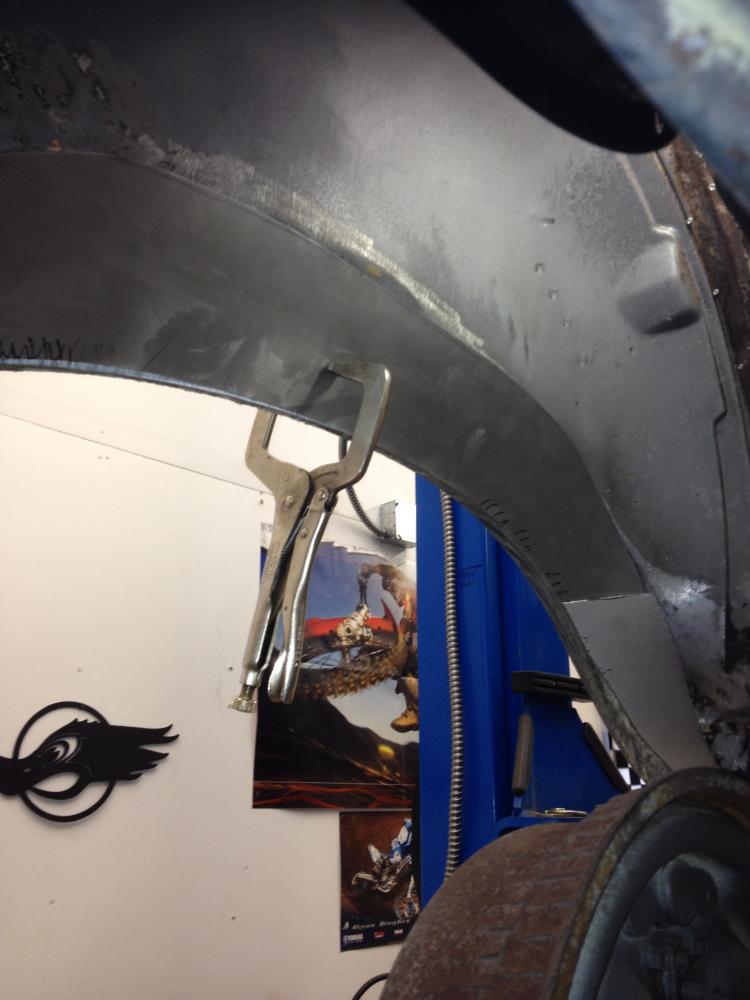

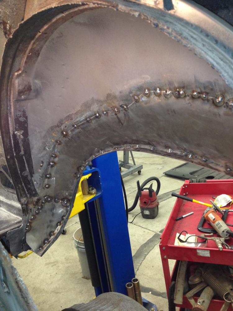

wheel wells are done. now need to get wheel tubs and trunk hinge in. Finally making some progress. I also plugged 30+ rivet and drill holes.. IMG_1618.jpgIMG_1620.jpg
How's your neck feeling? Don't you just love going over someone elses work! Looking good...
