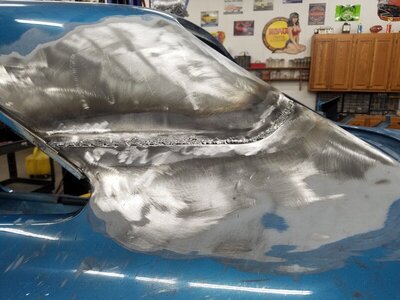

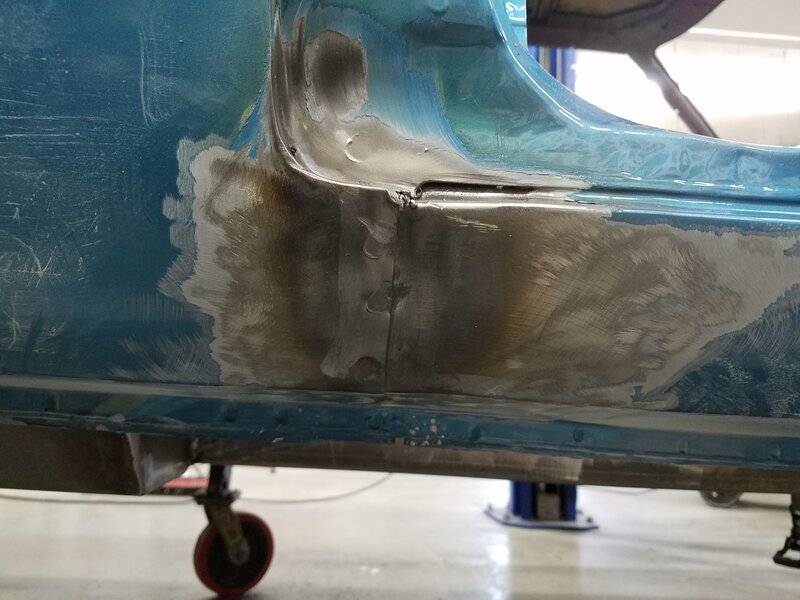

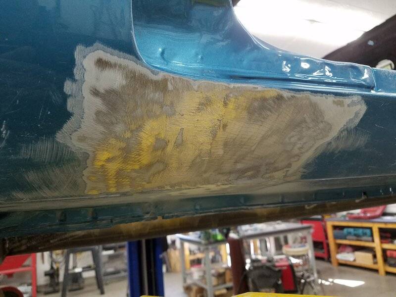

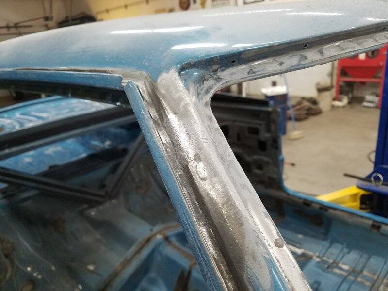

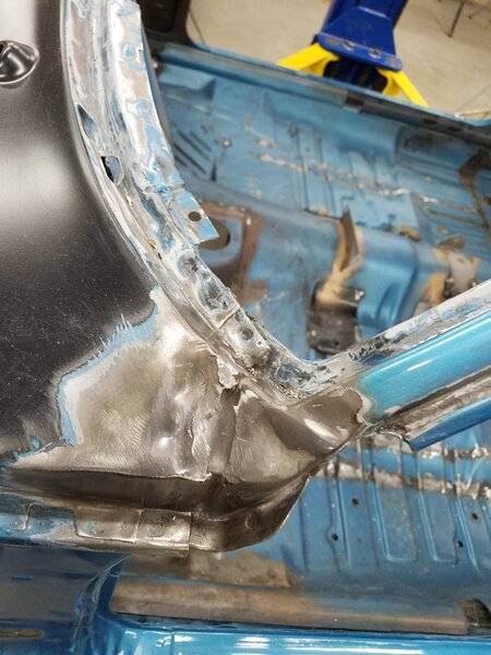

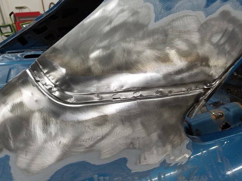

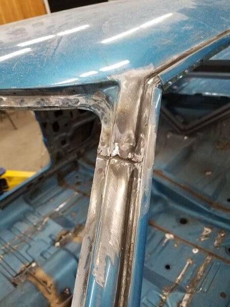

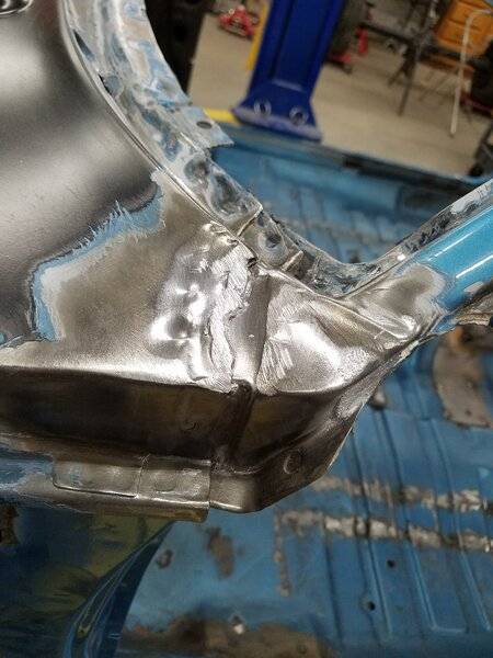

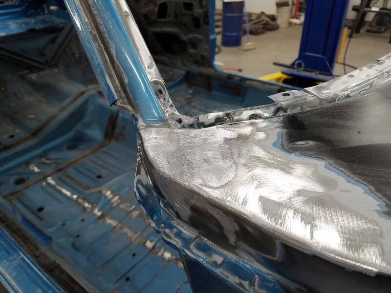

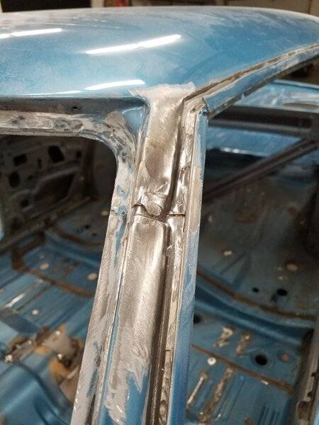

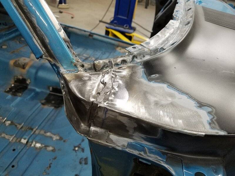

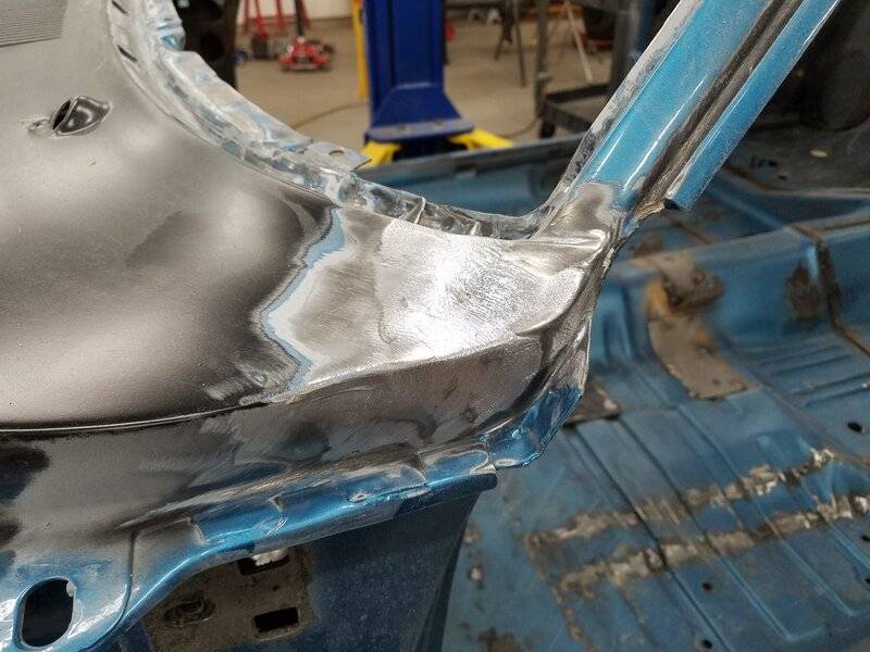

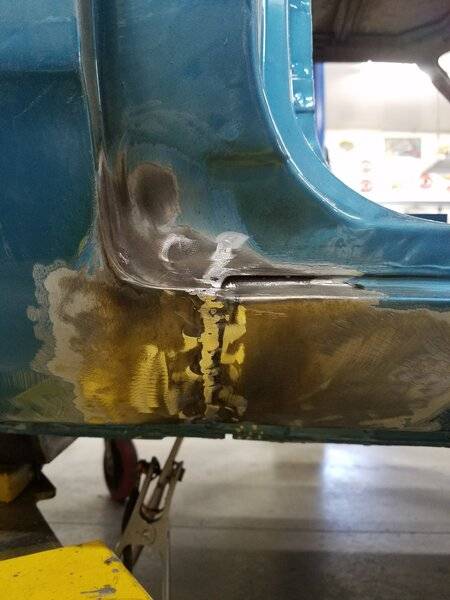

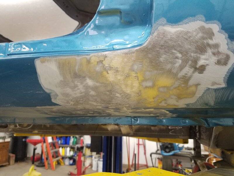

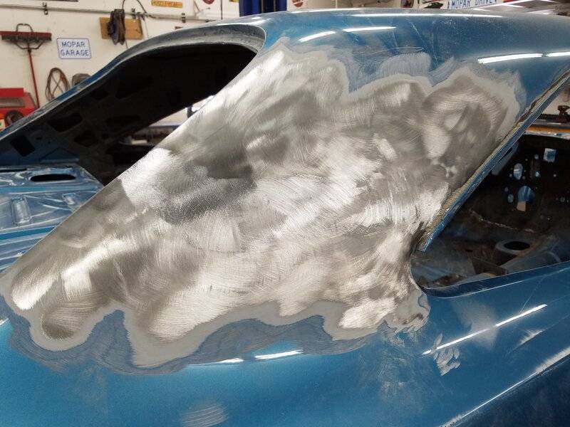

8 factory leaded joints on these old cars. I have got in the habit of removing this and welding the seams solid. This was my Saturday project.
20210206_141217.jpg 20210206_141226.jpg 20210206_141322.jpg 20210206_141334.jpg 20210206_141345.jpg 20210206_141350.jpg 20210206_141400.jpg 20210206_141406.jpg 20210206_141828.jpg

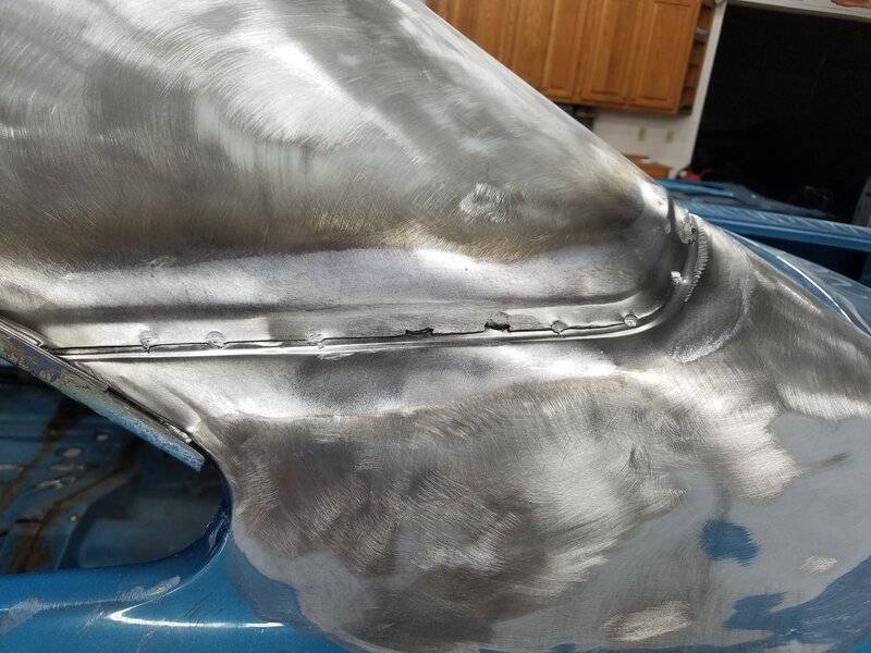

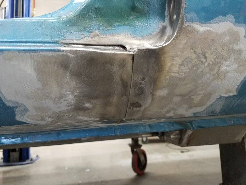

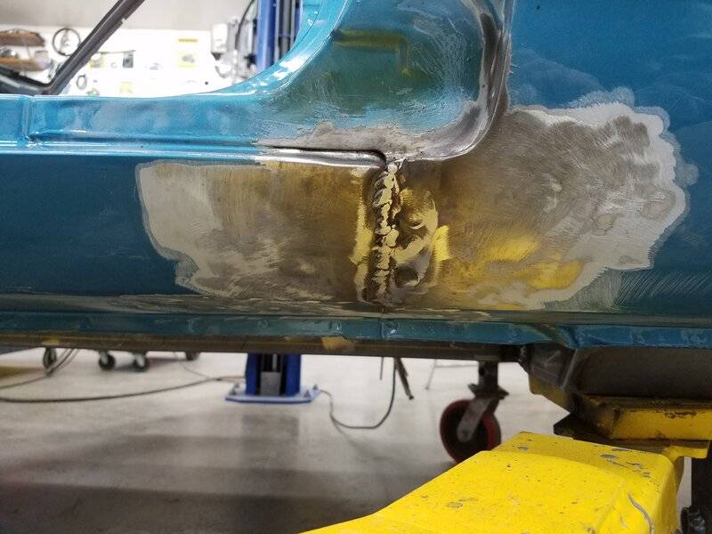

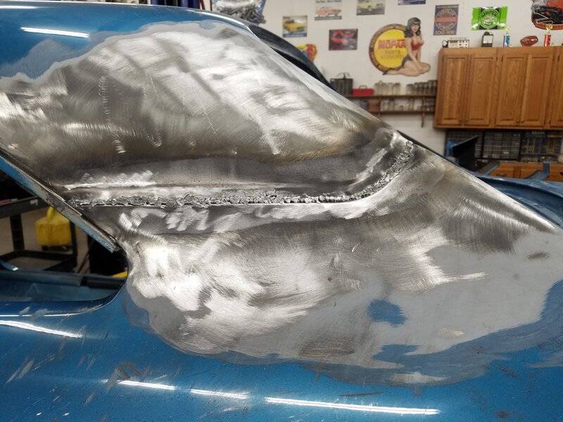

I have seen some pretty crappy stuff under the lead on other cars, but was pleasantly surprised on this one. Probably the nicest factory work I have seen overall. Lead melted out gently with a propane torch as well as cleaned out the drip rails.

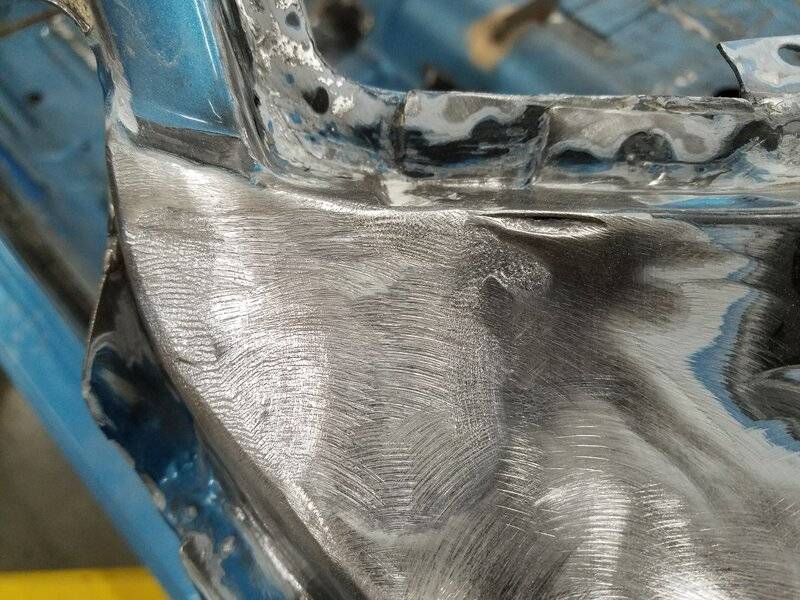

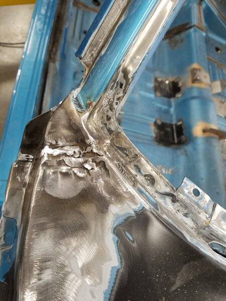

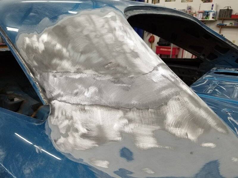

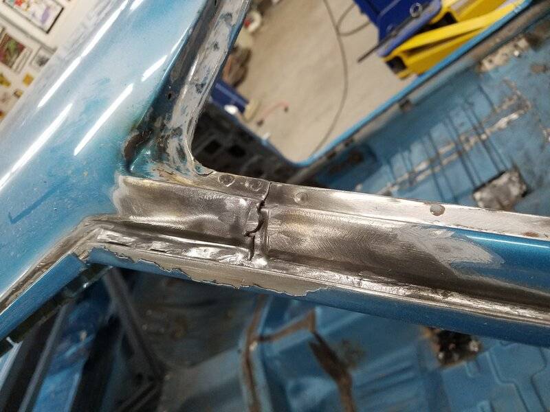

20210206_153434.jpg 20210206_153441.jpg 20210206_153452.jpg 20210206_153457.jpg 20210206_153507.jpg 20210206_153512.jpg 20210206_153522.jpg 20210206_153529.jpg 20210206_162449.jpg

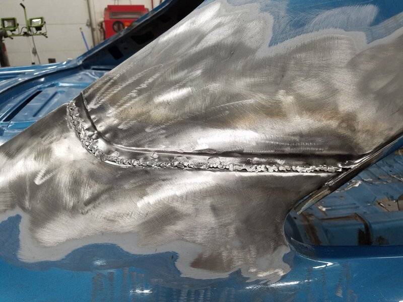

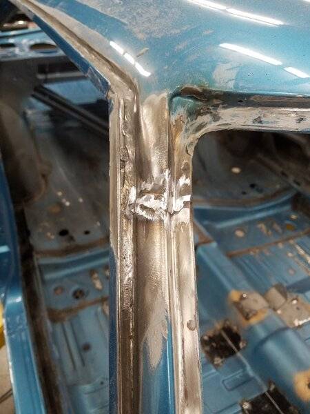

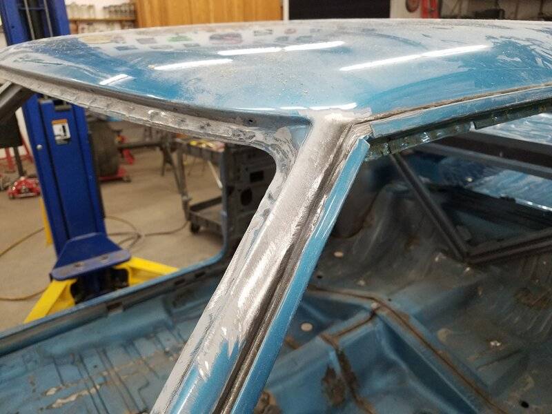

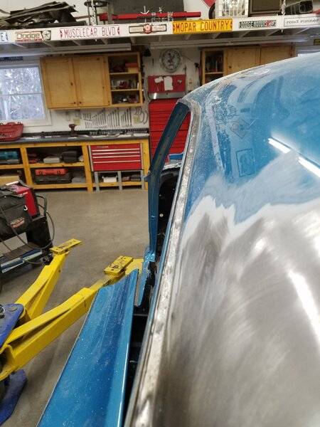

Welded up solid. Doesn't look the best especially on the C-pillars, but penetration is nice looking at the backside. Doesn't matter how much you heat this area with a torch, some lead is always trapped in the joint preventing a nice weld. So I just do the best I can with tack welds so there is no warpage.
20210207_101836.jpg 20210207_101842.jpg 20210207_101849.jpg 20210207_101853.jpg 20210207_101903.jpg 20210207_101913.jpg 20210207_101925.jpg 20210207_101931.jpg

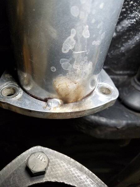

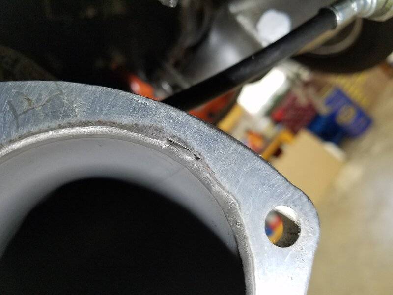

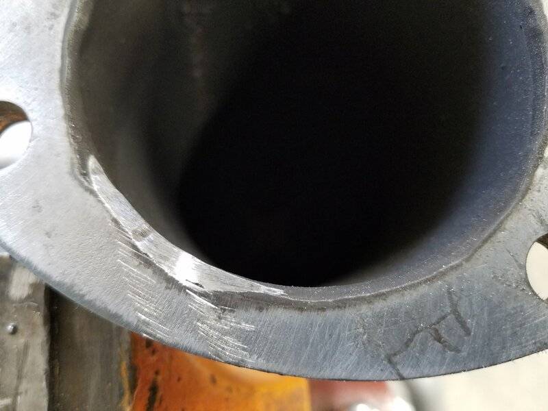

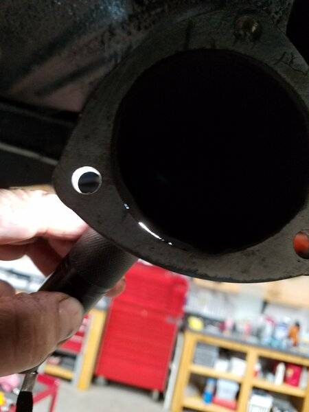

I bought these TTI headers 10 years ago and always noticed discoloration in a couple of spots around the flange. Come to find out that quality control was not up to par the day they were made apparently. 2 spots around the circle didn't get welded. Called TTI kind of expecting them to repair it since it was their fault. I was told to just weld it up and file the flange straight. So I did and fingers crossed that it seals and no damage was done to the ceramic coating. Kind of sucks to pay $900 for headers and have to finish welding them up.

I've been thinking recently of welding up the joints on my Charger.
Yours looks great.
Did you add any metal to yours or just build it up with weld?
Yours looks great.
No new metal, just welded the 2 areas that TTI missed.
Sorry I meant the 8 leaded joints on the body!
My mistake, my mind was on exhaust. I don't add any metal to the 8 joints. The 4 a-pillar joints you can fill in good with weld, but the c-pillar and rockers I just tack till the seam is covered. Don't want to heat those areas up too much and take a chance of warping. That with the original spot welds is stronger than it originally was imo.
Ok cheers. I think I'll do the same as otherwise it's either lead or filler and I don't like filler and have never used lead. Hopefully it will come out as good as yours did!
I believe most use USC ALL-METAL to fill those joints
I know when I had Fred in the body shop, he already had one c-pillar that had bubbled up
from the previous owners' dubious painting/prep work, so they asked me if I wanted them
to fix it while they had the car.
I said "sure", not knowing what they actually meant....
when I went out to check on things, they handed me a big wad of (cooled off obviously)
molten lead - they had done BOTH sides, melting out the original lead and redoing the joints
with weld, then filler. They matched paint perfectly, too - it looks fantastic now. :thumbsup:
