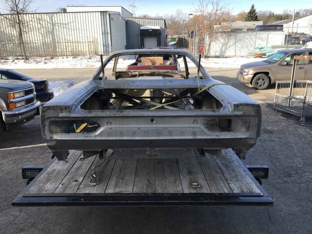

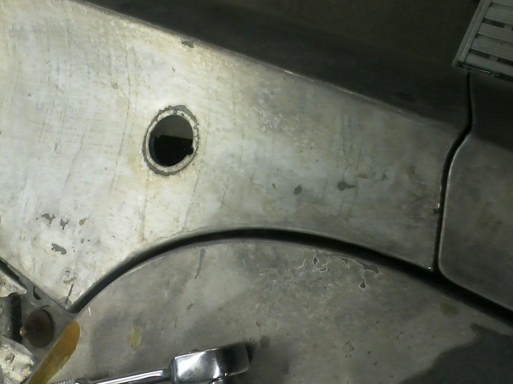

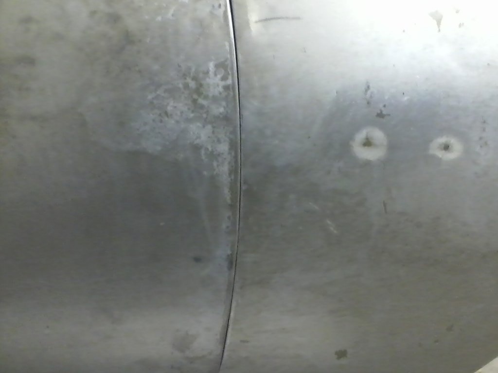

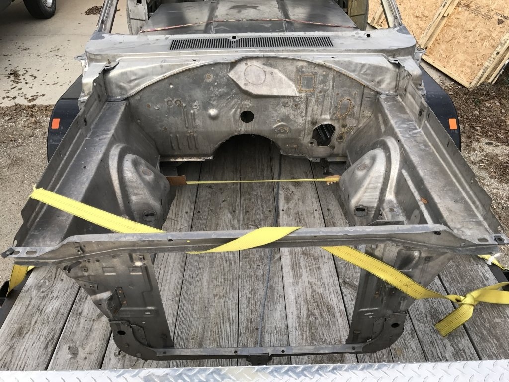

Well anyone following this ever wondered about chemical dipping your car...SHAZAM worth every single cent. My god it is beautiful and my car is not as I thought. No holes in hood. Trunk lid is 99.5% perfect thanks hemirunner. The fender I bought from challengersteve is perfect, thanks. The hole front end good but one little spot. Rear frame rails quarters trunk floor and extensions all getting replaced. Will post more pics tonight.

Can't wait for the pics!
Cool! Did you dip the Air Grabber hood I sold you or are you using a different one? I hated to get rid of that trunk lid as the 70's are hard to find in that condition but this new fibergass one I have wont rust! Lol
That's awesome, congrats my man:thumbsup:.

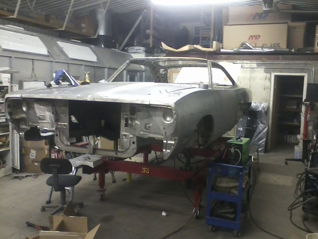

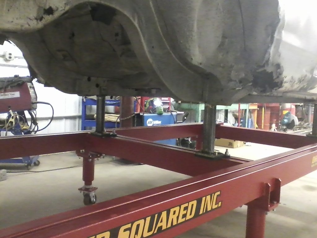

Well it is on the frame jig. I had the service manual for the 70 satellite and it has all the stock measurements from the factory body plugs. So he has it all plates welded in and measured up. Let the welding begin. I will try to post more pics but work is kicking in again. Gotta pay for this bad boy some how. Lol
Man that's awesome, can't wait to see it come together!

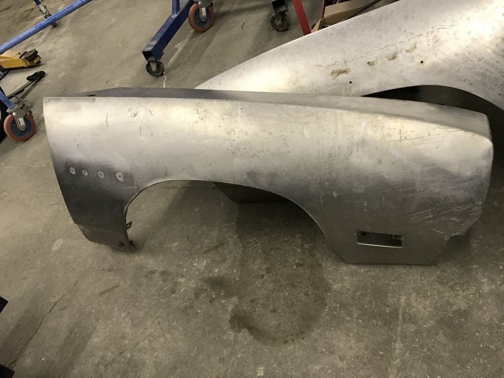

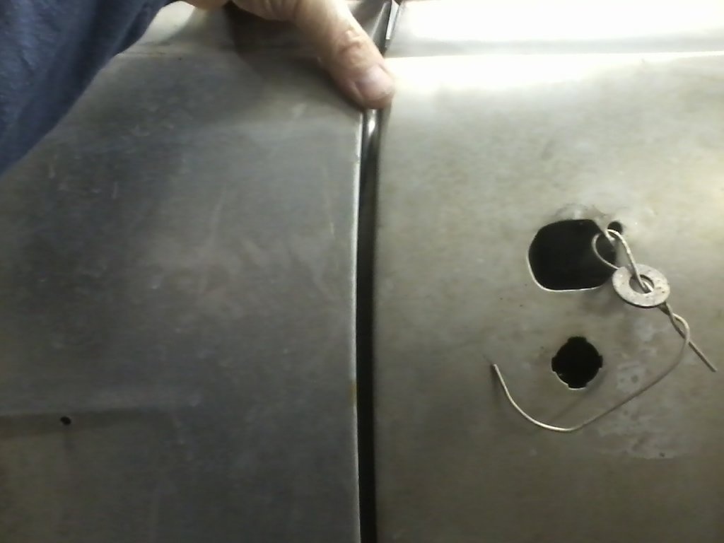

Doing a little front end body fit looks like the fenders should be pretty good, but these AMD door hinges look nice but are gonna need some modifications to get all the body lines the best we can get. He said if he has to he will do some cutting an splicing of body panels to get the gaps right. I knew my buddy was real good but he going over the top on this. As with 747, goon, hemirunner. I can't wait til it all comes together too, I'm pumped.

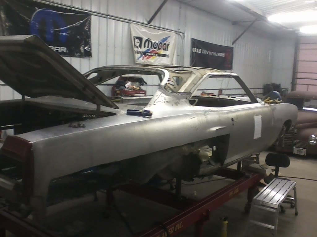

Well we got the fenders doors hood trunk lid back on. He cut the roof skin on an cutting the quarter panels off to start working on the inner metal. Here's some pics
:thumbsup: Keep that ball rollin! Looking great.
