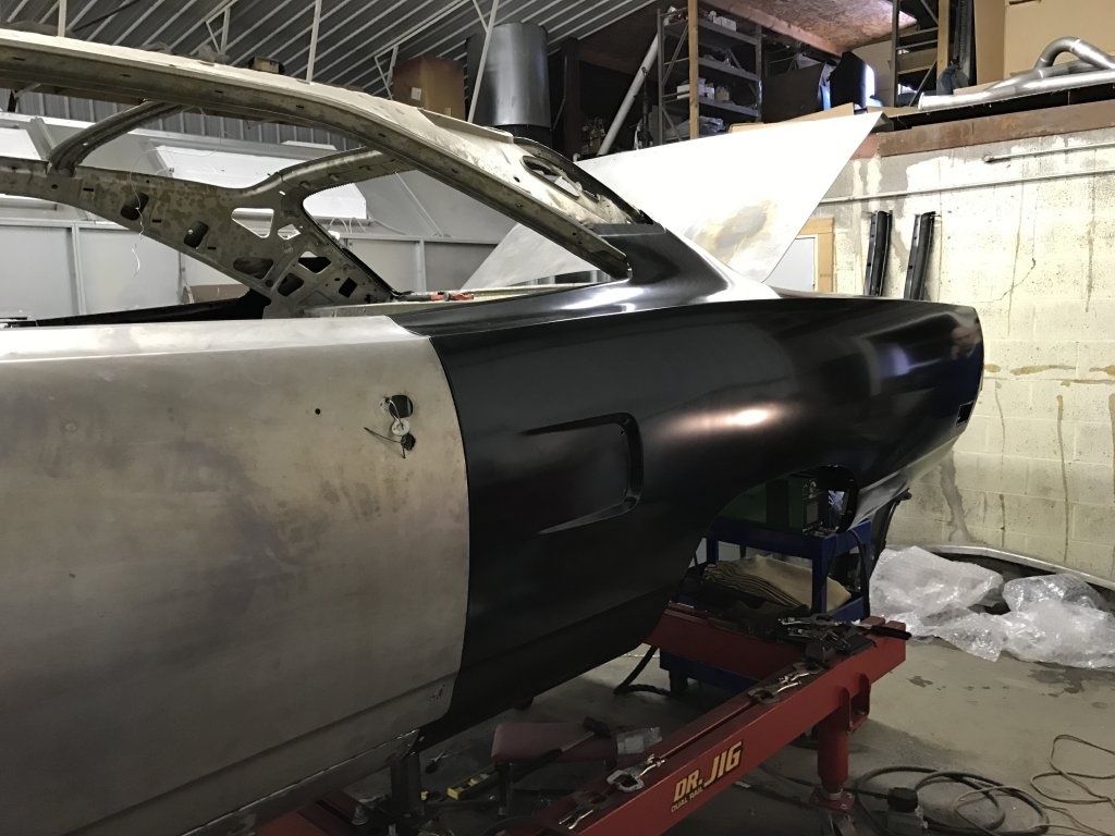

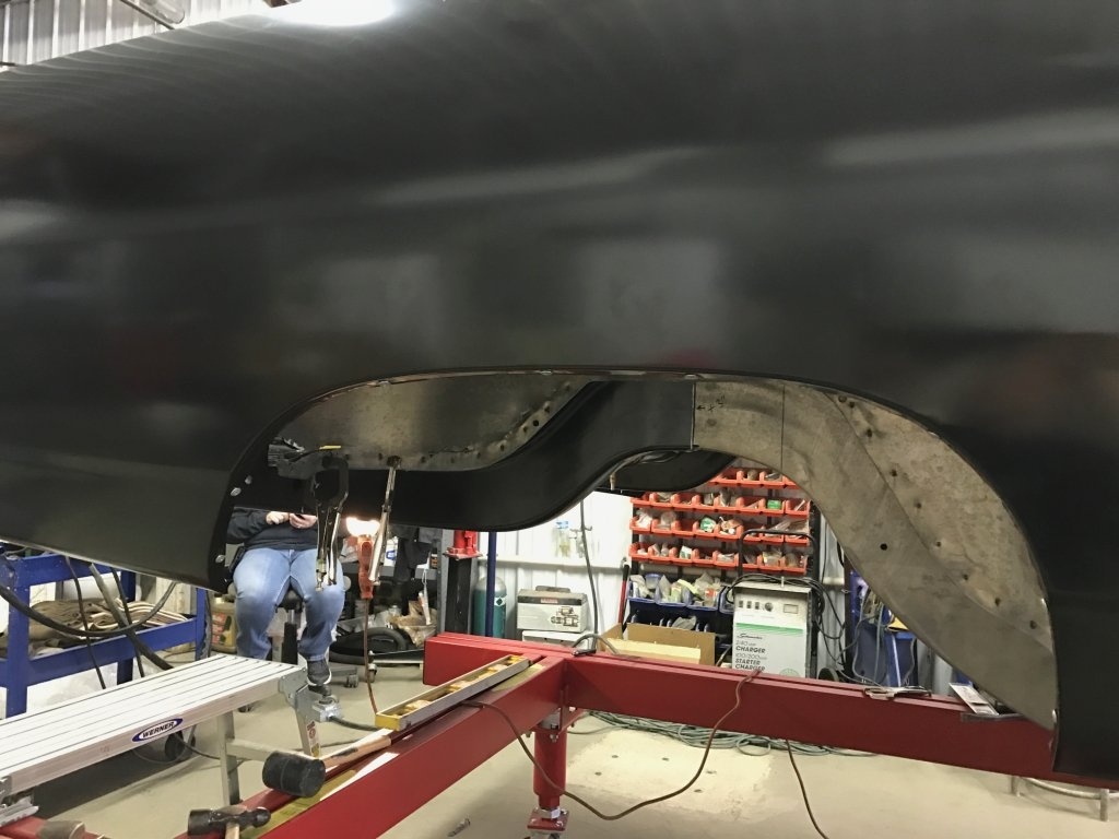

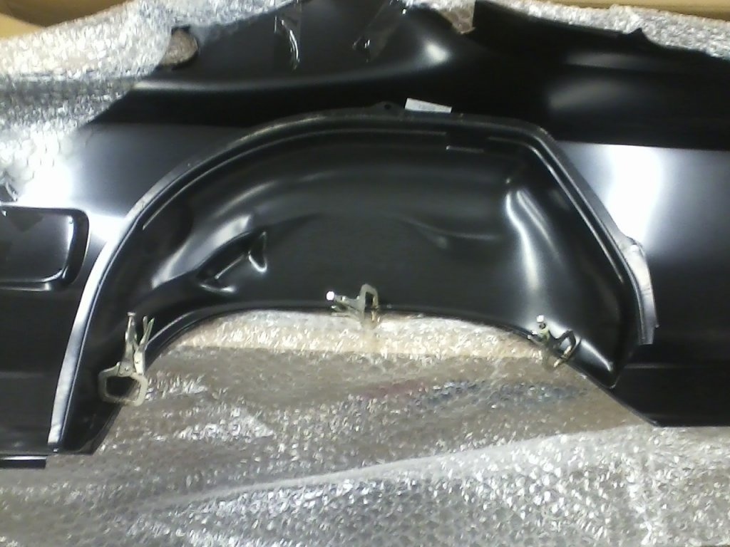

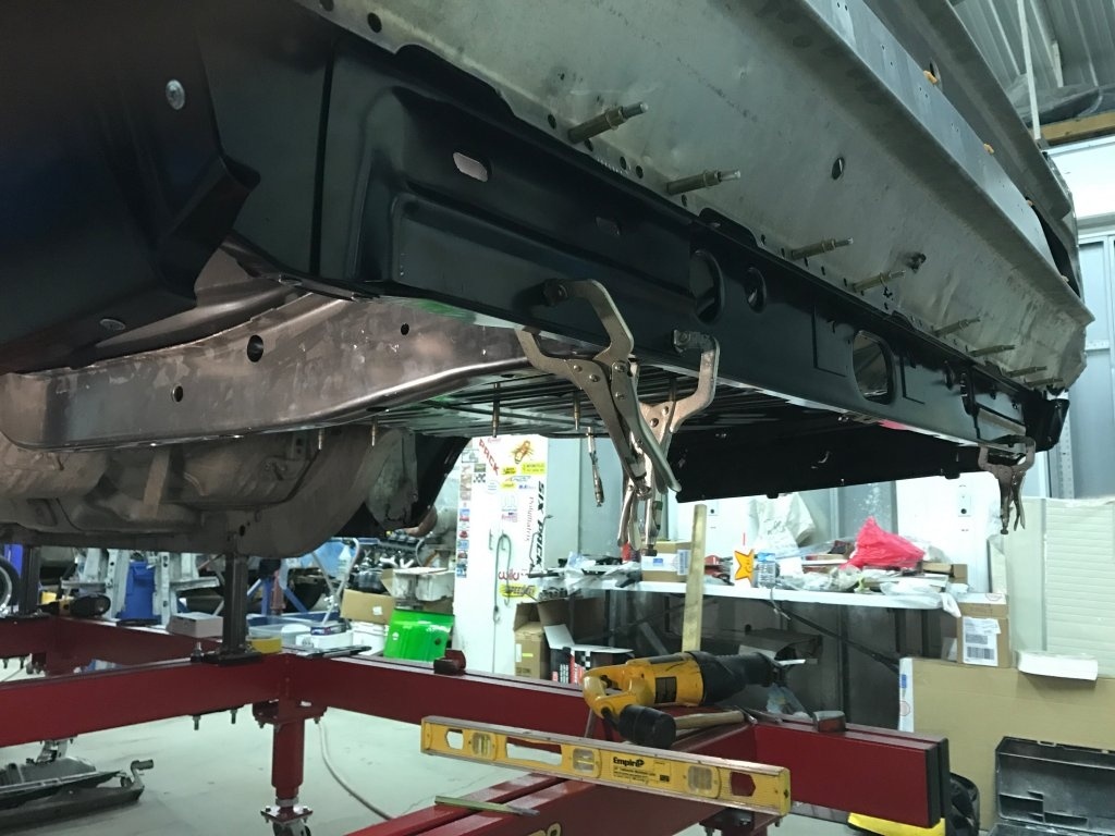

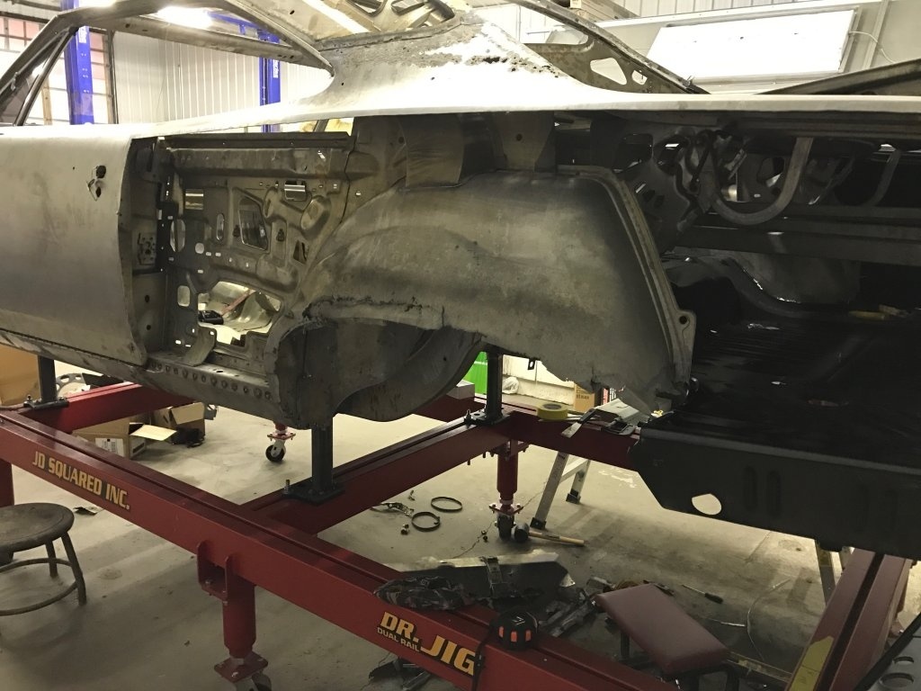

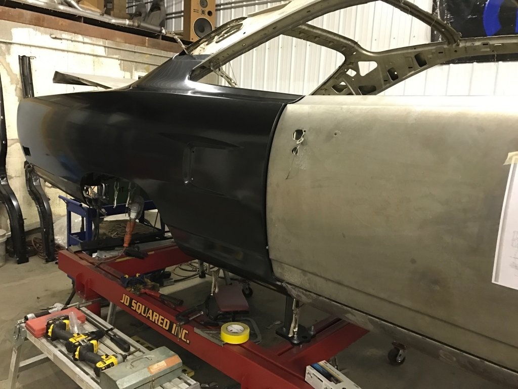

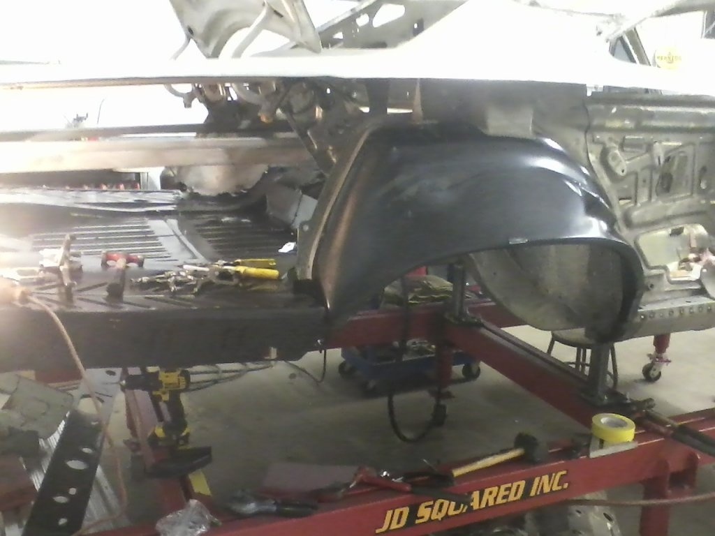

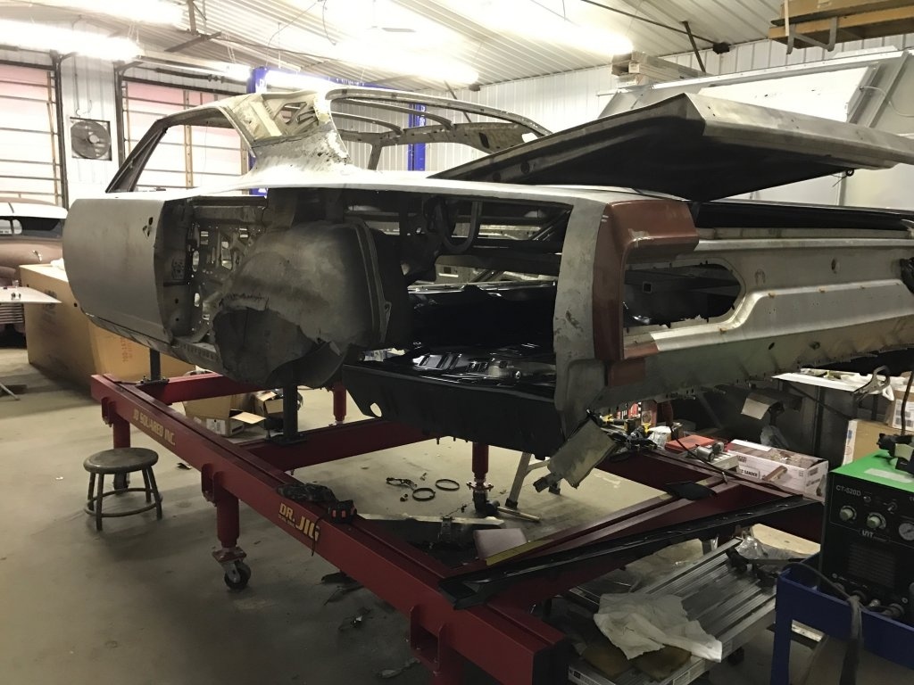

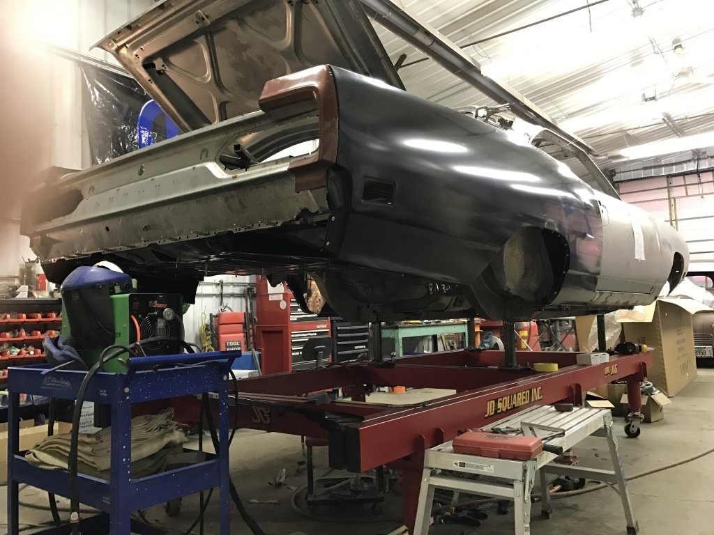

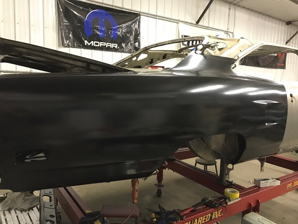

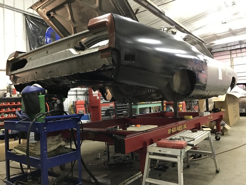

Having great luck with the AMD panels so far. Outer wheel well fitting in nice. Next pic is wheel well in quarter everything lining up nicely.

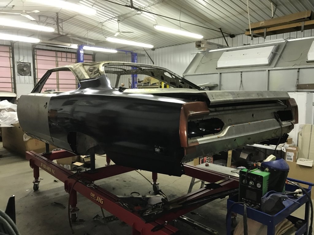

Holy cow, I turn my head for a few minutes and it looks like a car again!!!!!! Love it, give that guy a big hug for busting balls on it.

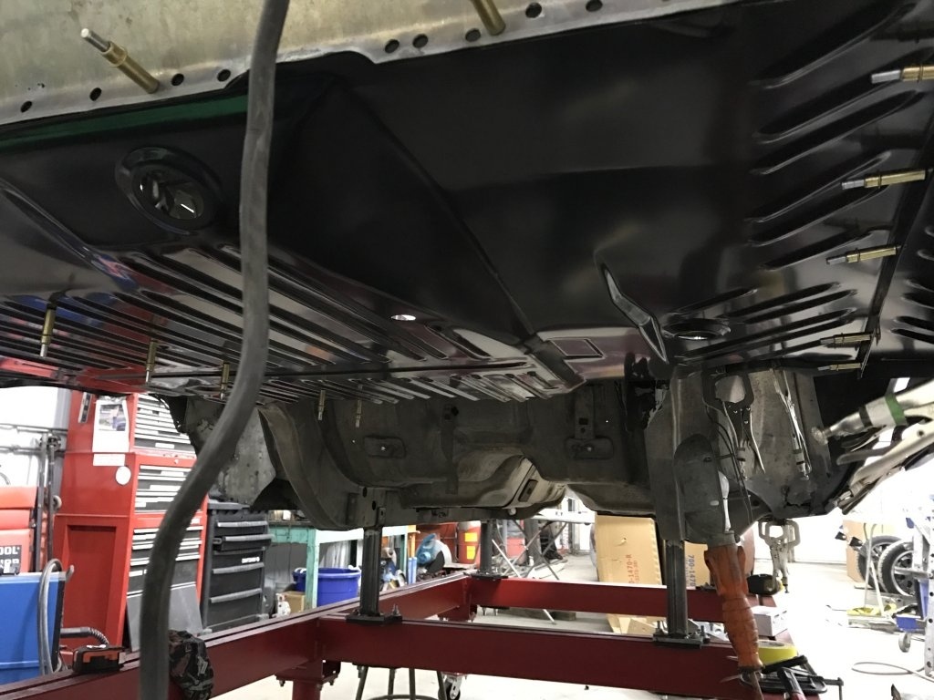

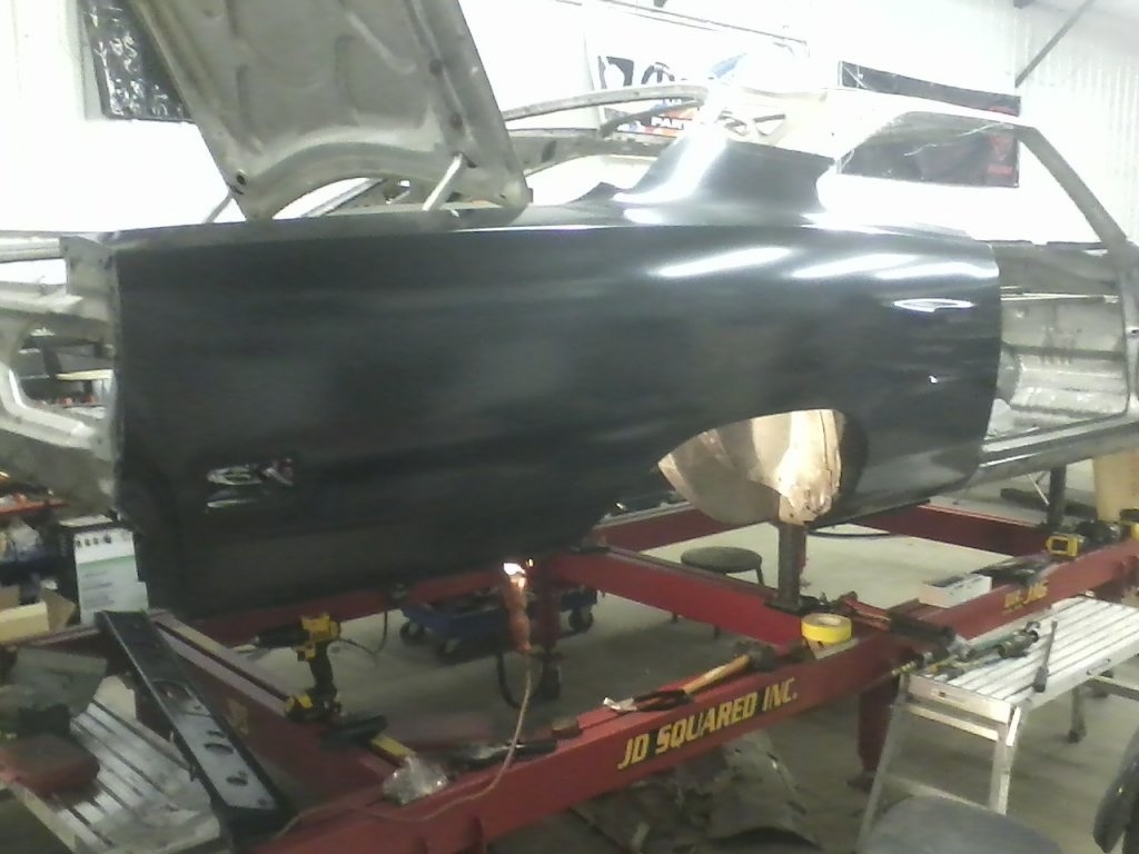

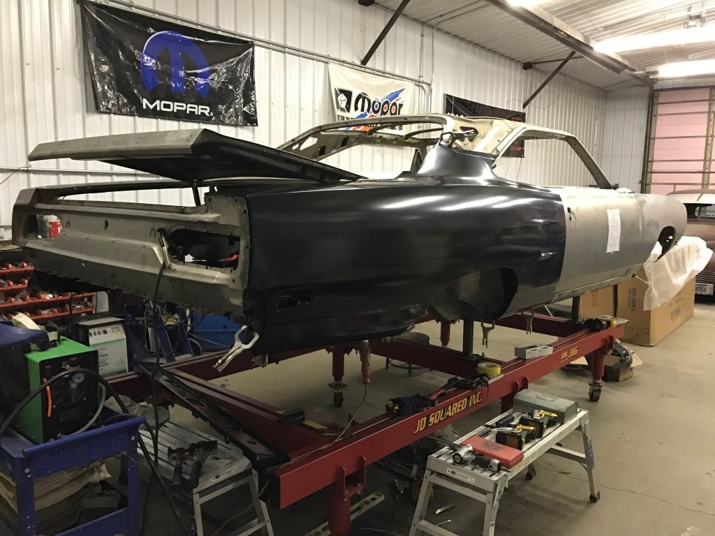

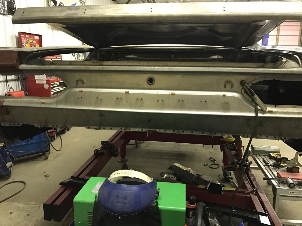

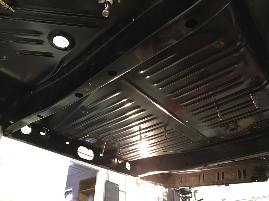

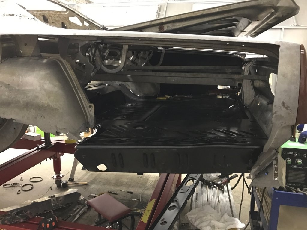

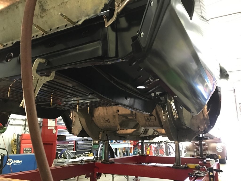

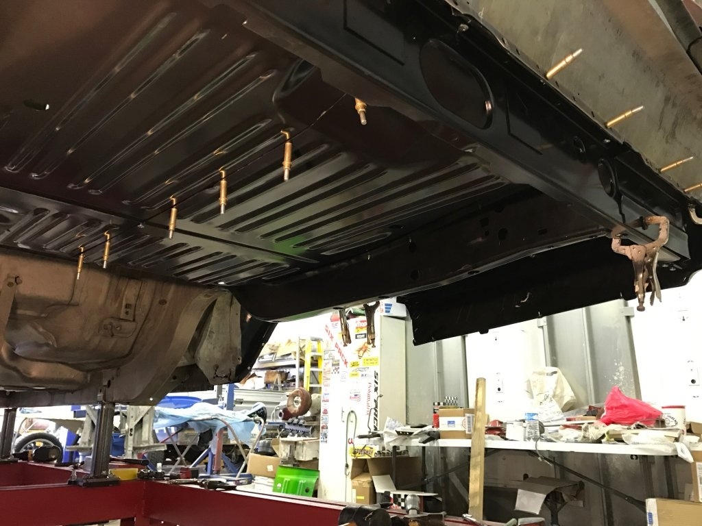

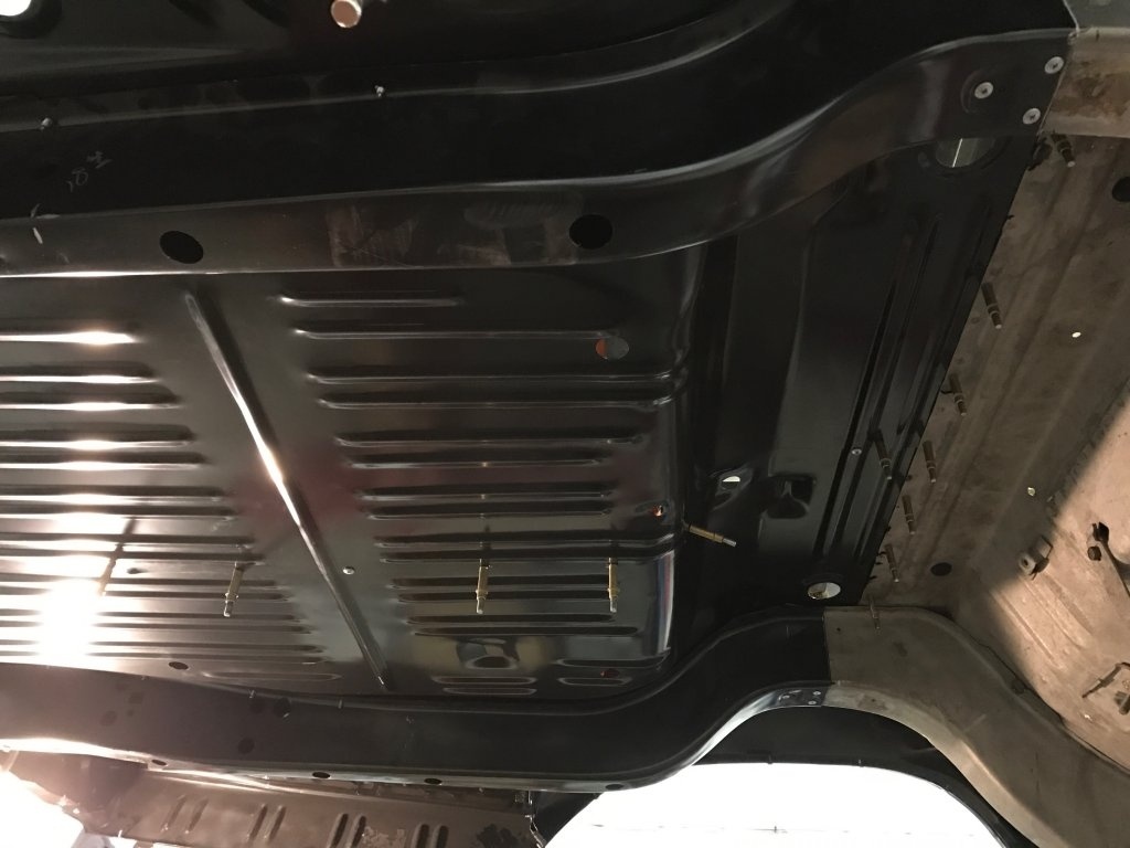

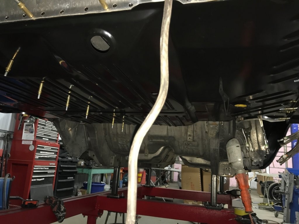

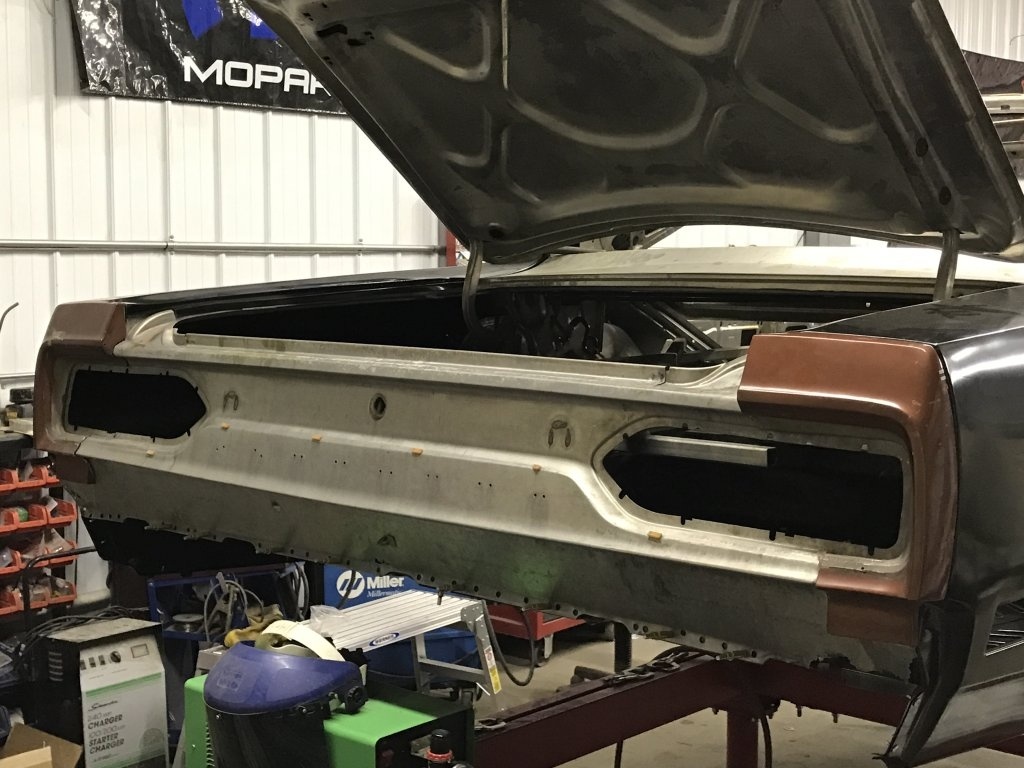

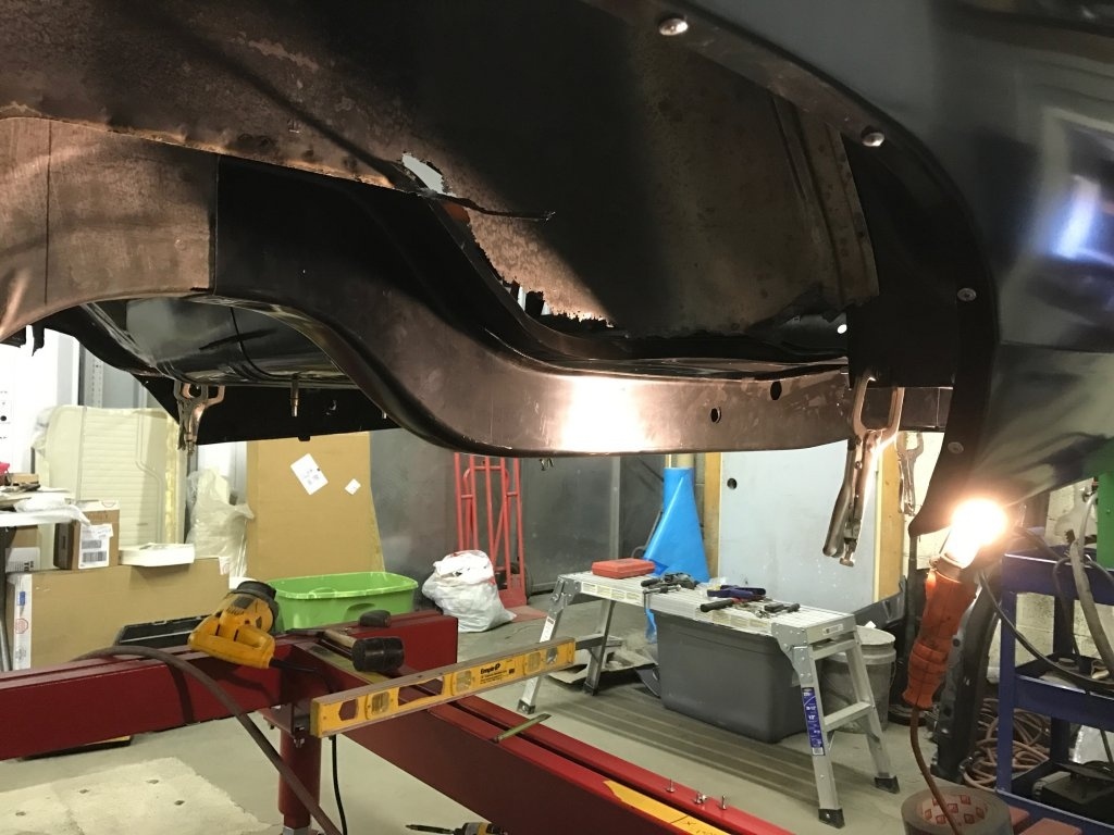

These AMD panels an parts are fitting great, if the roof skin fits just as well we are home free. Then let the welding begin. Over lapped the frame rails 3 inches an welded an plug welded. He said there stout as hell. All squared up with in an 1/8 of an inch.

Nice work getting rid of all the tin worms - great progress!

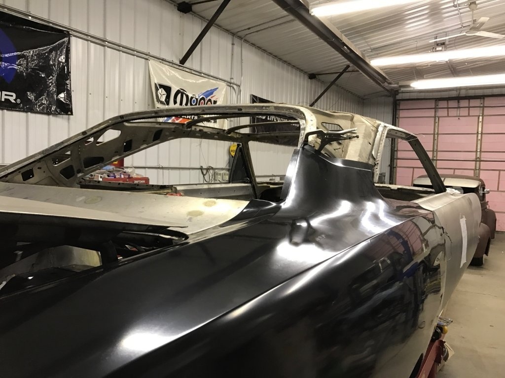

Check the bottom edge where the rear side windows contact the quarter. It is one of the few not perfect spots on my car, and I think that was from the AMD panel fit. Didn't see it until after the car was all painted. Grab a window just to be sure...
Rock on!
Rock on!
I agree, my quarters are AMD and they had a slight bow outwards at the window edge. I had to do quite a bit of adjustment with all my new AMD panels. Luckily I checked the shape around the lower edge of rear screen as it didn't match the trims at all. Your car is looking great tho and your guy is doing a spot on job fitting everything up before welding.
