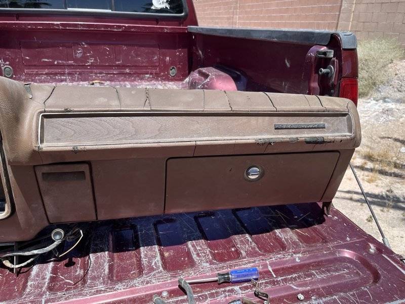

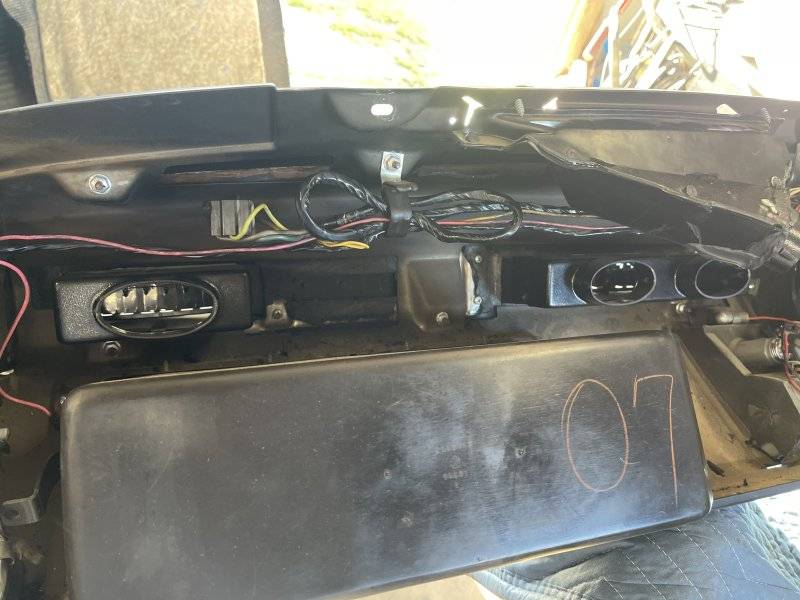

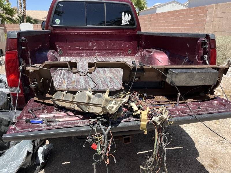

I asked them a couple day ago if they could remove the dash so I could get started on the no a/c to a/c conversion. It was removed the next day and I picked it up this am. I was really surprised how fast the tear down went with hardly a set backs. I removed the instrument cluster and wiring harness all in one piece. I was going to remove all the lights from the instruments but it seemed way easier just to leave everything still plugged in. I’ll be putting it up for sale in a while as a complete setup.
I bought a dash frame from an A/C car to put it back together with the Dakota Digital instruments and the Vintage Air. Vintage Air doesn’t have a kit for the 71-74 B-Body but the 71-72 firewall is from an E-Body according to Moparts Mark anyway, so it looks like a little firewall modifying has to been done. Maybe someone here has done the mod already? I figure if I send out the dash pad an have that restored. Then I repaint the black A/C dash frame to Saddle and install the Dakota Digital gauges with the new harness. I could save a **** load of time and a little bit of money compared to sending it out to Instrument Specialties and waiting for ever to get it back.

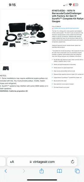

This is what I ordered. You will be ahead of me since you seem to be using that serpentine setup. I had to get my brackets for the big block. That kit came for a 340.

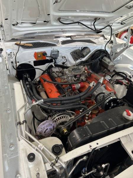

I used most everything in that kit. Retro (hacked) together the vintage air ducts to my factory defrost ducts and vents. My car was factory AC.

Honestly. I really just followed the instructions. No real surprises. The only thing is if you are having to modify your non ac firewall and have the motor out of it like I think you will, is if you could cheat the evap box further to the passenger side. Getting all six air ducts ran you run out of room quick. You are going to have a hell of a ride when you are done. I have the Dakota gauges on my shelf waiting for me to stop being lazy. They are sweet. Have you got them yet?
Horrible picture. But see how all the ducts come out the one side. It gets tight tight getting all that routed.
