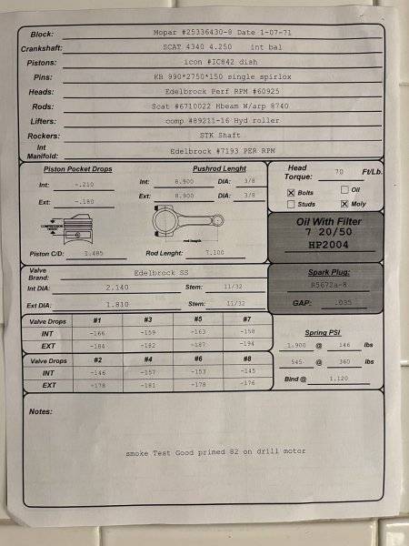

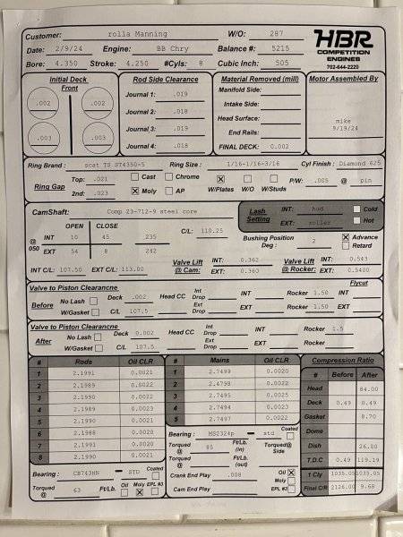

Well, they just put my car on the rotisserie to install the body stiffening kit and weld in the 4 link components. The engine should be finished with the startup and breakin in a couple weeks. Then they can test fit the engine and trans combo to finalize the tranny tunnel position. Then it’s down to right rear quarter panel work. Getting closer to media blasting. The DotorDiff
S-60 has arrived and will be fab’ed up for the 4 link and sent out for powder coat.

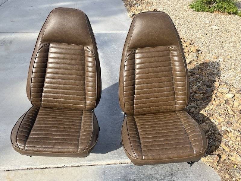

My back seat is finished and it came out real good. The front bucket frames had some miner cracks that needed welding. The powder coating is now finished and should be reupholstered in a couple weeks. I’m ordering the Digital Dash instruments today. Only a few components left to purchase. I should have my dash pad back from Just Dash in a couple months and will start putting the dash back together then.

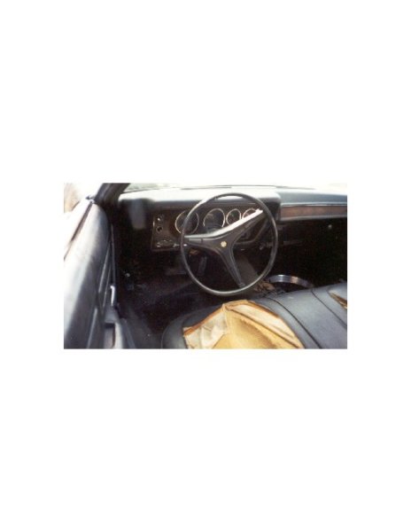

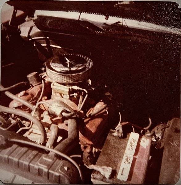

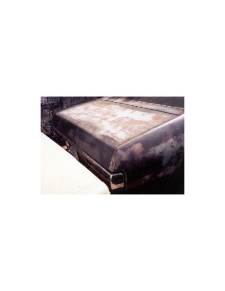

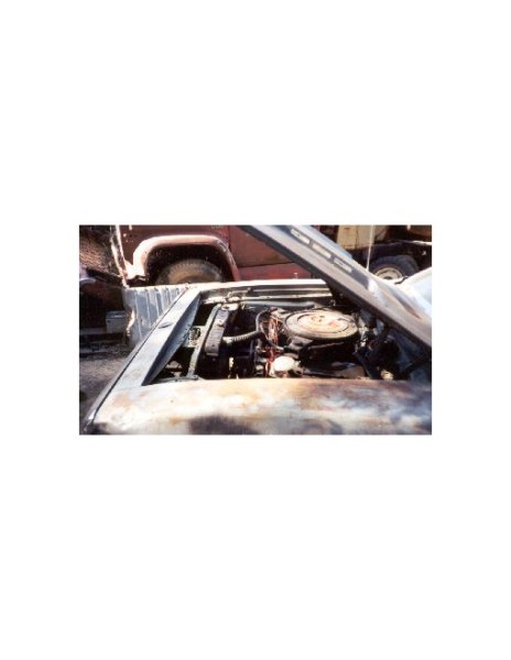

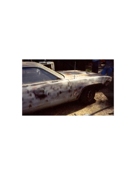

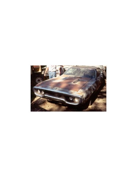

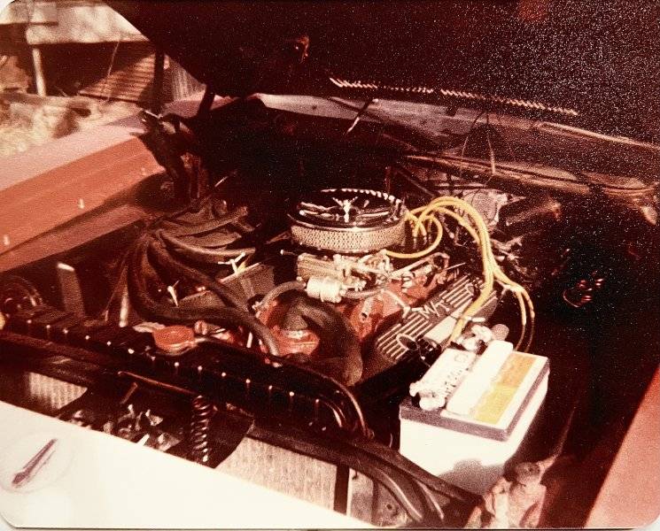

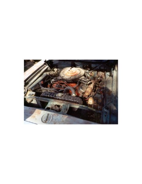

i'd bought a 71 roadrunner 383 727 auto on the column bench seat car , build date was in 70 . a friend had to have for a father son project . he sold it when the son's interests went else where .
My buckets are finished and came out great!
All that’s left to do on the interior is paint the kick panels, seat backs and trim my auto console into a manual console plus color match.

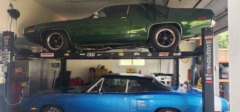

The shop posted a short instagram and my cars on the lift in the background a couple times.
