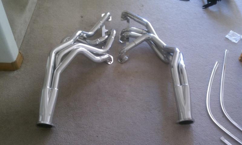

Got Headers??????
Got my stuff from TTI today, now I just need my motor! LOL

She's looking good !!!! You will love those headers. I used them on my last 2 restorations. Fit and quality. They've got it!!!!

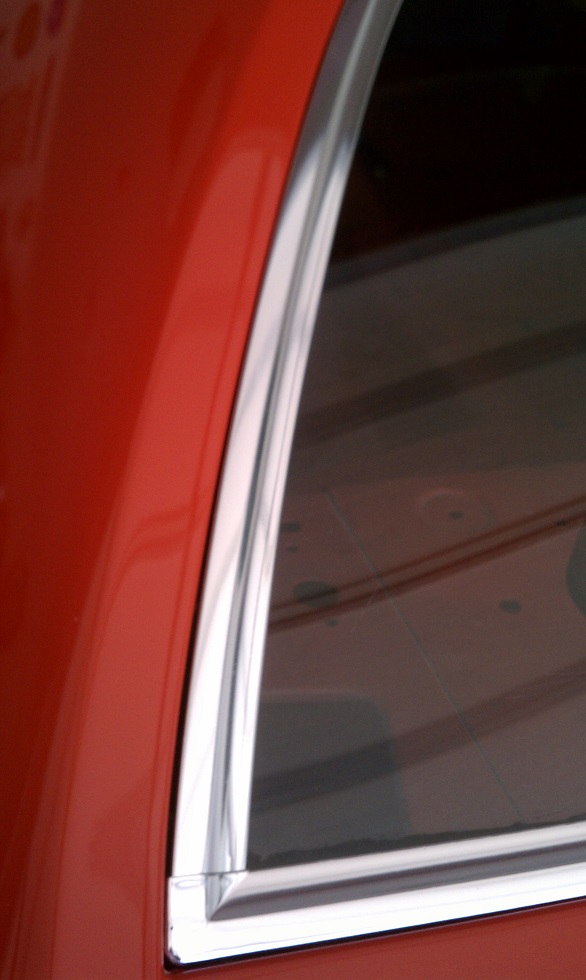

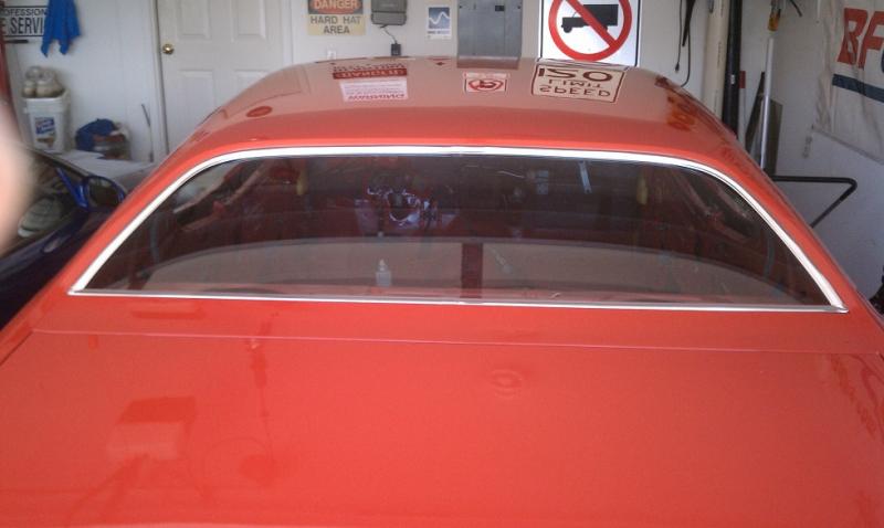

Got the back glass back in, original glass and original trim. I did a clean and buff and polish on the trim. It was a pain in the bean bag getting it right with the mastic type seal, a bit of fiddling, and should have used the larger diameter bead, but its not gonna move or go anywhere.

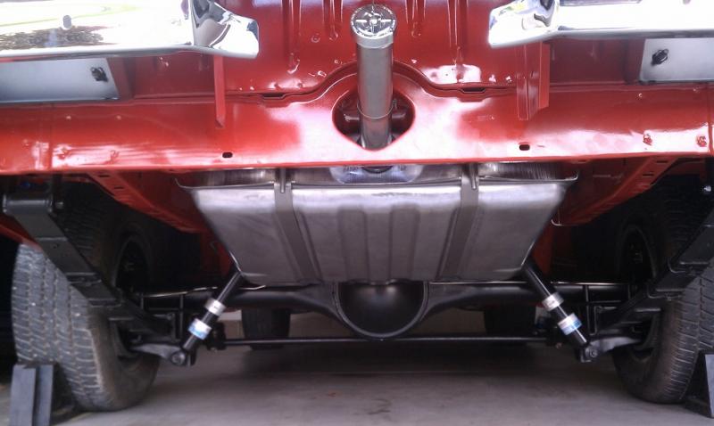

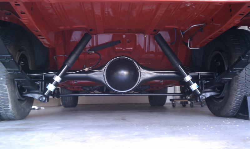

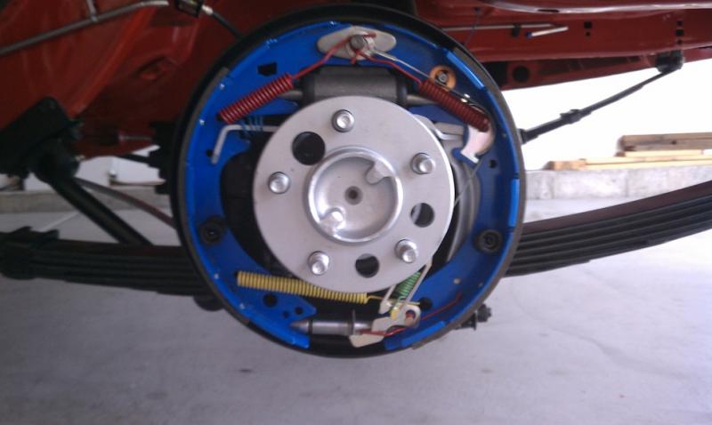

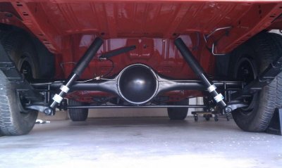

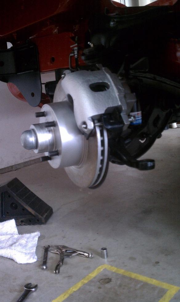

Brakes are completed, just need to bleed them, the e-brake is now operational and the rear sway bar is installed. Got the endlinks from Firm Feel, and they work out real nice.
Here are some photos.
Added this to show the FFI end link

Thanks. Got the fuel tank in now.

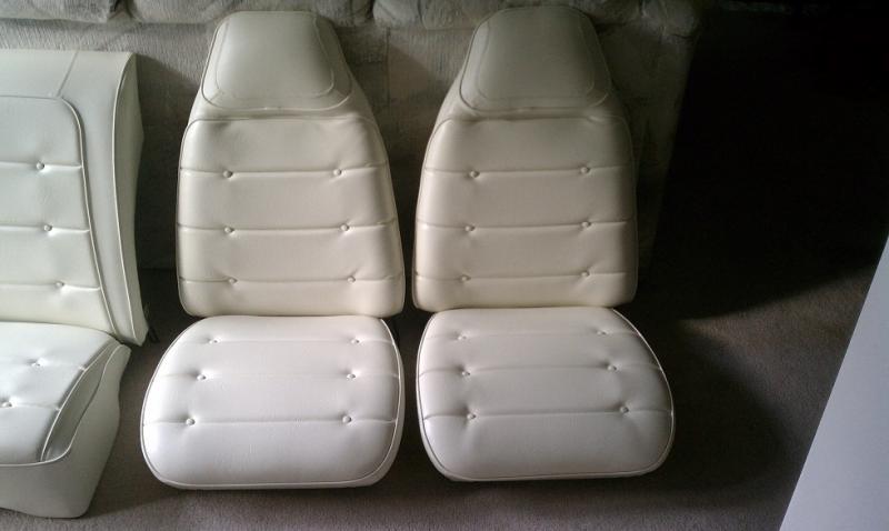

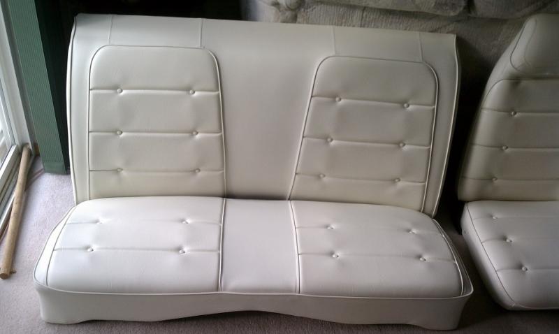

Seats, I will have to take some pictures of the under side, as the upholstery shop did a real nice job decking the frames and the frames were cleaned up, sprayed with rust preventer and painted.

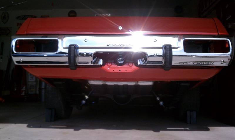

Rear bump stops are on, I cleaned up the rubber parts, filled all the gouges and scratches and sprayed with plastic coat and lower valance is now installed since the gas tank is in.

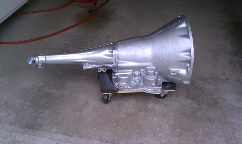

Got the transmission back and its all ready to go in as soon as I get the motor back. Considering it was not serviced in 25 years it was not too bad, complete overhaul kit, front and rear bands replaced, new bushing kit and a bolt in sprag plus torque converter for 2200 to 2400 stall. The transmission is heavy duty and originally built as a B&M street strip version.

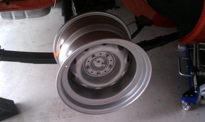

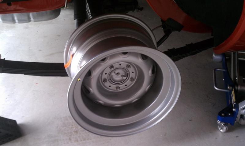

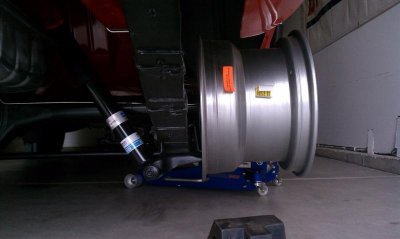

Got my rear wheels, still waiting for the fronts, but did a test fit, very snug! Should be real nice with some tread on them!!!

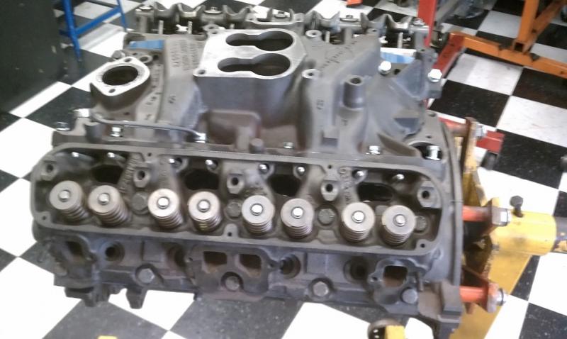

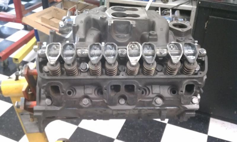

Also dropped off the accessories today for the motor and it is now being assembled, so got a couple of photos. Should be done next week!!!!
