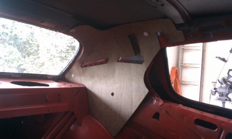

Here is the c-pillar sound deadener, REM has a nice reproduction pair that is correct material, figured what the heck, they did a nice job.

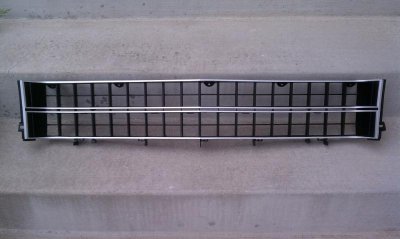

Also, picked up one of my two grilles that I had restored, gotta have a spare you know!!!! I Found a guy that is a wiz with plastic, so no more cracks, dings, or broken tabs, plus the paint turned out really sweet!!!!! I actually used my original as a donor for the other two that were restorable since it was broken in so many places, but had all the parts needed to fix two! I think I will cry the first time it gets a rock chip! LOLOLOL

Whoever did your grill really did a great job on it! I had a pretty decent hole in the very middle and bottom of mine that i repaired and then painted myself, I can notice where i made the repairs but ive never had anyone say they could tell, but i never had my car in a show that scrutinizes everything either, worked good enough for me and i agree with a spare, i bought one off a member here a year or so back but as yet not made the repairs, hope i/we never need them, of course if we sell one, you know what would happen :)

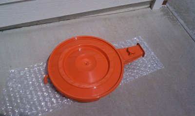

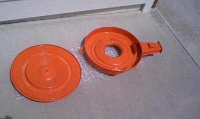

Got my air cleaner back today!!!! Yes, went the extra mile and had my body shop do it, results are great, just have to put the seal and stickers on now!
you should have them clear it after you add the stickers.
That's a thought, but its already a base coat/clear coat paint job.

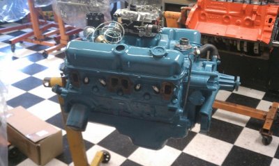

Engine is getting closer

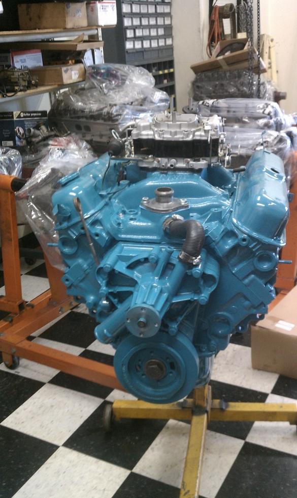

Went to check up on the engine today, and was hoping it would be on the run stand for break in, but not quite there yet. Here is how she is looking.

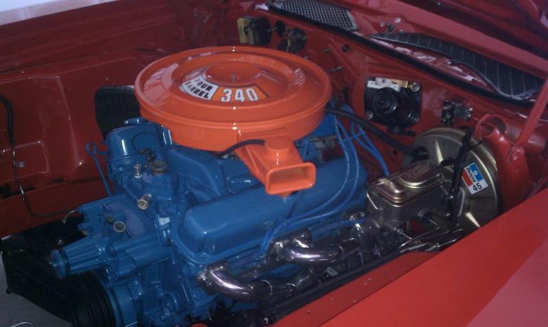

Finally got the motor situated, after I installed it, found out the MOPAR blue paint from summit racing was a bad batch, they sent me two new cans for no charge, now she's back in the car and looking proper now. So for those that were following the other thread about paint colors, now we all know why it didn't look right.

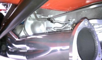

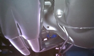

I got the trans cooler lines re routed outside the headers as well, so should not be any issues there, not the best pictures, but the lines stay up above the shift and kick down lever, then drop down and go outside the headers up next to the oil pan and back to their original configuration to connect to the radiator.

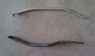

Also had to make a new shift lever, as TTI recommends putting the connector block on the top side of the shift lever, the original one does not fit, hits the floor pan, so I made a new one, that is the opposite of the original, it will go in soon, and I can get a better photo when its installed.

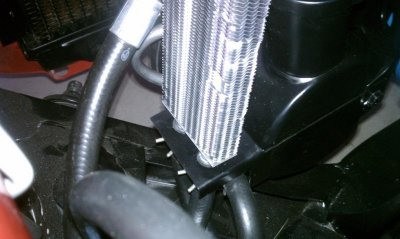

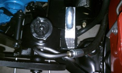

Here are some pictures of the engine and dash. Waiting on the AC compressor to come back from being restored, hopefully will have that back in about a month. Also included a couple of photos of the power steering cooler that I installed. This was from an aftermarket cooler I found and I fabricated the bracket. I think it should work out well as I noted when the engine is running the fan pushes a lot of air across the cooler in this location. I tried to keep it as close to the original setup as possible.
Here is the pump cooler

Glad to see that you got the P/S setup worked out.
