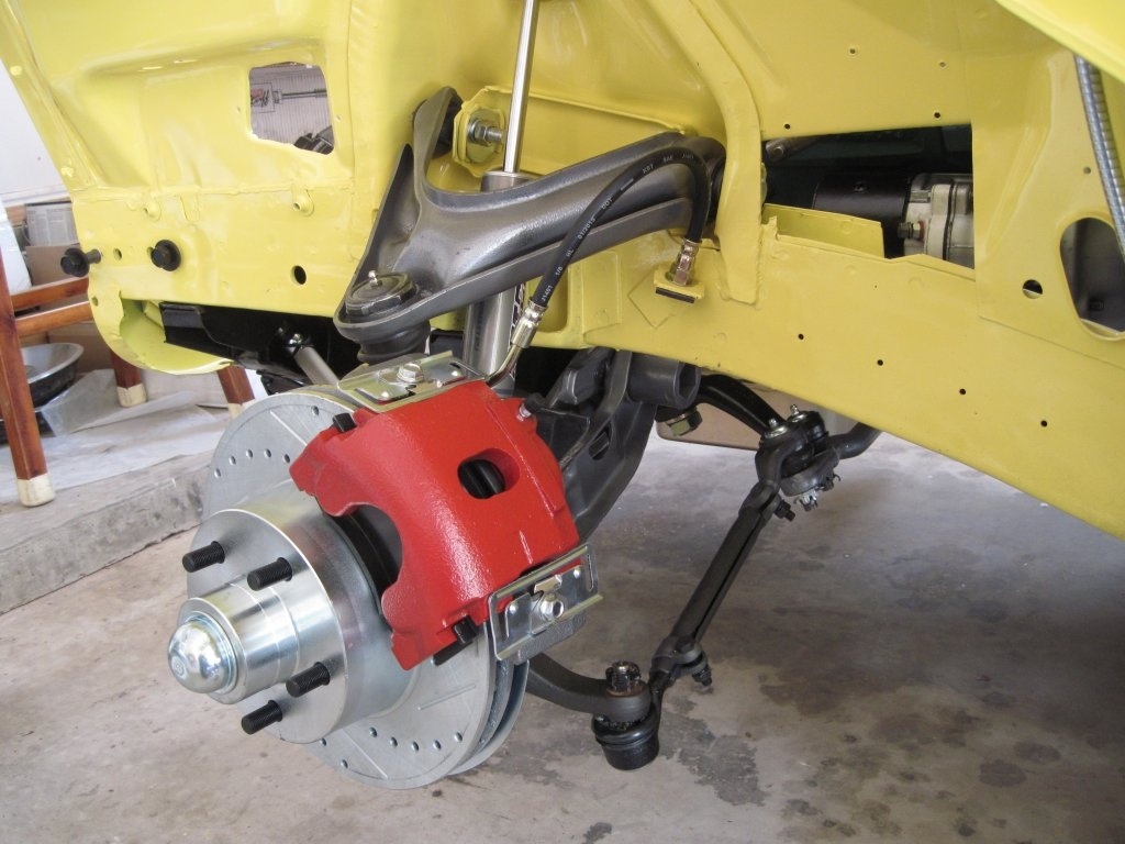

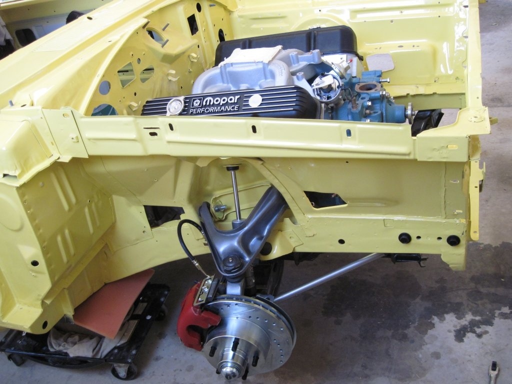

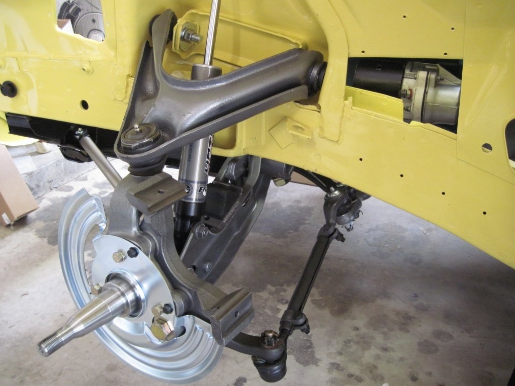

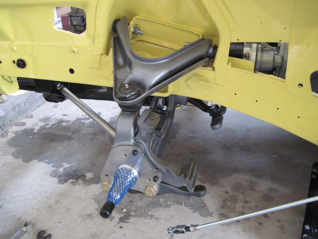

I worked on getting my disc break conversion kit on today (the kit was from The Right Stuff ). I'm getting ready to set her back on all fours.

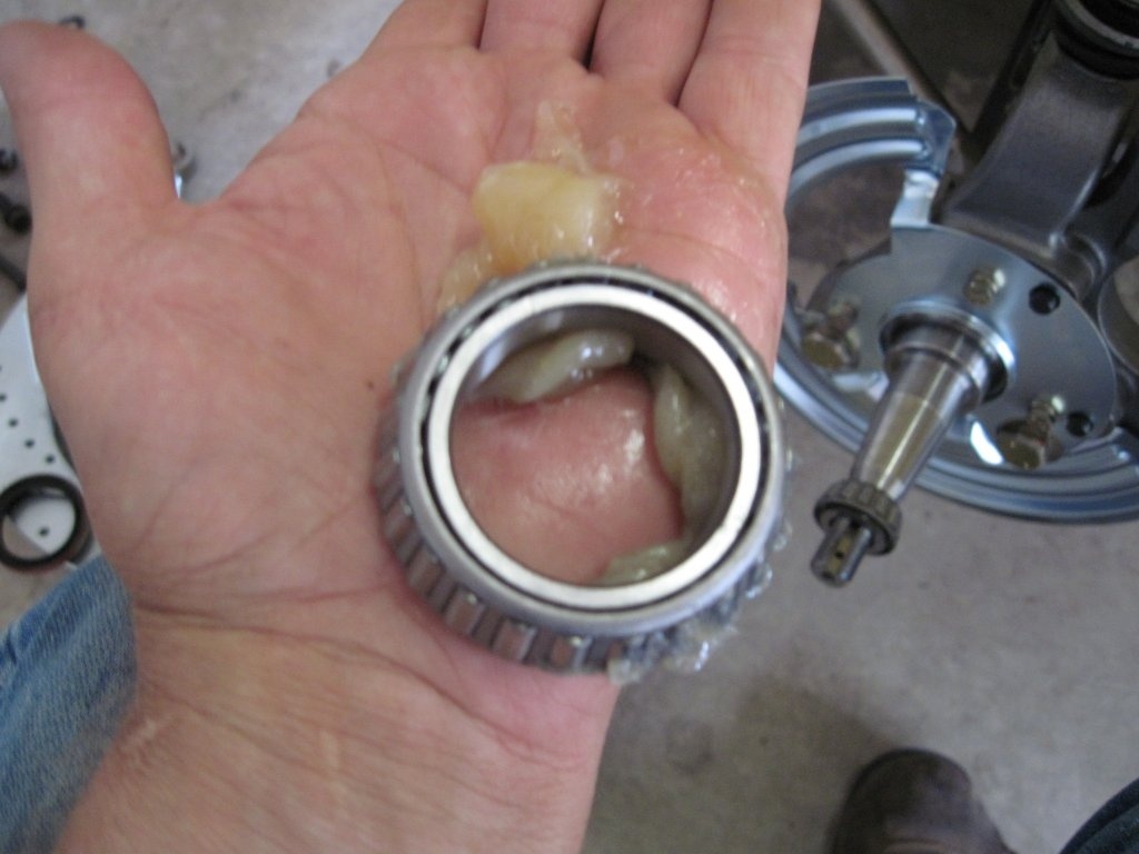

Packing new bearings.
My break calipers came with some black anti rattle rubber bands but I could not figure how they attach.

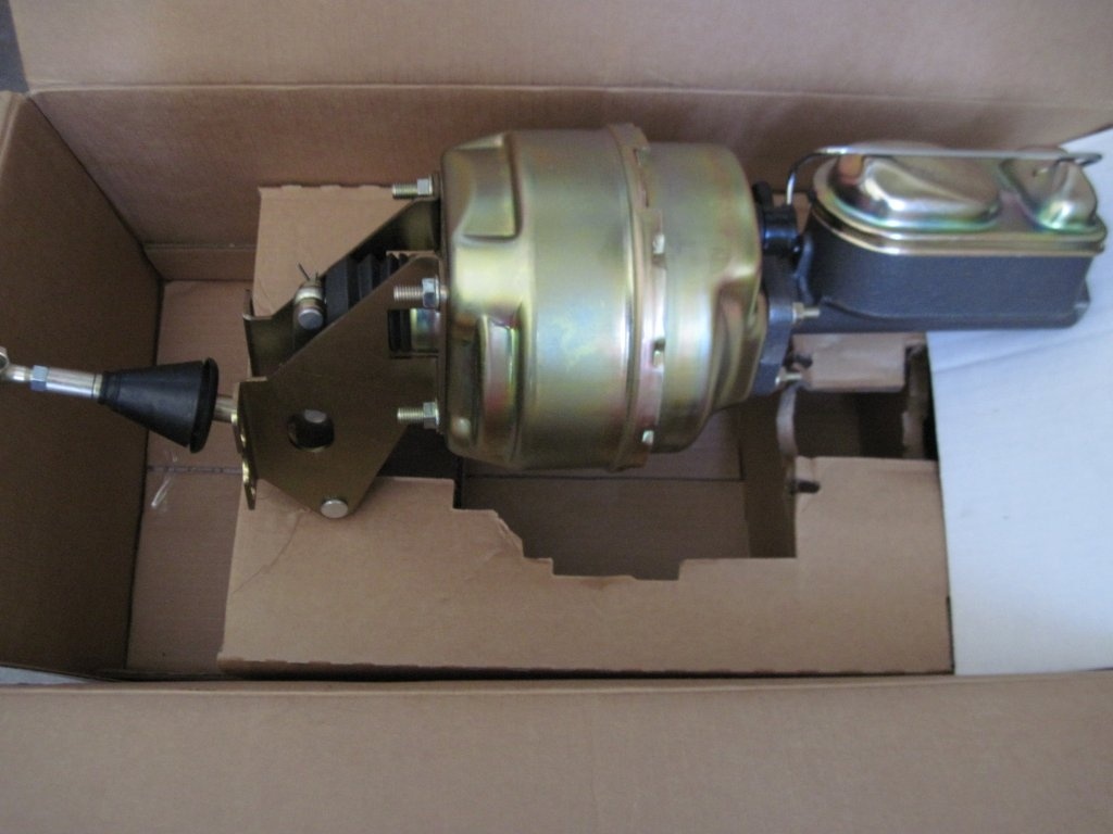

I used the same kit, just not drilled rotors. Good bang for the buck. I went with manual master cylinder. What did you choose?
Thanks, it's getting there. Did you go base clear or single stage? What brand paint did you go with and what was the paint code if you don't mind me asking? I plan on shooting my own color and going with a single stage urethane for ease and simplicity. Plus I like how it looks.
No problem, I did the base clear coat. The color that I used was 1970-72 Dodge yellow. The code was: AY1FY1 and the brand that we went with was the Sherwin Williams Ultra 7000. I don"t know what the code was for the Sherwin Williams brand but they were able to convert the code that I gave them to get the color that I wanted. I think that you would do great using a single stage urethane, I did not have enough confidence in my painting skills to tackle my car my self.
I have also been impressed with the kit so far. I went with the power booster kit.

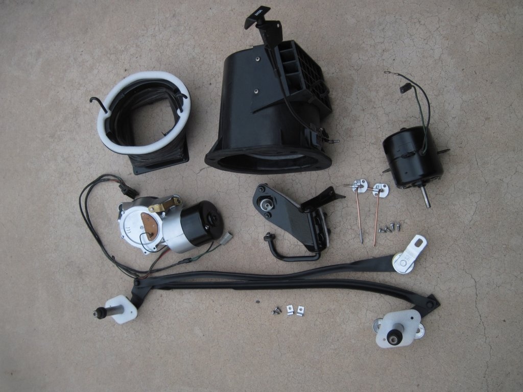

I got another component ready to install. I can't believe how many pieces there are to clean the years of grime off for this car.
I finished restoring a few more under dash parts. both my blower fan motor and windshield wiper motor seemed to work well and smooth when I tested them so I just opened them up and cleaned and repainted them. Things will be slowing down a little because hunting season has started and I will be using much of my free time enjoying the outdoors.

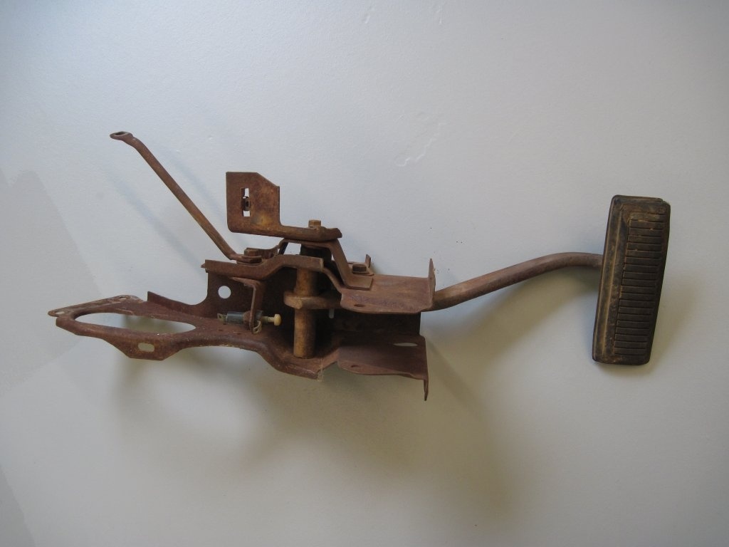

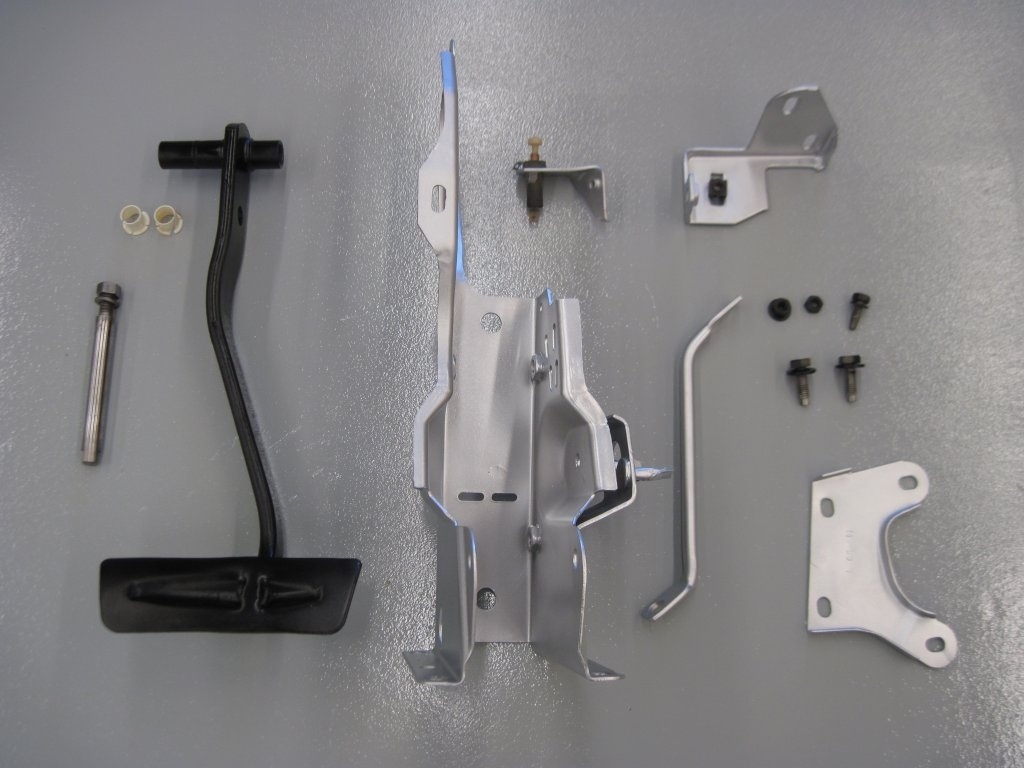

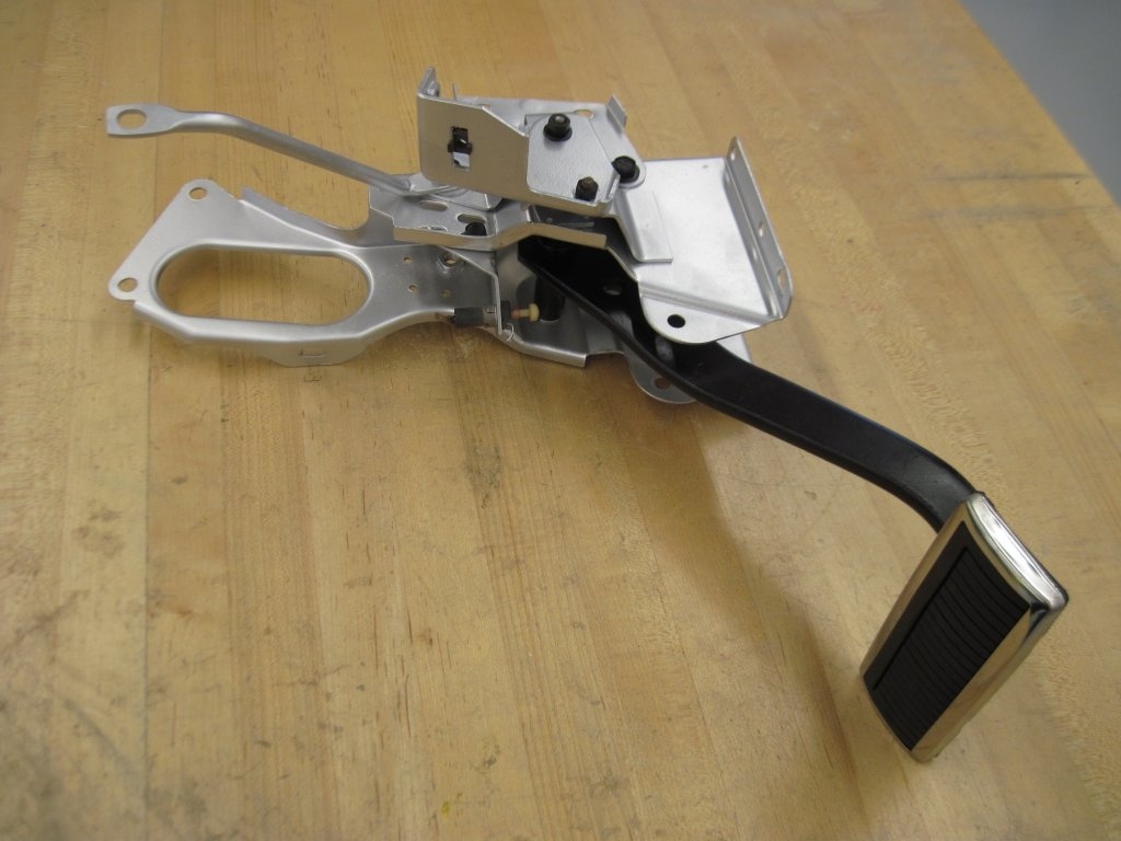

Nice work BTW. Where did you get the chrome lined brake pad?
Black powder or HiPower? Mulie? Those are on my bucket list now that I've been Kodiak to for my bear.
My pedals I ordered through Legendary Auto Interiors.
