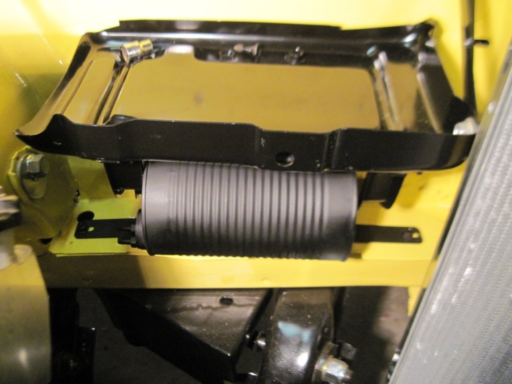

I have a question: What is this? Underneath my battery tray is a long metal plate that screws to the frame. I cleaned it and reinstalled it but I do not know what it is or what it is for.
1
3
Your photo doesn't show up for me - but on a 68 Charger the only thing under the battery tray is a soup can looking thing that bolts to the frame rail with two bolts - it is a vacuum can for the headlight actuators - it stores vacuum so the headlight doors can be opened or closed once with the engine off
Thank you, that makes sense. What I have is the mounting plate with the can broken off. Now I know what I need to get.

Thanks to Rolling Thunder, I figured out what my bracket was missing and ordered me a new headlight actuator vacuum can.

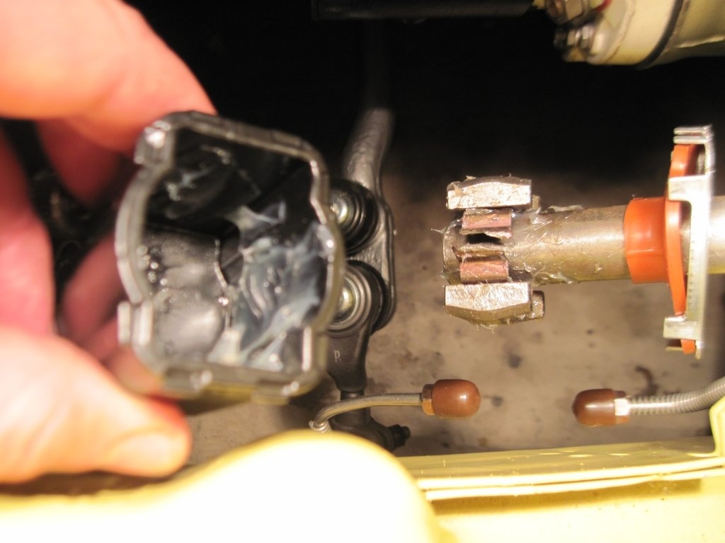

I hooked up my steering column today. I used the extension kit that came with the Borgeson power steering.

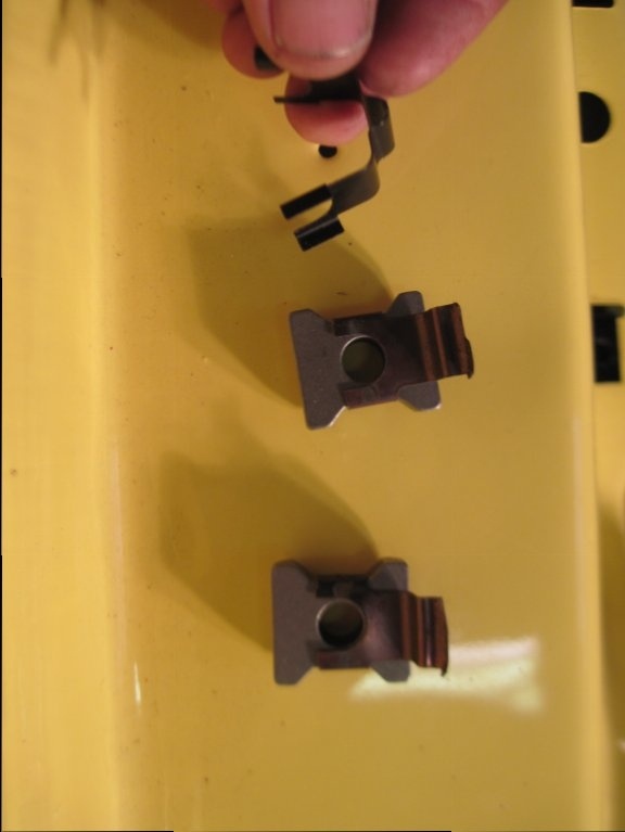

The uniclip that came with it did not quite fit, it was to narrow to fit the bushing spacers so I had to use the car's original ones.
Packed it with grease.

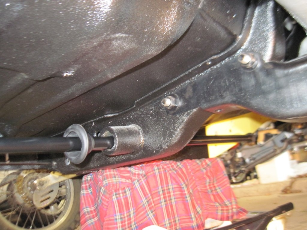

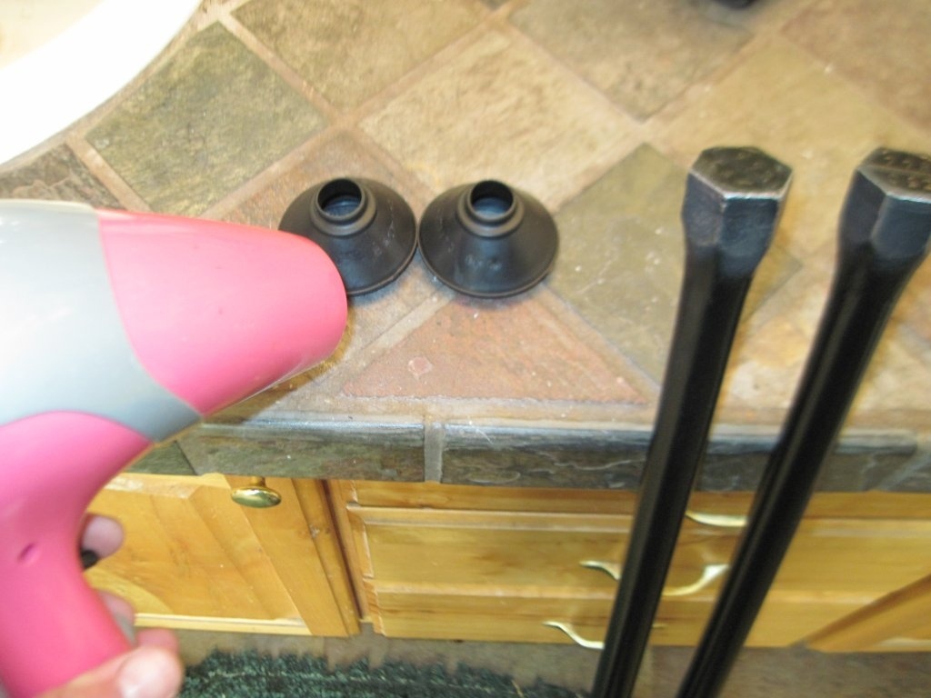

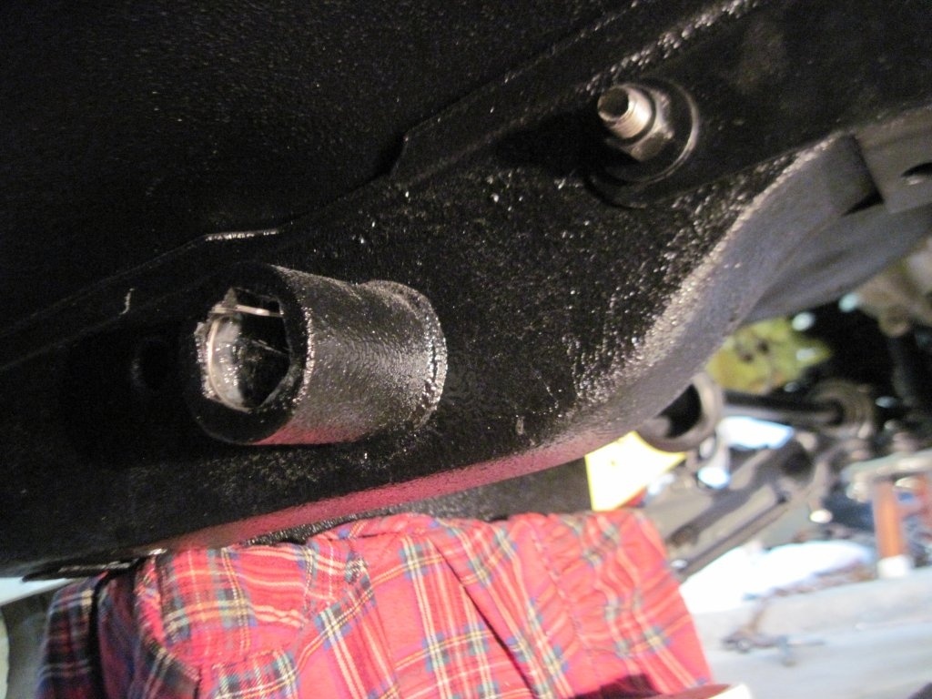

I installed my torsion bars. I had a hard time trying to get the rubber boot covers on the torsion bars. They were cold and hard so I had a bright idea to bring them in and heat them up with the hair drier.
This helped and I was able to get them on with some difficulty.

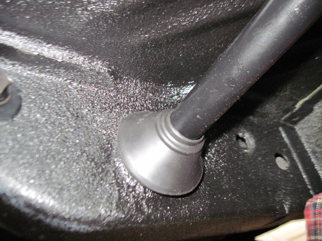

I thought this was a good idea until I went to install them and, because I have the front suspension already installed, I could not feed them through the hole from the front so I had to stick the bar through the frame hole from behind, pull off the boot from the back and re-push it on from the front of the bar again. This was a good workout exercise.
To get the bar to fit in the front socket I had to loosen the shock, remove the lower rubber stopper, and loosen the torsion adjuster screw.

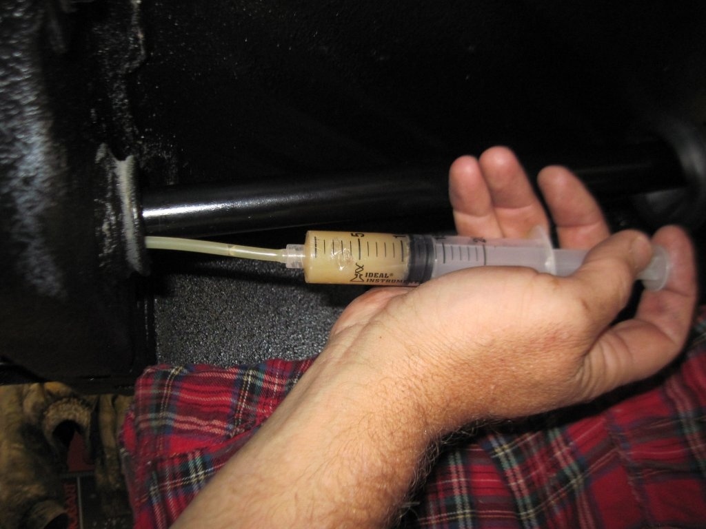

When I originally removed them they had a lot of grease packed in the frame socket so I greased and packet them before hooking up the rubber boot. I used my home made grease gun to make sure that I got grease back where it would need it then installed the boot and clip.

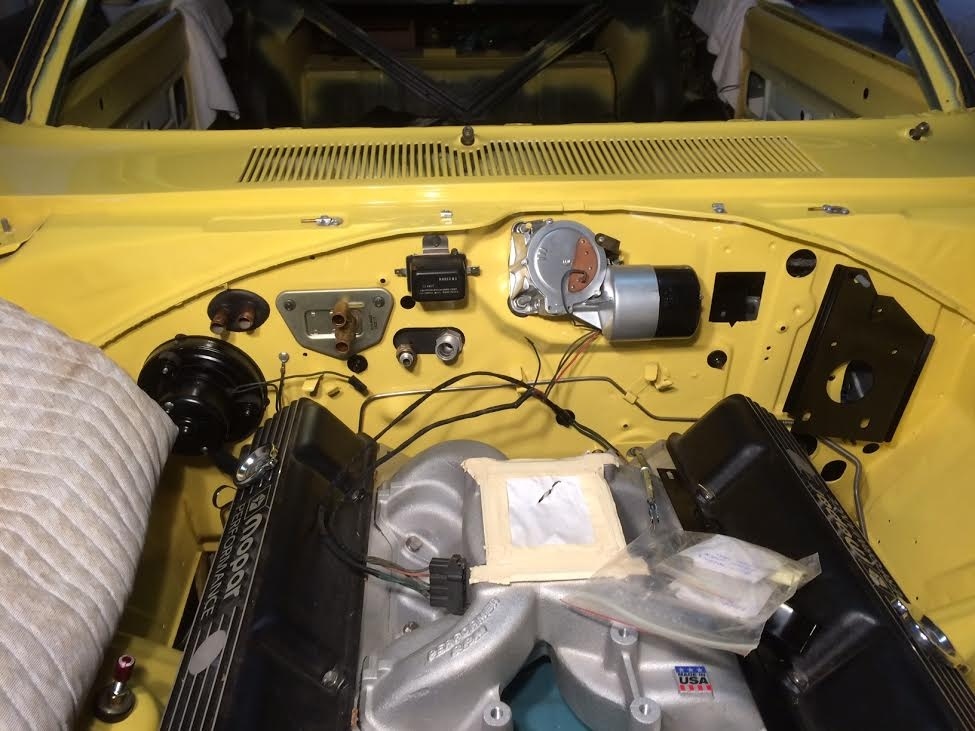

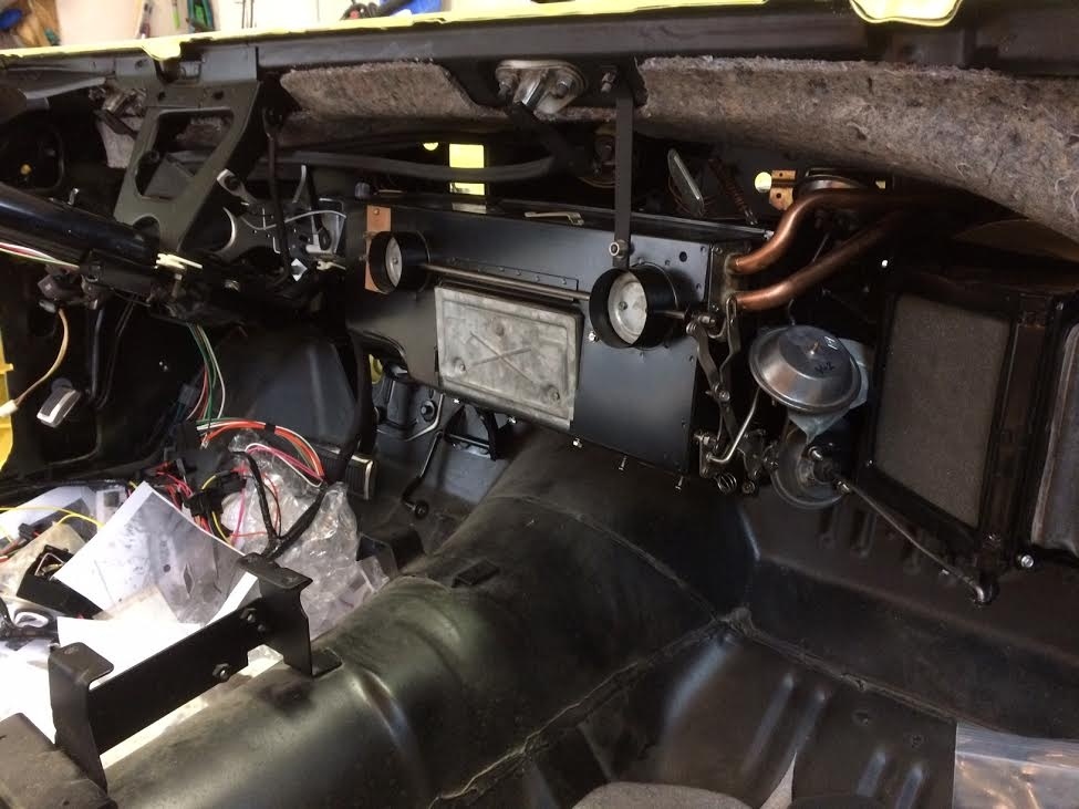

I have been able to spend some time installing many of the parts back on the firewall and under dash.
looks great, you should be complete by the time warm weather gets there. you must be getting more and more anxious after every step.
Thanks, I still have never driven a charger and am looking forward to driving mine.
