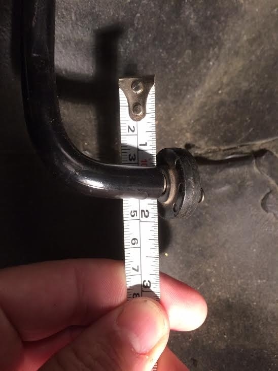

Quick question...what its the thickness and diameter of the small wheel on the accelerator mechanism? Mine vanished.
Thanks, I still have never driven a charger and am looking forward to driving mine.
I drove mine about 1/4 mile when i got it, couldn't go over 20 mph, bad front end all over the road, that was sept. 2014 did get a couple burnouts in my driveway though. I'm hoping to get mine together enough to drive it this summer. it's kinda like waiting for Christmas when your a kid.
Lookin good!
The thickness of my accelerator wheel is 1/4" and the diameter is 1".
Classic industries has one for $17 or $18 Product # MB1880. Maybe you can find one somewhere else.

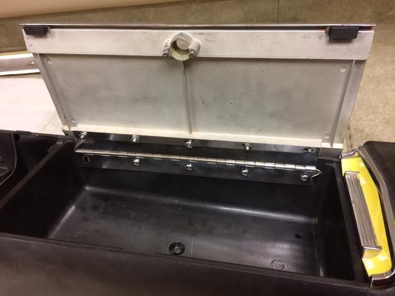

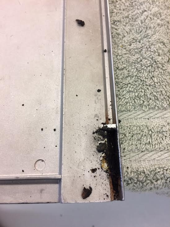

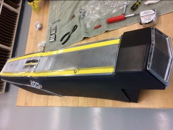

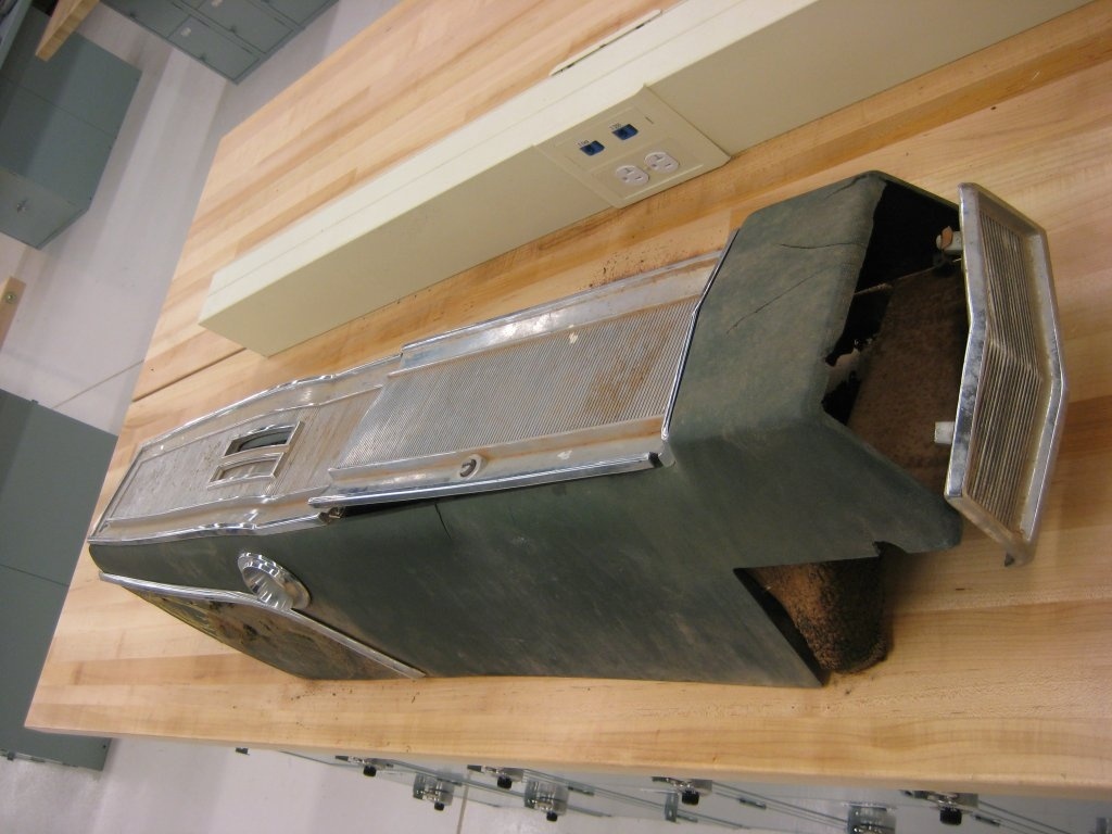

My center console was in poor condition. The door was bent and the plastic console was cracked and broken. I spent some time and glued, cleaned, and painted the plastic console and it looked decent. I also cleaned, buffed, and painted the metal parts. After putting them back together I decided that I would rather spend the money on the new plastic console. The old one just was to brittle.

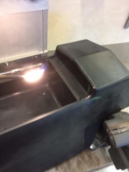

My trim parts did not fit the new console very well. I used the torch to carefully heat and reshape some of the plastic to get the parts to fit correctly.

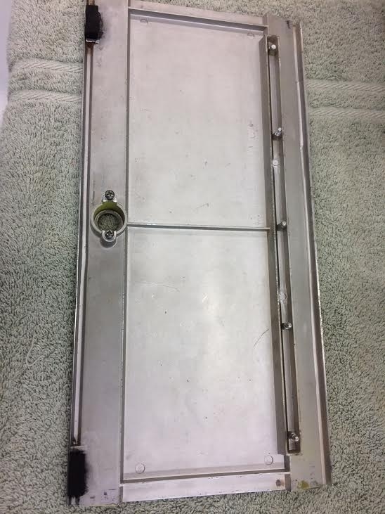

My door was bent and the rubber stoppers were old and rotted. I tweaked and bent the door straighter and cleaned out the old rubber and glued in some home made foam rubber stoppers.

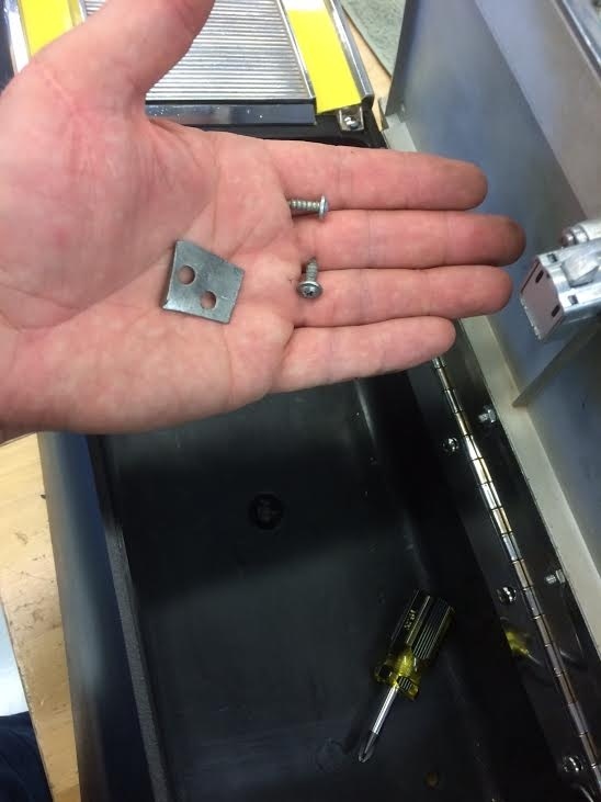

It was also missing the latch catch and the old lock didn't work. I made a latch and bought a new lock.
I think that it is about ready to reinstall.

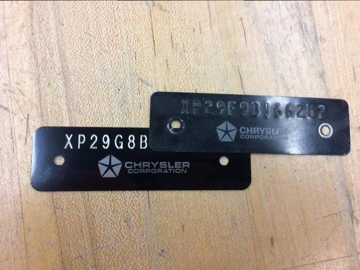

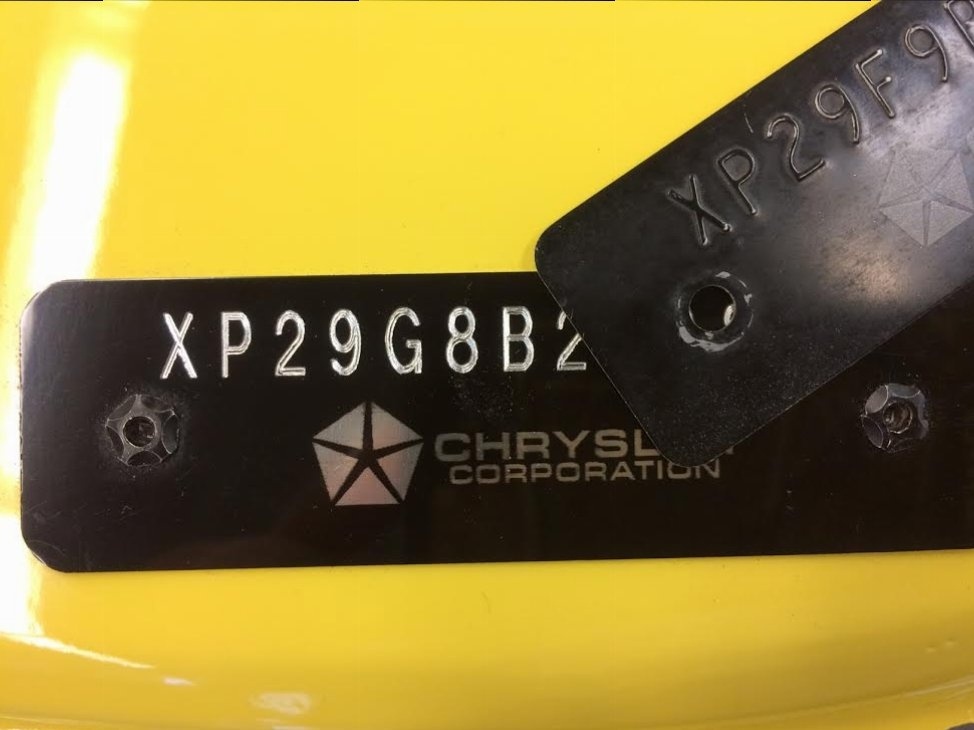

When I bought my car it was missing the dash and so it did not have a vin tag. It did come with a clear title and I had it transferred to my name. I bought a dash frame from another car to restore for mine. I took the vin tag from that dash to a sign shop and had them copy the tag design and put my vin number on for my car. They did not have a number stamp so I just had them engrave the numbers in it. I think that it looks good.

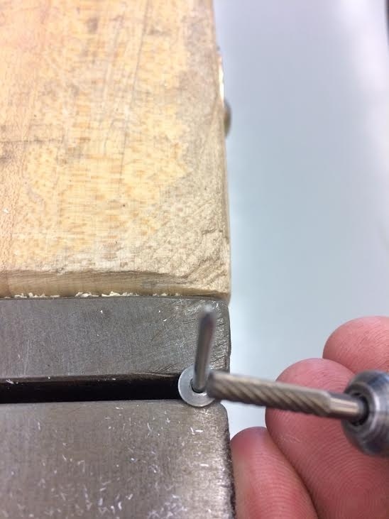

Because this car was missing many things I am not worried about having everything original as long as it looks new and close to original. I did not want to pay $29.00 for 2 rivits, to hold my vin tag on, so I used my dremel and fluted my own rivits.
After painting them and installing them I think that they look good and don't think that anyone will notice that I used the wrong rivits.

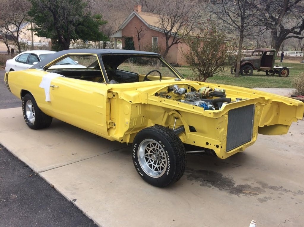

I put her back on her landing gear so I could adjust the front end height. First time that it has been on all fours sense I put it on the rotisserie a few years ago. I dry fit one of the fenders to get an idea of how it will look.
