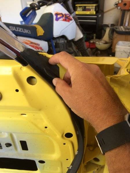

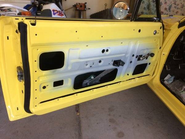

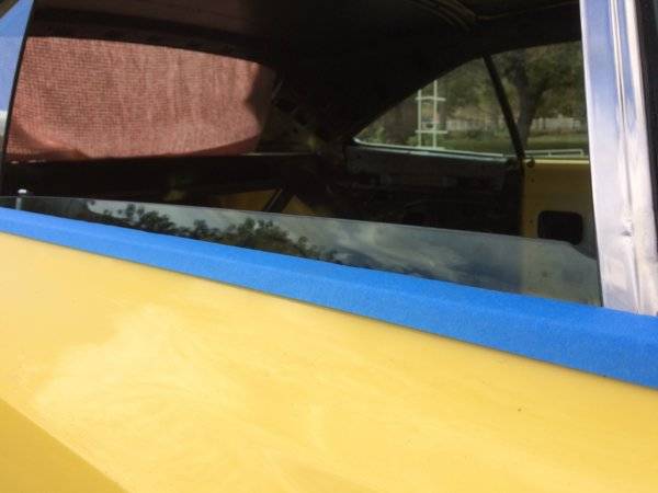

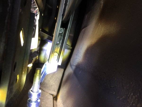

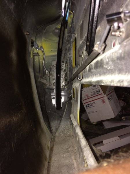

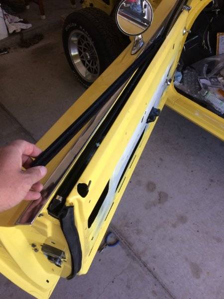

I set passenger door window and vent window today. I did attach the vent window support bracket with the mounting screws and blue locktight. I did find a problem with the screws in place of the spot welds. After getting the window set i could not get the window to roll down all of the way. I found out that the screw heads were holding and catching on the bottom of the plastic slide in the window channel. I cut a groove in the plastic slide far enough to let the window go far enough down. Spot welds might have been the preferred method but I think that everything is OK and it is all working well now.
